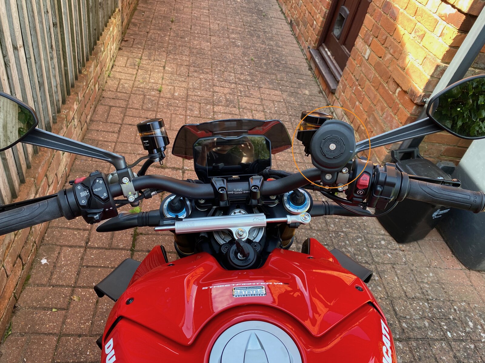

  2. IMG_0254.jpeg Allegedly there is a power socket on the left hand side under the tank shroud. I've not dug into there so far.
    Right now I have a USB connector wired to the battery powering a Qi connector by Quad-Lock. Then use Google maps on the phone for Sat Nav.
    I have had a recent quirk of start switch not doing anything - well its only got one job, but you get the picture. Dealer reckons its the USB connector. I'm less convinced but his solution was to switch the power feed to the sat nav feed on the left...

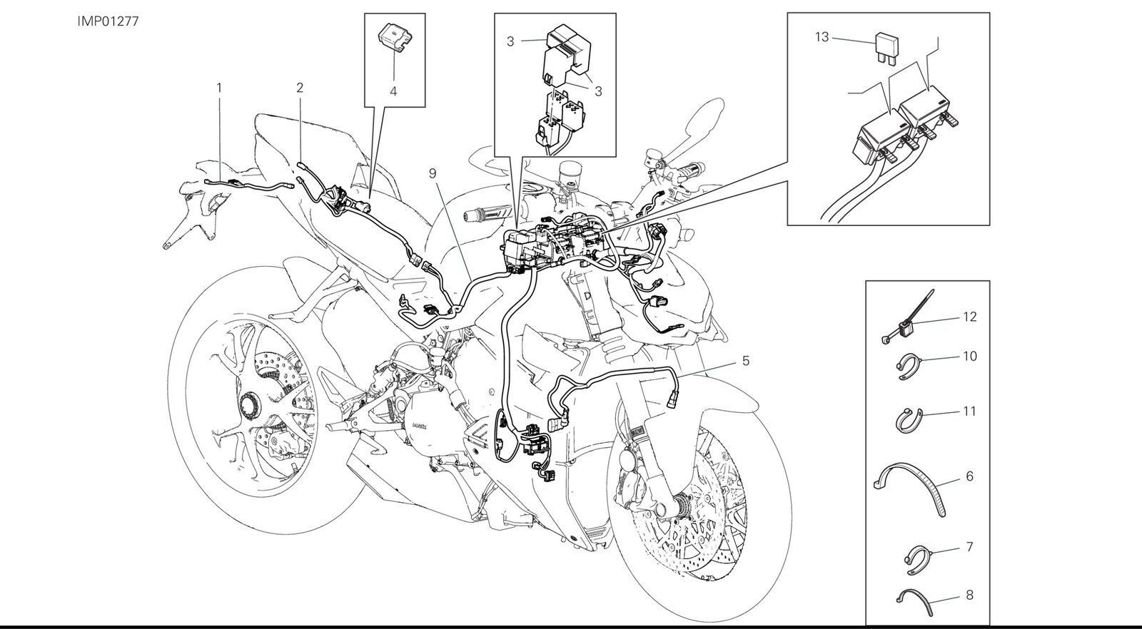

    I think the wiring point under the seat is the DDA connector. I used to trickle charge my Panigale and the Streetfighter through it, but its a pain to take the seat on and off between charges. There is a DDA to SAE connector adapter available from Optimate which would simplify the wiring.
  6. Streetfighter Electrics.jpg Item 4 in the picture.
