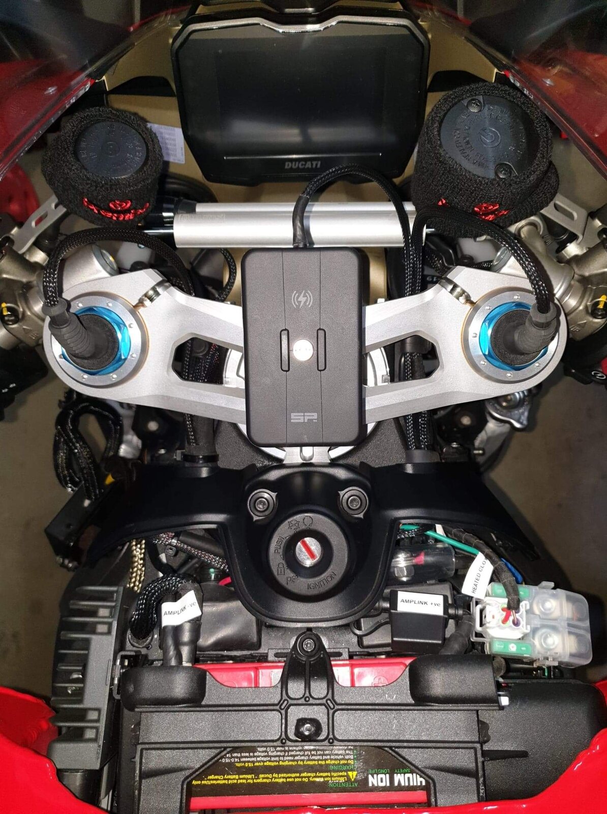

I just fitted the SP-Connect wireless charger to my V4. It can either be direct-wired via their extra cost cable (contains a resistor to knock down the voltage), which is what I did more or less, or the unit comes with a "special" USB lead. Of course that means you need a USB port. Back to square 1. SP stuff is nice quality but bloody expensive. Oh and if you really want someone to bend you over go to Ducati and buy the SP-Connect cover for your phone. It's nice but triple what you'd pay for the non-Ducati version.
Did you ever find a USB adapter and somewhere sensible to tap into 12v switched with the ignition to power it? I already got Quadlock gear including wireless and anti vibration but I too need to find somewhere sensible to get 12v power turned off with the ignition preferably without having to route it all the way from the battery?
Oh for info are mounts that connect to the steering stem but they’re €80+ plus postage or brackets that bolt onto the two bolts that hold on the ignition barrel cover but they’re over £50 too!
