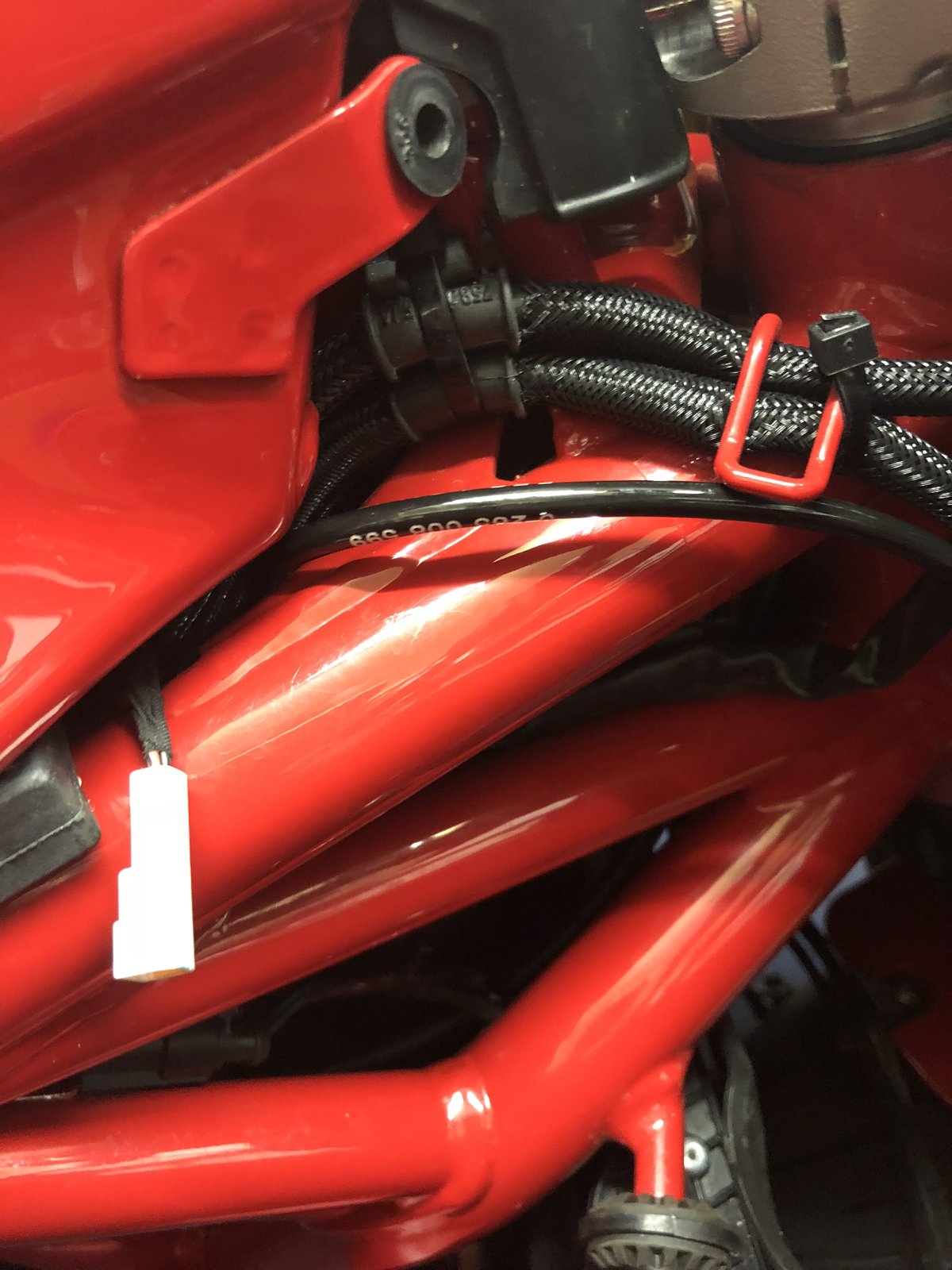

  1. 8F9FEDC4-711B-42B5-B273-243967AB604C.jpeg I have just removed the Garmin sat nav mount that was on my bike and unplugged it from the white socket in the picture.
    I read that there are meant to be 3 plugs in the same area but this plug is the only one that I can see.
    Where are the other plugs and is there a usb socket there or do you have to use the one under the Seat.
    It was to power my iPhone rather than the sat nav.
  2. The other two are the heated grips sockets and are further forward. You can't use the other two for anything other than heated grips. They do look identical.
    I have a USB socket attached to the one in your picture to connect my tankbag and my phone. I use the phone for GPS as it has a better GPS system than a dedicated GPS.

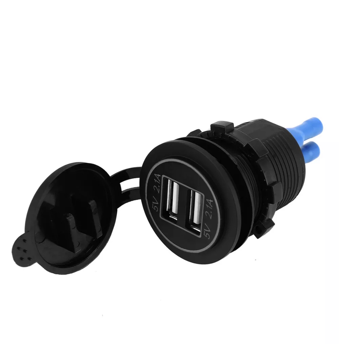

  5. F850F560-94E7-45AD-B1B6-12A051AAC233.jpeg Thanks Bob,
    Did you get something like one of these sockets and wire it to that small plug ?
    Do you have a link to the parts you used
    Cheers
    #5 iang27, Nov 3, 2018
  6. Sort of. That is a panel mounted one and I used a waterproof flying lead that sits next to my ignition key. Cannot find the link to the one that I bought.

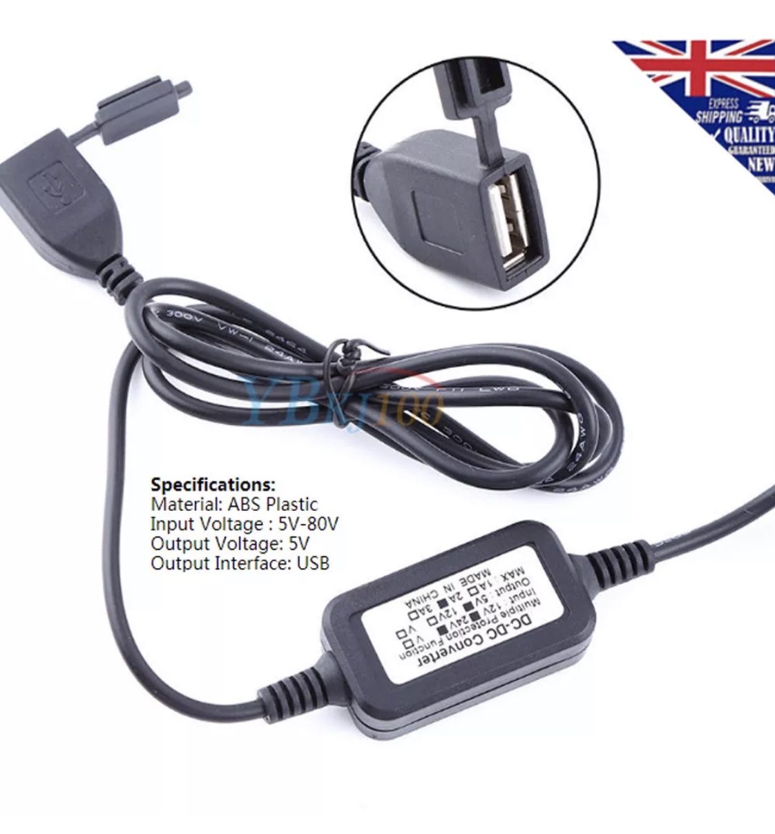

  9. 7EC6D089-7F15-4BC7-BD9E-ED1B134D2E51.jpeg This may do the job.
  10. That is the one that I have on my SS and the wifes Monster and the nieces Monster.

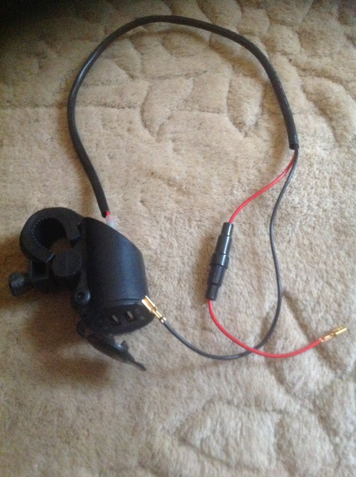

  11. image.jpeg Would this be of any use to you @iang27 ? You might be able to squeeze it on to the left-hand bar.
  12. I have one of those too. Never fitted it because, despite what the information says, it is not waterproof.
  13. Cheers for the offer but I have ordered one of those ones pictured like Bob’s.
    Only £5 so worth a try.

  15. I've just replaced these with a better one. They were not providing a sufficient charge to overpower the drain from the phone using GPS so I would get a slow discharge (from the phone... not me).
    I ended up getting a 3.0 amp quick charge one and even when taxing the phone, it still charges quick.
    The ones you pictured, are fine for lower end things like action cams etc.
