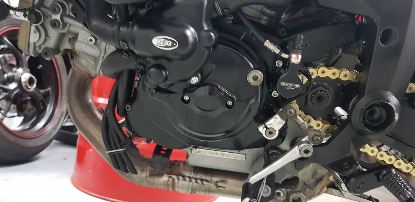

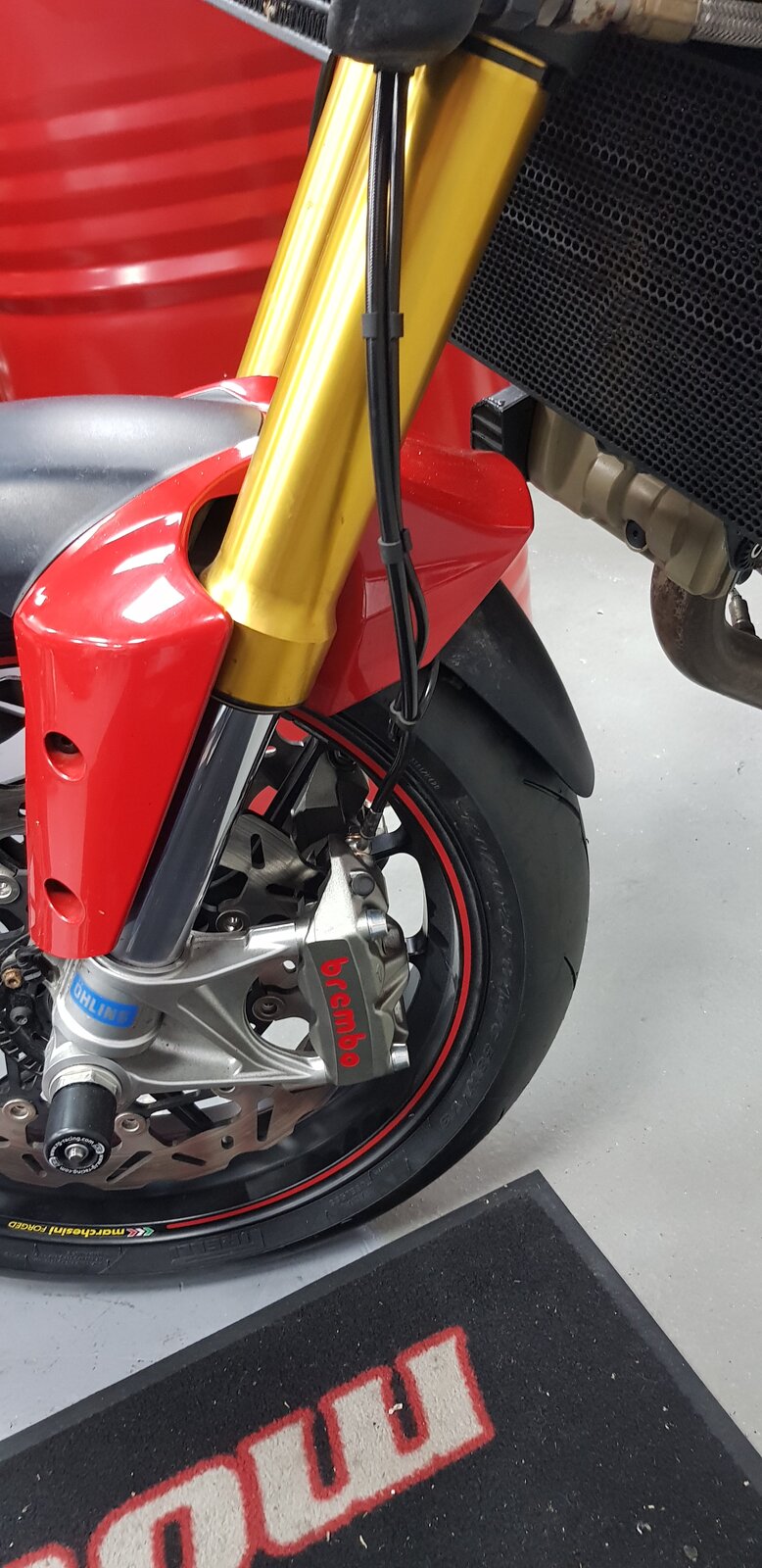

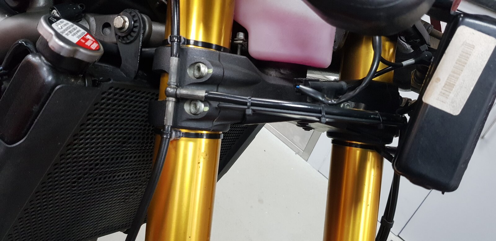

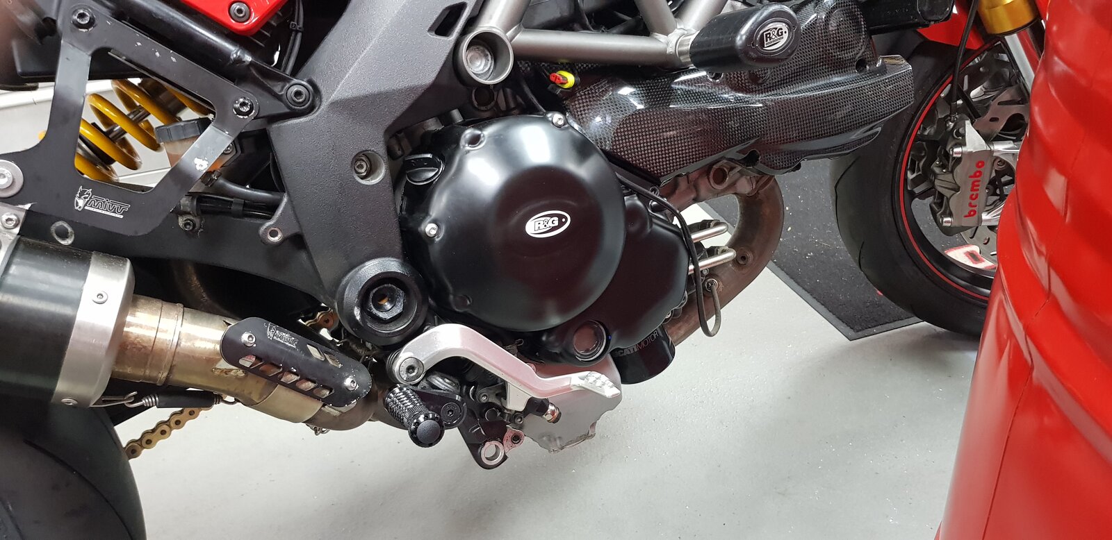

  5. Case protectors and made to measure brake lines fitted and baseline ECU map loaded. Andy
