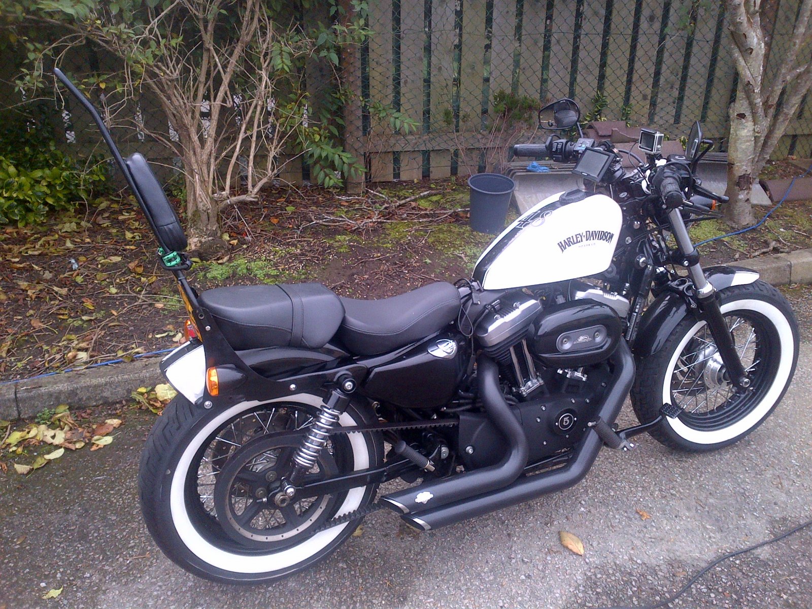

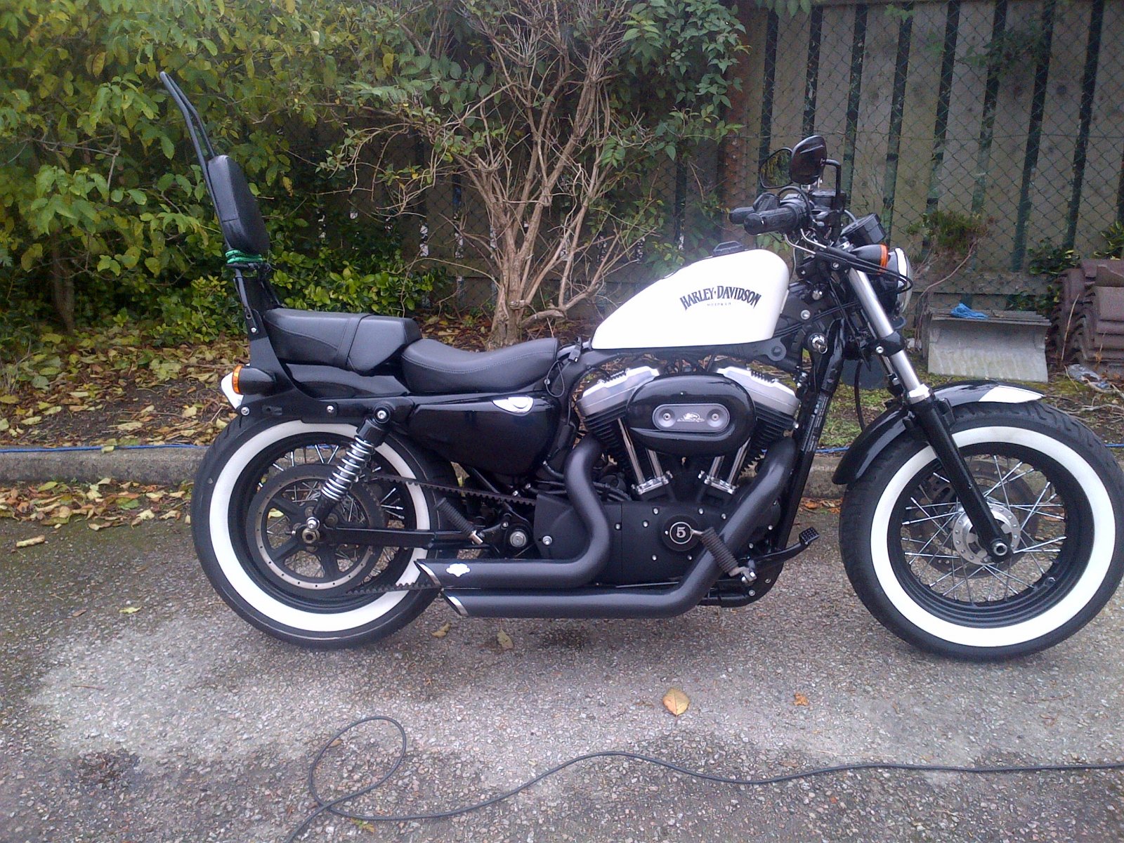

  10. not sure why you are askin but here it is
    HD Sportster 1200 XLC ( custon ) "48" , stg 11 , screamin eagle , 022.jpg 019.jpg
