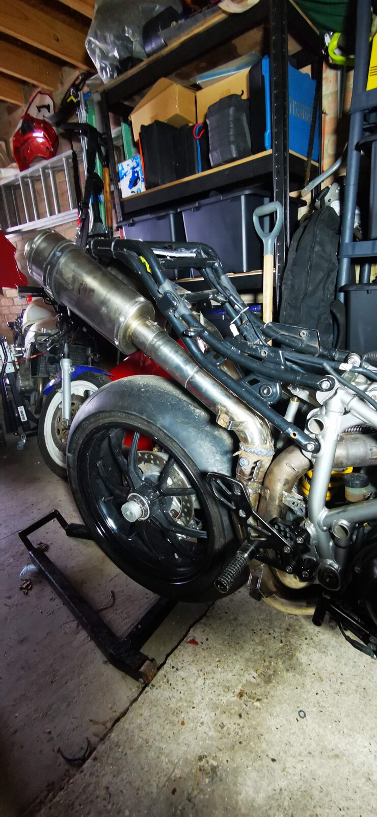

    While all that was going on I also got hold of a welder and chopped about 20mm out of the section where the butterfly valve is to give better clearance for the rear sub frame. as you can see from previous images I have to adapt the sub frame and space it to clear the exhaust. It looked bodged as f**k and my little legs meant I could only just reach the floor. this has now been rectified but as it always is solving one problem causes others and in this case roughly 6 or 7.
    Dropping the rear sub frame back down to its intended height meant the seat sits further back and as i was using an 848 tank and 999 seat there is now a gap not only in the nut sack area between tank and seat but the seat itself doesn't sit on the sub frame meaning its just floating which will no doubt at some point just collapse.

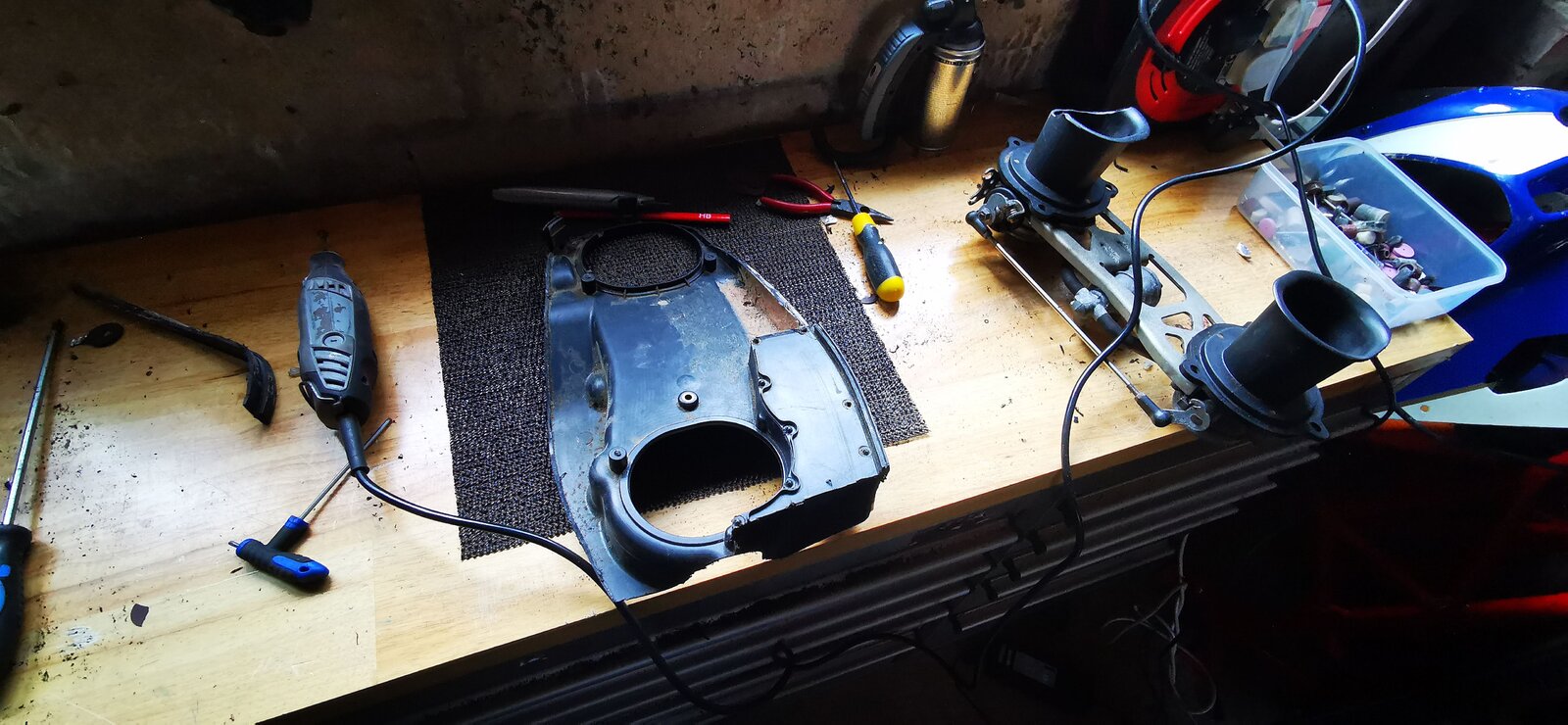

    Back to the 999 tank it is then. This is where the next problem came in. I managed to get a 1098 airbox to fit the frame without too many issues when using the 848 tank but it was never going to fit under the 999 one so that has been ripped apart to give me a "flatish" base to then graft the top 90% of the 999 box on. This also means the air duct fitment will be much easier. Next issue is fuel. obviously the 1098 injectors sit in the top of the box the 999 ones don't and mount on the inlet. Fortunately on Ducati ms someone has kindly posted up some 3d print files to fit 1199 injector mounts to the 1098 throttle bodies as part of their 916 / 1098 project. All in the change from 1098 to 1199 injection will be about £70 this includes ordering 2 parts new. Looking further into the injectors I will also gain over 10% extra flow rate so more room to tune when all up running.

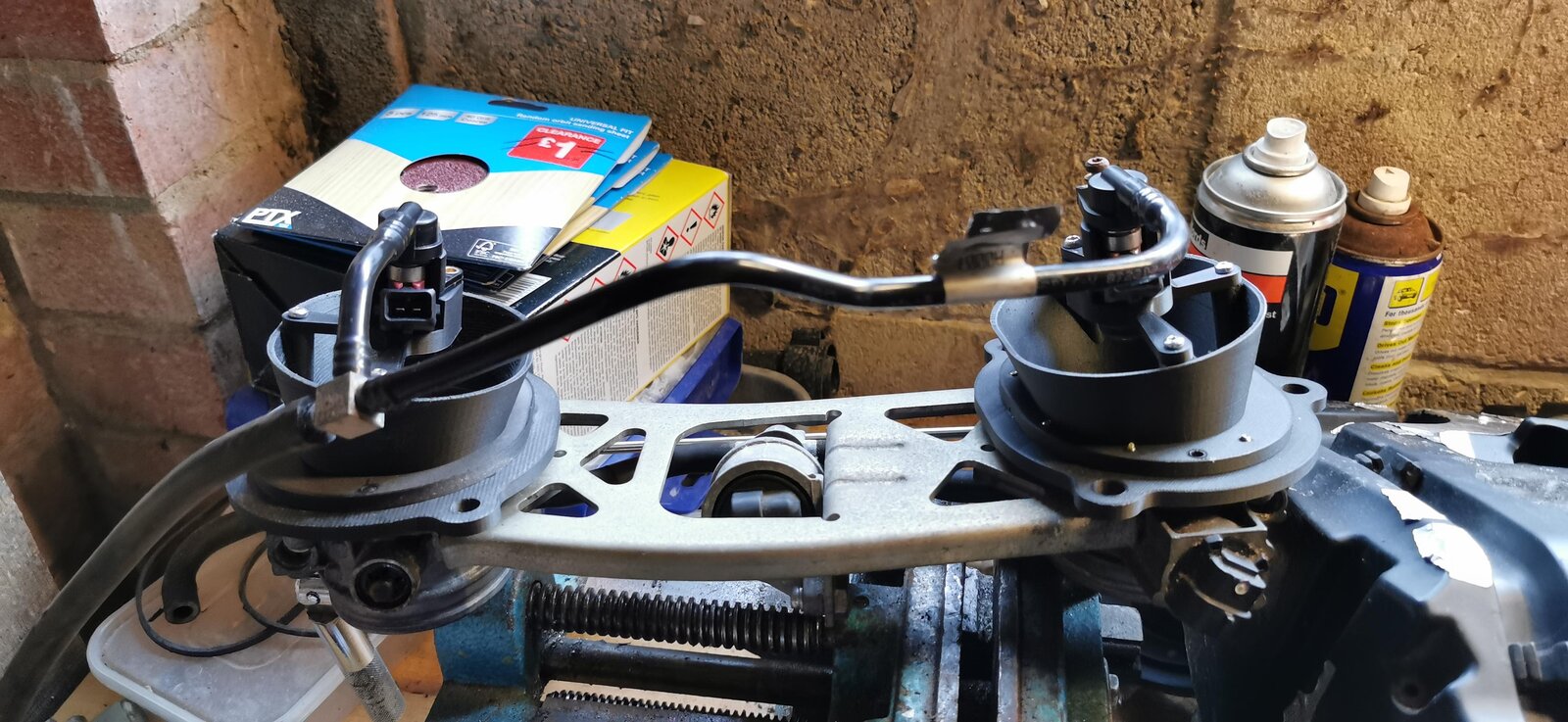

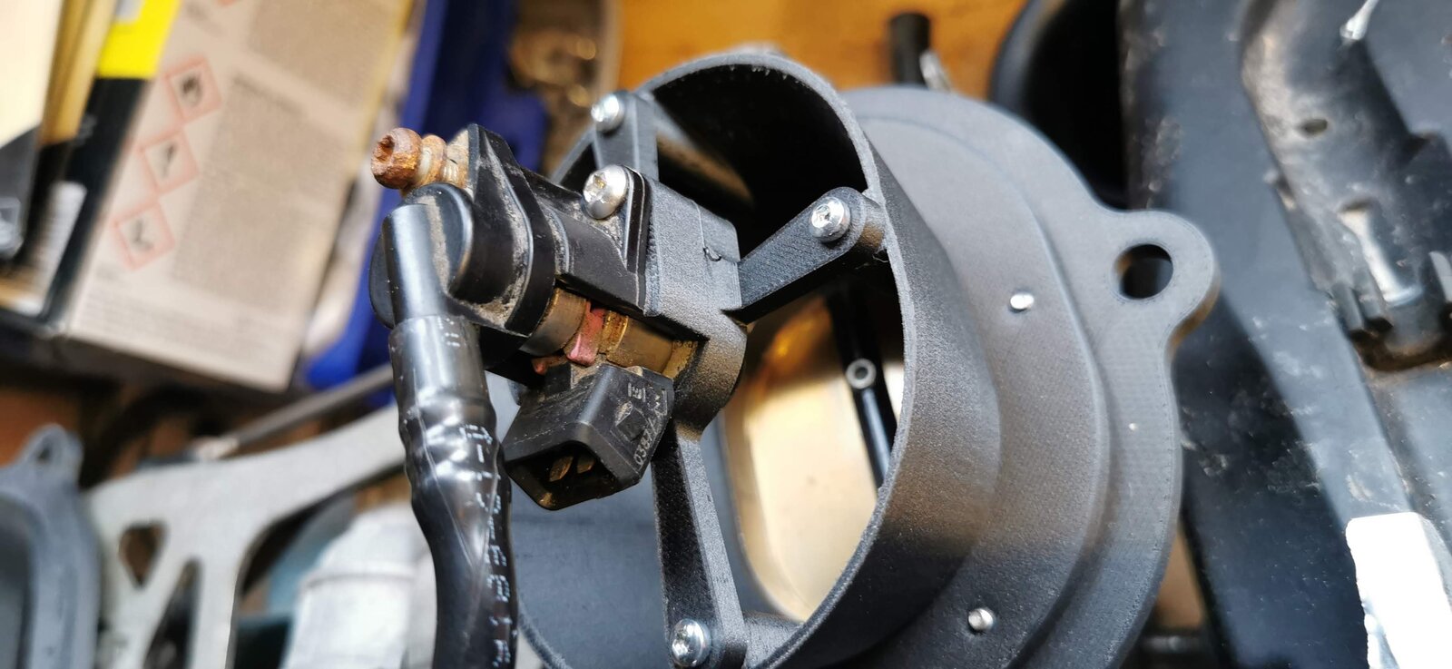

  6. I've now managed to get some 3d printed injector mounts that fit directly onto the 1098 TB's at the cheeky cost of £30 for materials. I'm going to have to run new fuel lines can someone point me in the direction of what lines I would need. preferably long lengths that I can cut to size. going from 999 fuel pump to 1098 injectors
  7. Here are the printed parts. Guy did a fantastic job tweaking them to clear the air box lid and fit the injector perfectly. Super strong and very light as printed using part carbon fibre filament
