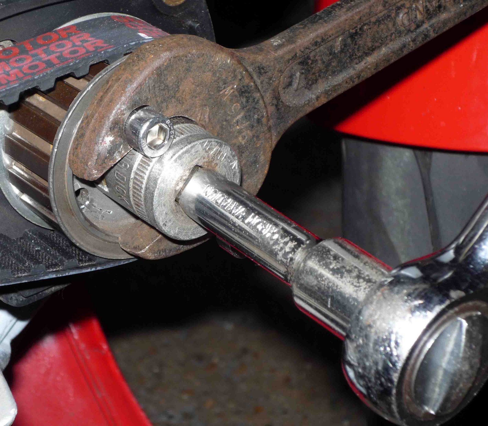

    My cam pulley tool looks something like this:-
    DUCATI PANTAH MOTORCYCLE CAMSHAFT PULLEY REMOVAL TOOL | eBay
    The trouble with using a socket or a filed up nut, is that you are always going to have a little difficulty holding the pulley still while you undo it. Sometimes using an old scrap belt with a pair of mole grips or similar won't be enough, and you will have to drill the pulley nut. This happens if you use locktite or similar on the pulley nut.
    After screwing around with Ducati engines for about 10 years, I gave in and bought the tool. I think that it's worth it. Two of my mates also have Ducatis, so it gets some use. The camshaft seals behind the pulley need changing every now and again, and this tool comes in handy for that.

    .........two of the holes in the pulleys appear to be M6 thread.

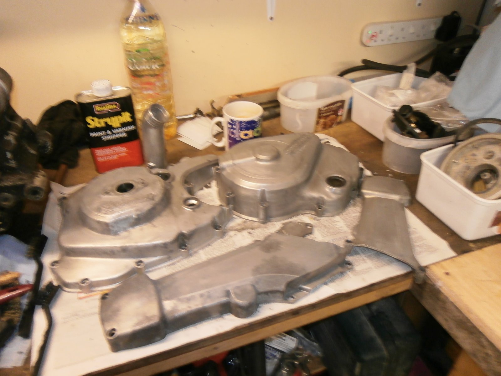

  7. Here's what i have done today with engine strip and cleaned cases, about four hours work.
    Just need to polish now, any ideas on kits for this. I'm not going to mirror polish just a decent finish, get the blemishes out.

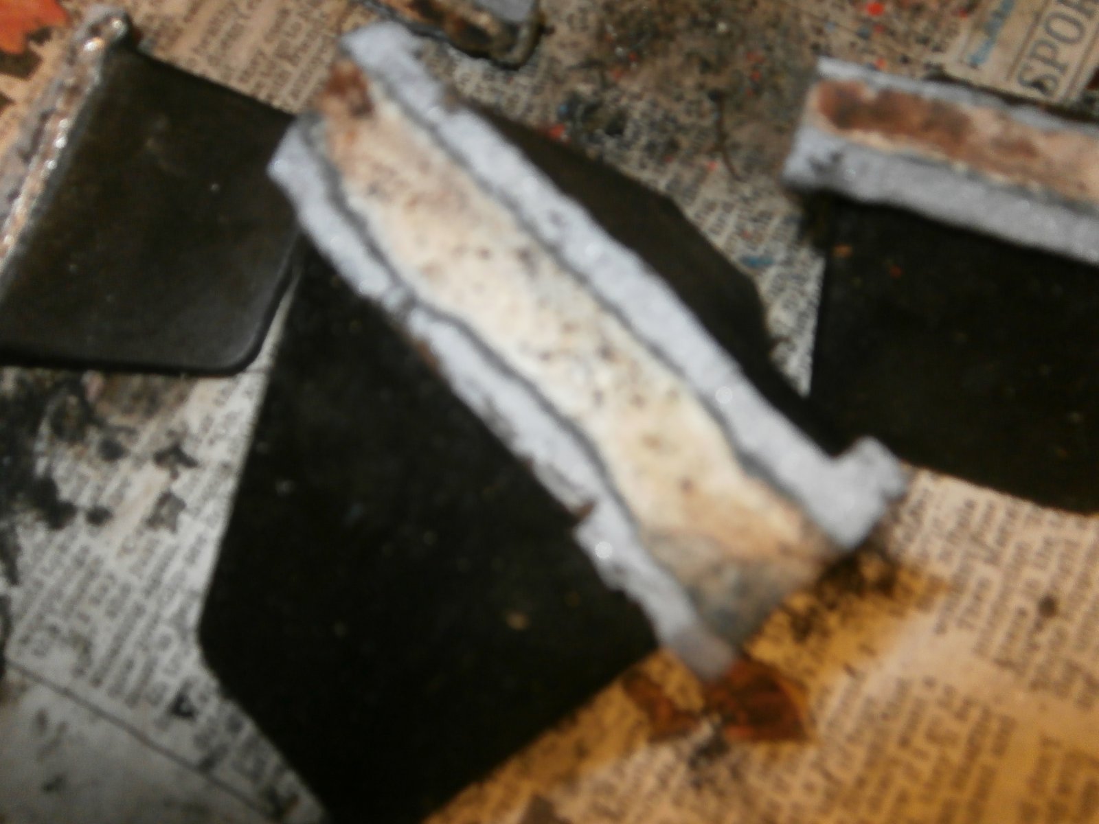

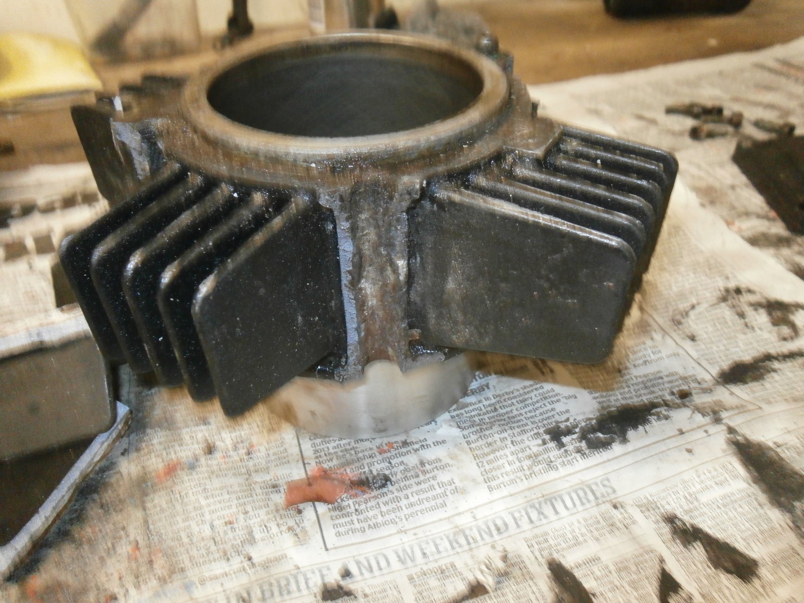

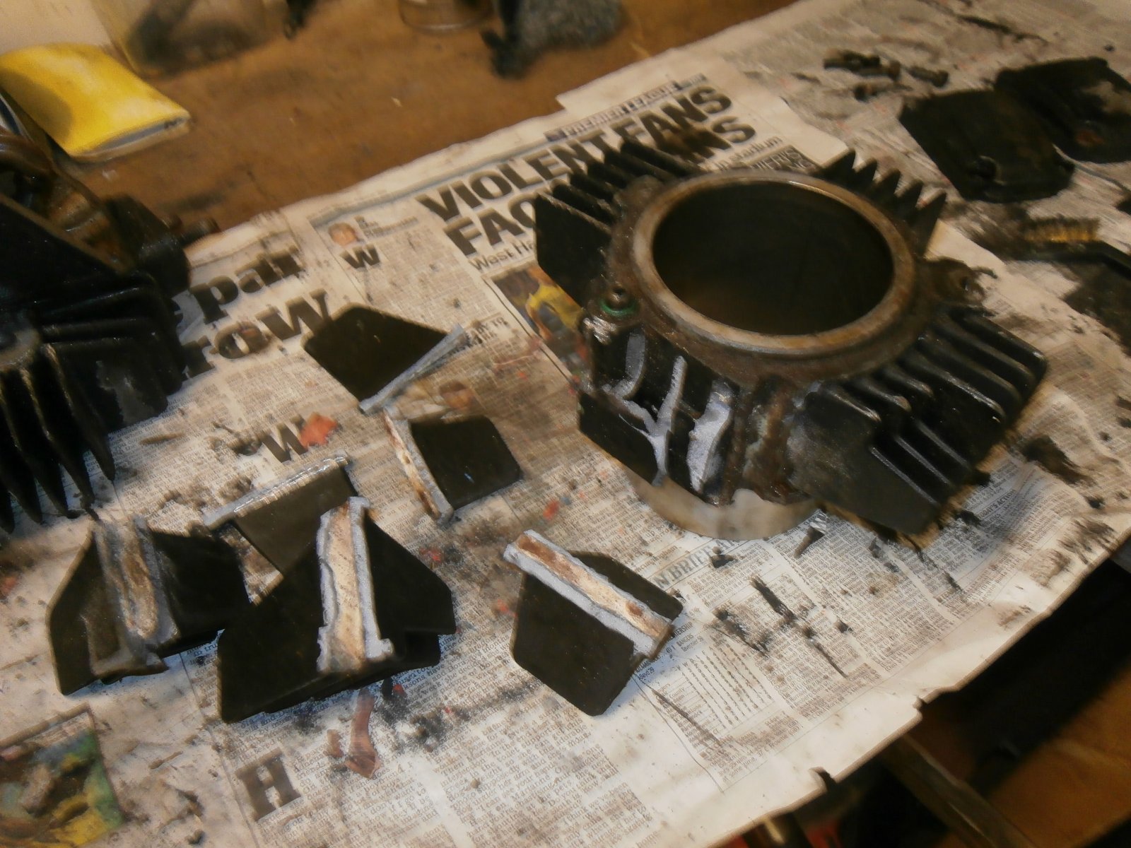

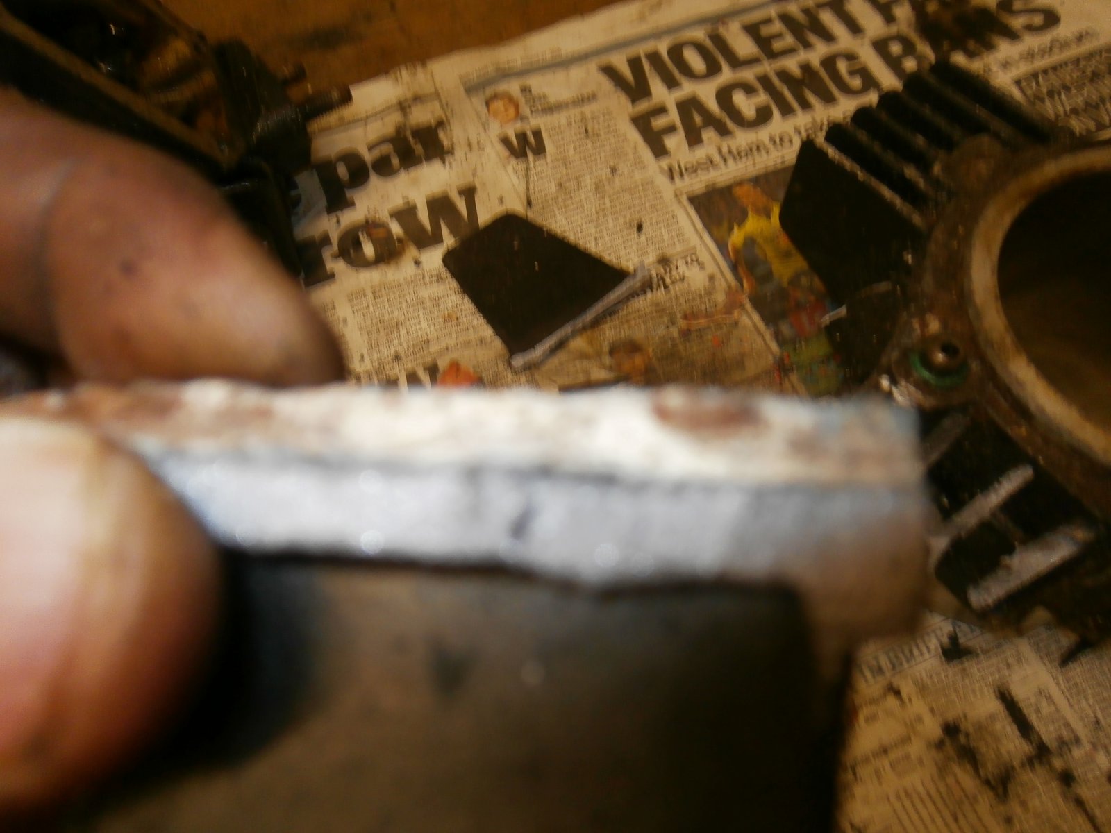

  10. What sorry site, nobody would be leave what has happen, probably all thinking hamfisted twat, honest im not, barrel and head stuck fast more soaking and heating, cooling more soaking heating etc left it more heating soaking gentle taping with copper hammer, at last a movement with a very loud cracking metal sound, you no the sound which makes you jump, you look thinking the worst and all is ok, not this time. never had this before barrel cracks round all for studs, never seen so much corrosion on an engine round studs, done a fair few engines in my time, solid on all four studs, thick and hard. So if anybody got a 600 horizontal barrel for the right price i would be interested. Thanks P1140001.JPG P1140005.JPG P1140003.JPG P1140004.JPG P1140002.JPG

    Stick ad in wanted section. Bound to be someone on here with 600 motor in bits.

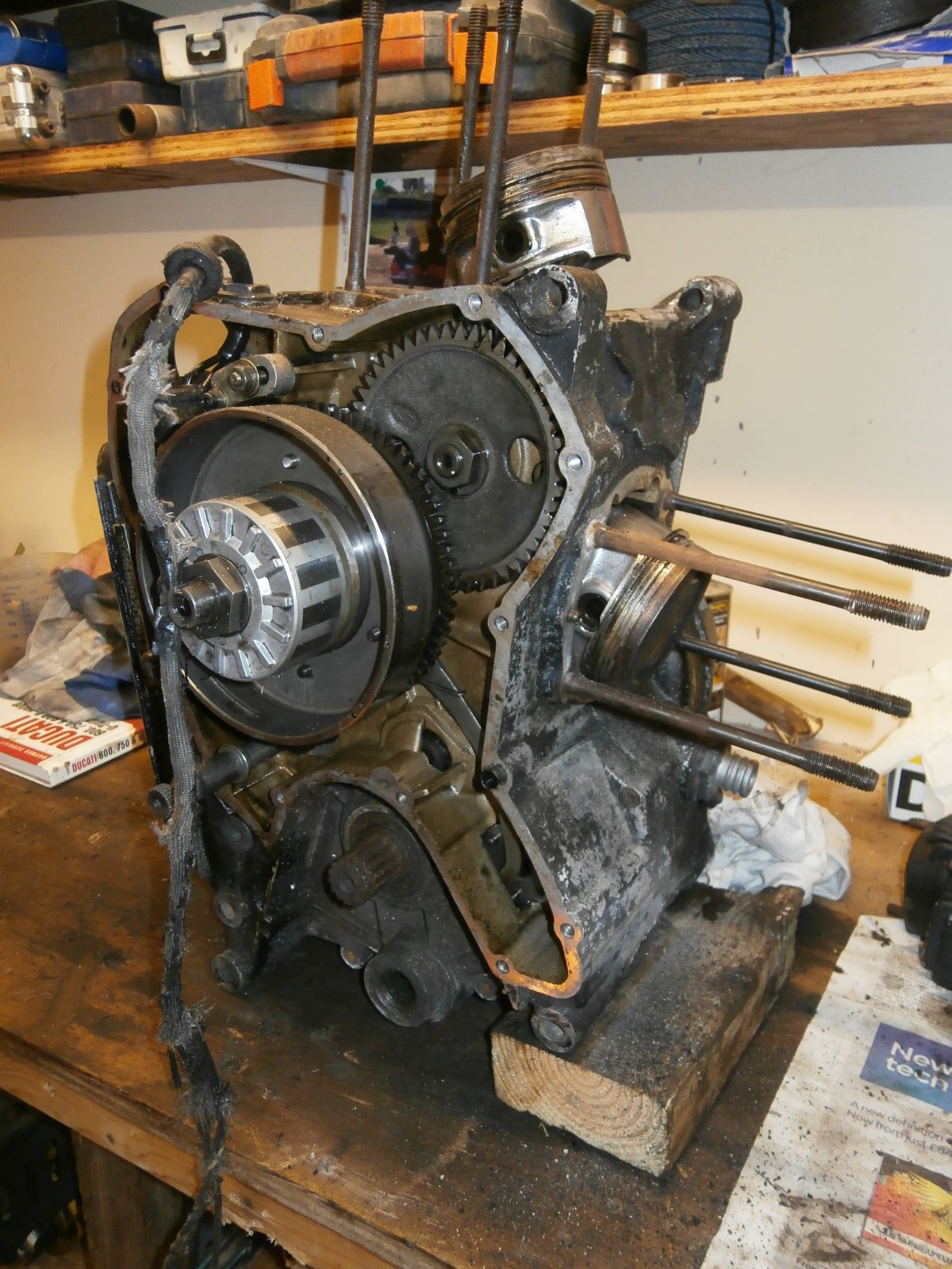

  15. I suspect there must be some body on this forum that has some idea, as long as you can get head of first you will have a better fighting chance, which mine would not separate from barrel, until the barrel split and then it took some getting off due to corrosion. You might be able to make a plate type puller, which i saw in piratical sportsbike mag a while back but could not find the issue but the head has to be off. If you are splitting crankcases like i am, you will need a rattle gun to undo 30mm nut on primary gear and if the engine has been apart before a two legged puller will get the gear off, if not the engine will have to go to a work shop ie: bike or engineering shop with a hydraulic puller. Which i have to. Alton Hant's is my nearest ducati dealer I'm only stripping my engine down as i bought it as box of bits, got no history and the engine looks total crap on the outside and peace of mind when i rebuild it.

  17. Because duke's dont have head gasket and have recessed fitment the metal corrodes together making it a bit harder to separate than a head with gasket, the vertical barrel and head came apart on mine easy enough with gentle persuading. I did find even with the special tools for undoing head nuts was a bit of a pain as the nuts are of poor quality, seem to be in between 14/15mm. did buy one set from laser tools which twisted got a set from M&P which where better i think i will be getting a decent set of crow feet sockets. To get the clutch basket off you will need to stop crank rotating, use a rattle gun or breaker bar also depends if engine is in frame or out how you will lock crank. Take your time read up be confident.
  18. Rain off today, oh the life of a bricky. gave me a chance to get in workshop, have another go at getting the primary gear off. The first 10 ton puller i bought was far to big a tool for the job, that was about three weeks ago.Bought another one off ebay copy of Draper/Sealey one's, arrived this weekend, although the different reaches are fine the tool only has a min of 100mm spread, the gear is only 80mm wide, jaws kept popping off the gear to wide a spread you see. Been pissing me off this has just would not budge. So one last go with plenty of heat on gear, bang a puller falls to worktop and gear fly's a cross work bench, I no the manual says its factory pressed and you will need a hydraulic puller if it's not been off before, so if any body is going to do this for the first time just be careful, it could do some damage if it fire's off and hits you. Never known a gear like it, taken apart & rebuilt plenty of engines in my time, every days a school day they say.
