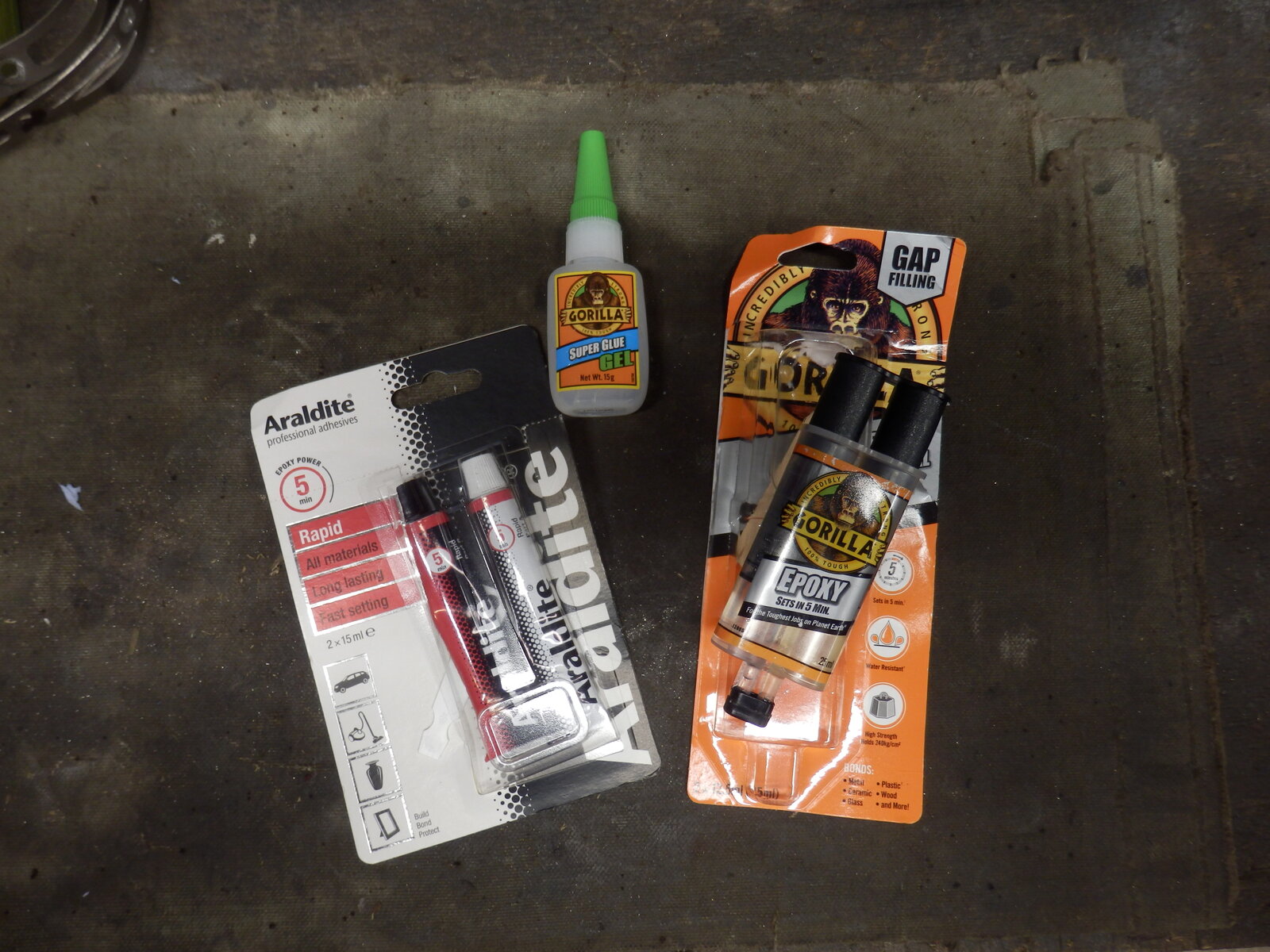

    First of all Gorilla GEL Superglue.
    The Gel version is formulated differently to other Superglues, even the normal Gorilla Superglue, and sticks ABS and other plastics really well.
    I came across this stuff via a comparison test by a boating magazine I read.
    It performed much better than other more specific plastic adhesives despite being significantly cheaper and available in Halfords, Tesco etc.
    I've used it a lot, and can't recommend enough that everyone has a bottle in the cupboard.
    In October lady Nasher and I had a week walking on Bodmin moor.
    On the second day the sole separated from one of my walking boots.
    As I always have a bottle of this in the car I glued the sole back on, left it weighted down overnight and not only did it stay attached for the rest of the weeks walking, but is still going strong having been used every day to walk the dog since.
    The Gorilla Glue 2 part Epoxy is just as good on Plastics, but has a lot of gap filling qualities.
    It sticks ABS etc really well with the above preparation, and can be used to form a fillet around a broken lug etc.
    It's available in Halfords amongst other places.
    But, it's difficult to squeeze out equal quantities and is quite runny when first mixed so needs care to use.
    It's supposed to cure in 5 minutes, but in current temperatures in my garage takes @1/2hr
    Good old Araldite works just as well as on ABS once the prep has been done and is easier to use.
    It's thicker when mixed, is easier to squeeze out, and cures a bit quicker in cold temperature.
    It's also available in Halfords etc.
    However, I've found that if building up several layers of epoxy, the above two products appear to adhere to each other better than they do to an already cured layer of themselves, so I use both in turn.

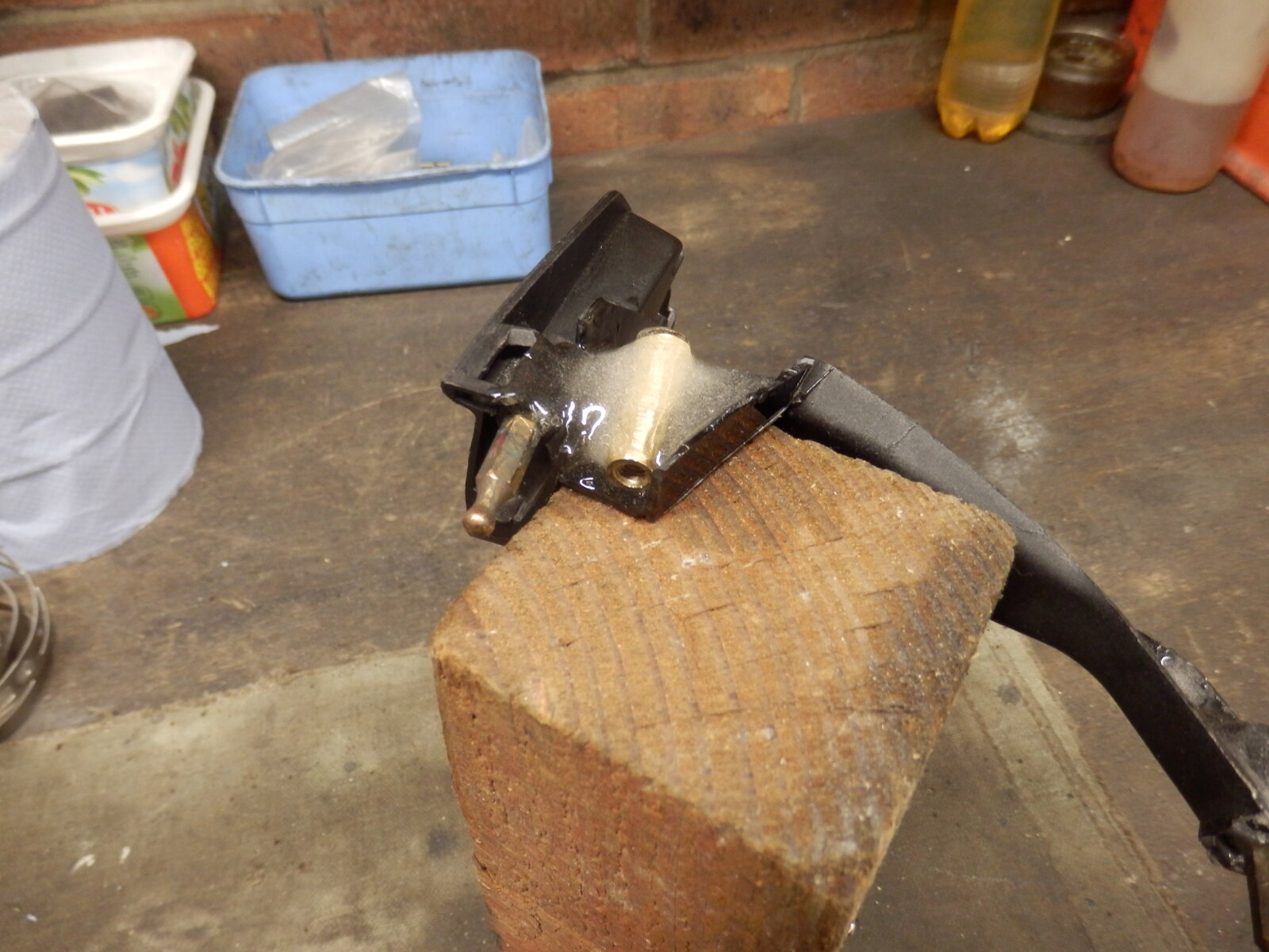

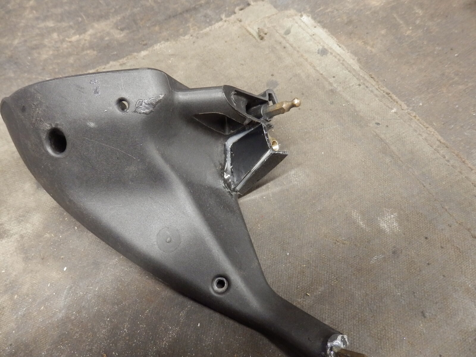

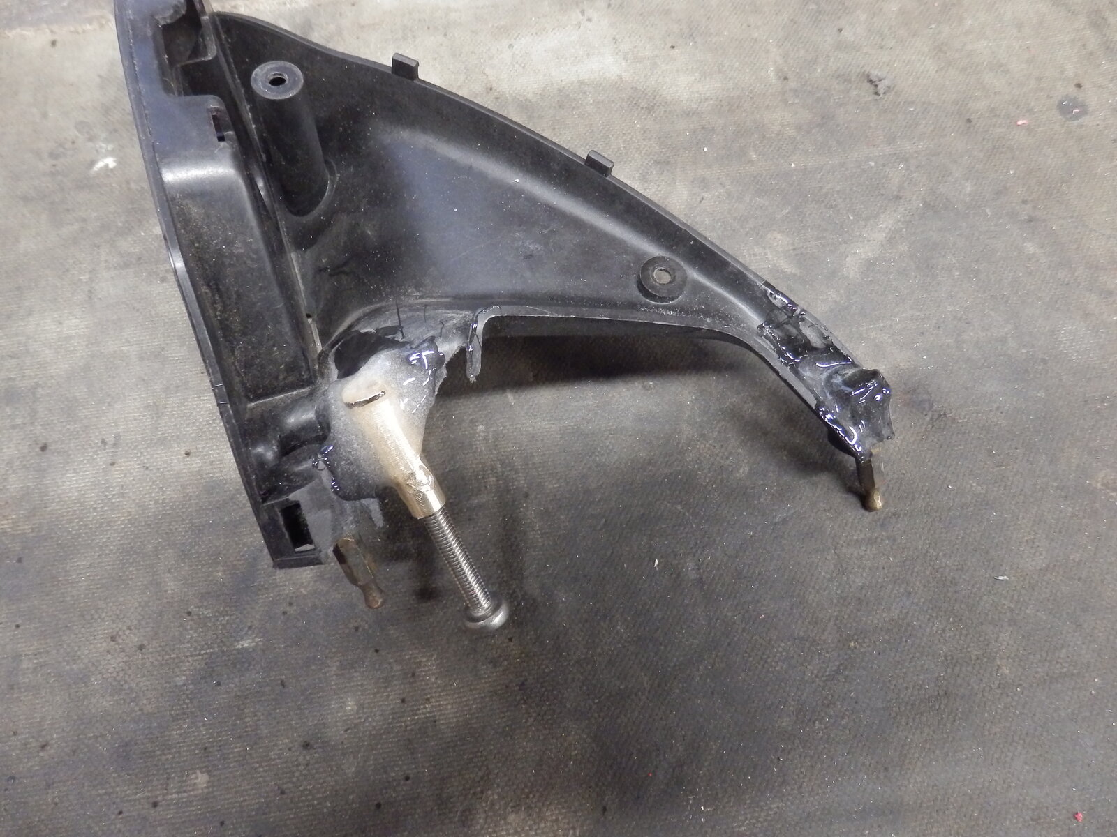

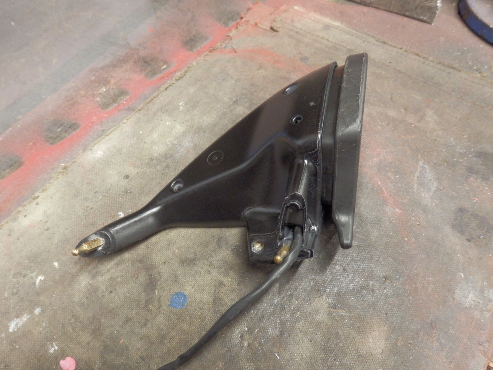

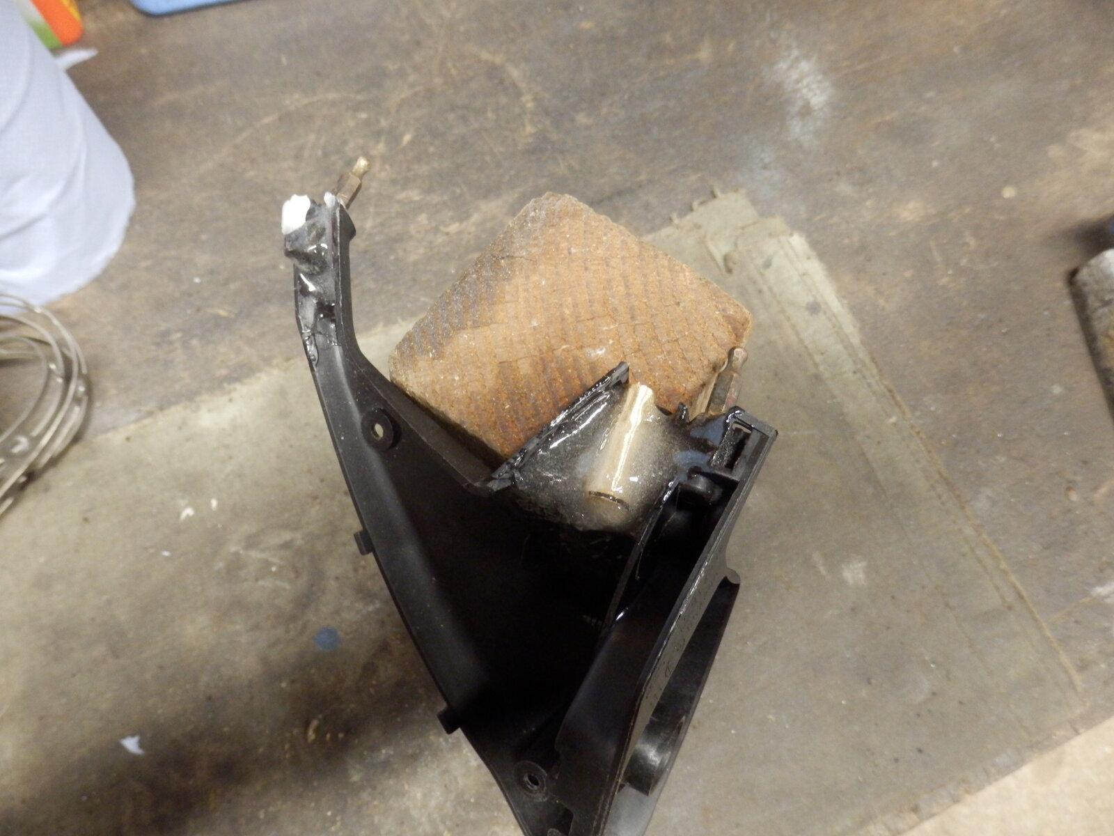

  2. Stage one was to turn up a Brass threaded tube to replace the broken away mounting boss and superglue it in the correct place to what's left of the body:
    Then add a first layer of epoxy to lock it in place:
    Once cured I cut some sheet ABS and epoxied it in place to start reforming the body and add more strength.
    I'm currently leaving it for a couple of days to fully cure before starting with some plastic bumper filler to reform the shape.

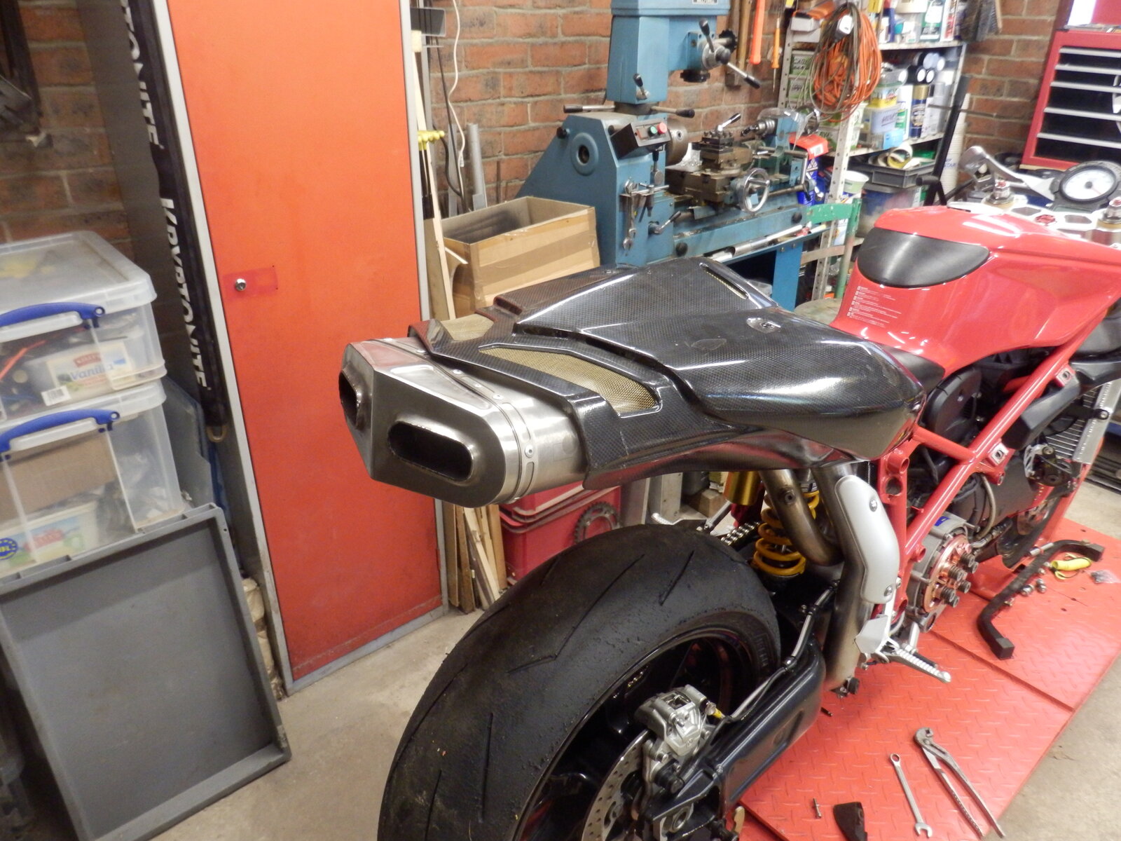

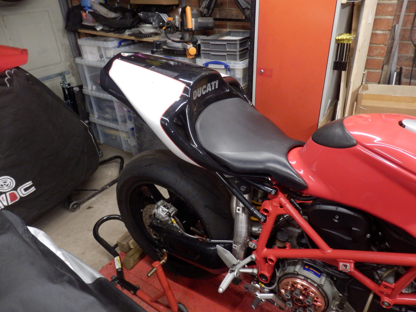

    Firstly the 'R' style Carbon tailpiece previously mentioned in this thread:
    It basically owes me next to nothing, and I've now modified it to fit with the standard Biposto subframe.
    It fits over the standard Exhaust and exhaust cover.
    But needs a lot of work cosmetically and I'm not sure I like the shape.

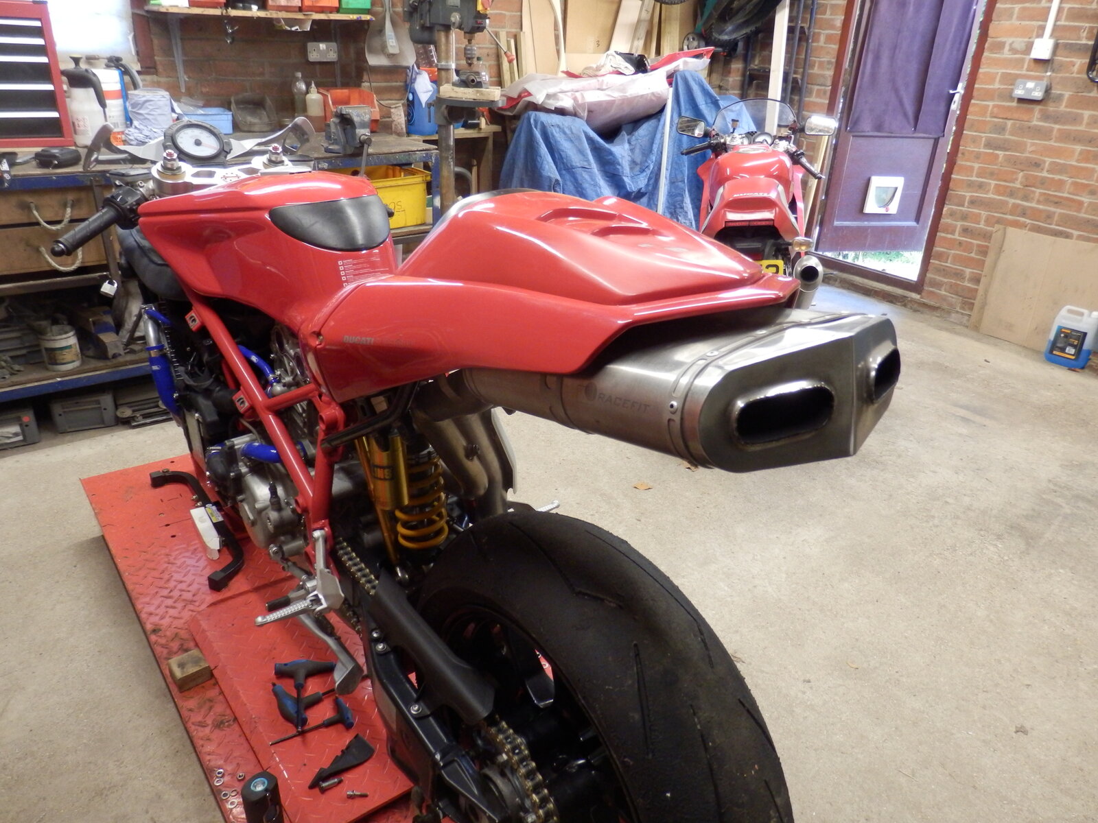

    Secondly is an RS style Carbon tailpiece I've picked up for next to nothing because again it needs work.
    https://www.ducatiforum.co.uk/threads/carbon-tail.89428/
    It looks daft over the standard exhaust, but fits nicely over the Racefit.
    Note above it's mocked up only as I'd need to cut and shut a Biposto Subframe to mimic a Monoposto as it won't fit with the Biposto subframe in place.

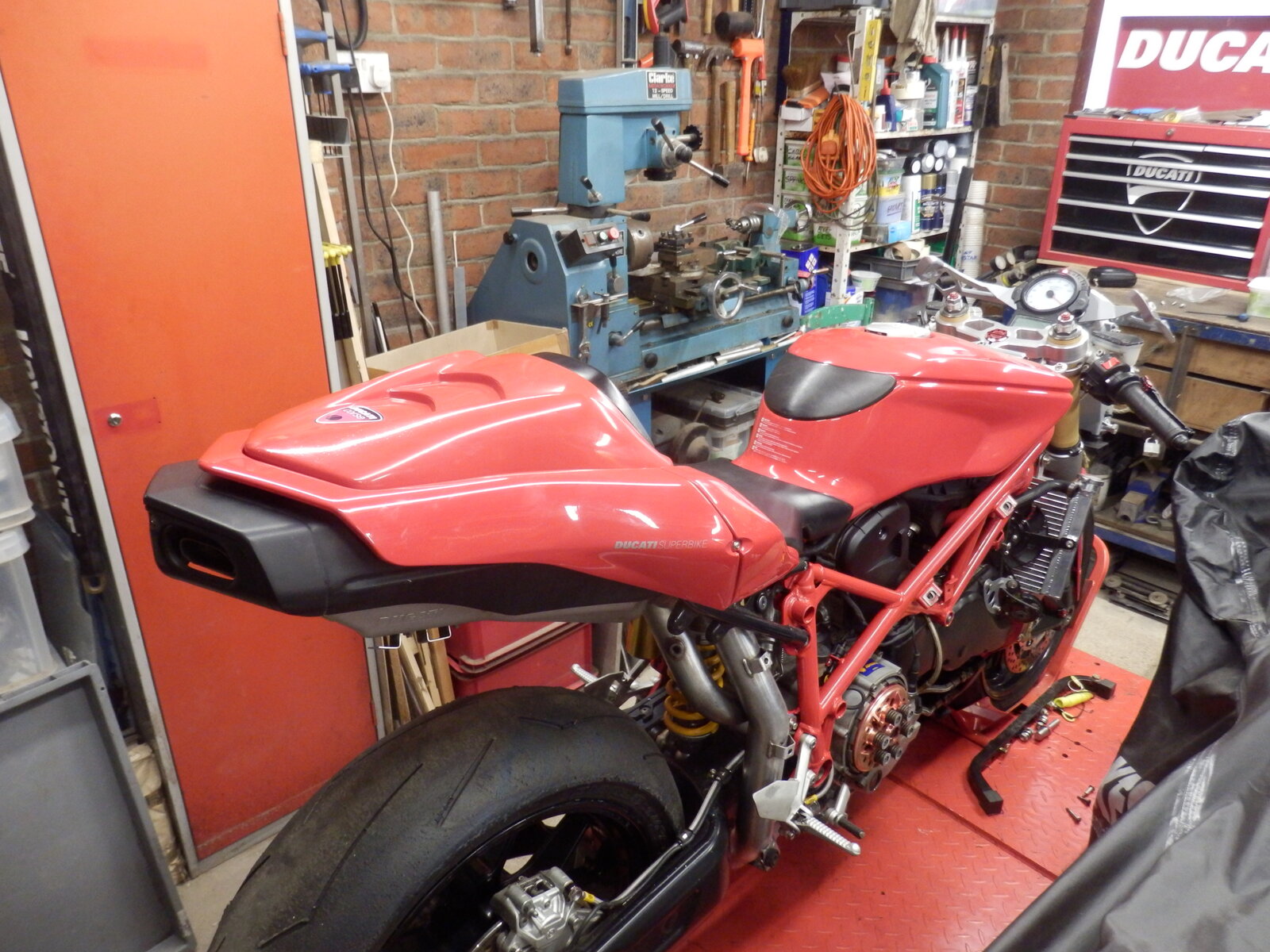

    The other option is the standard rear panels with an aftermarket single seal 'converter' which fits with both the standard and racefit exhausts:
    The 'Converter' needs paint to be good enough to use, and I'd cover the solid plastic Bum Pad in soft Vinyl to mimic a proper one.
    Going this route would give me the option to convert to Biposto really quickly should I see the need, and gives a small key accessible locker for tools.
    I must admit I'm quite liking the proportions, look, and practicality of the last option at the moment, but could be swayed by the Carbon RS one if I go with the Racefit exhaust.
    I'm almost certain to sell on the Carbon 'R' One at the moment to add to the project funds pot.

  6. RS tail plus Racefit can gets my vote.
    • Agree Agree x 5
  7. RS tail with Racefit exhaust all the way. Convinced me I need an RS tail myself for my Racefit exhaust. :heart_eyes:
  8. RS tail and Racefit all day long. Always loved that look, with the can sticking right out...:upyeah:

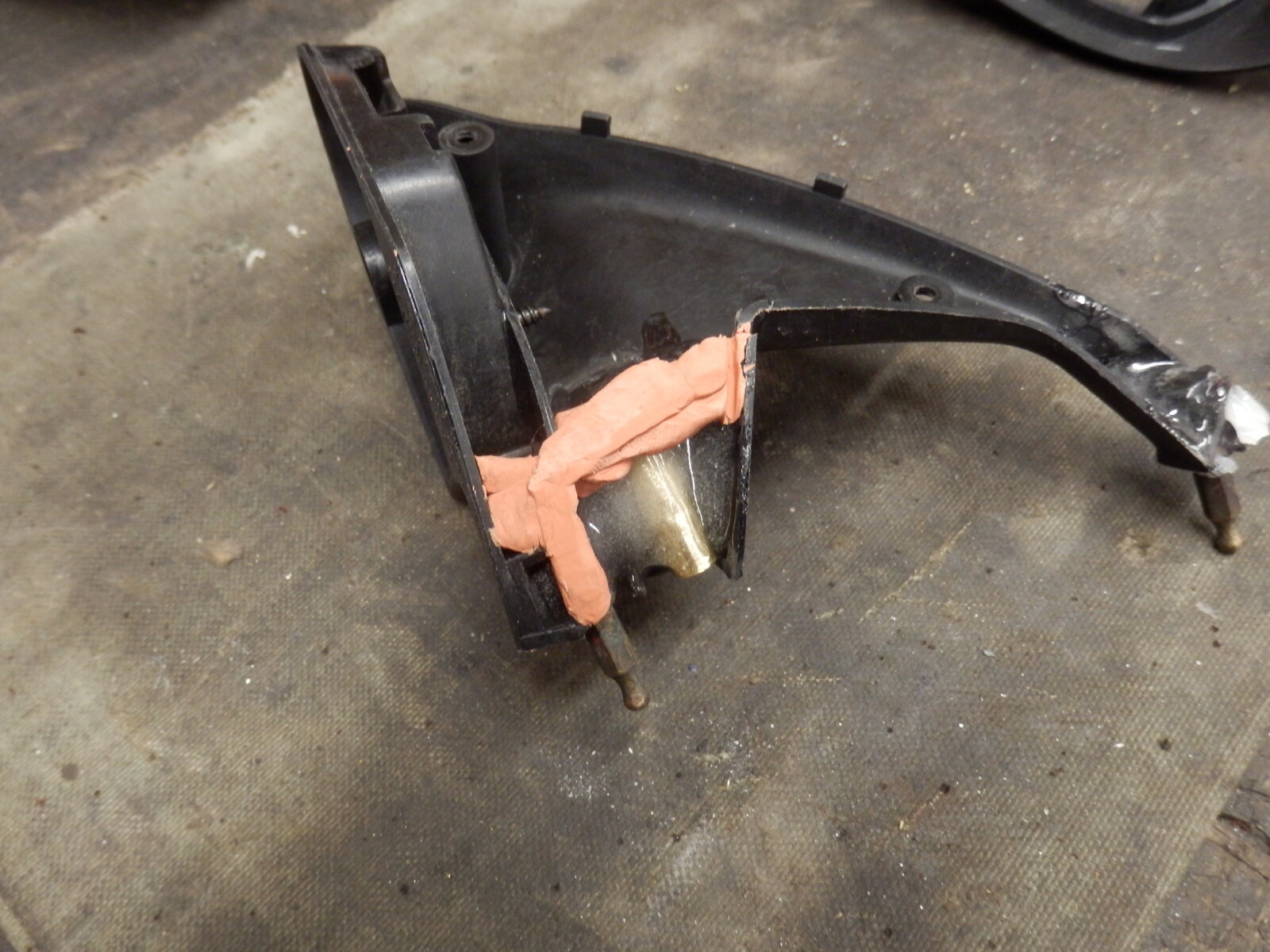

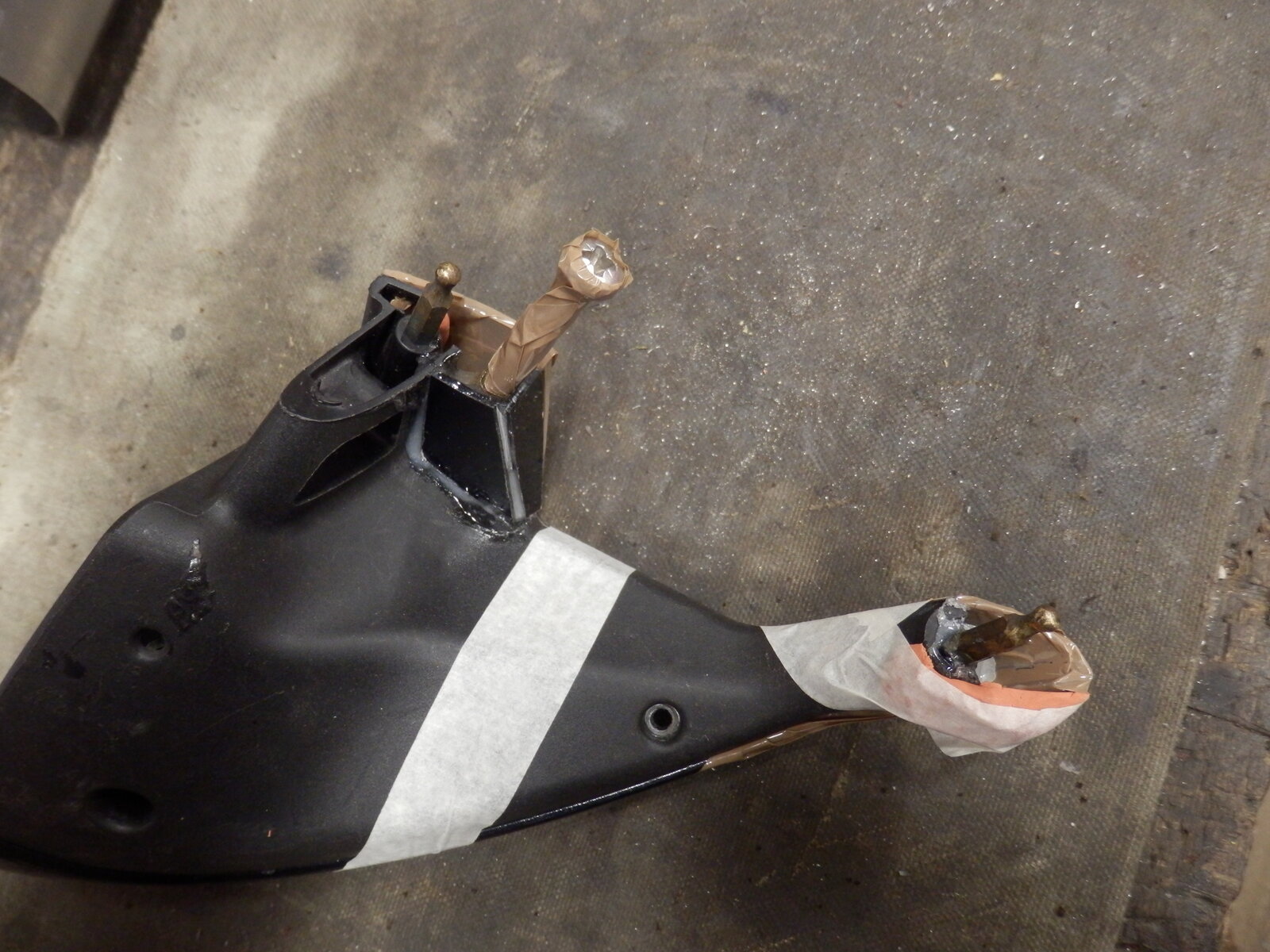

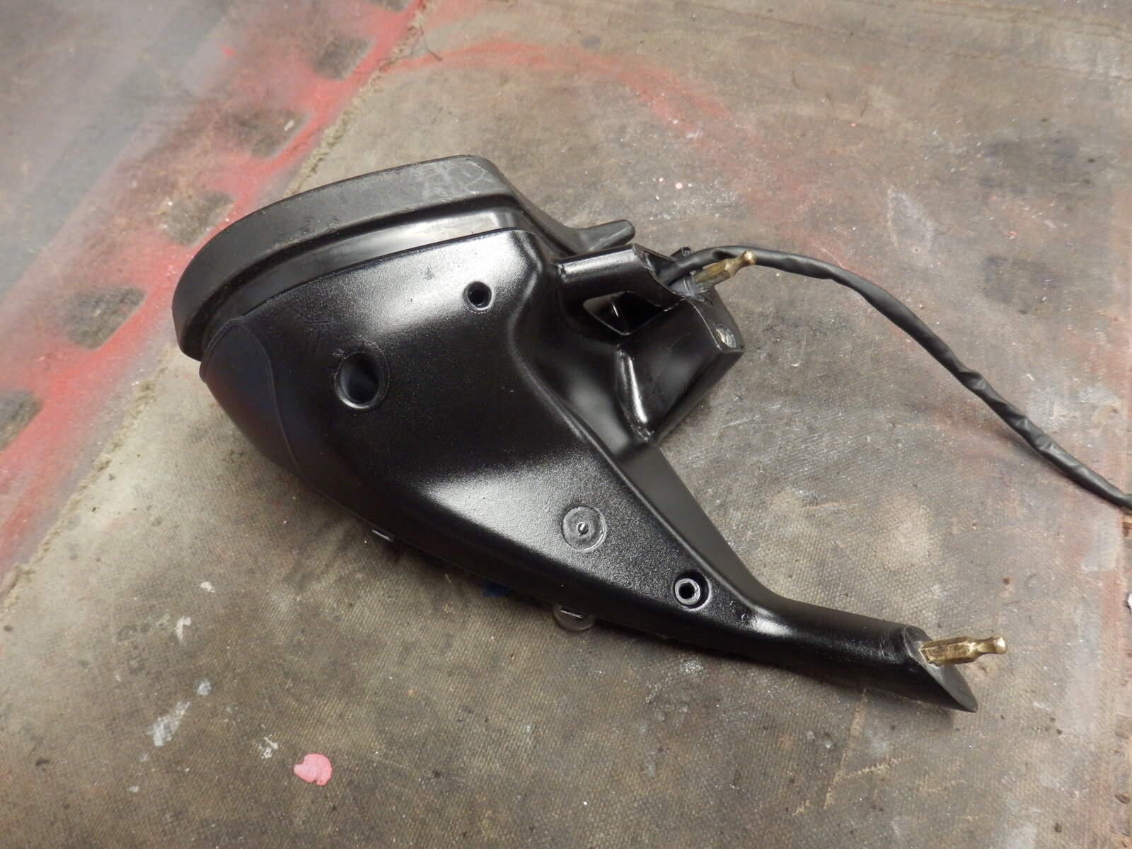

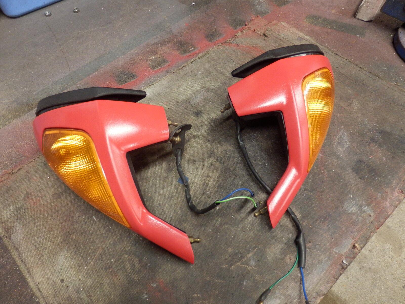

    I have finished off the Wing Mirrors.
    With the Epoxy having gone off properly and providing a good strong mounting point I could concentrate on making them look good enough to fit.
    Plasticine is useful for lots of things, including making temporary 'Dams' and molds when using filler, and Parcel tape is great for stopping Filler, Epoxy, Fibreglass, and many other things sticking to what you don't want them to stick to:
    Then with a coat of etch primer and Satin Black paint the Left hand base is good enough for me to use.
    I brought some rattle cans of paint from RS paints and sprayed the Black Covers Red.
    I'm not completely satisfied with them, but the colour matches and I'm sure I'll warm to the finish.
    It was probably still a little cold to paint them in my unheated garage.
    Rubbing them down and repainting them can be a job for a sunny Sunday once the bike is on the road.

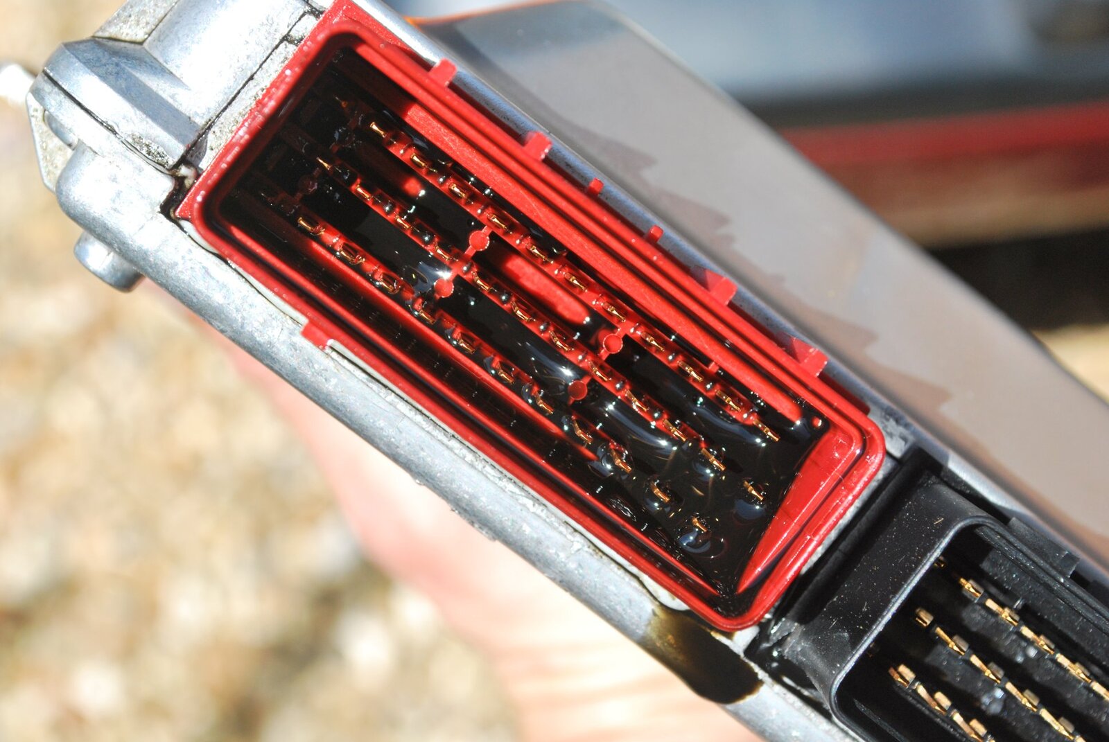

    My first experience of it was with a TD5 Discovery, where the injector harness ends are under the rocker cover, and the Oil finds it's way all the way back to the ECU plug, shorting it out and causing all sorts of running issues.
    Land Roved had so many instances of it that they redesigned the harness.
    From a LR Forum:
