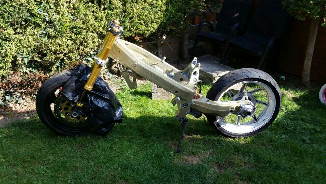

  11. I got the gsxr front end half fitted today with the bearings suggested earlier. Just need a small space making now

  14. [​IMG]
  15. [/QUOTE]
    Time to start a thread instead of hijacking this one now the pictures are starting to flow / trickle ;)
