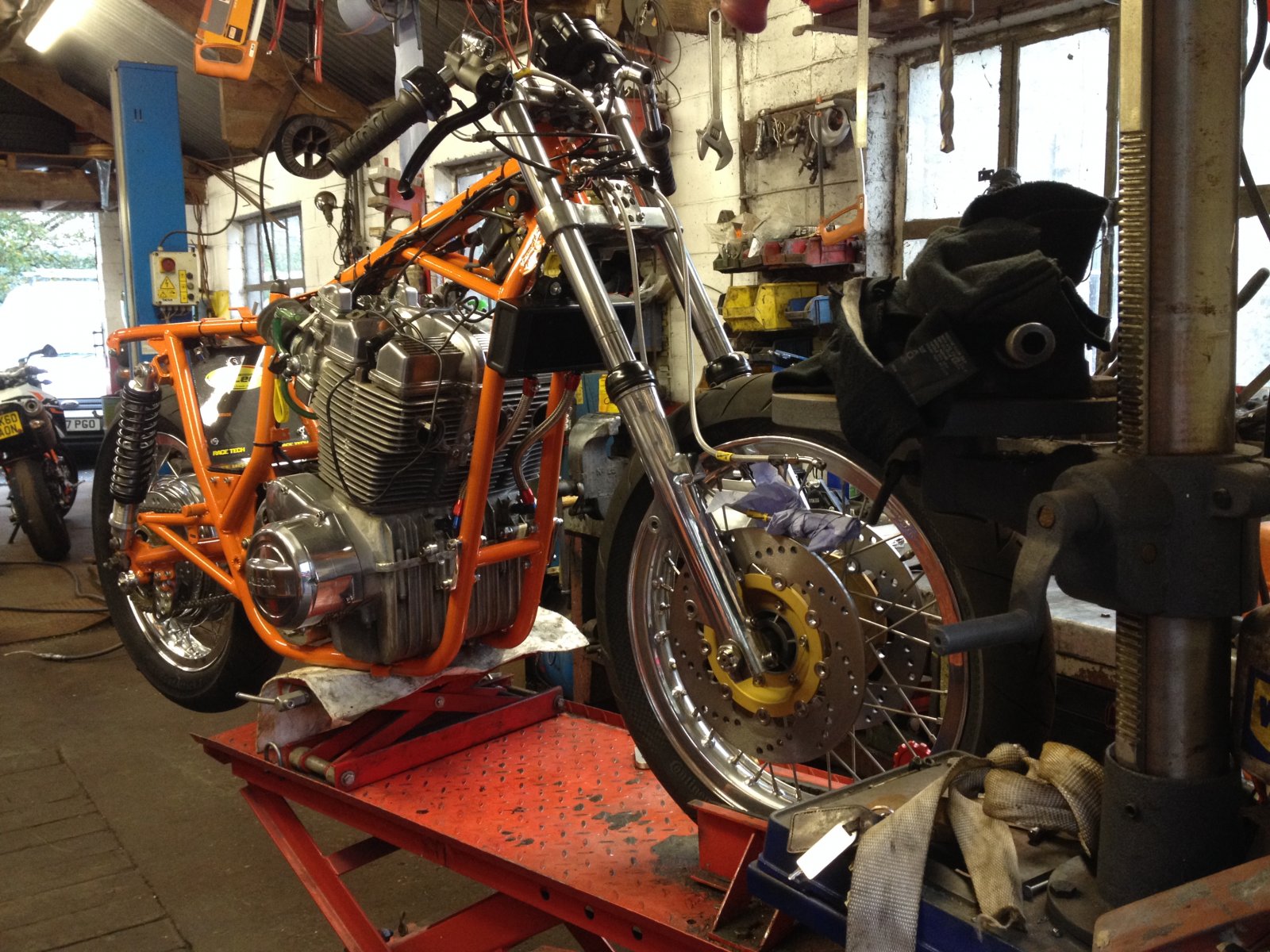

Update on my mates Jota , its been running but he found out it needed a rebore , so while it was in bits the frame got some treatment it looks even better in the flesh .
