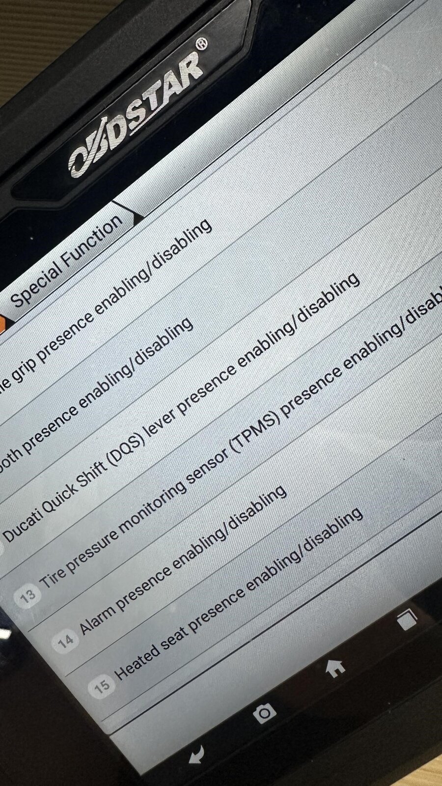

  1. Hi everyone, I own a Multistrada V4, and recently had it serviced. During a test ride yesterday, I noticed that the quick shift function suddenly stopped working. I checked and confirmed that the function was indeed shown as deactivated. The bike itself seemed fine. When I reactivated the quick shift function using the diagnostic tool, it enabled normally. Does anyone know what might cause this? I'm a bit worried there might be an underlying issue...

  5. Hi, yes, it was working initially, but suddenly stopped functioning during a ride. It might indeed be as you suggested — a software update issue. After I reactivated it using a diagnostic tool, it started working normally again.
