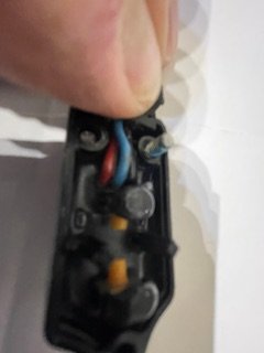

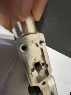

    I too have the very useful 42 tooth rear sprocket but that wasn't the problem. If you have a look inside the lever sensor it is rather simple - a couple of microswitches and a springloaded bar. I read somewhere on here of someone who repaired theirs by replacing the microswitches.
  4. That's interesting, if that's the case i can do a quick test and repair if necessary. I assumed that it was strain gauges and something more complicated
  5. So did I. I'd heard of a Hall Effect switch and thought it might be something like that, but it isn't.The little yellow pins operate the microswitches and are triggered by the metal pin in the second picture.
