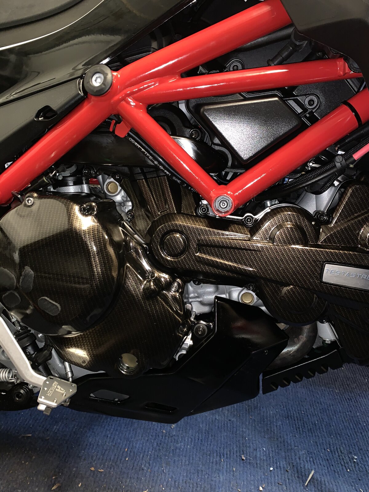

  4. Added a picture to show the bolts
    Had this dipped two years ago when it was on my previous DVT and shows some rubbing. About to replace with a new one. Has totally protected the clutch housing
  5. they look mint!
