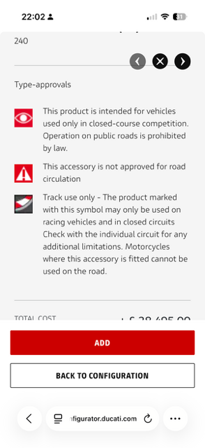

  4. It depends on the bike and what’s being added, whether ‘silencers’ or a full system. I just did a quick check on the configurator, looked at a Hypermotard V2 (the subject of this thread), a Panigale V4 and a Multi Pikes Peak. They all have silencer options which have homologation in various places, eg EU, California, Japan, Australia, but all the ‘full systems’ have this attached to them, including the ubiquitous ‘full’ Akrapovic for the Pikes Peak such as you used to have I believe.
