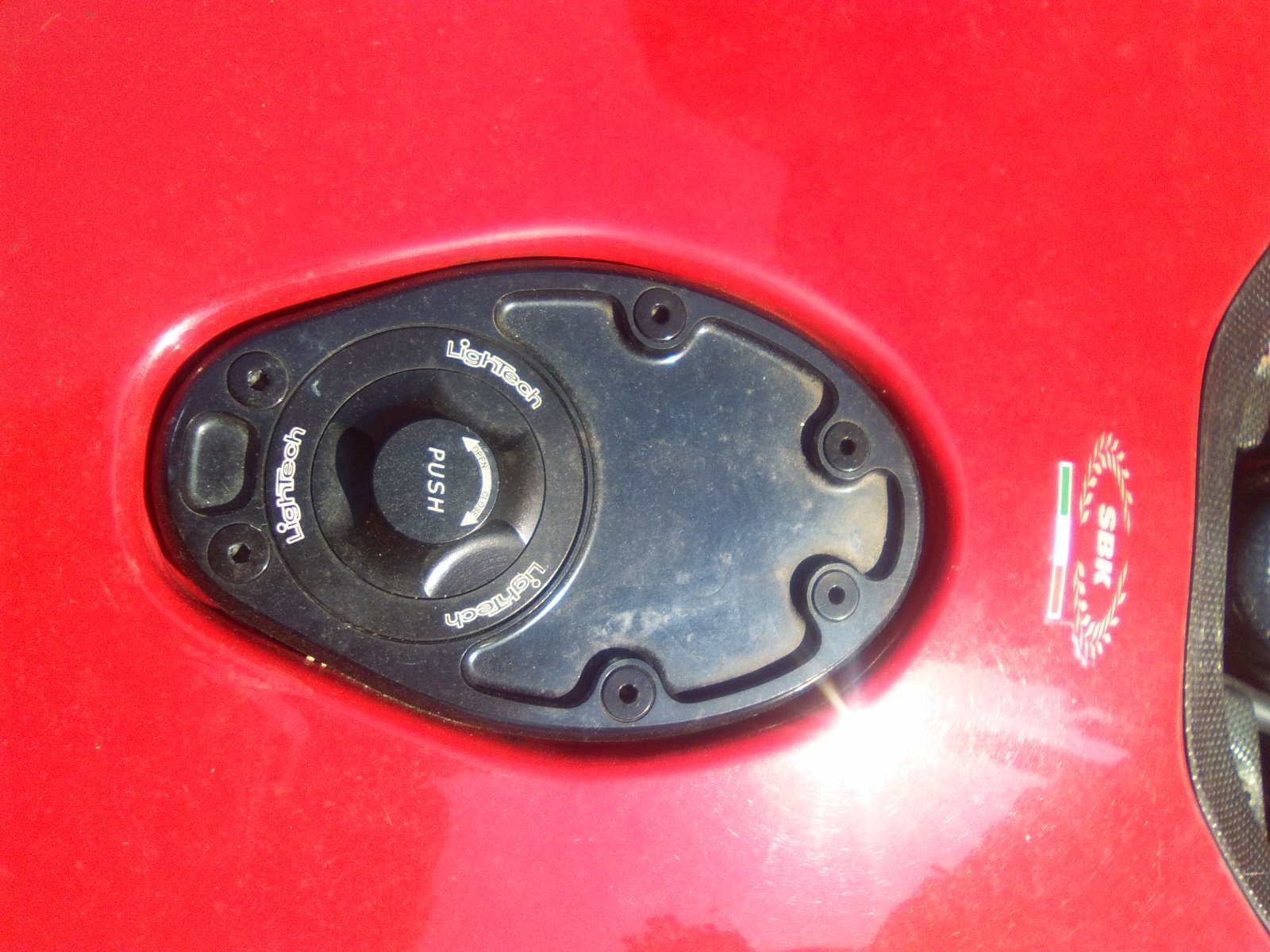

  19. These Lightech units IMG_20170407_151824.jpg don't leak, are lightweight and look good when clean
