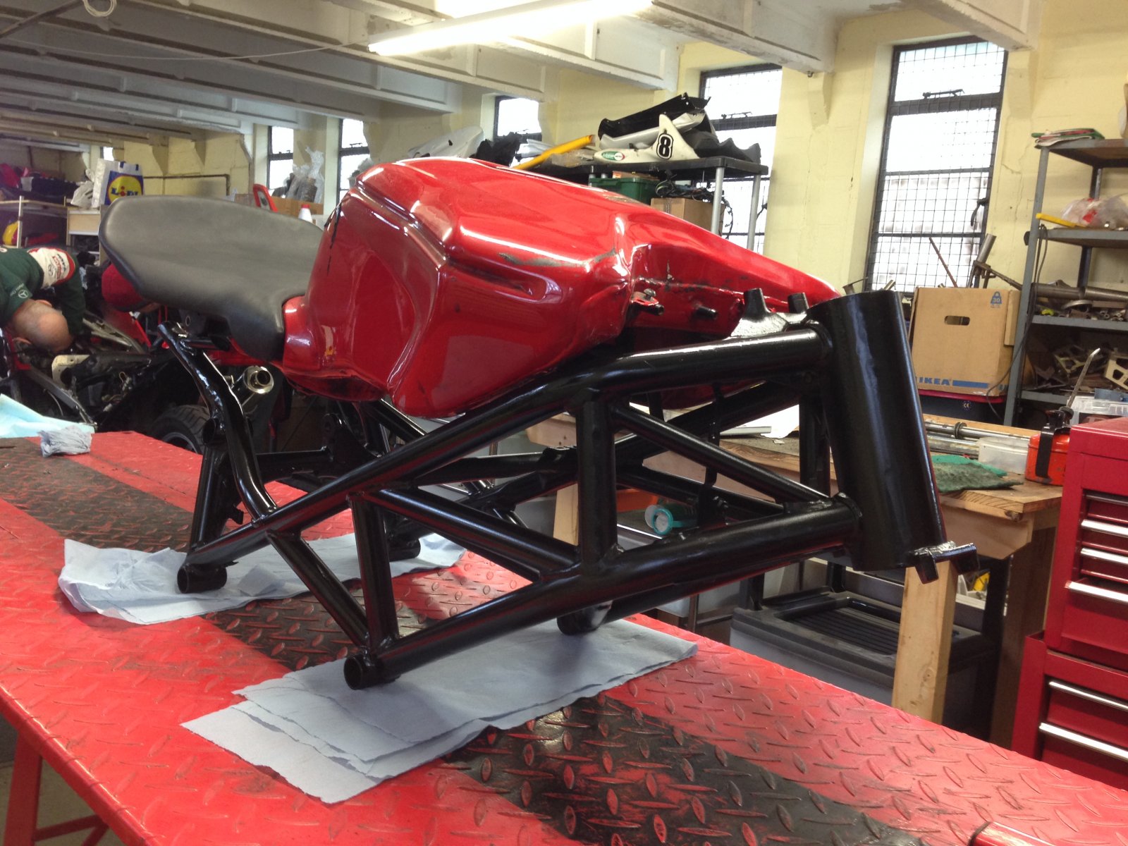

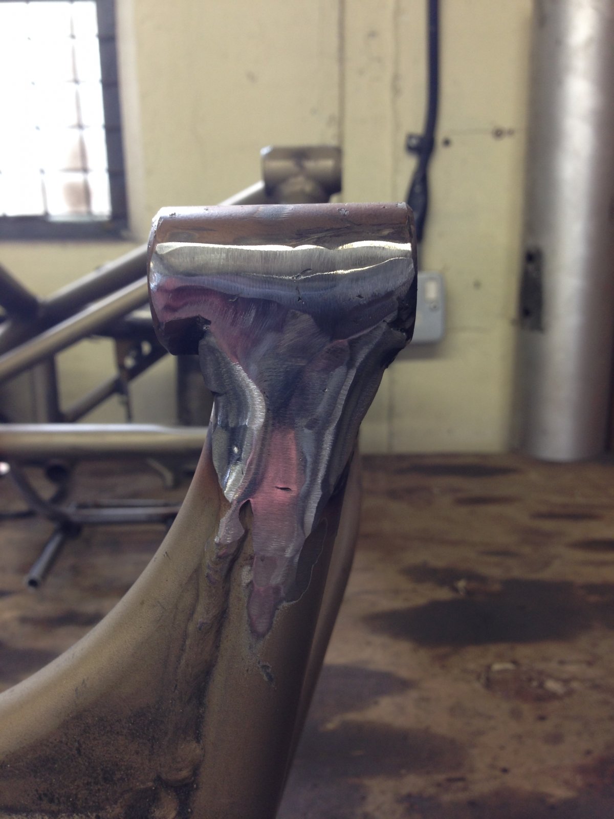

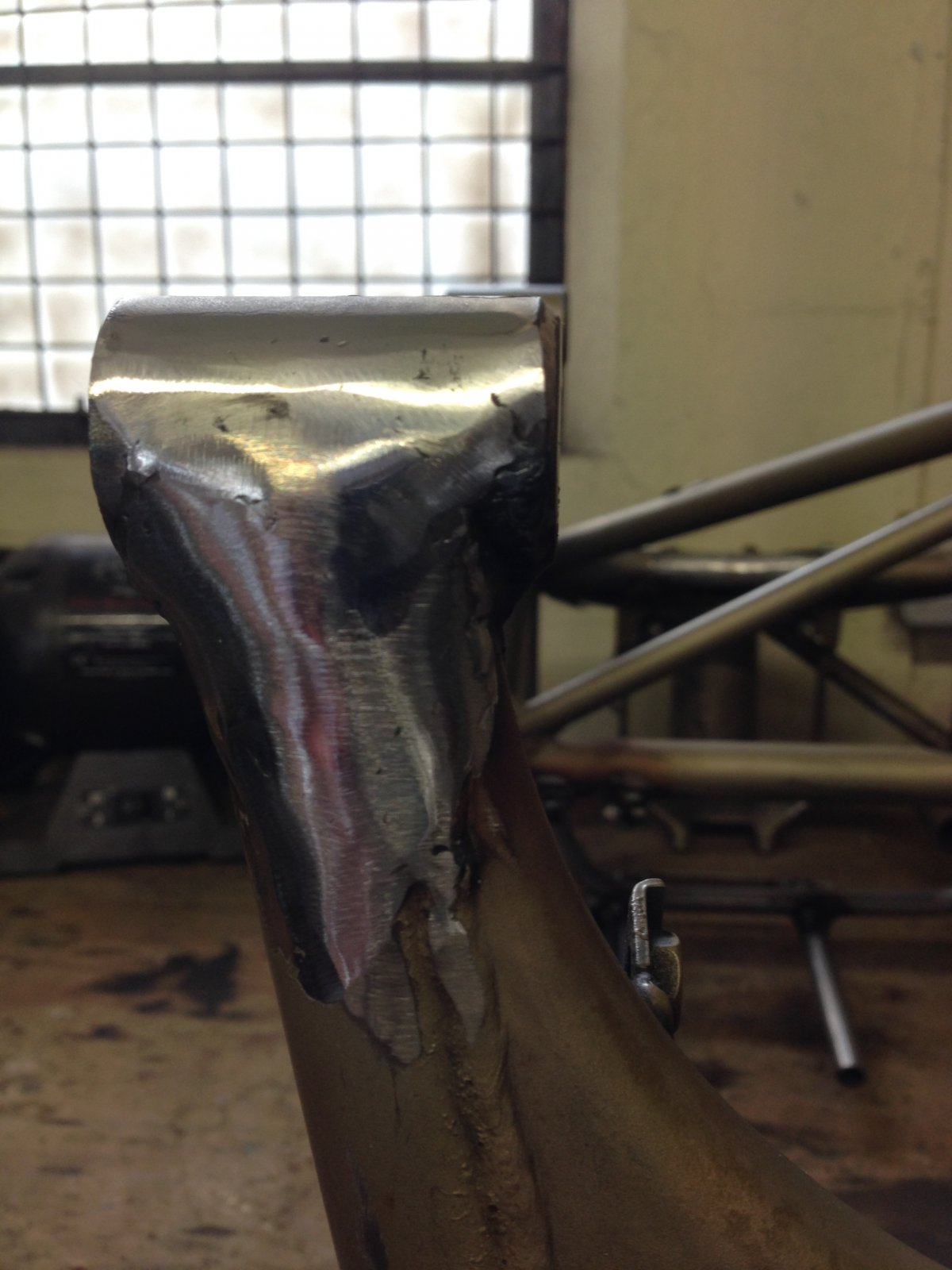

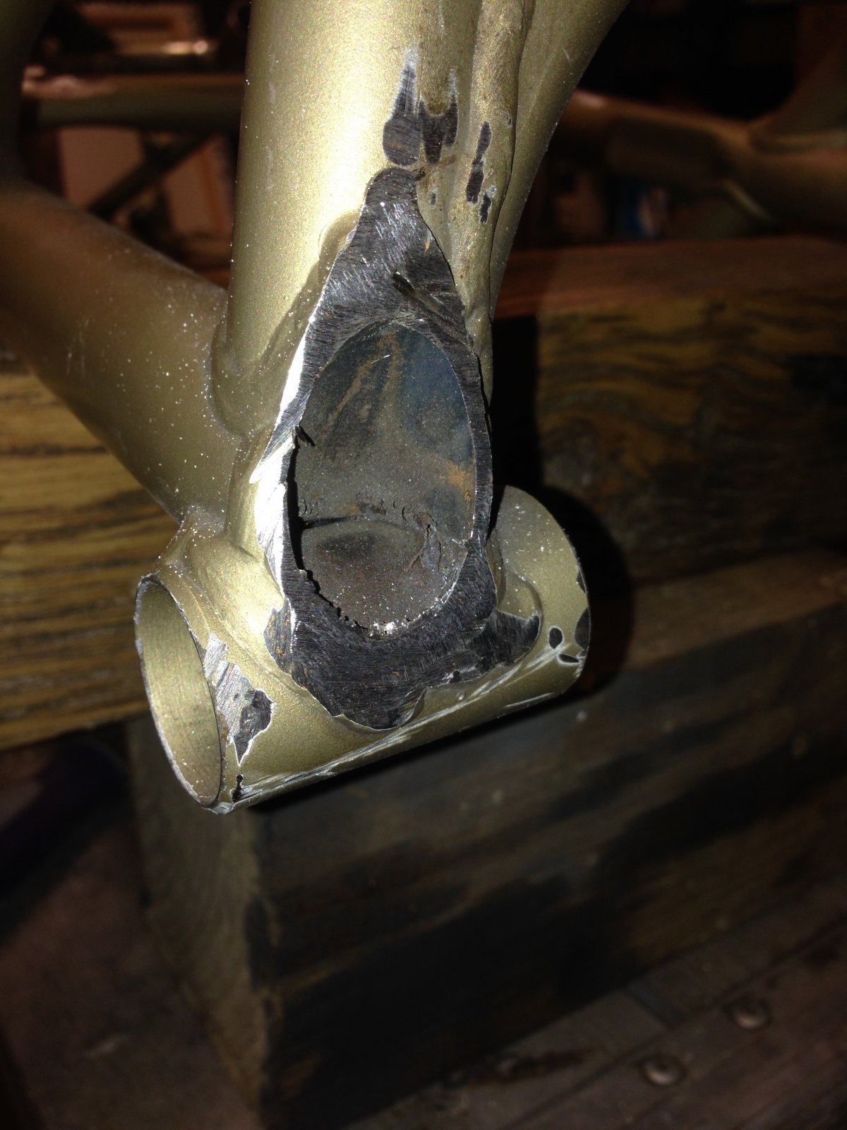

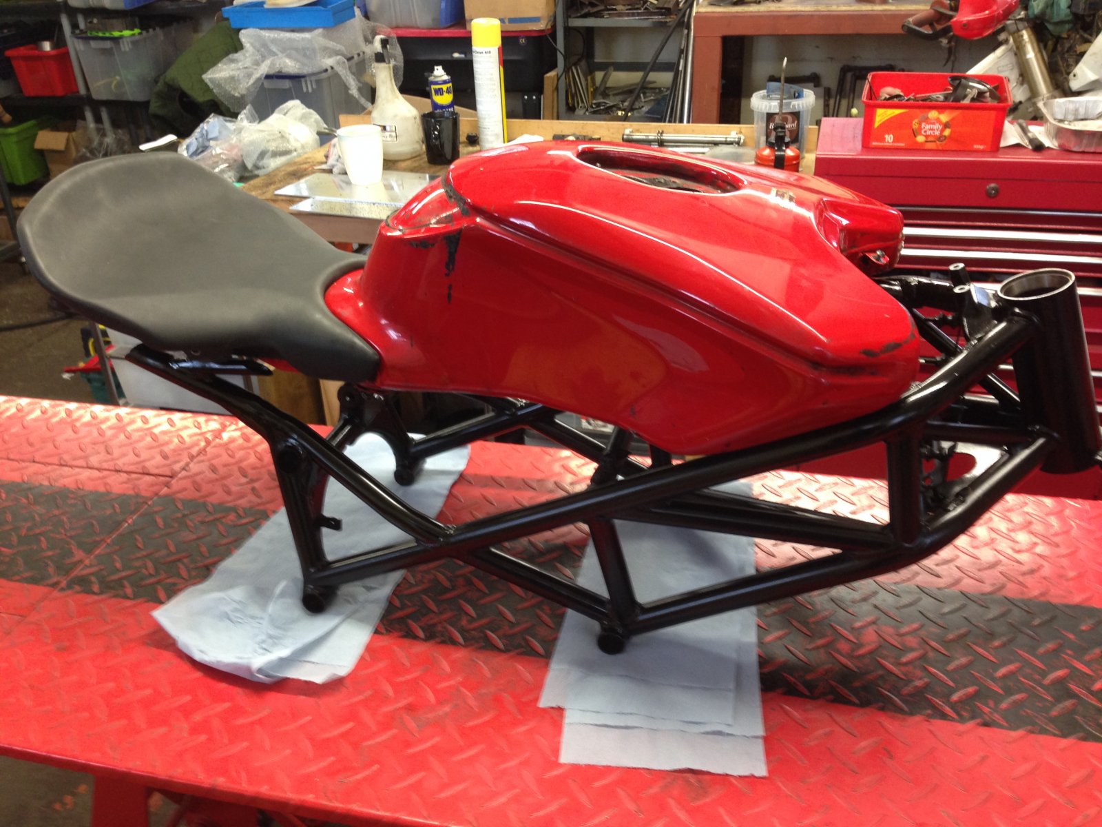

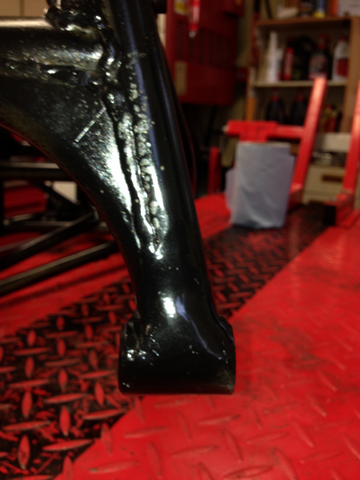

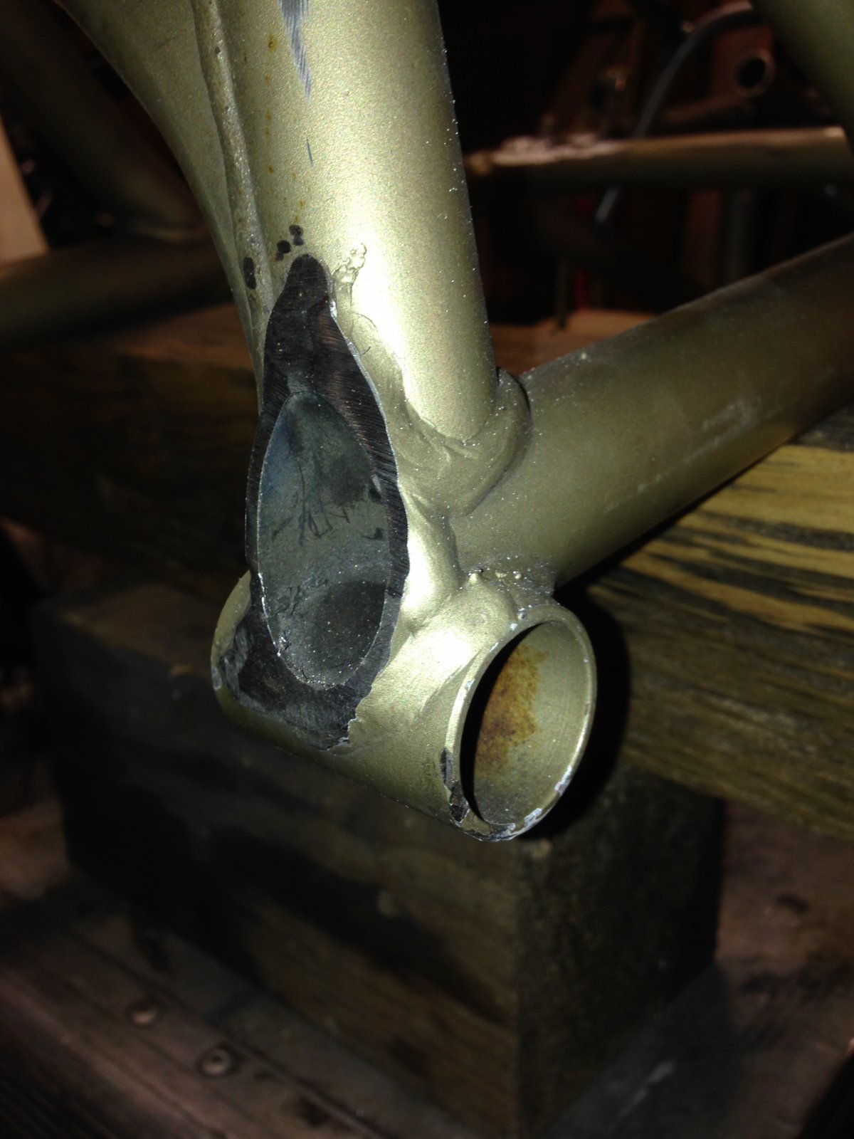

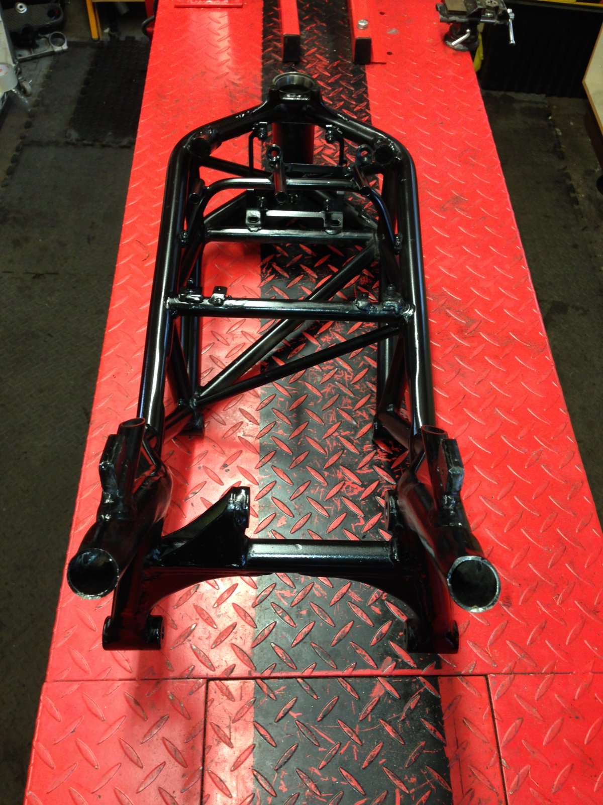

  3. Things have been a bit slow over the winter, I've not spent as much time as I would have liked moving things along, but here are some pictures and updates of what's been happening...mainly been getting the frame finished which involves quite a bit of metal work.
    I've settled on a way of terminating these frame tubes now, using Marks suggestions to fill and work back, so here are some pics pre and post fill

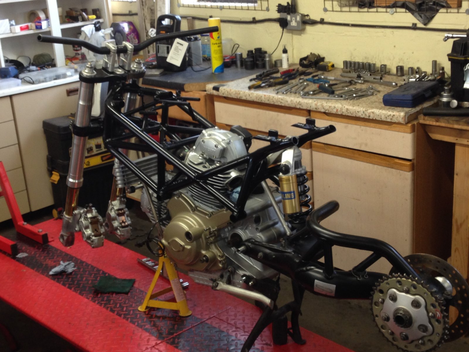

  4. Here's the next step...

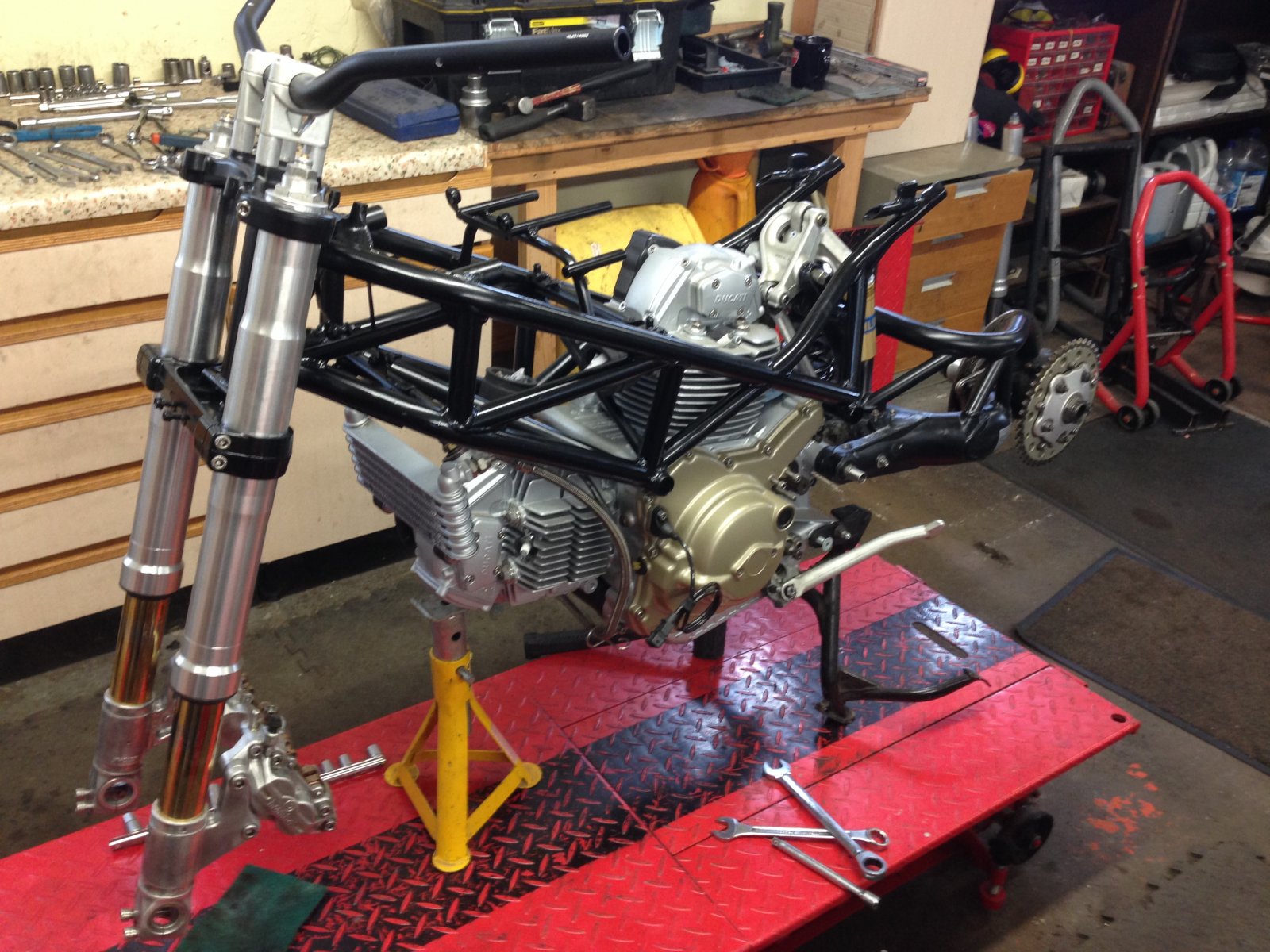

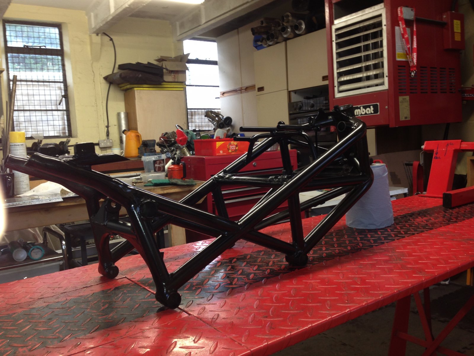

  5. I've slapped a coat of paint on the frame to see what it looks like in gloss black, eventually i'll get it soda blasted and poweder-coated but these pics give a good idea...

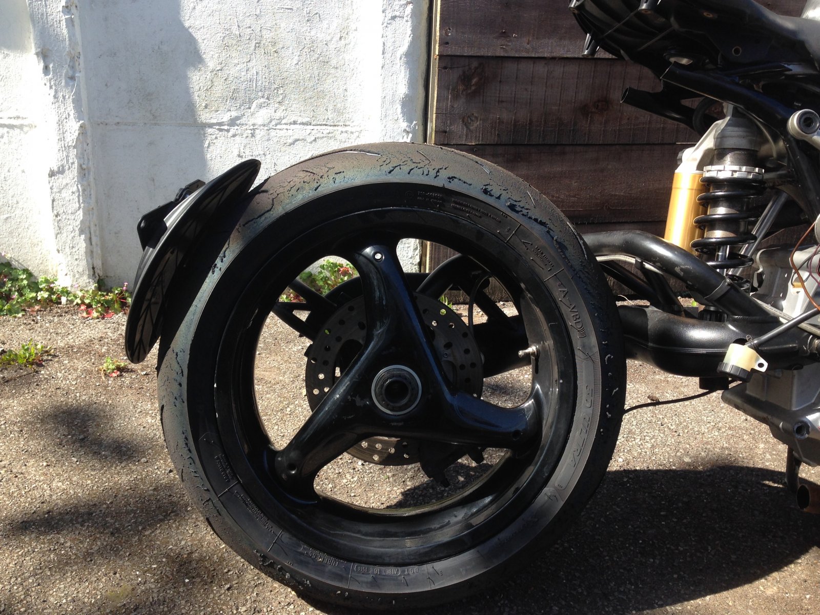

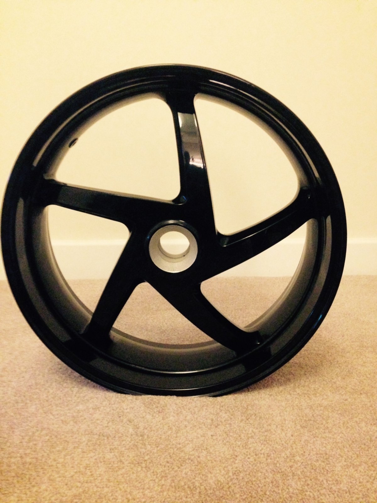

  6. I've had the wheels soda blasted and powder coated...
  7. I've also bought an Ohlins rear shock from a 996 and sent it off to Reactive suspension to be rebuilt. Just be warned if you're doing something similar that the damping (shim stack) is different from the s4r so this has cost more to rebuild then expected.
    I also told them that I'd lopped about 10 kgs off the back end as this needs to be taken in to account.
    Next step is the wiring loom/harness, the mini frame you can see on top of the frame is the new wiring mount, another of Marks genius solutions to hide as much wiring as possible. Reason this is offset is to follow the line of the recess under the 749 tank to maximise the working space under there. I bought a speedcell battery which is a lithium jobbie from USA, super small and light, only weight 700 grams instead of the usual 5000g!
    I was trying to rush and get each part up to the painted stage but have since learnt its far better to fabricate everything and put it together before going to paint. Save time and money further down the line. I'll post some more pics when i have them.

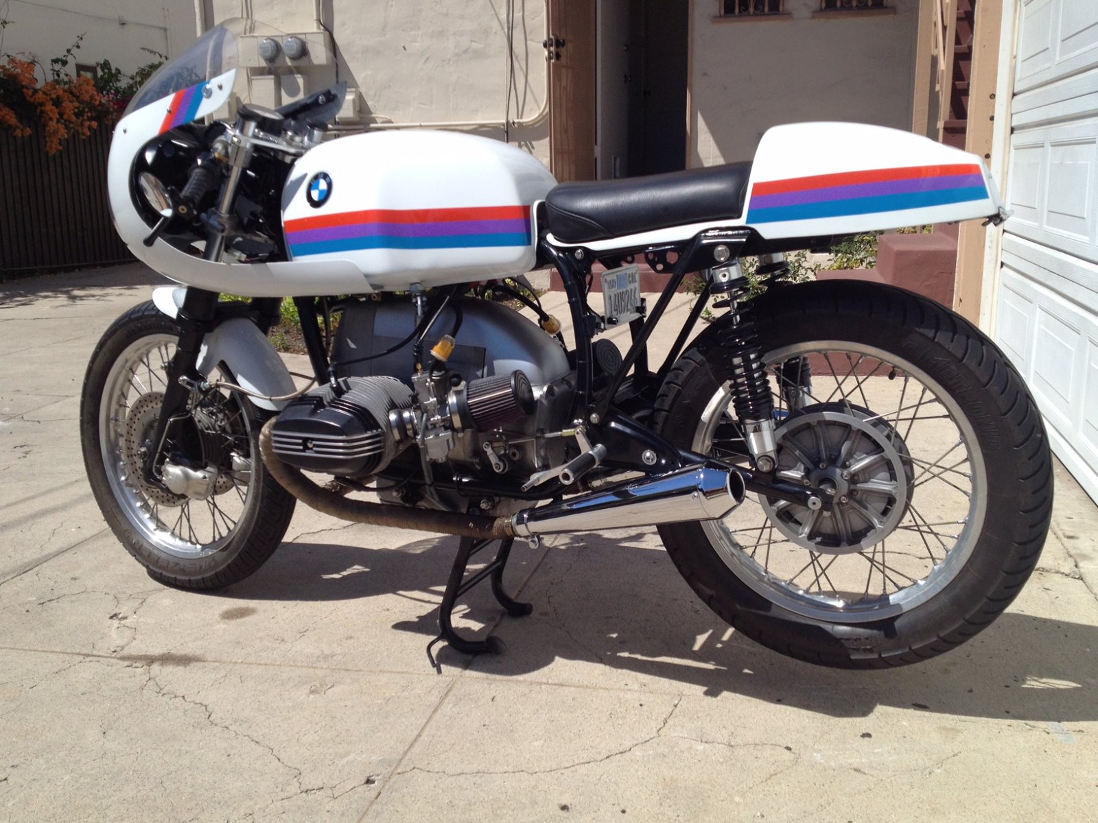

  10. Amen:) I finished up my first build last year (1978 BMW R100s - with 70's BMW motorsport CSL colors), which took me about 3 years (3x the time planned!) so I've run the gauntlet once. I'm hoping I can take my learning experience and make this second build a bit more sophisticated.

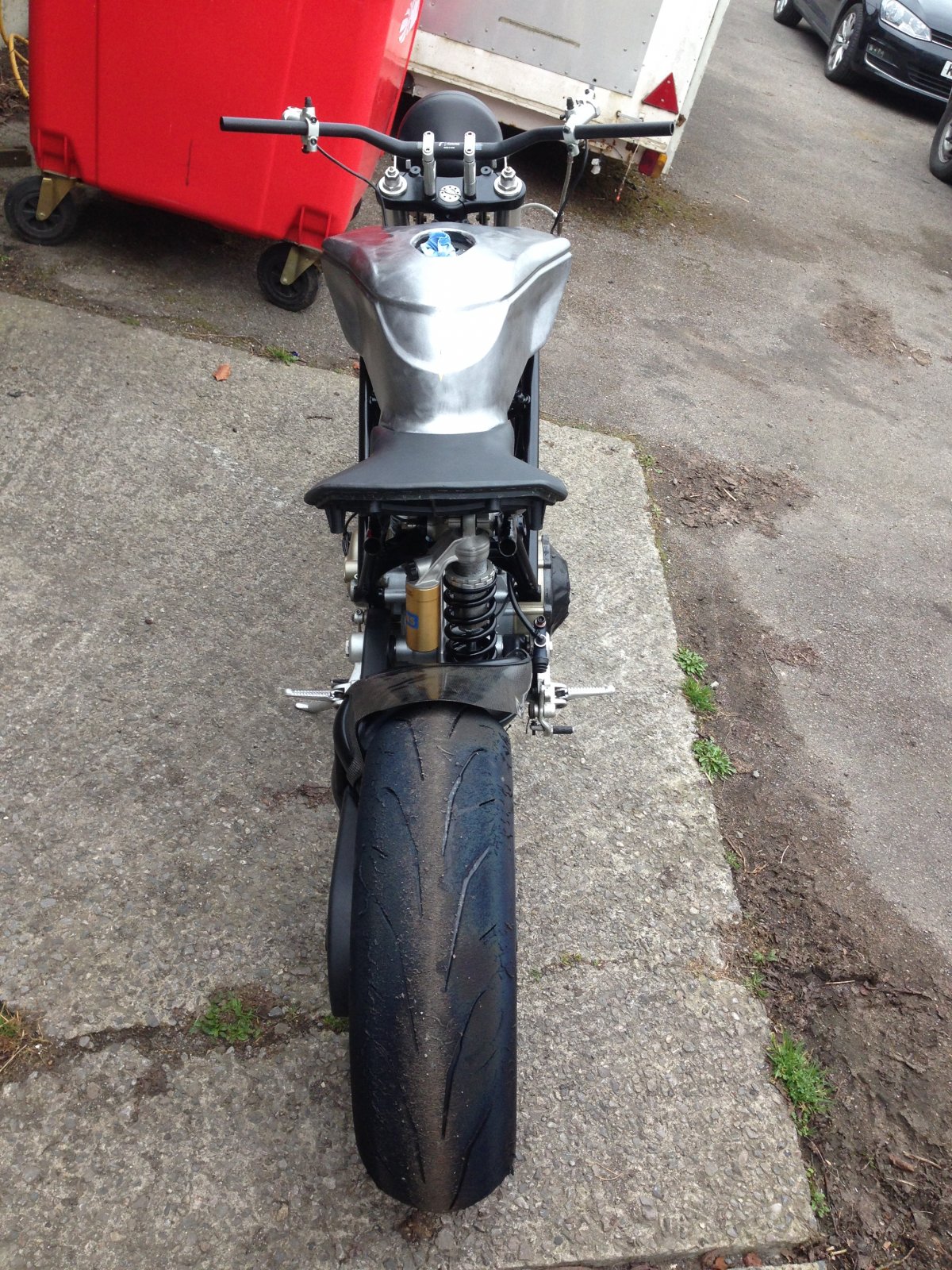

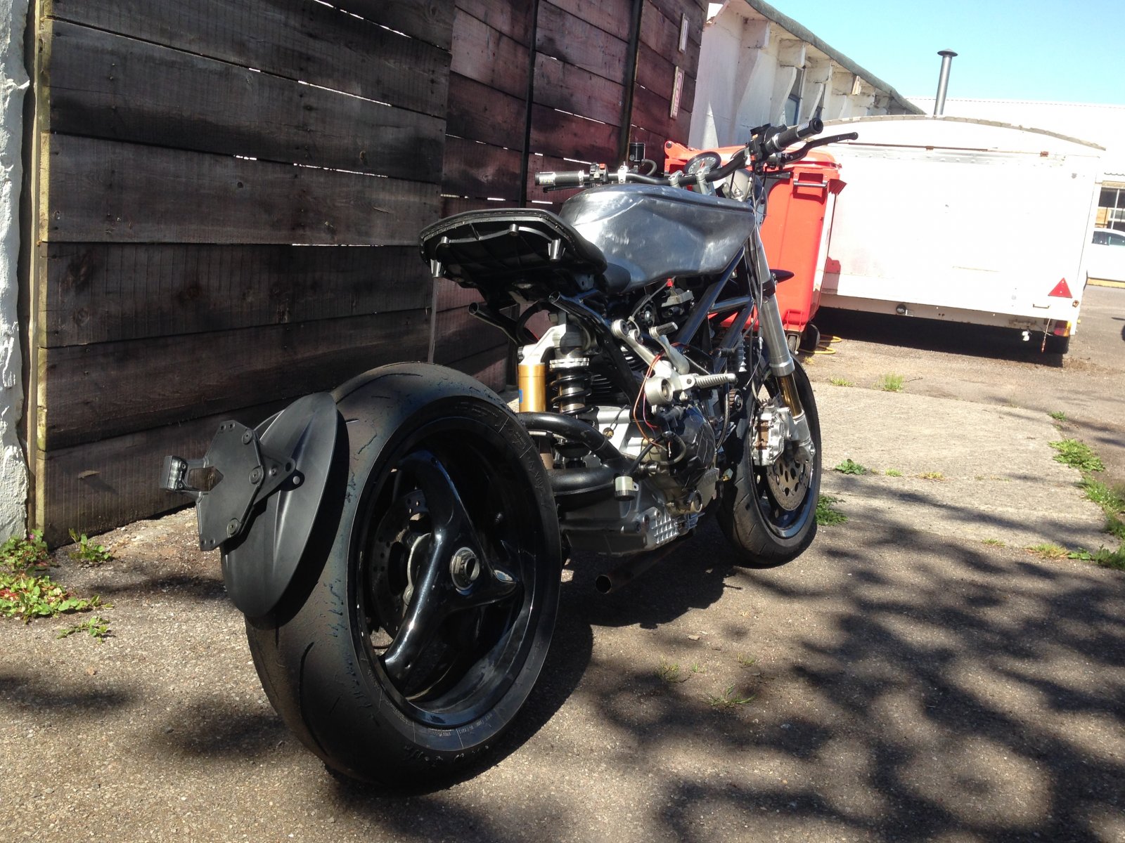

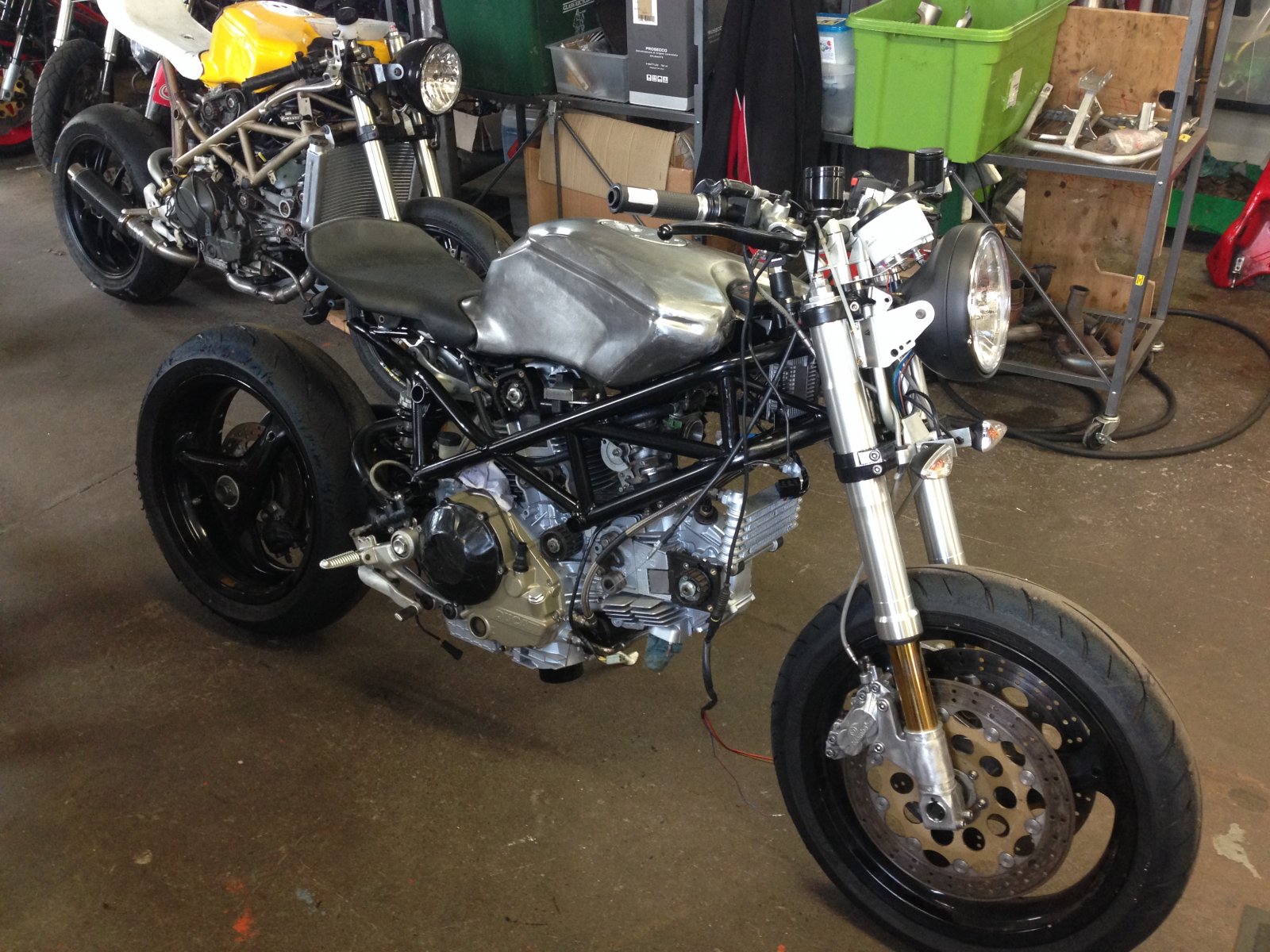

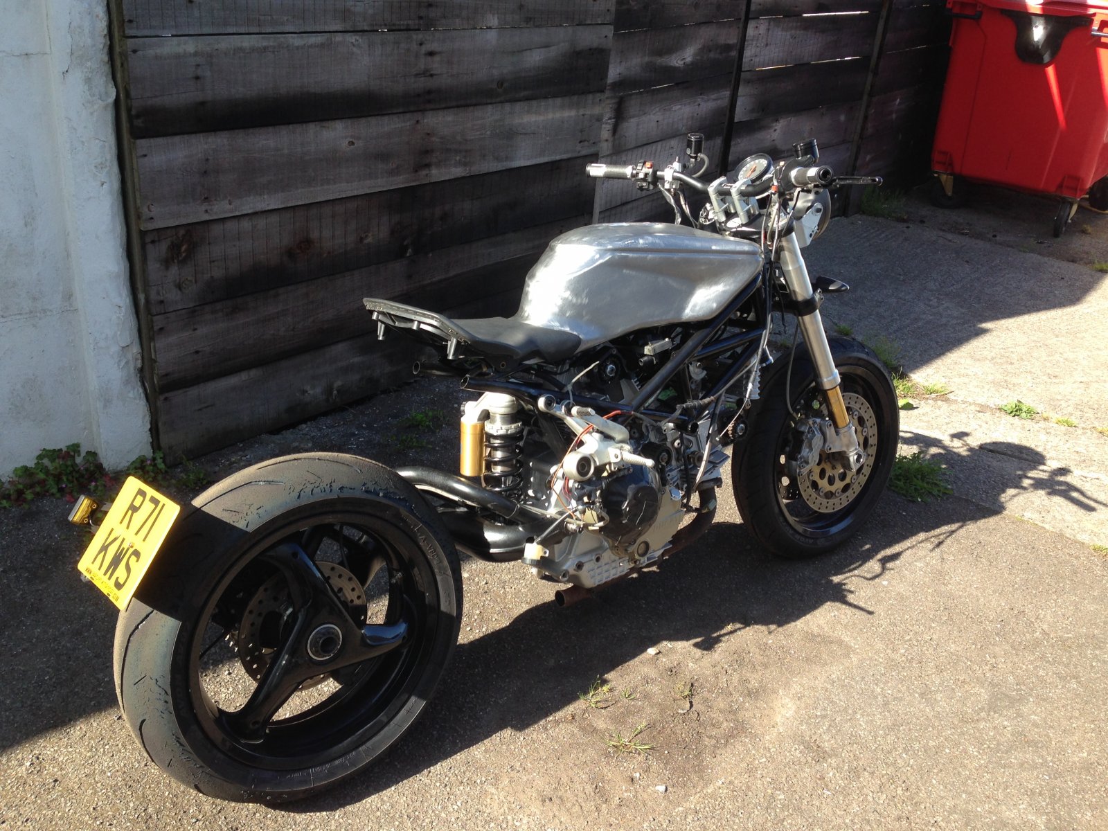

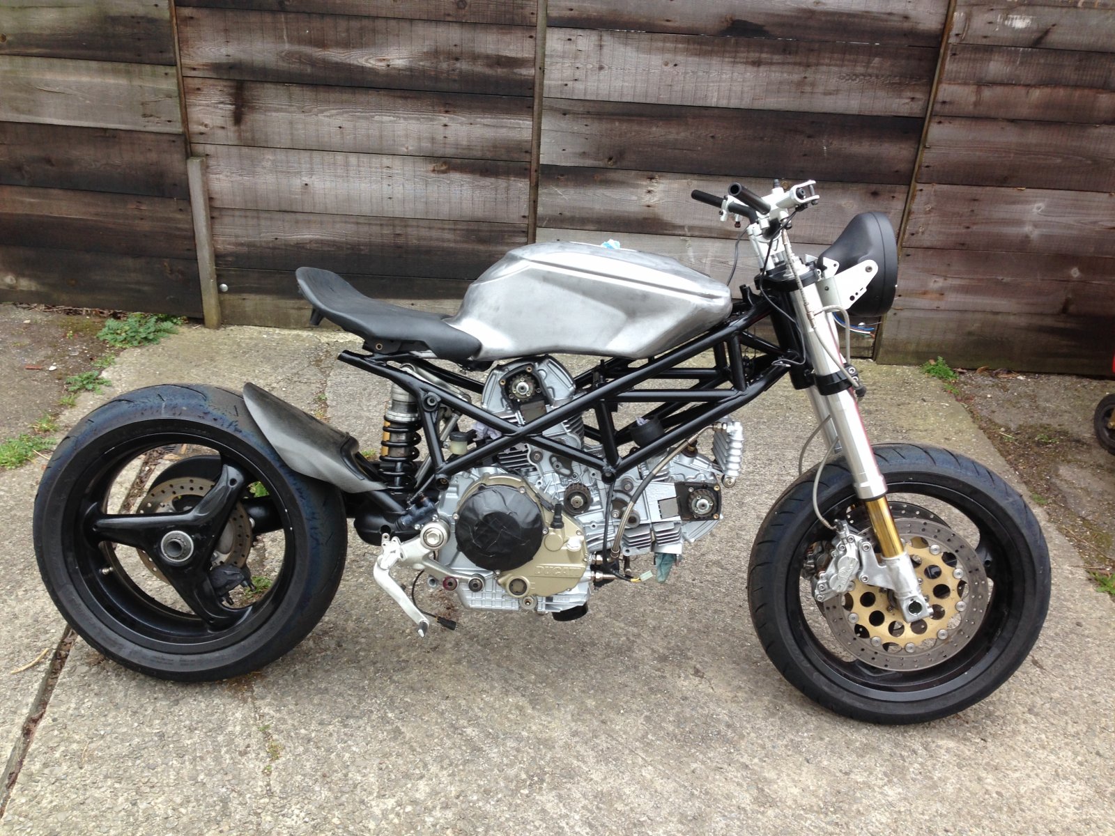

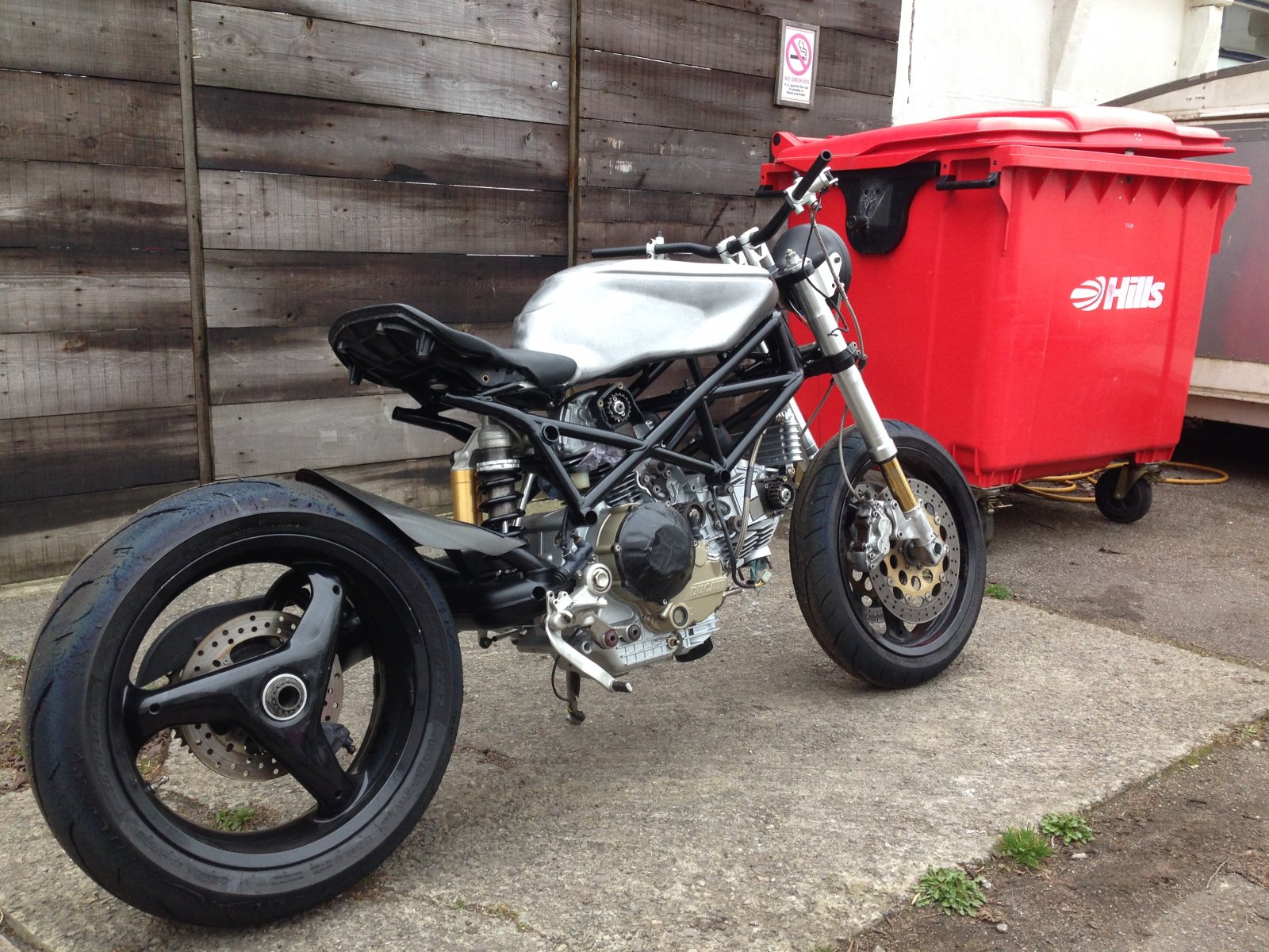

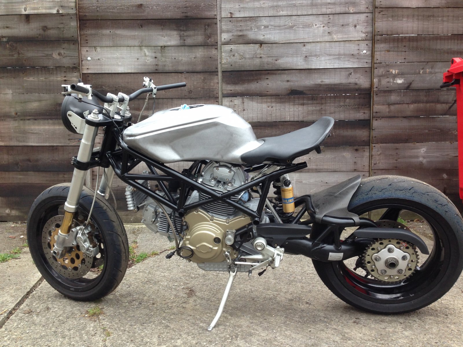

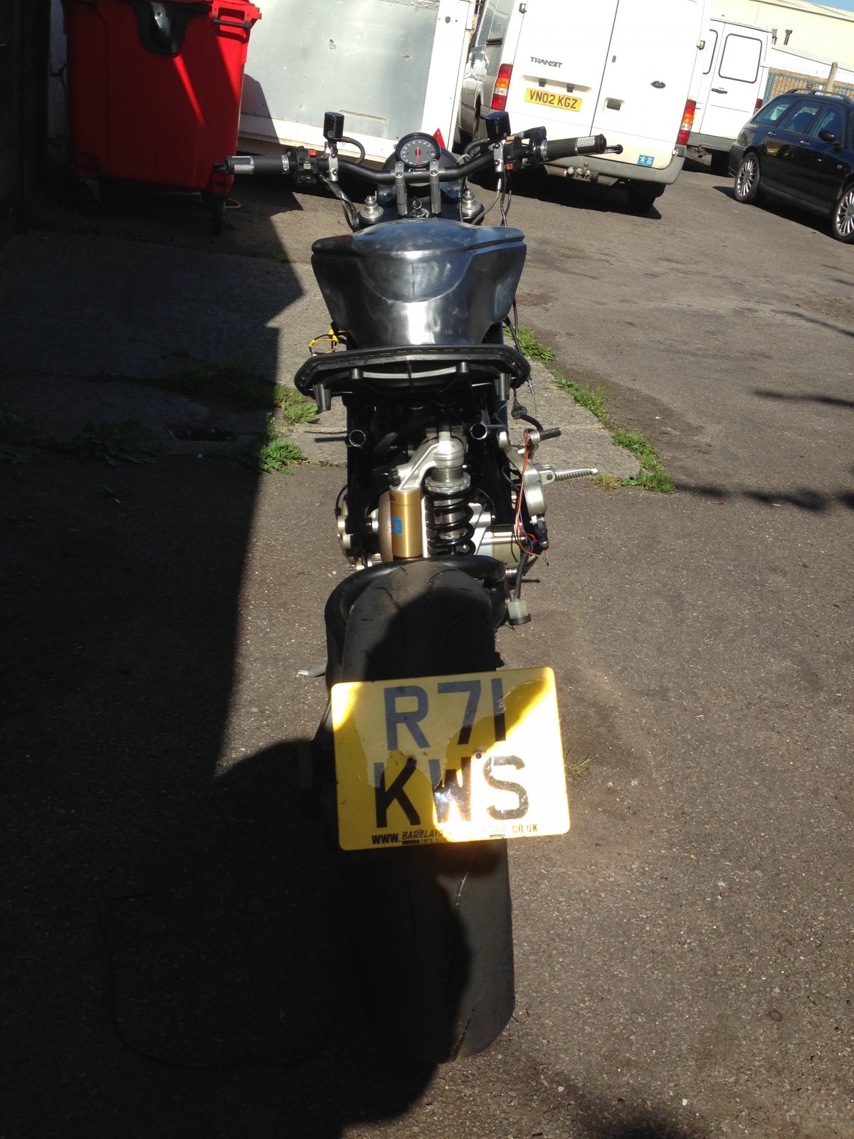

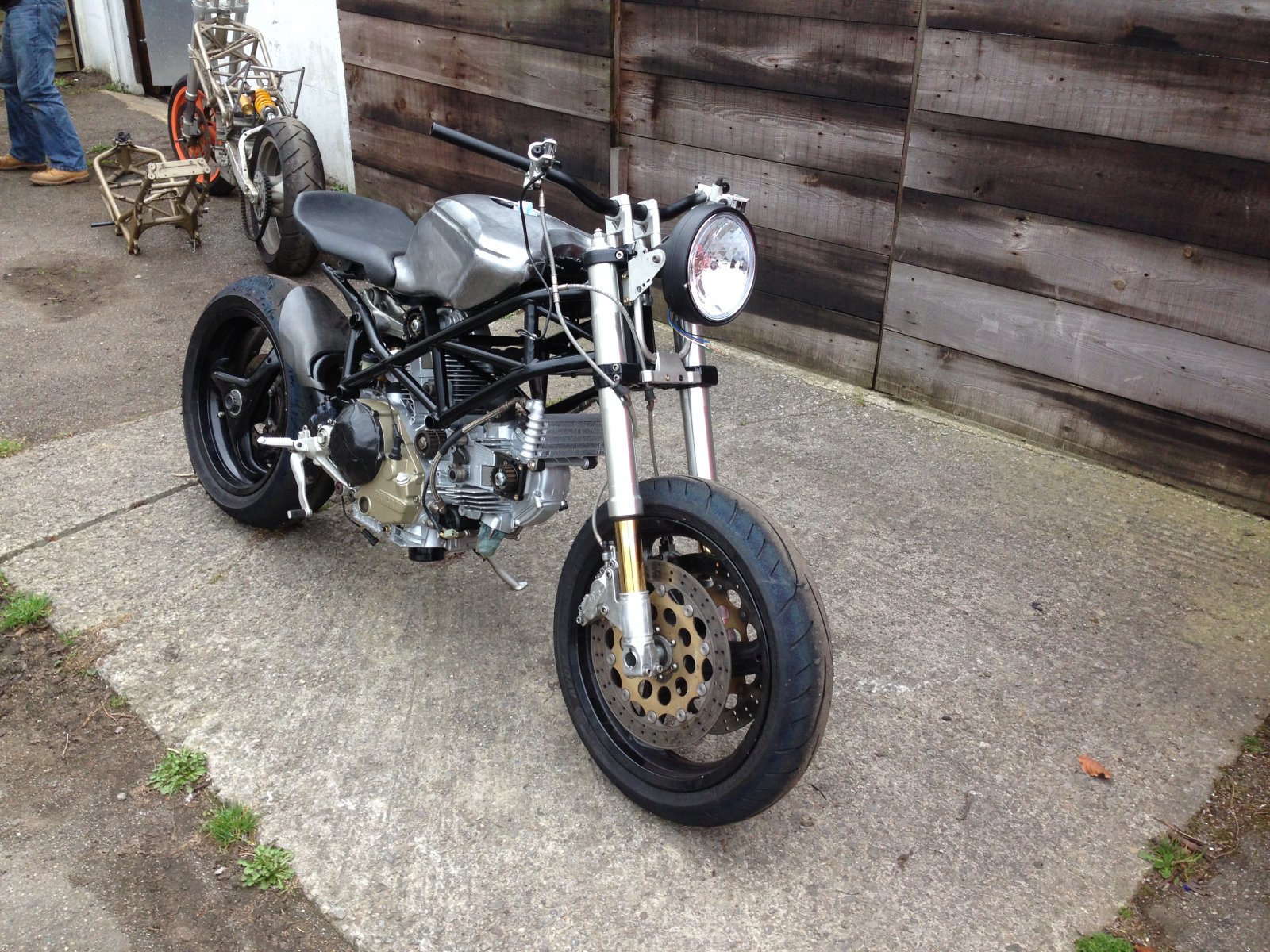

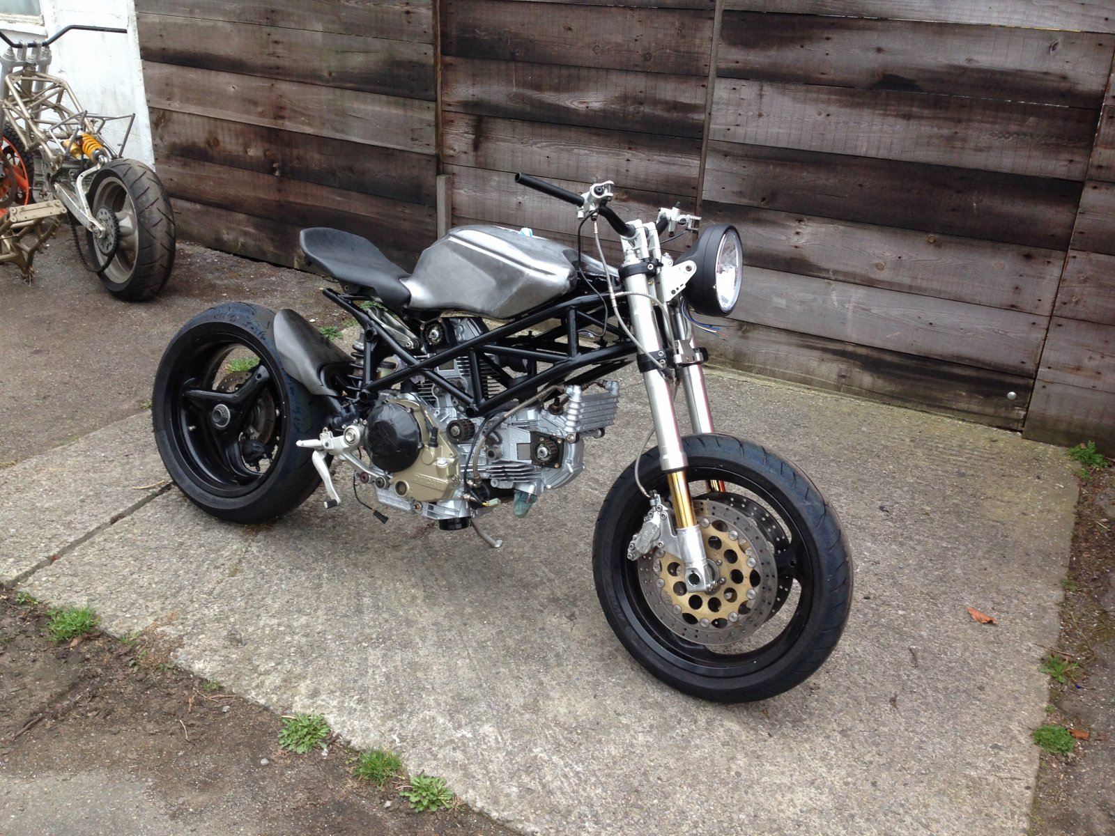

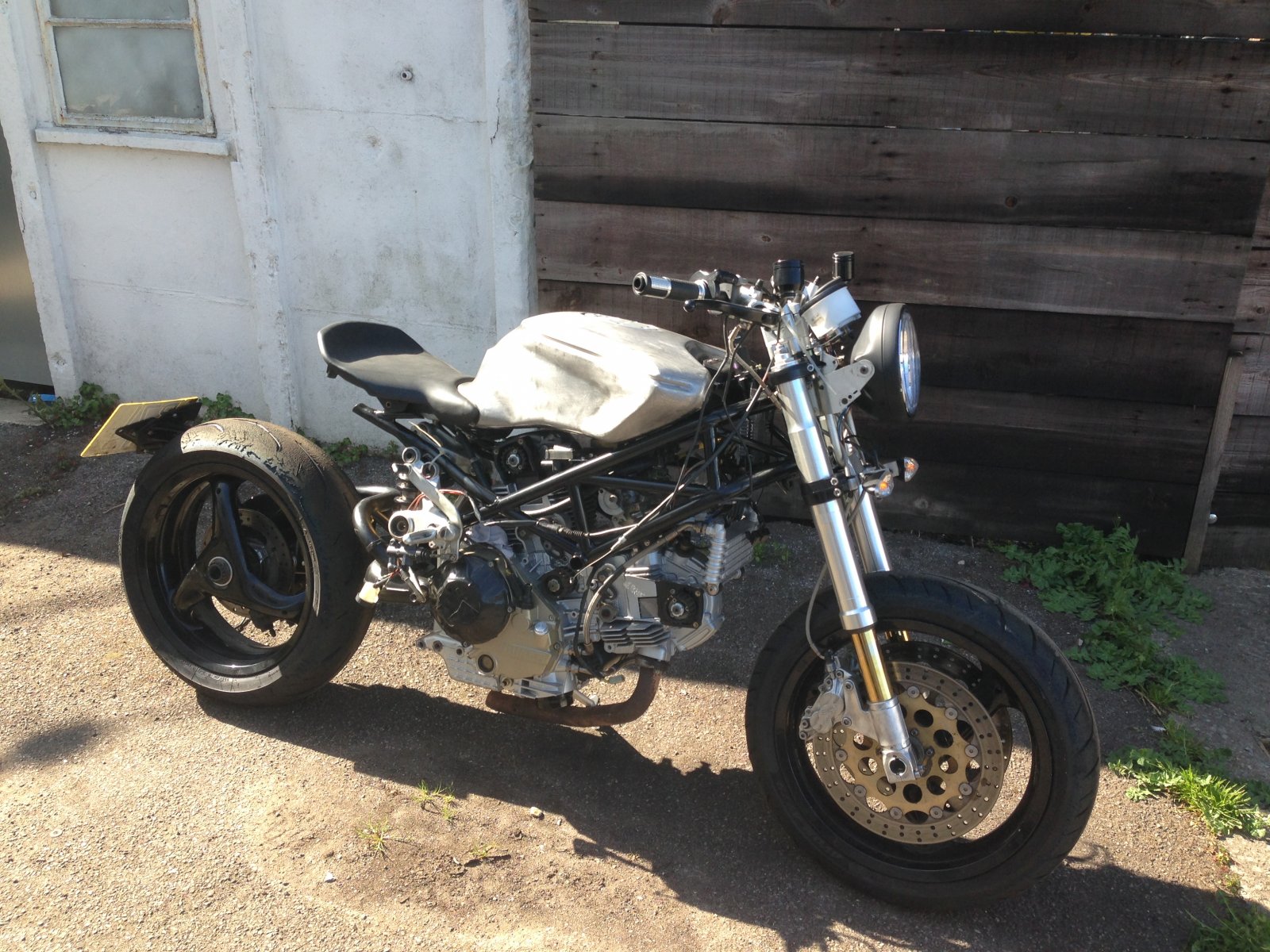

  11. Hi all, got the first proper dry build underway on saturday, not finished yet but finally getting to see what she looks like all built up...
  12. Looking good bud! Nice to meet you on Saturday too :)
  13. nice

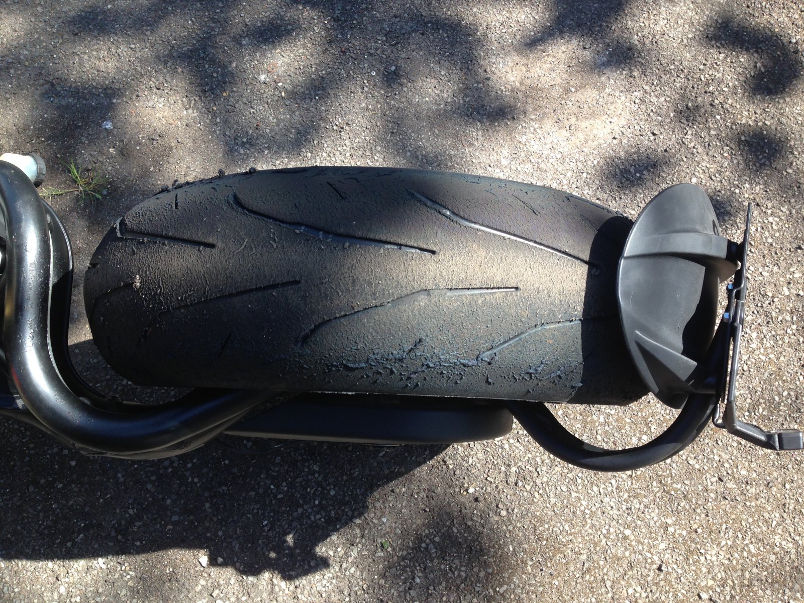

    get the rear tyre on the right way round ;)
  14. You can run these Avons both ways, this is an instructors wheel from Castle Coombe...

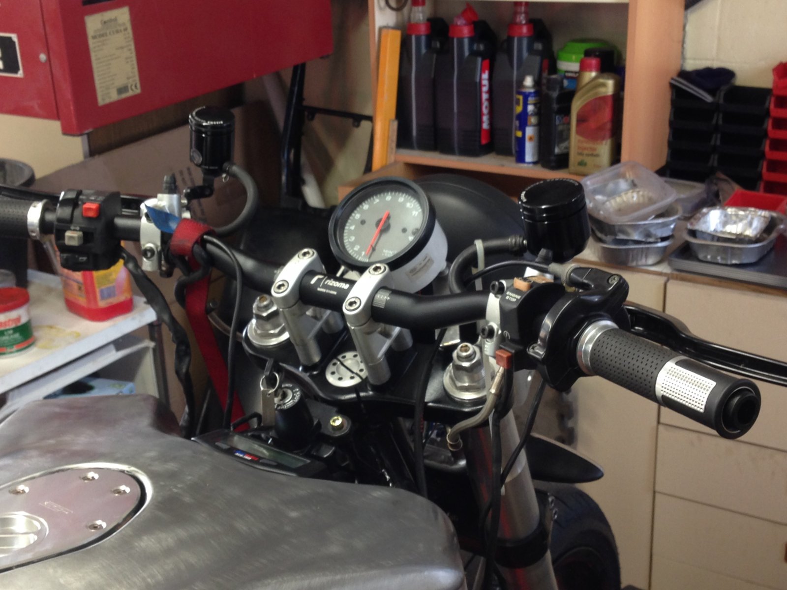

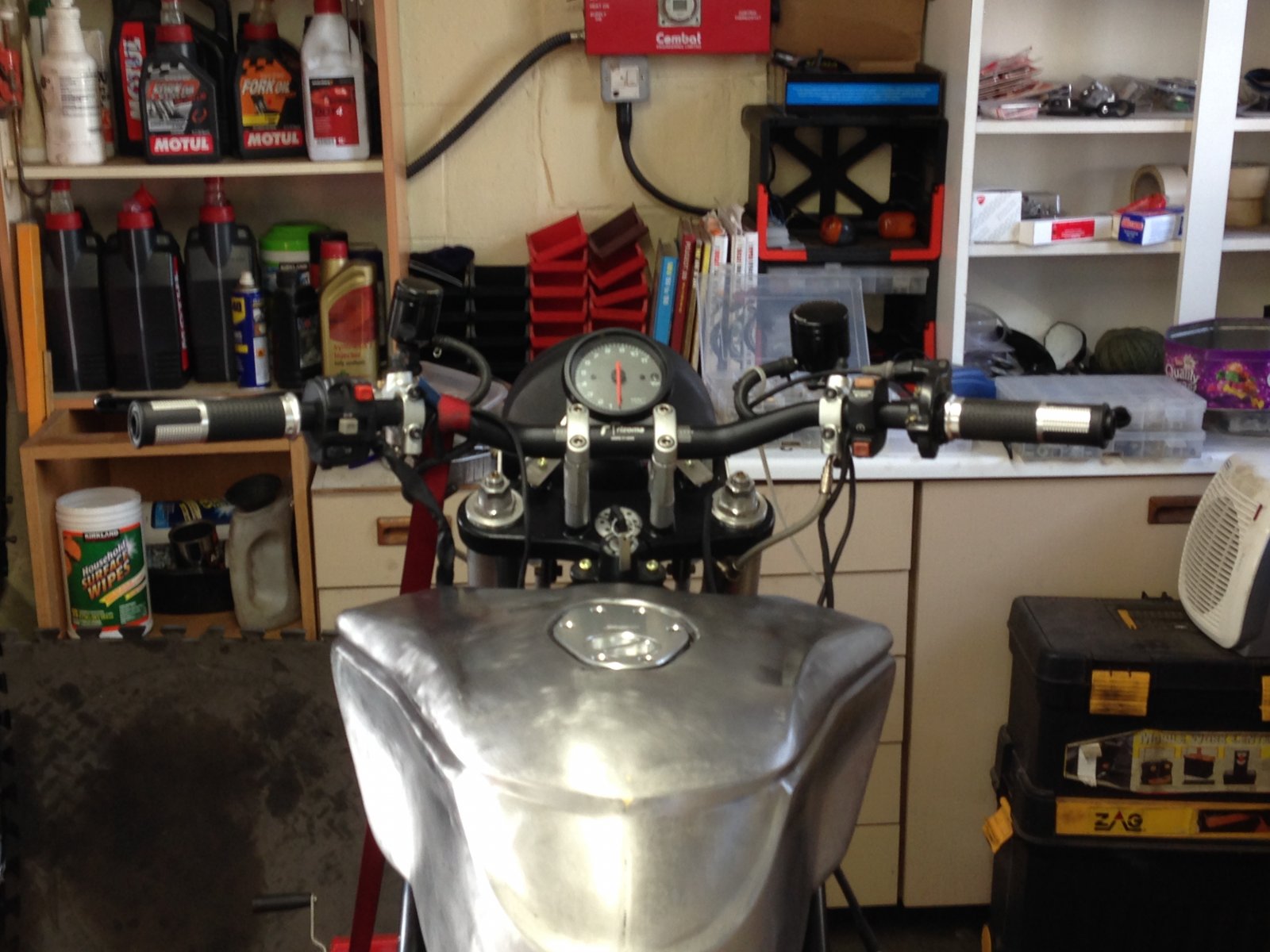

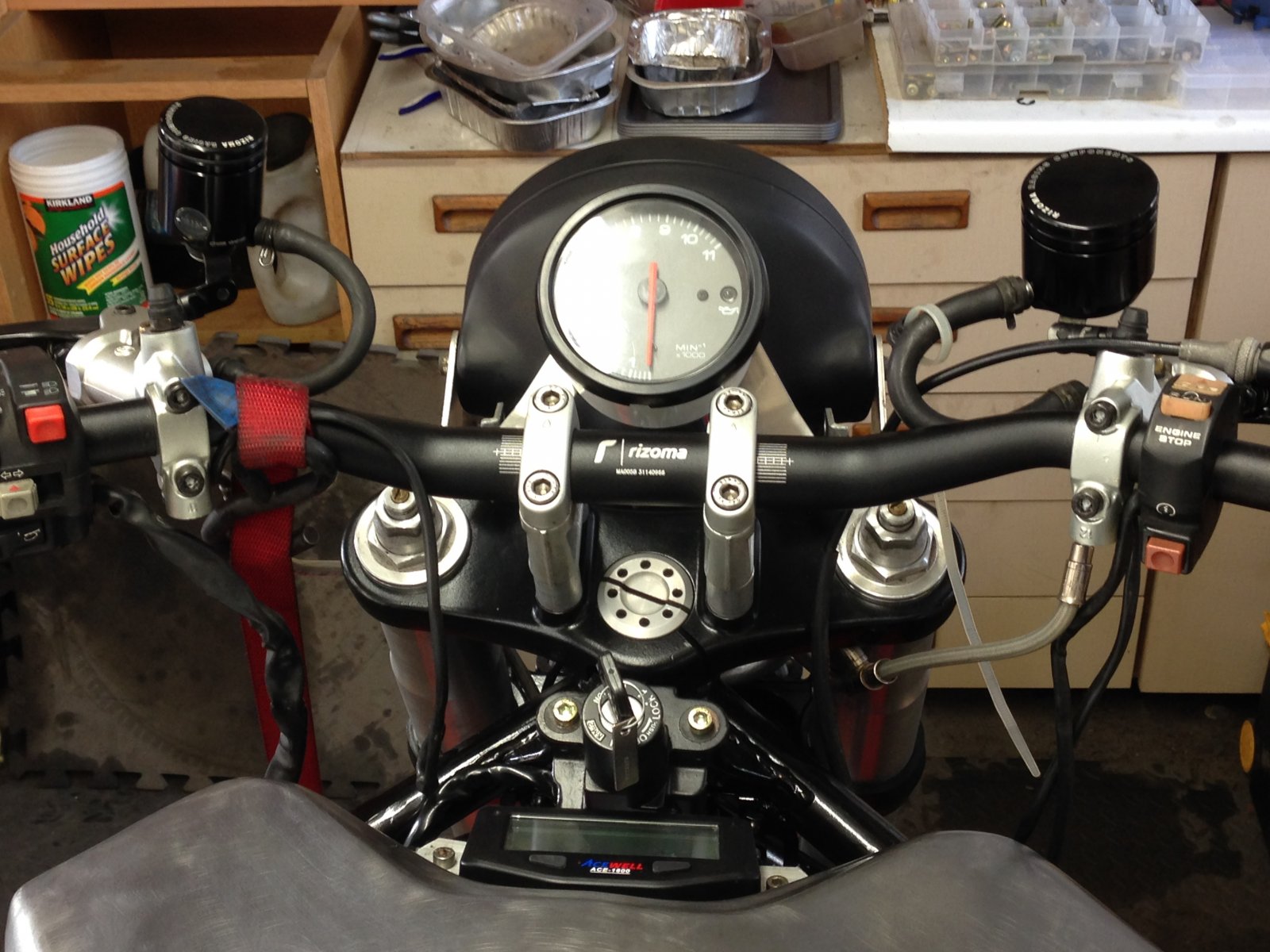

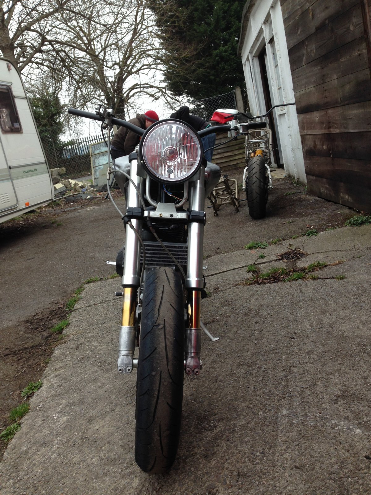

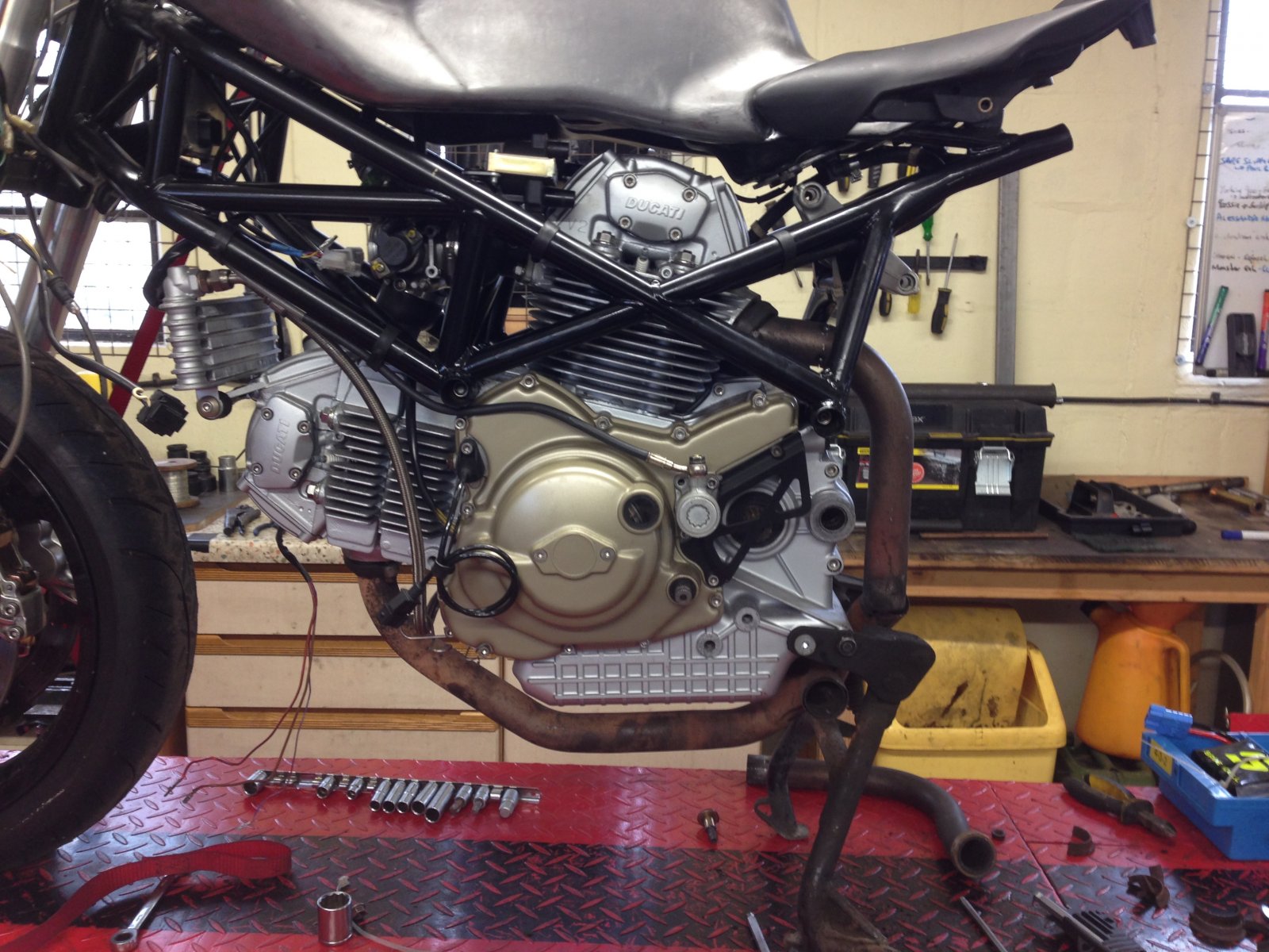

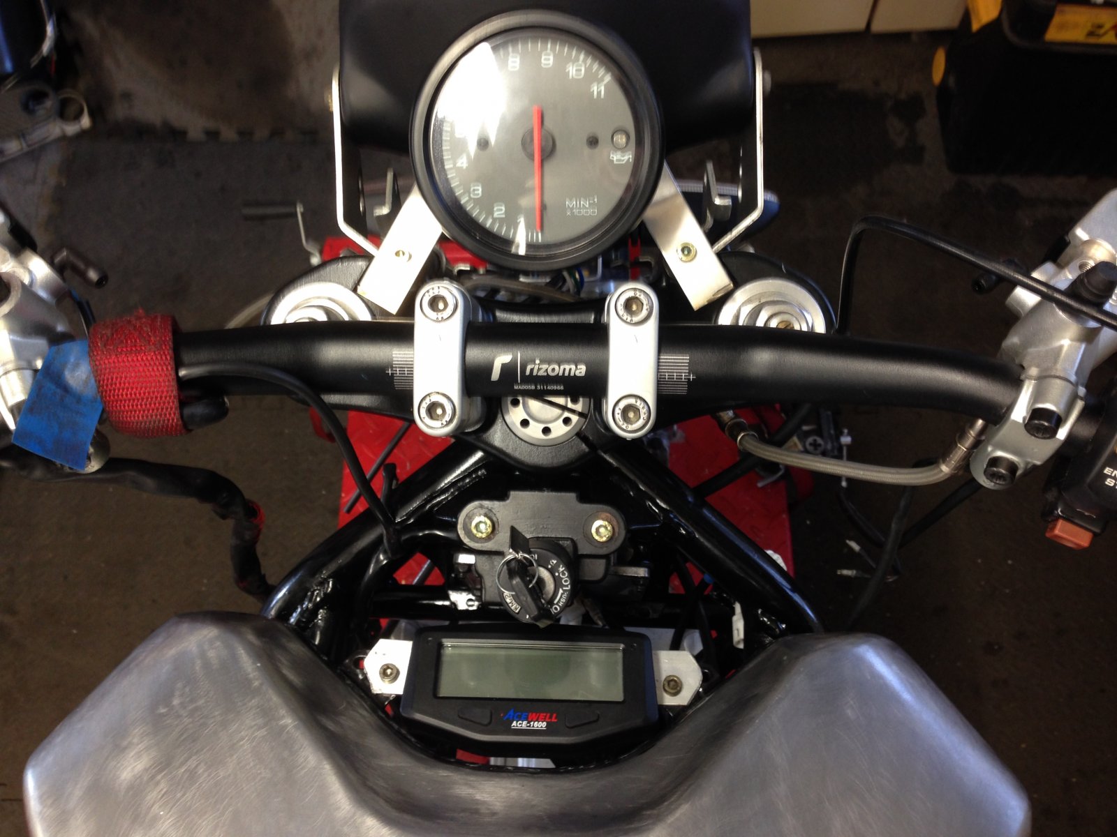

  15. More progress yesterday, still dry build stage, got the following jobs knocked off yesterday
    Brake & Clutch systems built
    Hand controls attached, grips, throttle, switchgear, fluid bottles etc
    Front indicators, speedo, rev counter mounted
    Fuel system built
    All the brackets are pretty rough, just wanted to find the position for these bits before i spend the time making nice brackets up and make sure i have all the bits. Lots of tweaking still to do....next week i'll be looking at the exhaust and wiring.
  16. few pics

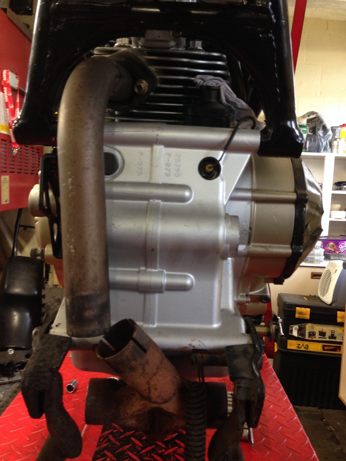

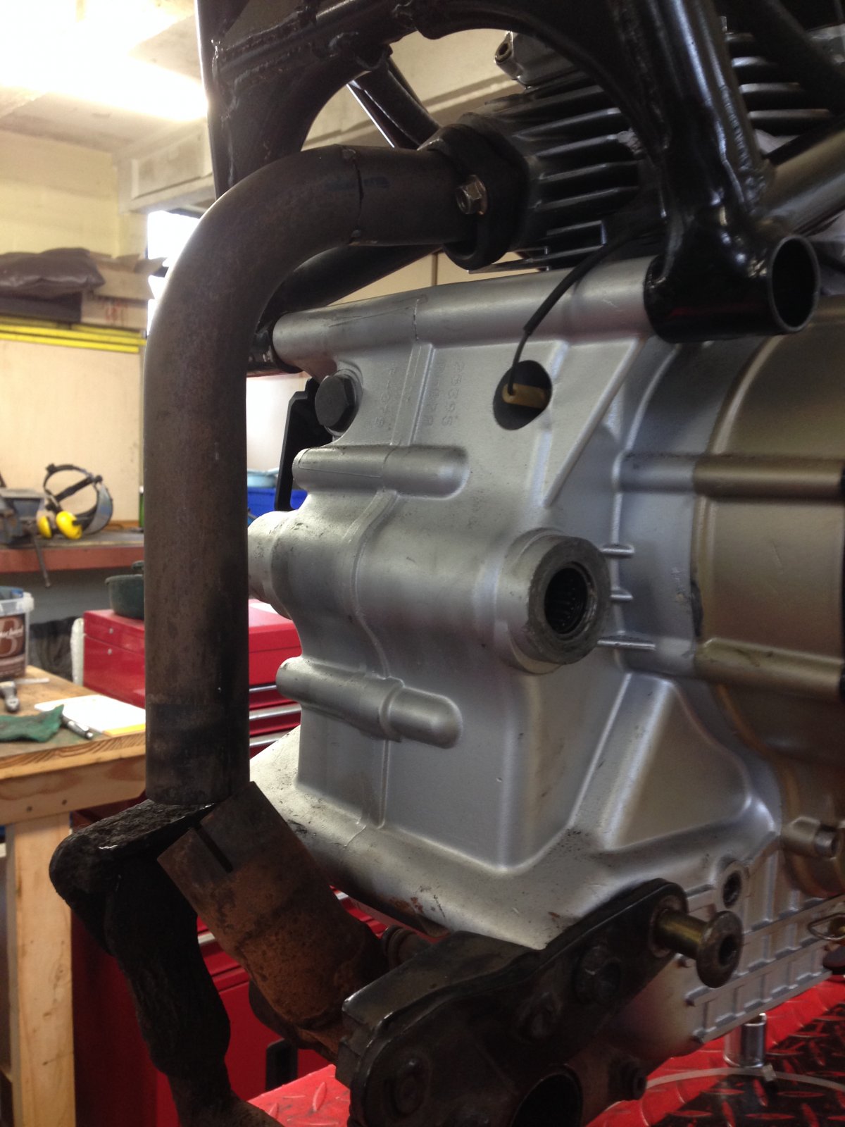

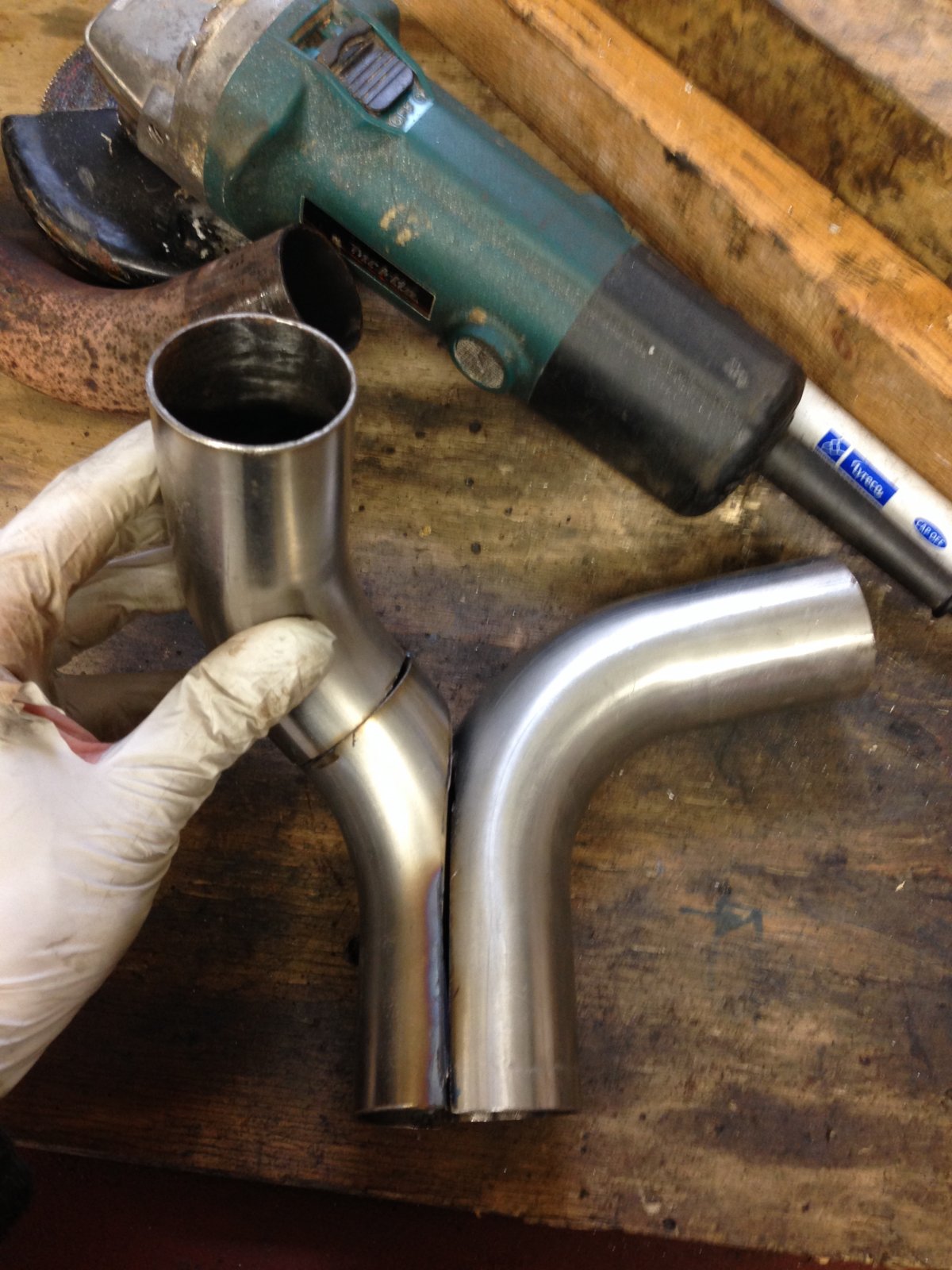

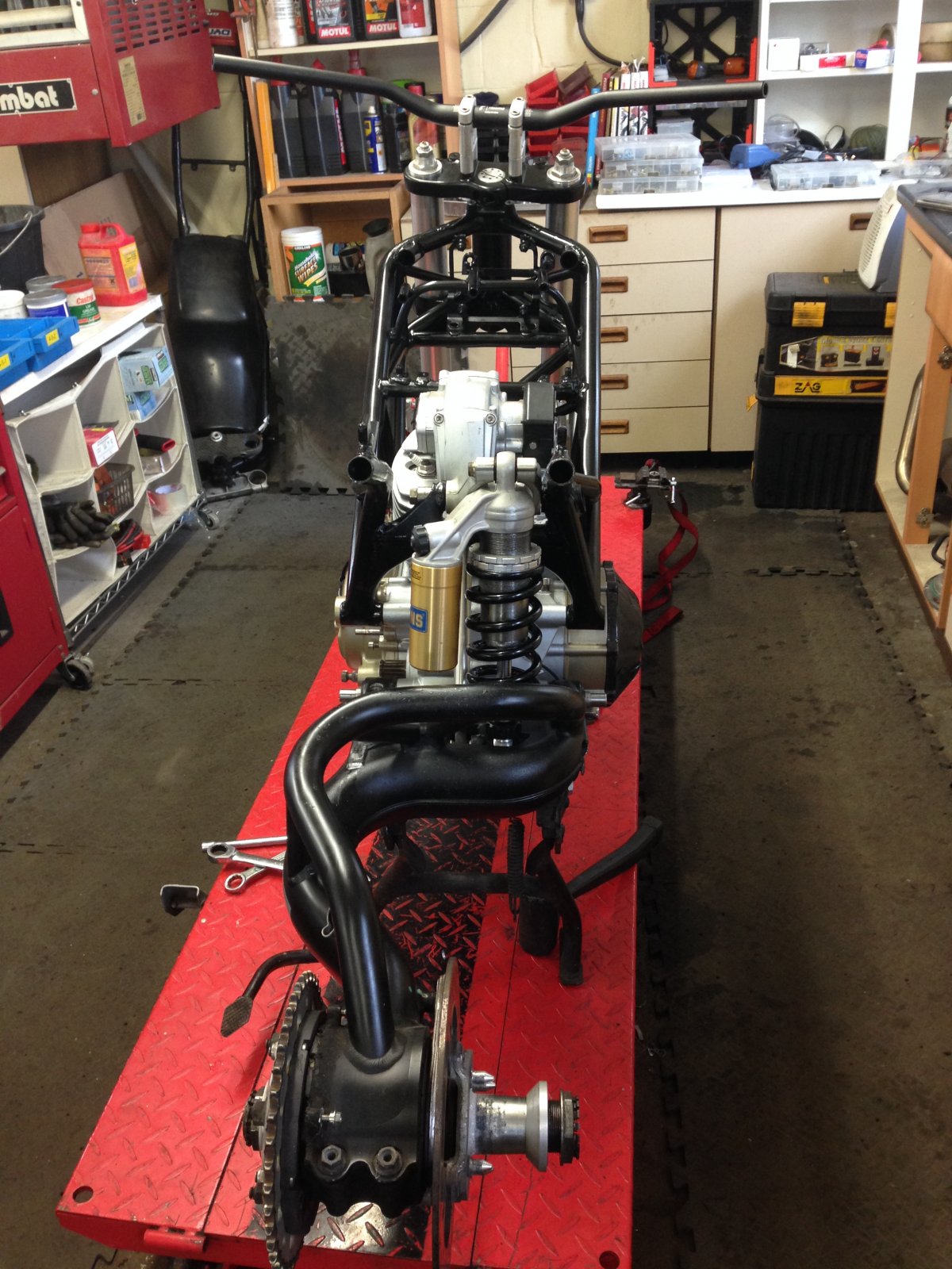

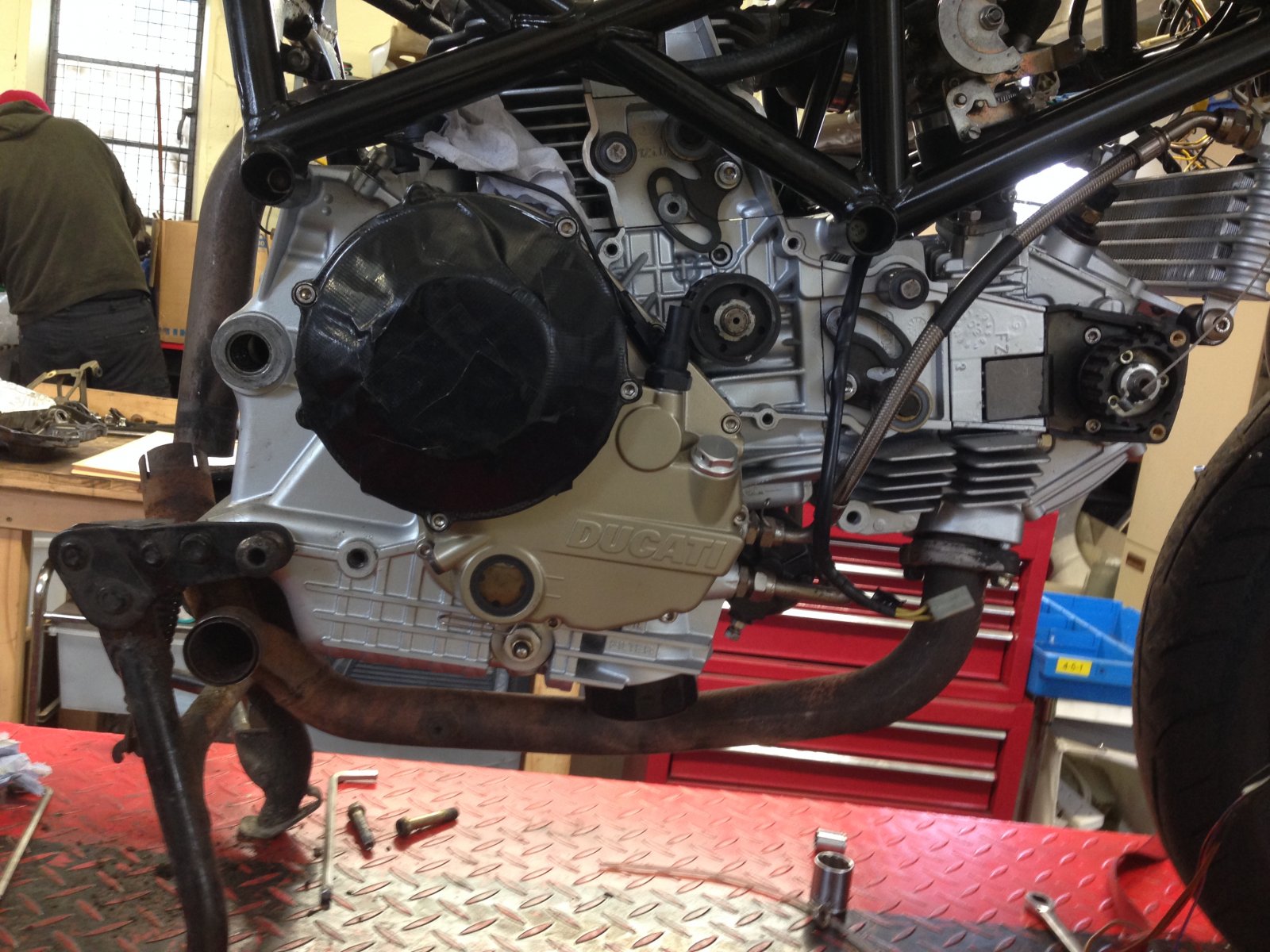

  17. Latest instalment, been making the 2 in 1 exhaust link pipe today, using standard headers and the fabbing a link pipe, here's some pics. Probably another days worth of work at least, it's harder then it looks!
  18. Here's some pics

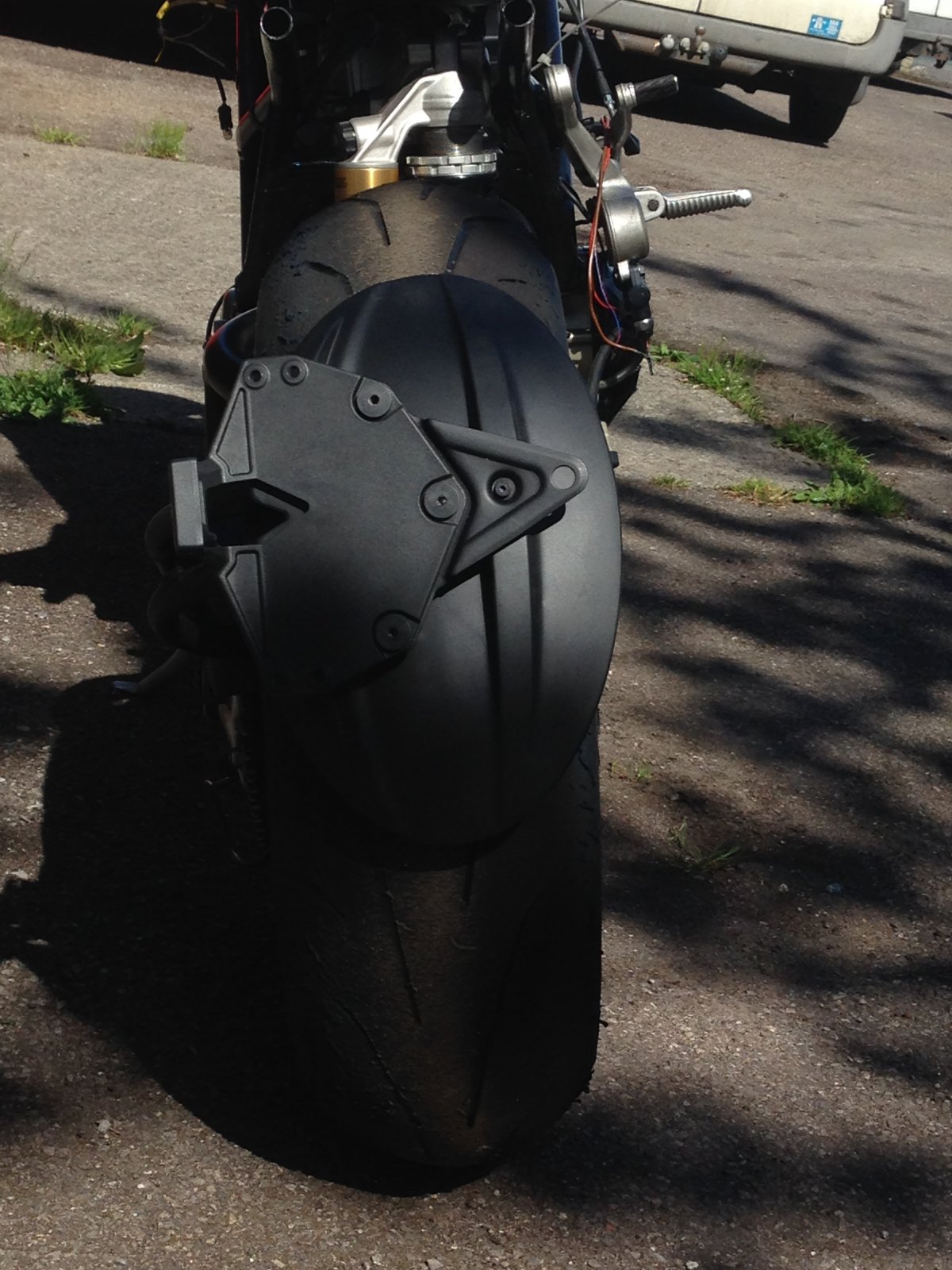

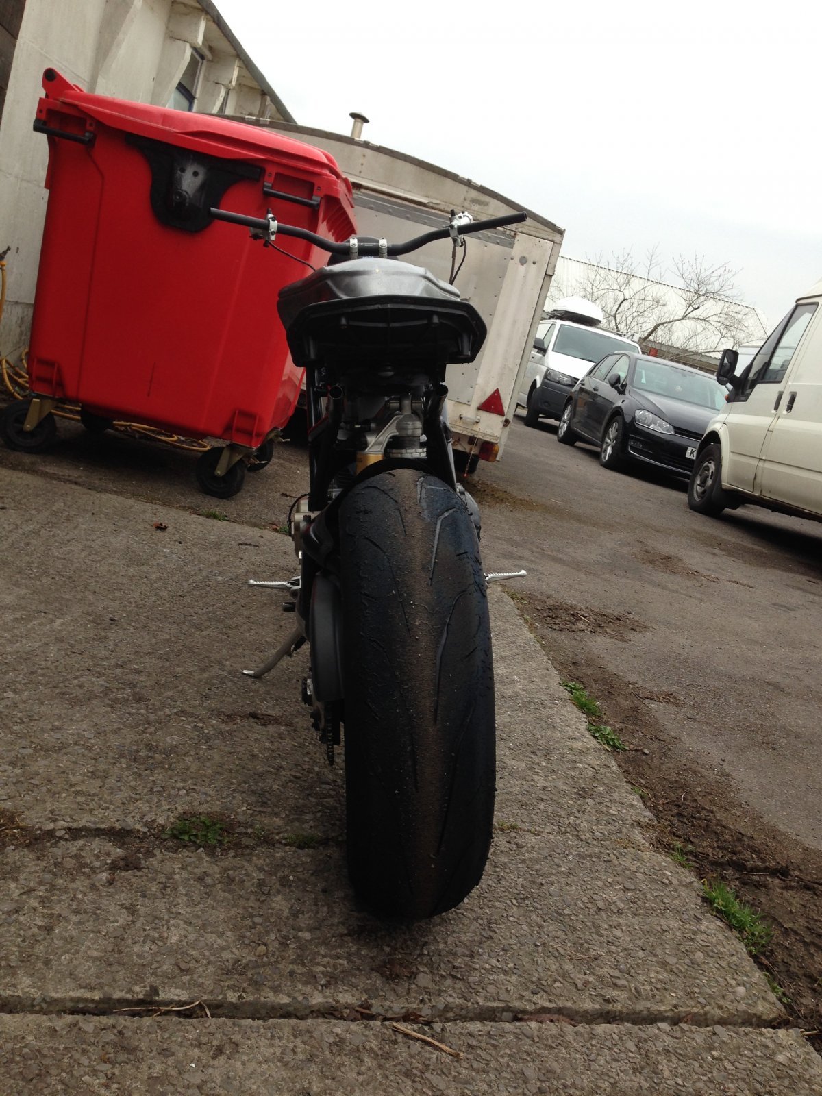

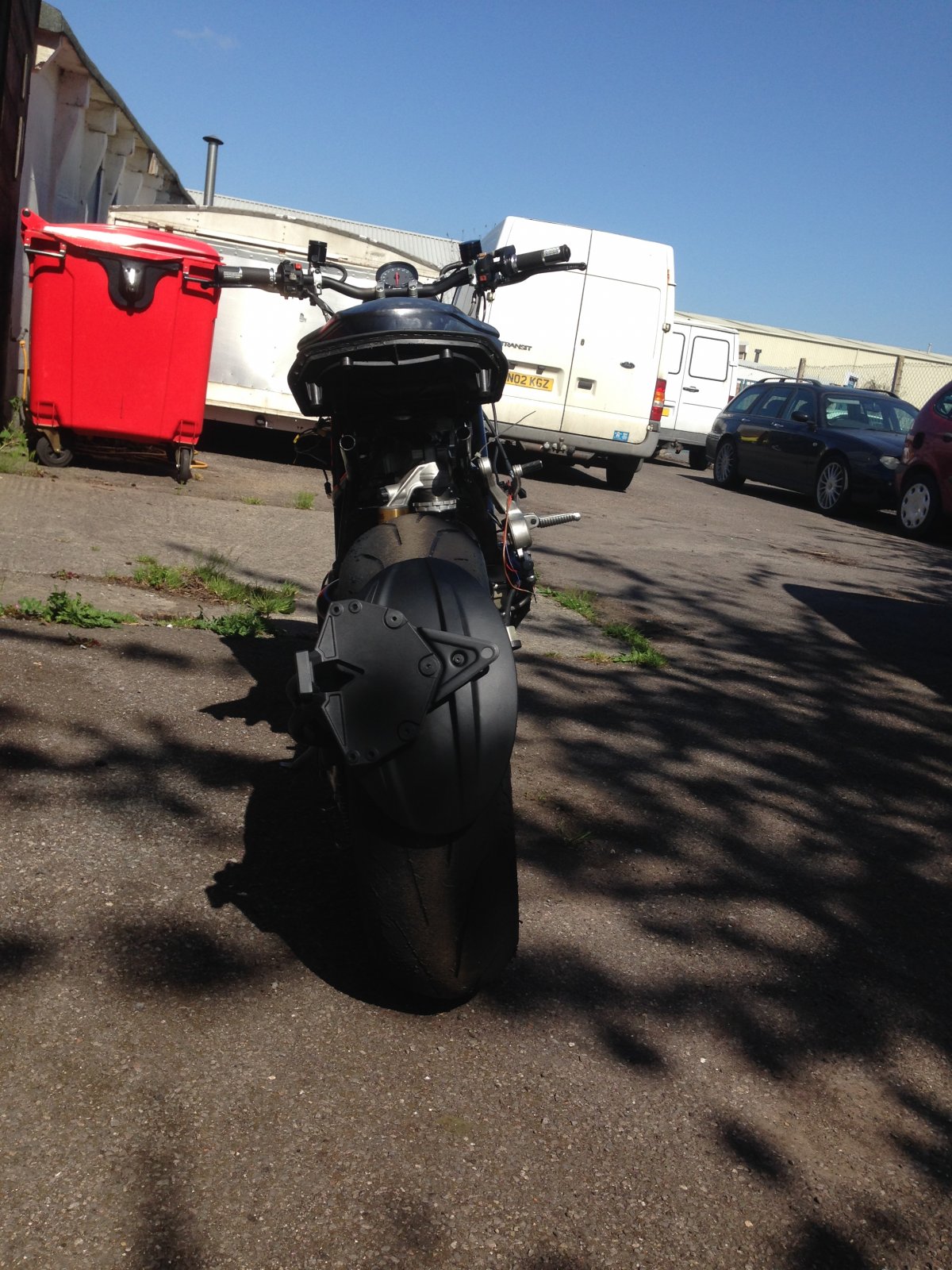

  19. latest update, got the number plate bracket mount mocked up, still needs squaring up properly but i wanted to see what it would like first. Its an oem item from a Diavel.
