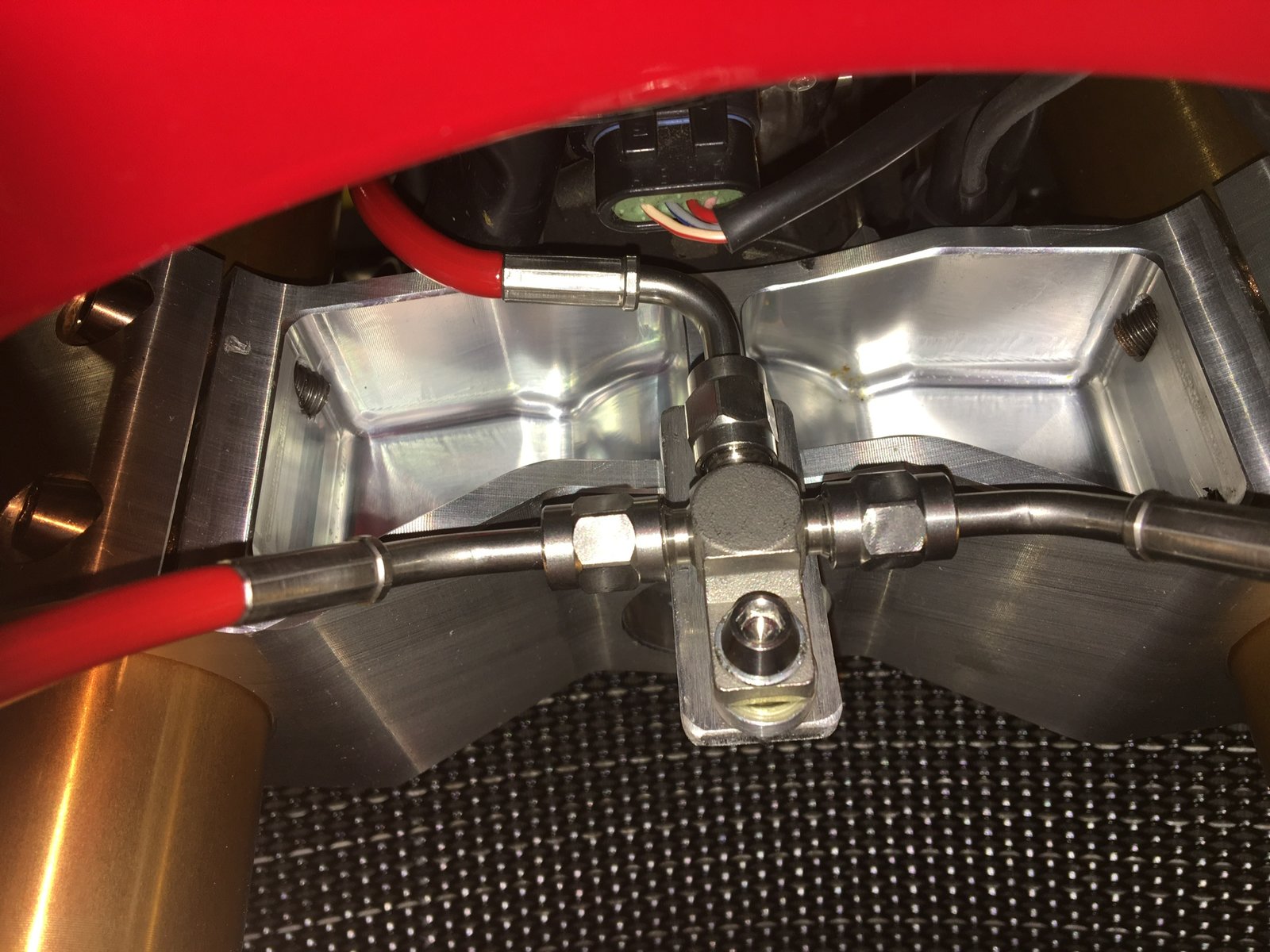

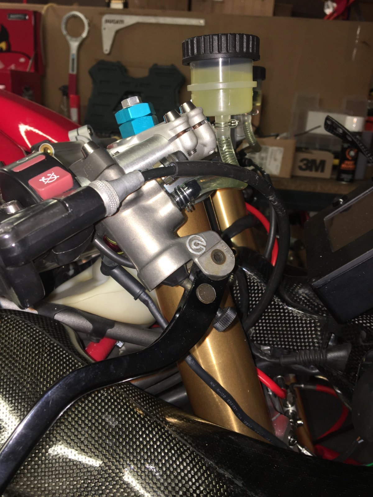

  10. Ian, did your brake lines fit, banjo bolt in the same position ? Aftermarket banjo bolt needed? Where did you get the bracket for the reservoir
  11. Hi mate. Got new lines made up from Hel as I wanted to use a brake line splitter fitted to the bottom yoke (after seeing andy’s @final_edition ’s set up. Just having 1 line coming off the front master is better IMO as that area’s already a bit crowded. Just used a single banjo bolt as I fitted the banjo brake light pressure switch onto the front calliper. Made the brackets up at work.
    426B5517-4468-4AEF-BCE4-C9CFCF7CD036.jpeg 5481EDE3-3628-479D-8C68-23B8A74AF6CD.jpeg
    Top photo shows the pressure switch fitted to the master. Moved it to the calliper after
    Cheers, Ian

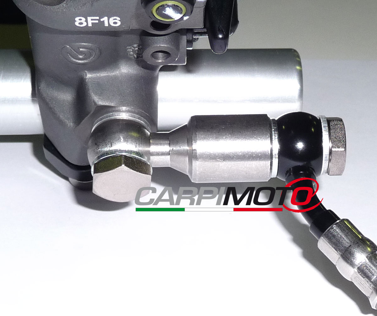

  12. That's not an RCS but I'm sure it's the same arrangement.
  13. Yes, that’s it. Came off a 998rs IIRC. There’s no provision for a brake light switch.

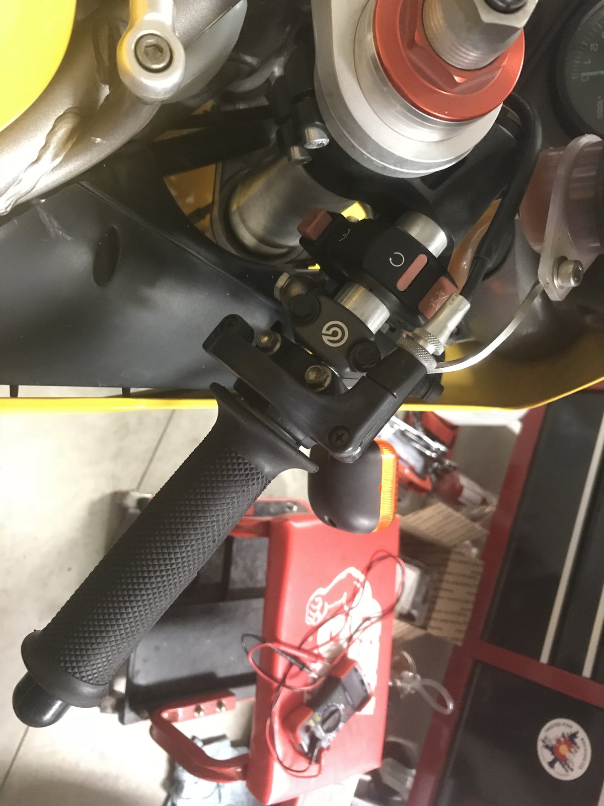

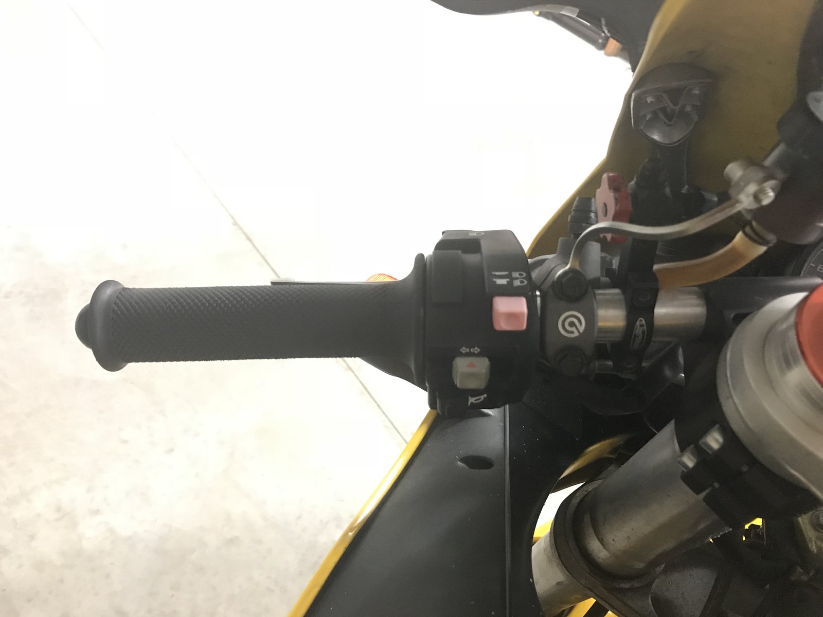

  15. Everything is fitted, only issue I have come across is the Brake side, OÉ kill switch won't fit too, there is what looks like a stop pin on the underside of the bar

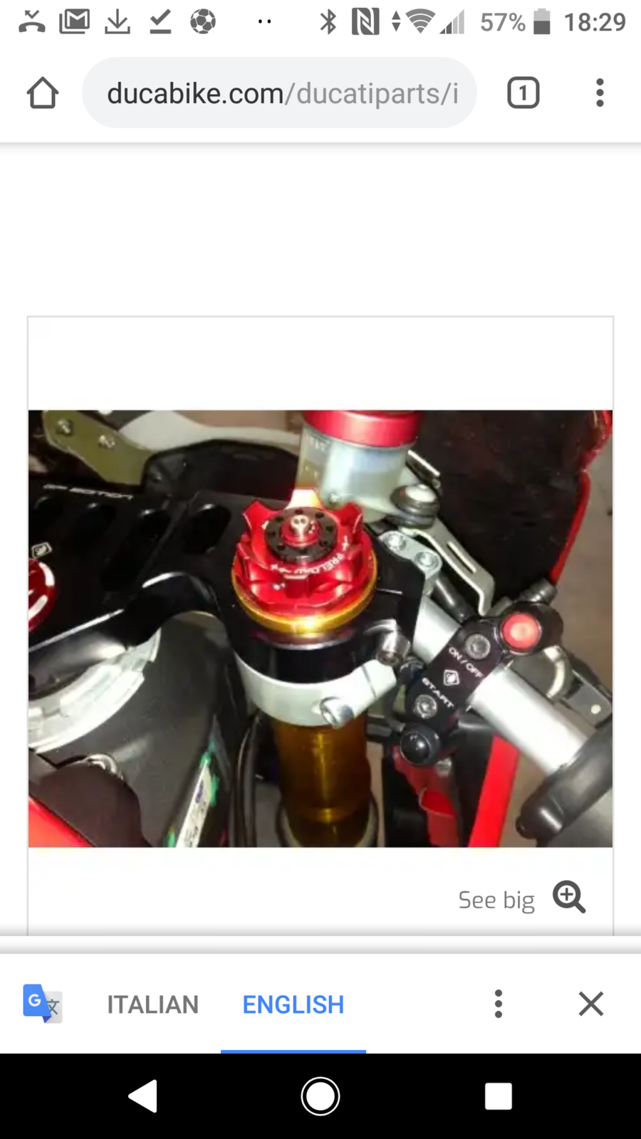

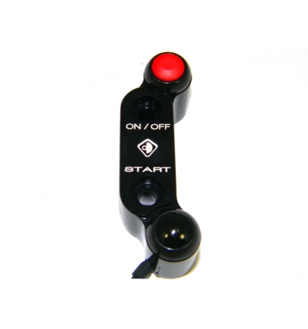

    Ducabike do a swith for the rcs but I will need to wire it into the oe plug
    Any ideas?

    The master cylinder should be inboard (to the left) of the kill switch normally. Then it would fit (it did on my 916 with RCS master cylinder).
  17. Thanks ricky
    I just threw it there for the picture, there is a pin in the underside of the handle bar, rcs don't have provision like the oe clamp to accept the pin, it's to ensure correct position , I was told you can pull the pin out with a pliers, was holding off till I researched it but ducabike do an rcs clamp with built in button, I taught I might have to get that, bolted it up for bleeding aand to measure master to reservoir argon line, I had to cut to measure
  18. I removed the location pin , no full lock the brake lever hits the Rev cluster ; will have to stay where it is and a Ducabike switch will need to be wired in

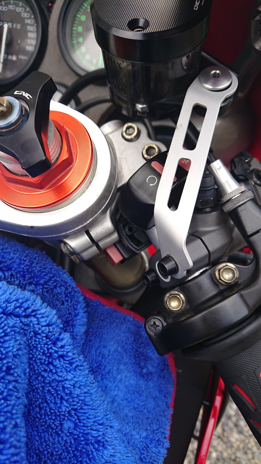

  19. I have a set of RCS on my 748; I ran into the same issue and ended up with different clipons to replace the stock ones. I went with Woodcraft ones, so always another option!
