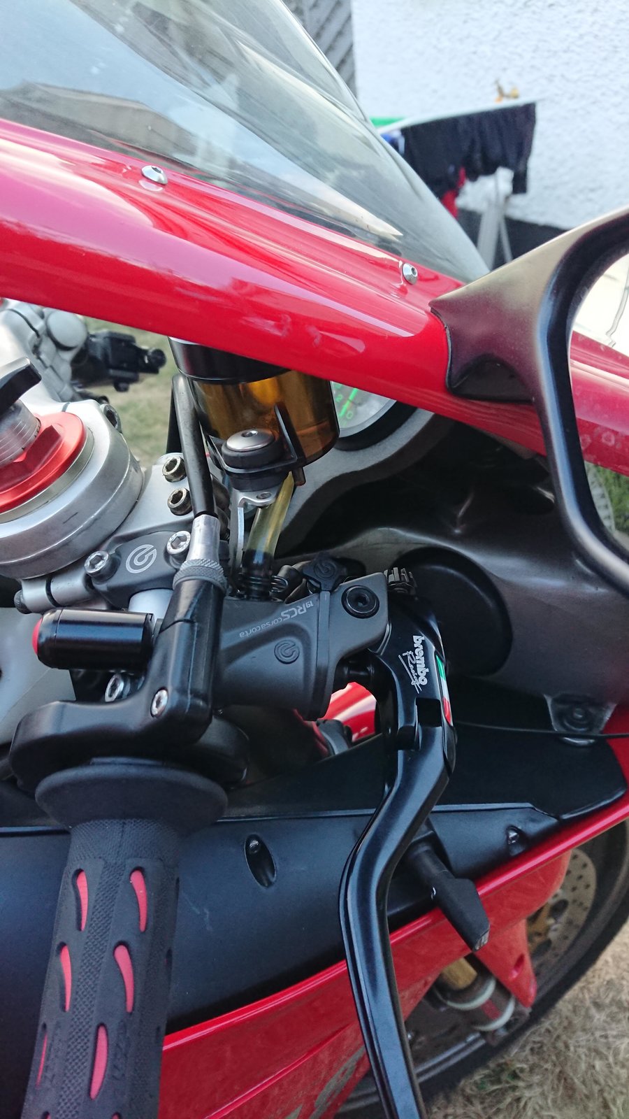

  3. Did you find the Clutch Lever adjuster fouls the Speedo trip counter reset dial; I think the only option is clip ons ; it is only on absolute full lock , I can still put on the steering lock though
    What diameter are you clip ons ? CNC racing have 50 & 53 , I have OE Showa front
  4. 53mm for both ohlins and Showa for the top. I can’t really help any further as I fitted a top yoke to raise the bars further up and also 40mm longer DP bars. I also ditched the clip on locating pin and replaced it with a counter sunk screw so I could change the angle of the bars.
    Ian
  5. I believe mine are 53mm with the stock Showa but it’s been a few years since I fit mine.
    They don’t hit anything full lock to lock but there is very little clearance for stuff at full lock, like a mm or two. I do have the MCs tilted down more so than stock MCs were; it was like a puzzle when I put them on to not interfere with the speedo reset dial, hit the frame at lock, and miss the nose fairing with the reservoir.

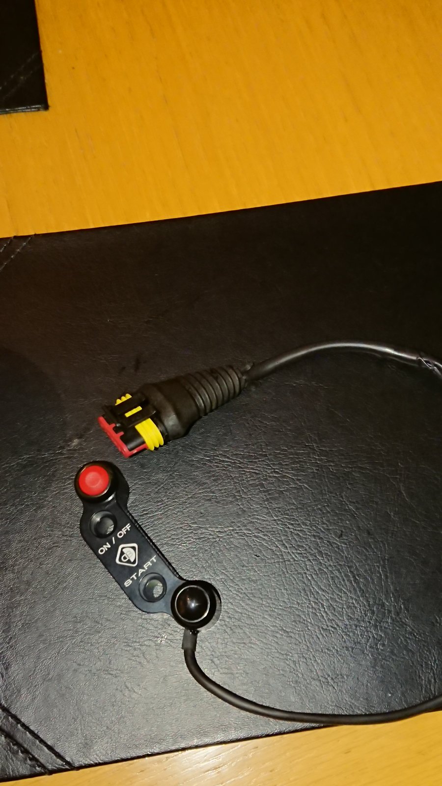

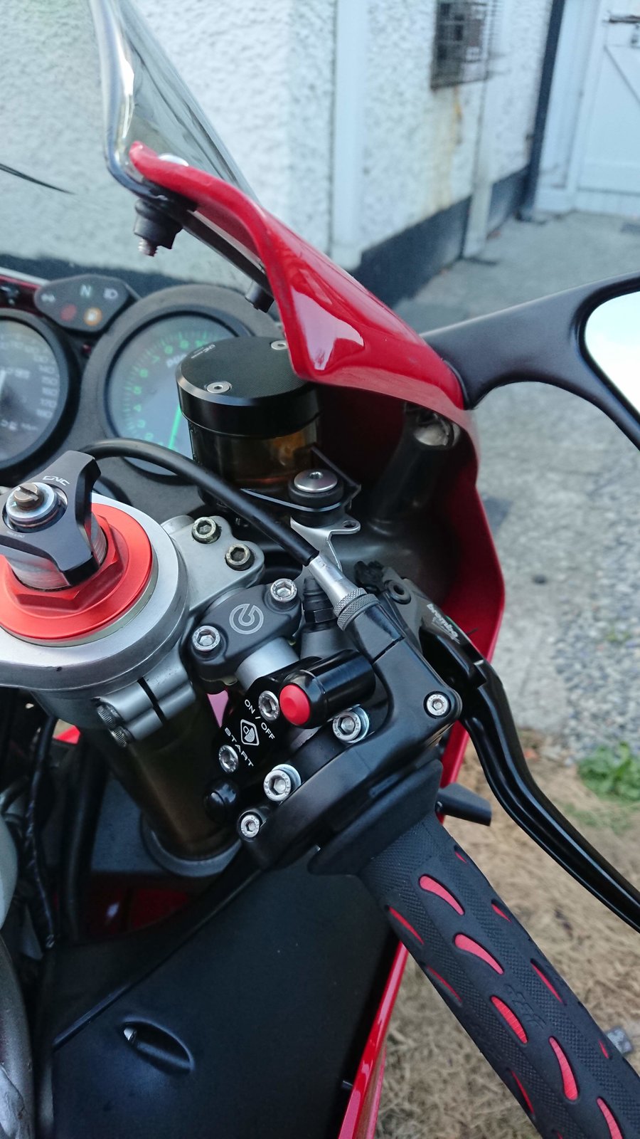

  7. I used a double banjo bolt for the brakes, the latest rcs not a chance the oe starter switch will fit too
    Wired up the ducabike one last night
  8. Fitted the switch
    Had to use the original OE bracket to mount the reservoir
  9. Looks good. Glad you got it sorted!
  10. Its a jigsaw !
    At least it may give other members an idea of whats involved , not too bad but the switch is not cheap

    How much was that switch?
  12. 200 euro, its billet
    700 euro for the Brake and clutch
