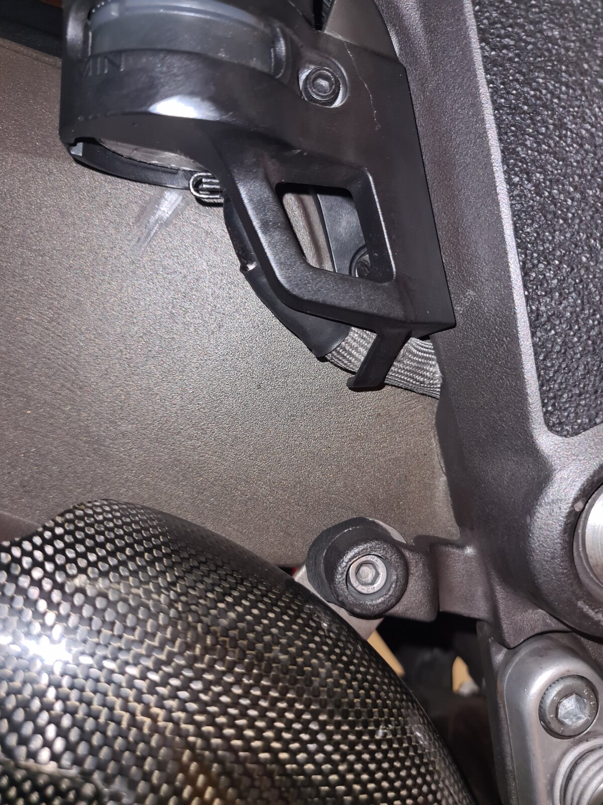

  1. So, as we all well know the rear brake has been pretty poor and goes from ppl saying its good to most saying I have no back brake at all, so I went through ALL procedures to make it as good as I could from bleeding regularly to bleeders on the abs unit and tbh all were temp improvements but not long lasting... so, I contacted Hell for a new rear brake line and they advised me that my line was already braided so it wouldn't actually make much if any difference to my shitty spongey rear brake, So as it was pointing towards heat from the engine effecting the brake fluid I looked at the line and figured the line from the rear brake reservoir to the master cylinder was rubber and as this ran next to the engine could be the weak link, I looked for some heat insulation and bought some. I had to remove the pipe from the bottom of the rear brake reservoir and feed it down to the master cylinder. I did heat shrink both ends and also bleed the system with Motul 660F ( yes this might have made the rear brake better alone) but the rear brake is brilliant and even after cooking it on a 2 up tour over a 36 mile pass and got brake fade as i didn't let up on the rear brake as I've never had much use for it before it still worked perfectly after things cooled down. I've been running this now for 6 months and cant believe how its been and also how my riding has improved especially 2 up so just wanted to share after a good trial :upyeah: ( i got 10 and 12mm but 8mm sleeve would be the best fit)

  2. Nice one. Any pictures please.
  3. Sounds good. Would the 8mm ID sleeve go over the banjos prior to heat shrinking it? Can't recall how that line is terminated, no access to the bike ATM.

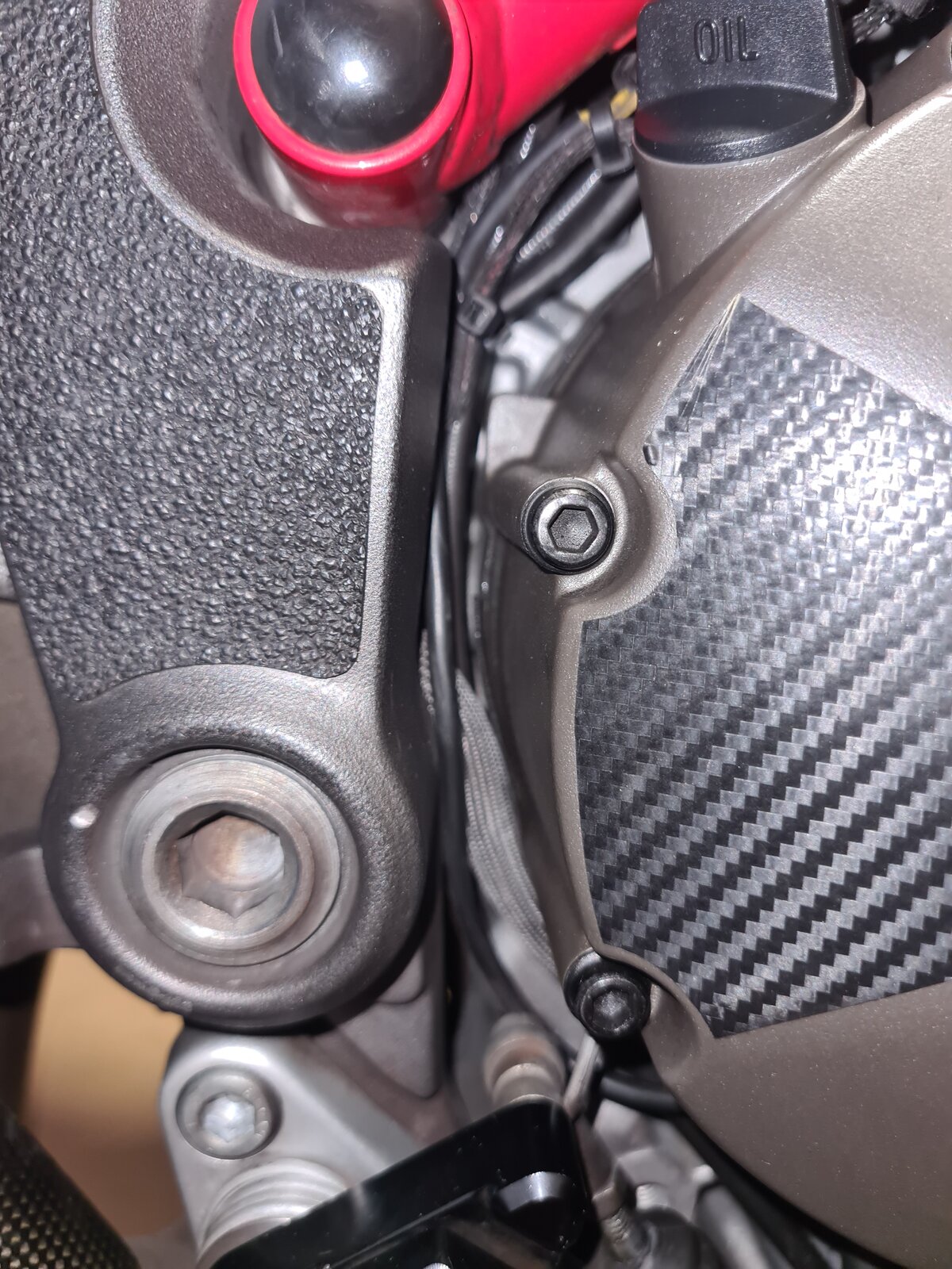

  6. Just took a couple of pics to show the sleeve in place, if you need something more specific let me know
  7. As was adding motul 660 I just drained the rear brake res and pulled the pipe from the underside and feed the sleeve down the line, i think I also undid the front foot peg so to get at the rear master cylinder just to make it easier and heat the heat shrink at both ends, looking back 8mm would be a better fit but now also thinking might be a bit harder to feed down if its a tight fit
