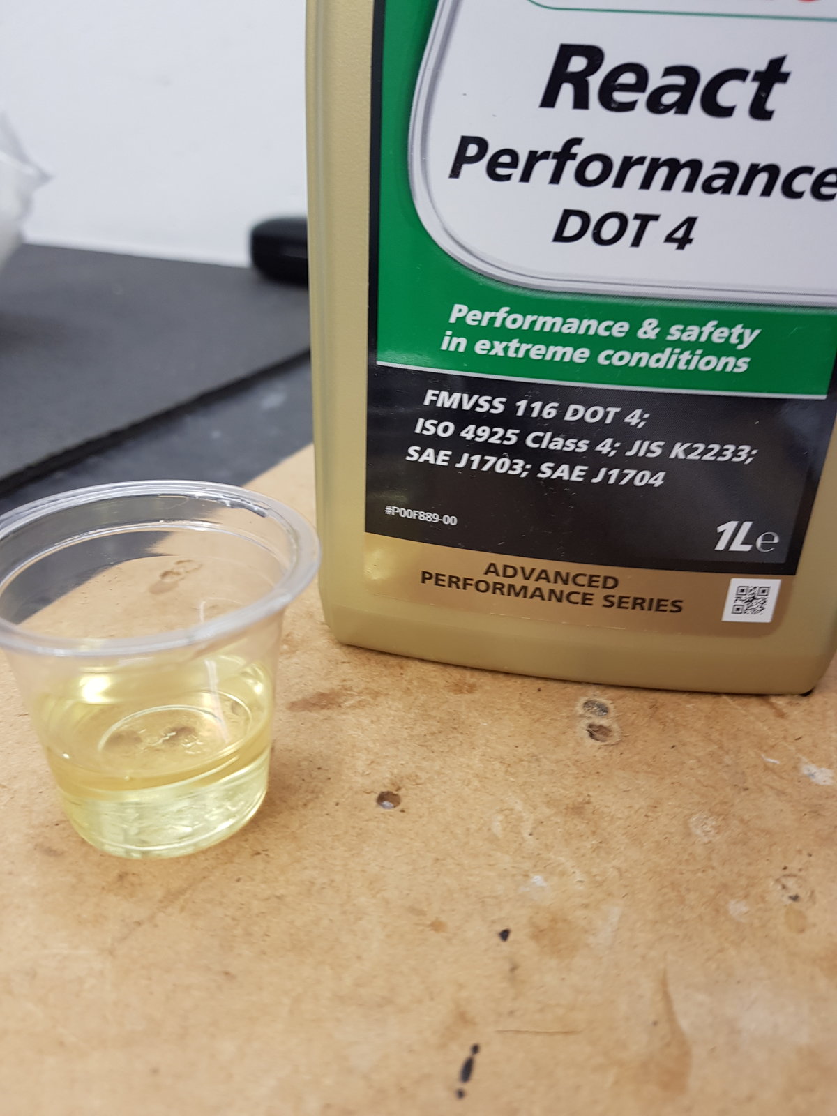

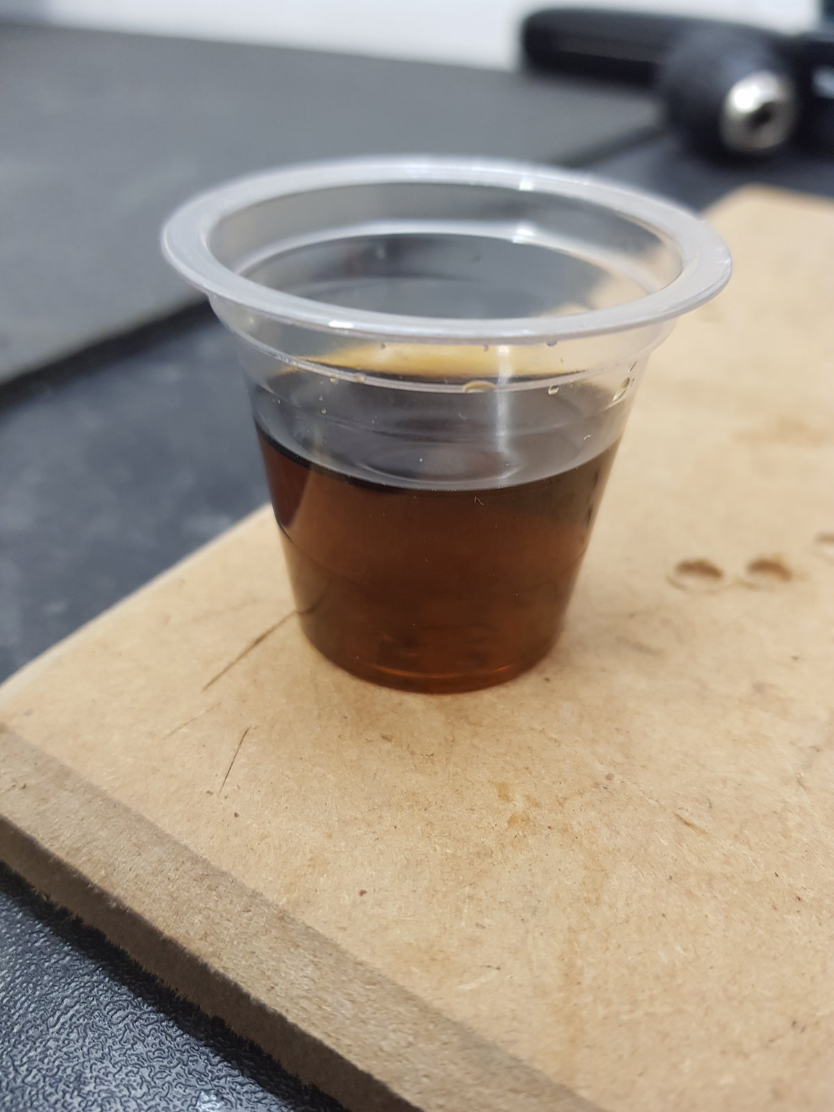

  7. Just changing rear brake fluid on my 1260. Looks like it is cooked! approx 7800 miles since April.
    My 2015 DVT did exactly same.
    Have swapped pads to EBC day 1 and keep an eye on fluid helps keep back brake as good as it can be.
    Am trying Castrol React Performance DOT4 as it says for extreme conditions!
  8. New Fluid
    #28 Joolsroper, Sep 22, 2018
  9. Motul RBF 600/660 gives you 20deg C more (wet boiling point)

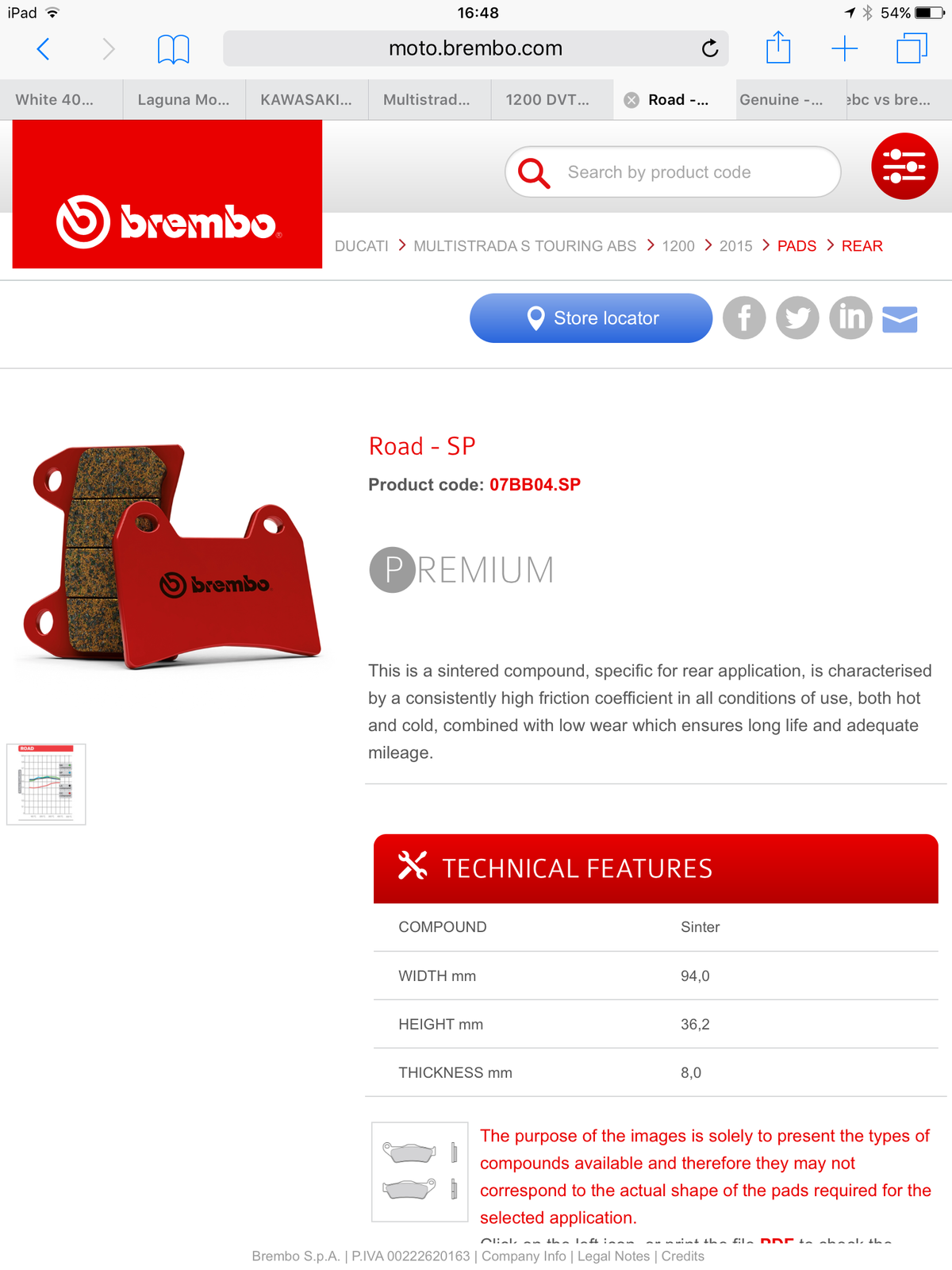

    Jackstraw my advice was to swap the OE rear disc for a brembo serie oro. The standard ones are I believe made by brembo but they clearly arent the same material

  17. PS does anyone have a link to the sintered Brembo rear pads for a 2019 PP? Be interesting to try them
