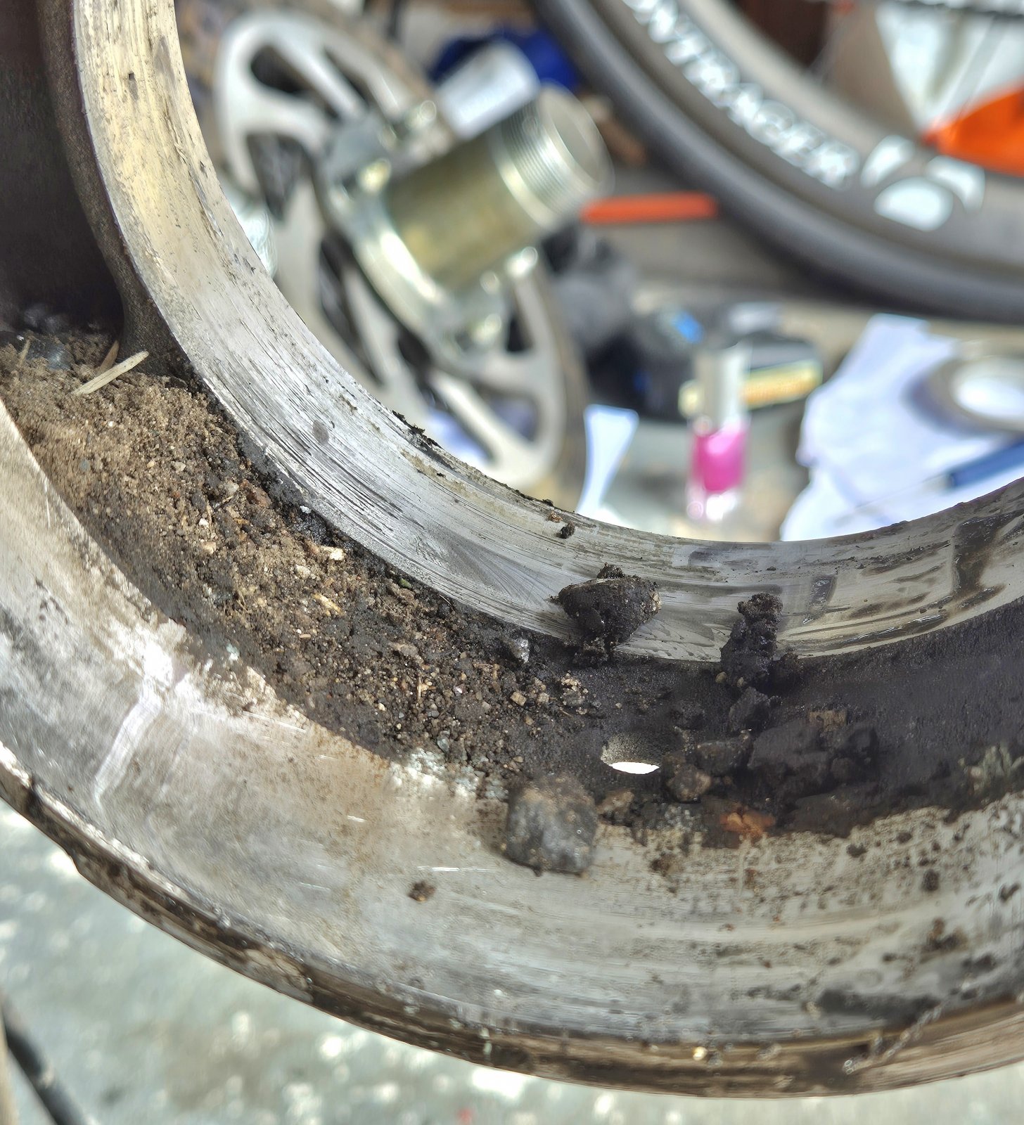

Those pictures are quite shocking. I've never taken the hub out of my bike but thats a job I'm going to have to learn over winter

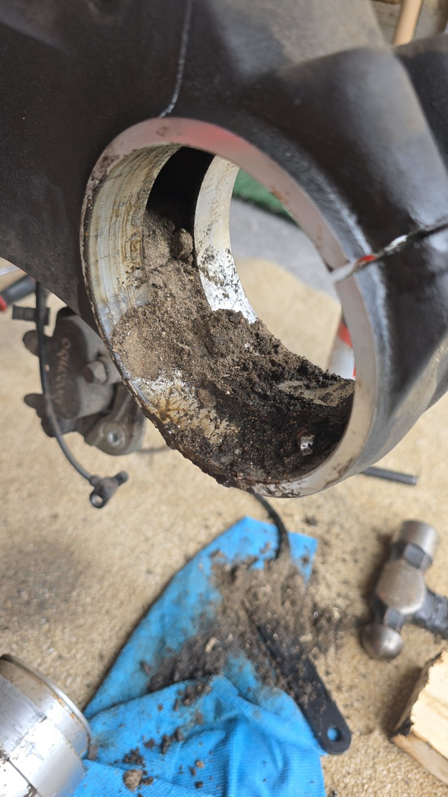

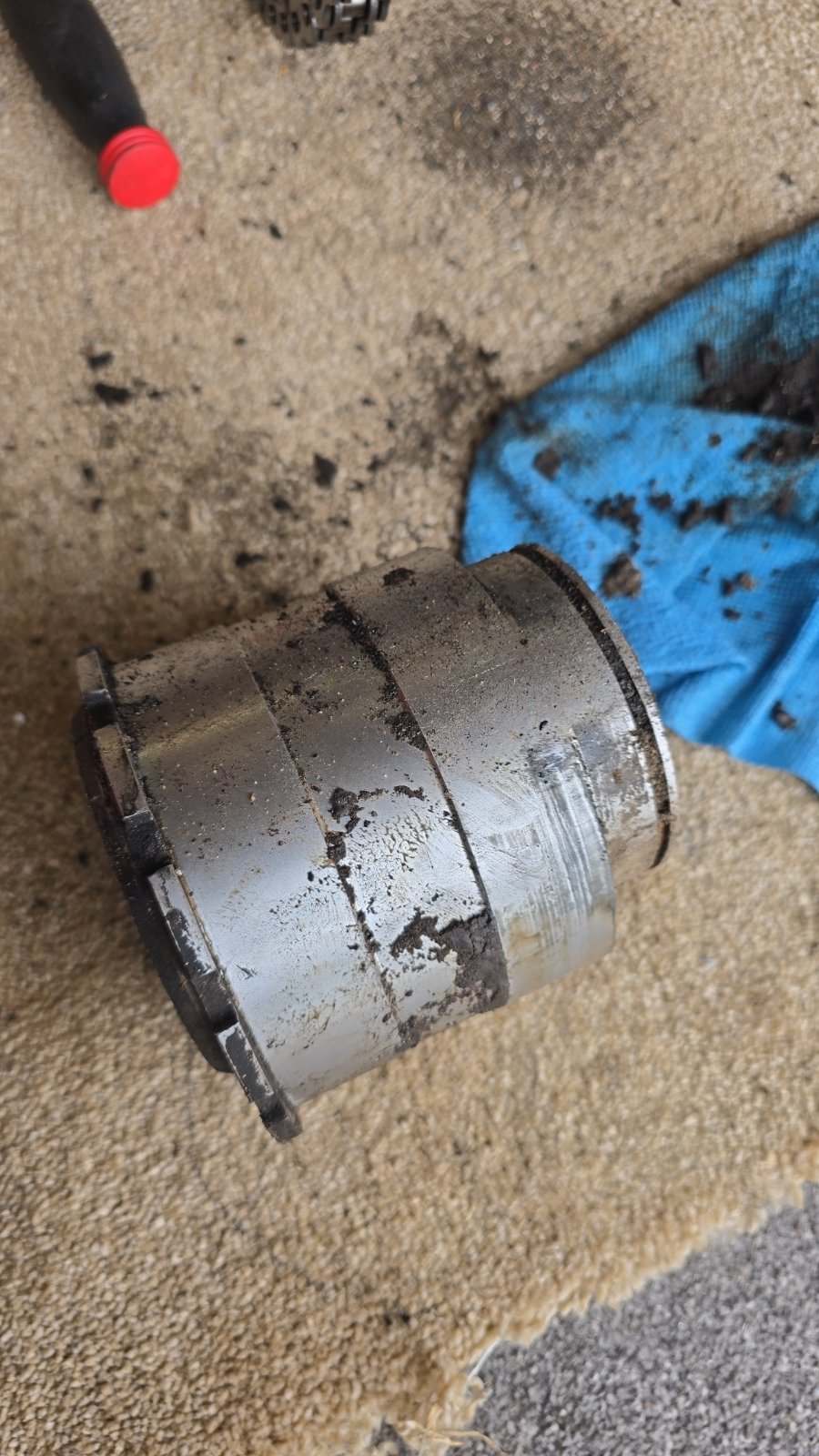

I'll never let my rear hub get like Andrew46! Never!! Meanwhile...... While trying to figure out what was going on with my chain length altering so much I decided to finally check the hub. I know I'm being naive, but if this can happen, why on earth is it not part of the Ducati service plan in a timely manner? Bike has only ever been to a main dealer for service. What a pain it was to not only get the hub out, due to all the crap, but since the rear axle stub had zero grease on it from new and has never been out it was well and truly stuck.
I believe it is part of the 18k service now, certainly is at Cornerspeed as far as I recall, although like many always do this job myself.
