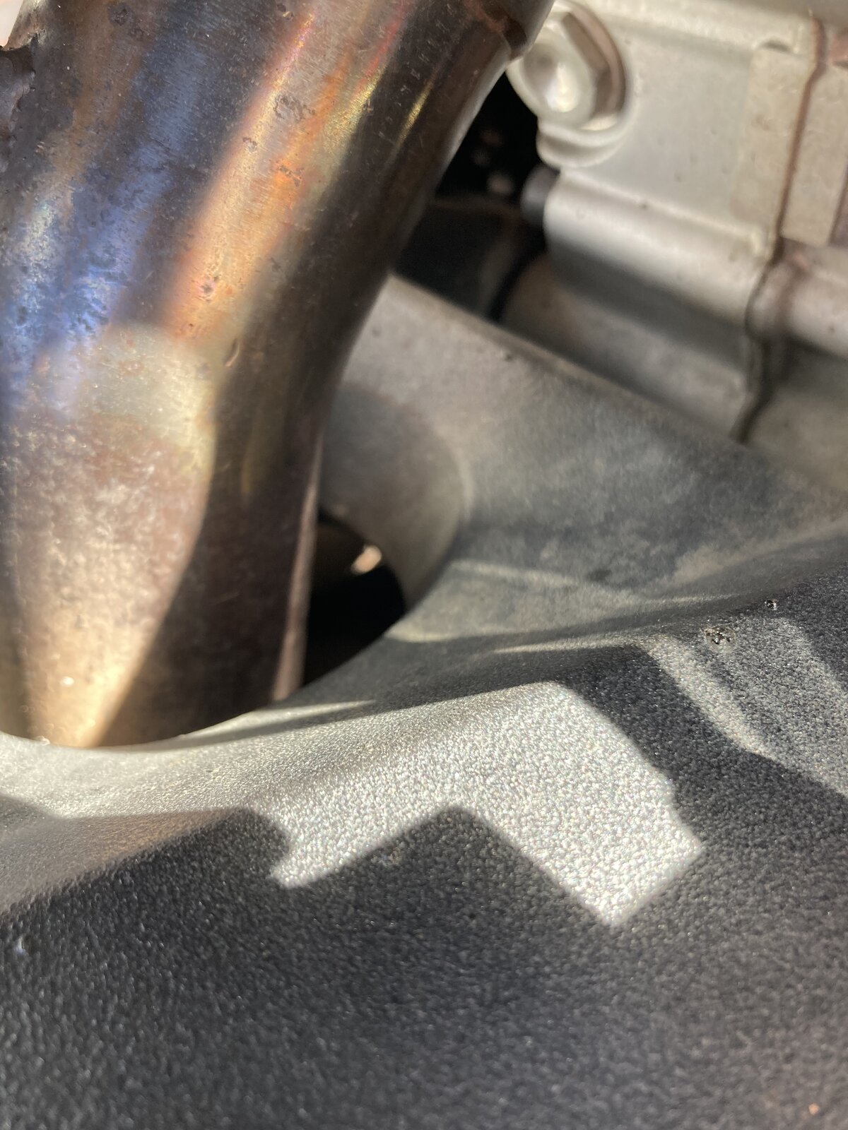

  11. Is this where the subframe bit that needs blanking off is
    The hole looks a bit rectangular
    What have people used to do this thanks
  12. Yes, but adjacent the block. If you look backwards towards the wheel, you'll see there's a hole there in the swingarm.
    I bought a 3d printed one from Holland and siliconed it in place.
  13. Do we mean behind the header, in the photo....?

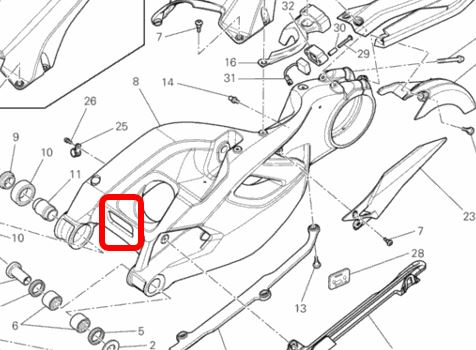

  14. If it's the one I'm thinking of, the hole in the swingarm is highlighted in red in the diagram below.
  15. Put your had up the back of the swingarm, next to the block and it's there. That's how the crap gets in the swingarm.
  16. Spot on.

  19. Thanks all yes the piece in the picture is what I was aiming for
