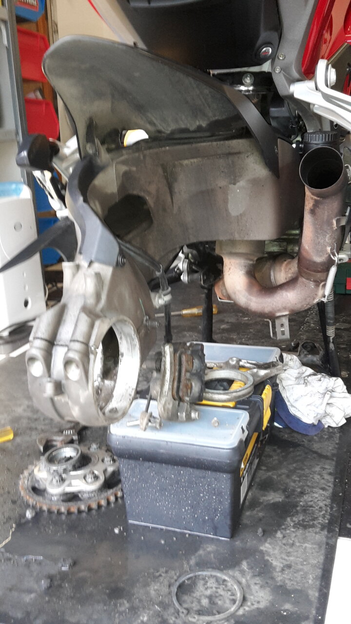

  2. I did this on my DVT a couple of years ago, it's a reasonably simple, if not time a consuming task. From memory: slacken both axle nuts, remove rear wheel, remove rear caliper, loosen hub pinch bolts and slacken chain, remove sprocket and carrier as one (no need to undo the 6 sprocket nut), remove spacer and inner ring from behind sprocket carrier, remove axle with brake disc from rh side, you'll now see the infamous circlip!! Remove circlip noting which side faces out as apparently it's chamfered on one side, remove the caliper bracket with 2 spacers and rubber O ring from the hub noting their position. The hub can now be removed from the lh side of the swingarm, it may need persuading, by opening up the gap a little where the pinch bolts are.
    Refitting is reverse, I used a good quality grease on hub / swingarm surfaces and axle parts and rubber grease on the "o" ring, when refitting the caliper bracket be sure that it locates onto the peg on the swingarm. The difficult bit is refitting the circlip, while trying to hold the 2 spaces,"o" ring and caliper bracket on the end of the hub, even using large circlip pliers the circlip wants to twist, after several attempts, walk away and come back later, it will go on so much easier! Good luck! Should have taken more photos.

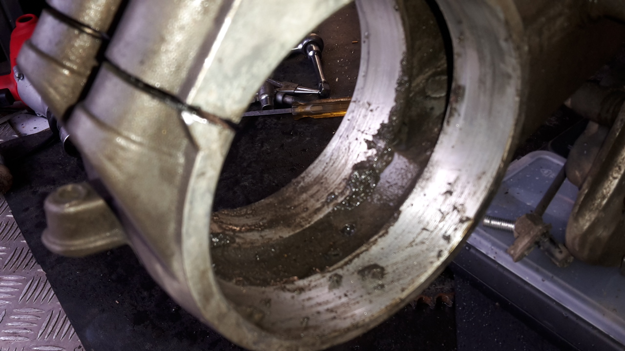

  8. For me the two greatest pains were the refitting of the circlip (not removing it) and the removal of the hub itself from the swing arm. It wouldn't budge at all. After I removed it (using several good hits with a mallet) I understood why: totally dry and with loads of road grime in between. After a good cleanup I used a lot of grease (just normal grease but you may want to opt for the anti-seize variety) to make sure it doesn't happen again. I will find out if that worked the next time I attempt it.
    If you find the task a bit daunting, just take notes and lay everything cleanly on a bench (preferably numbering the actual steps so you can follow them backwards afterwards). There is no strange or peculiar action in the whole disassembly, just stubborn parts that won't budge (or refuse to go back in their place. The circlip is one such part. The tolerance of the groove where the circlip goes is very small). I remember that I needed big circlip pliers (in the range of 50-60mm that open the circlip outwards). When removing the hub you can provide some assistance to yourself by pushing a small wedge in the gap at the end of the swingarm (after you completely unscrew the two bolts that tighten it). It will open the arm more and lessen the friction between the arm and the hub.

  13. When I opened mine, there was a lot of grime in the channel between the two tightening screws (exactly above the dreaded hole that lets in water and mud) and minimal in the rest of the hub body. I believe the latter was transferred the numerous times I actually rotated my hub for chain adjustments as there is practically no space for the grime to seep in. Now that I have an oiler installed, I still have to adjust my chain after a good 25K kms (the oiler made a tremendous difference in chain condition). So I believe that I am safe, although I do agree about the grease being a mud/grime magnet. I'll definitely have a look next time I change my chain and If I remember I will comment on that.

  18. The hole at the bottom of the swingarm, beneath the hub, is there to drain water from inside the swingarm, unfortunately it gets clogged with road crud and gravel which enters from the large hole in the top of the swingarm near the top chain guide. Maybe there is a good reason for that large hole to be there but I can't think of one!!
