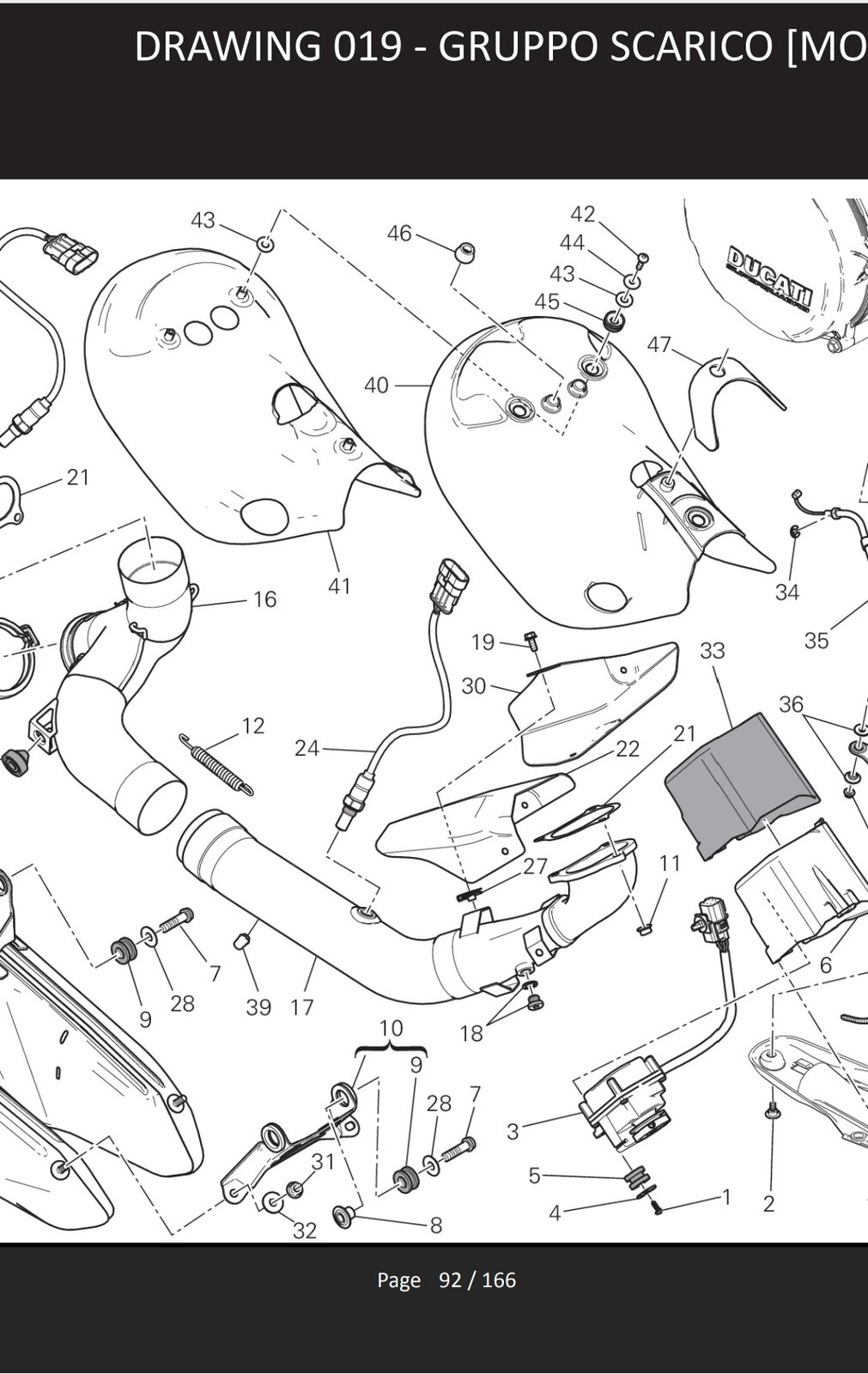

    I've done a bit more digging around and can't see these spacers on the 1199 parts catalogue either. The closet thing I've found to what I saw in a video when a guy was fitting the rear pegs and had to remove the spacers, is a spacer from the 1299.
    Item 46 in the attached picture, part no. 71614961AA. Does that look right for the 899?

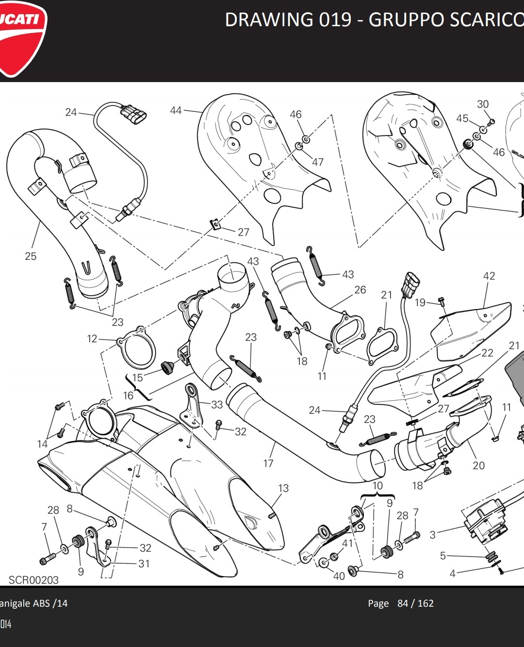

  10. It's interesting with the 899 and 1199 rear pegs when you look at the parts catalogues. As the dealer is closed today, I've spent a bit more time looking at the catalogue for each model, along with the 1299, and only the 1299 one makes any reference to the tapered spacer and the fittings for the relevant exhaust shield bolt holes. The 899 and 1199 doesn't show anything for these exhaust shield bolt holes.
    899 page attached for reference and comparison with the 1299 page I attached previously.

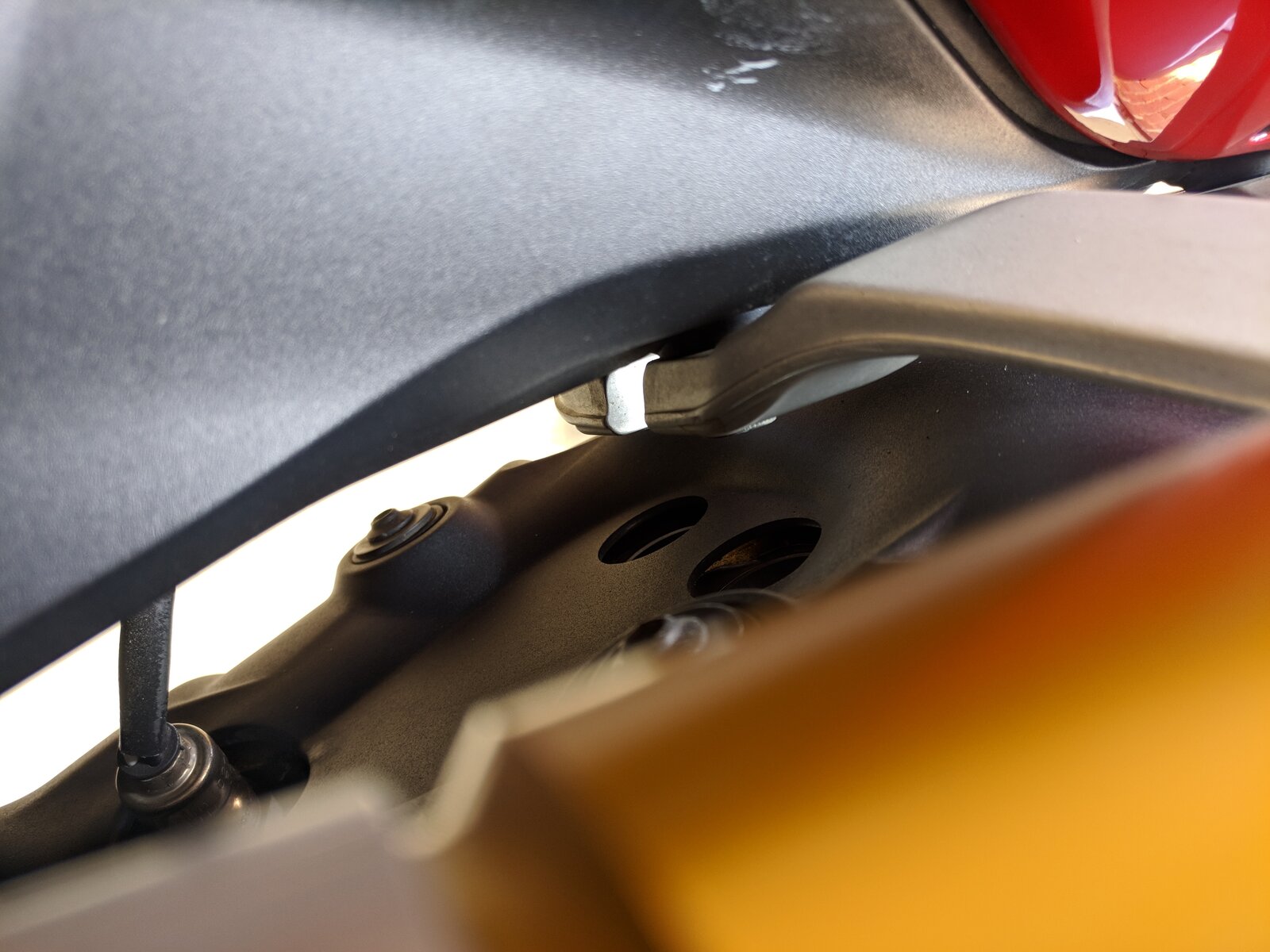

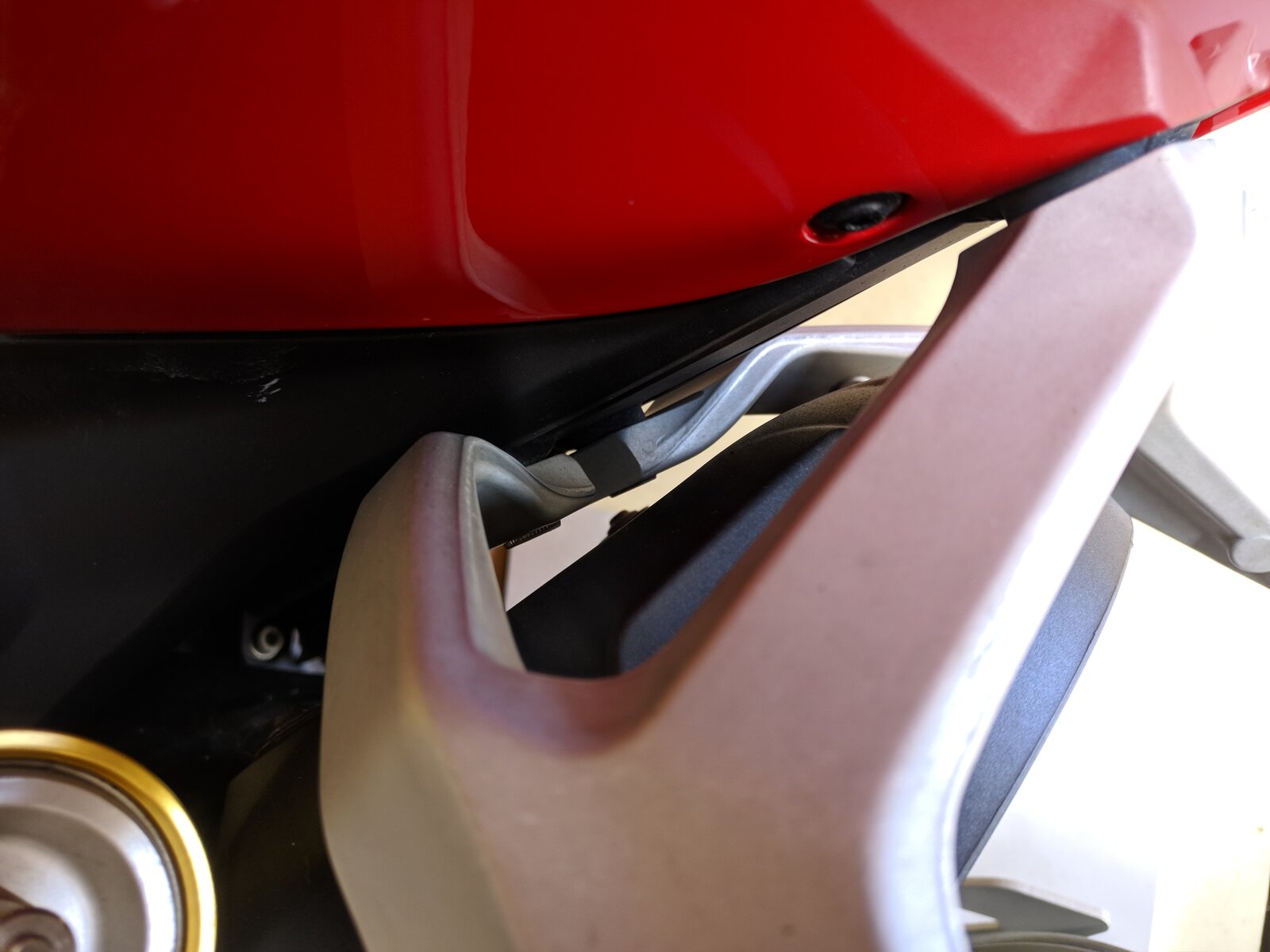

  11. Now I've finally had proper time to go over the bike, it was only delivered on Friday, the parts catalogue makes sense. The 899 exhaust shield isn't attached to the rear pegs and clears the pegs and underside of the bike by default.
    Couple of photos for reference.
