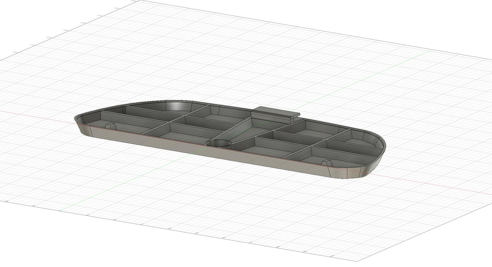

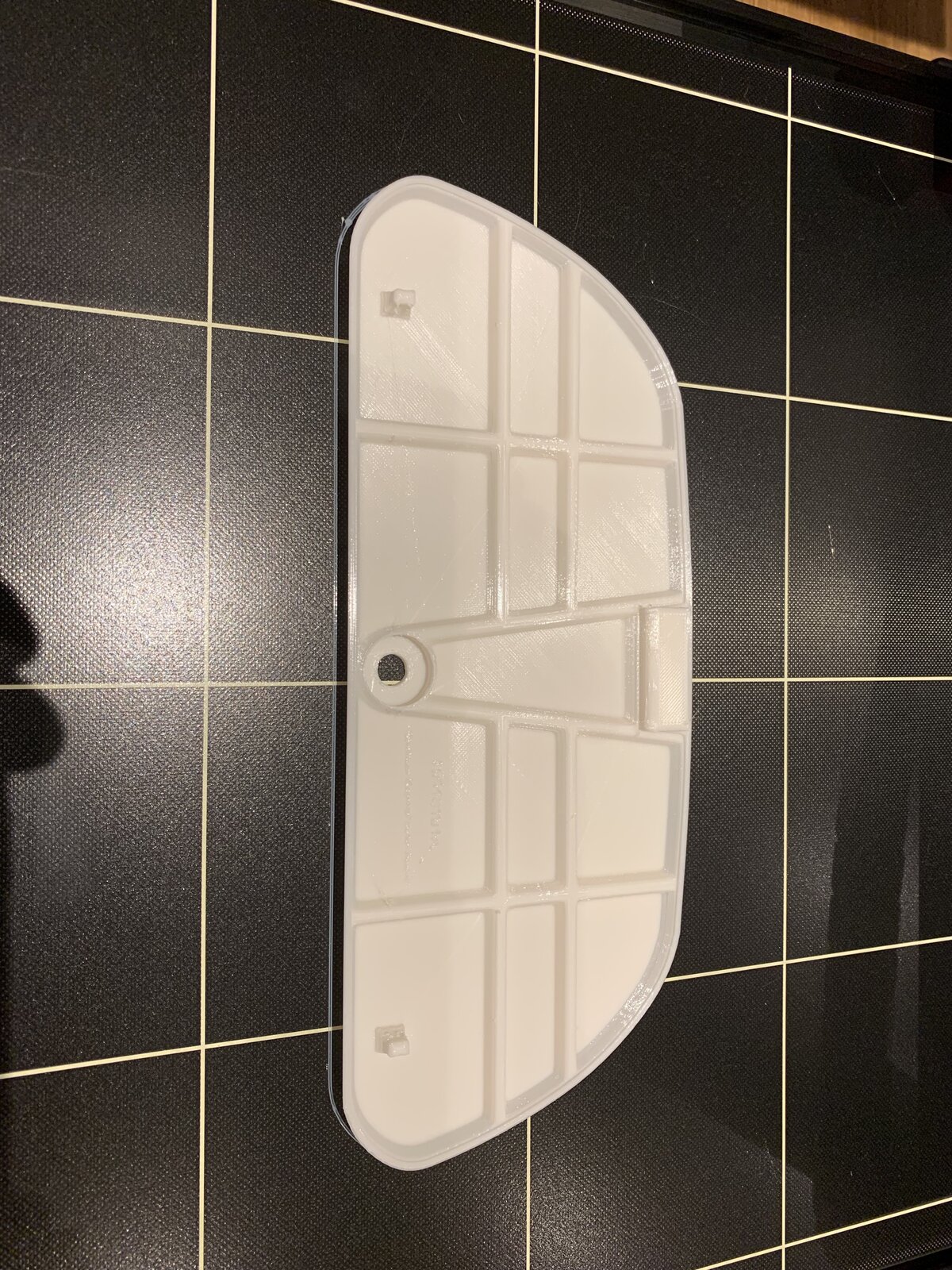

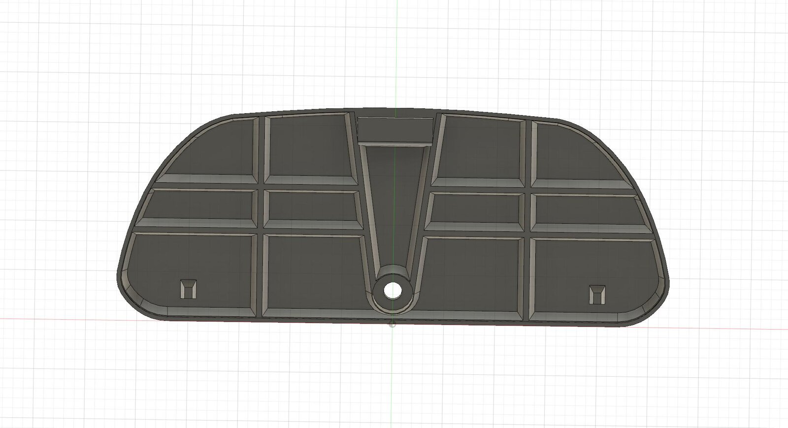

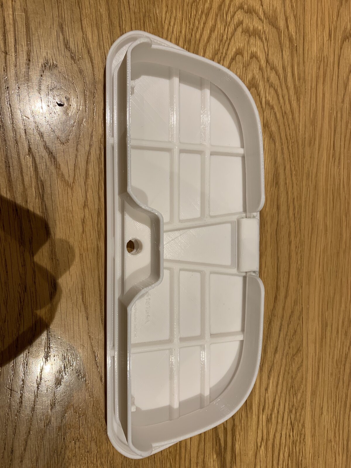

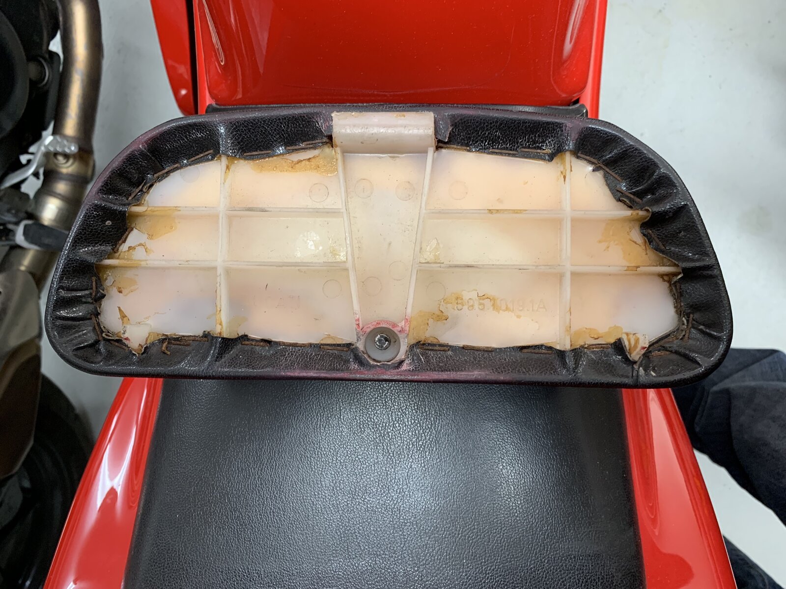

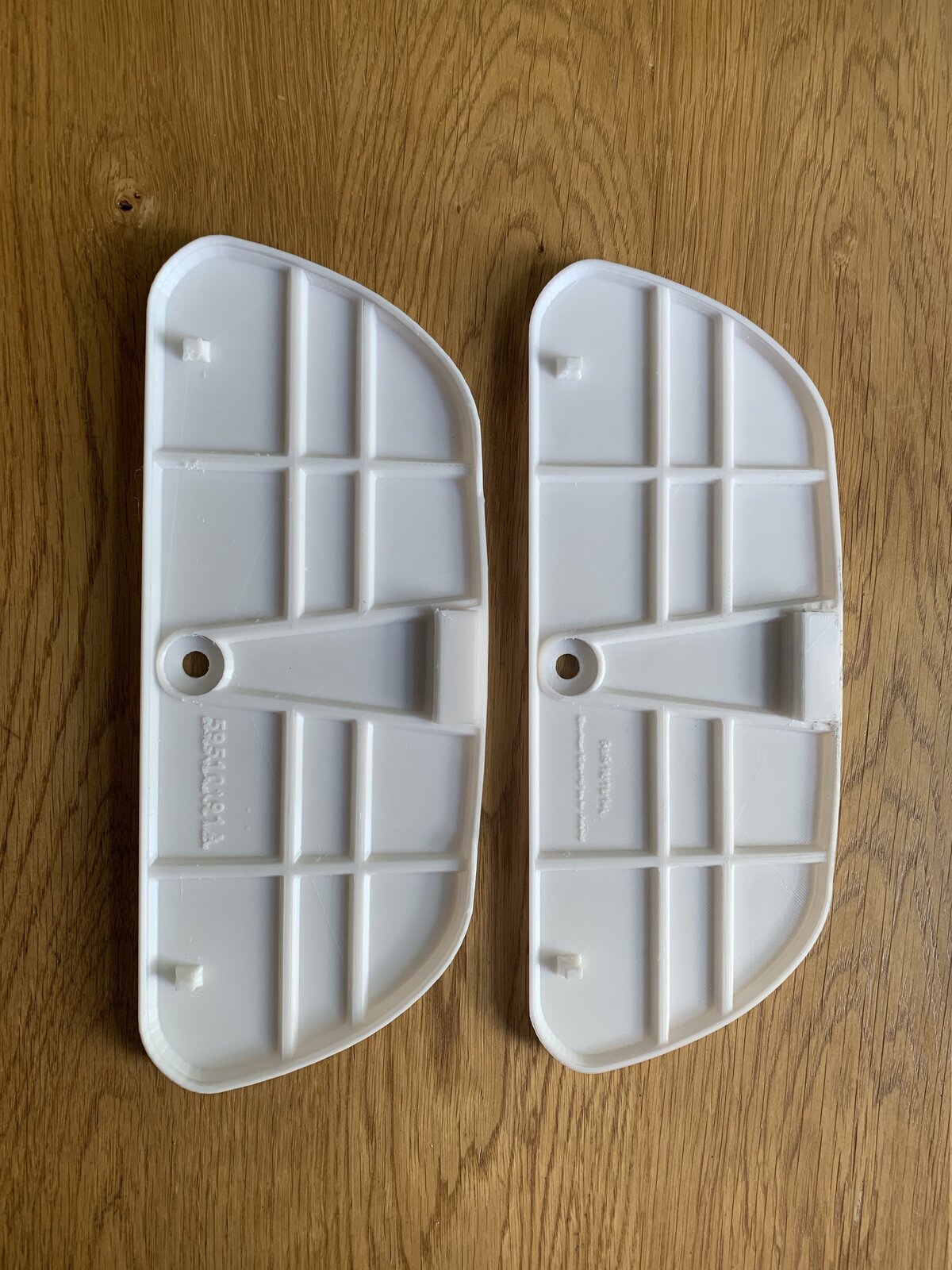

  1. After taking a few photos and measurements of the rear seat pad for the 888, I have spent time getting a CAD drawing done so I can get some printed (3D printed). The dimensions are pretty damn close and I expect to get it padded and then covered in vinyl, to make it look authentic.
    First prints done and 2 versions.

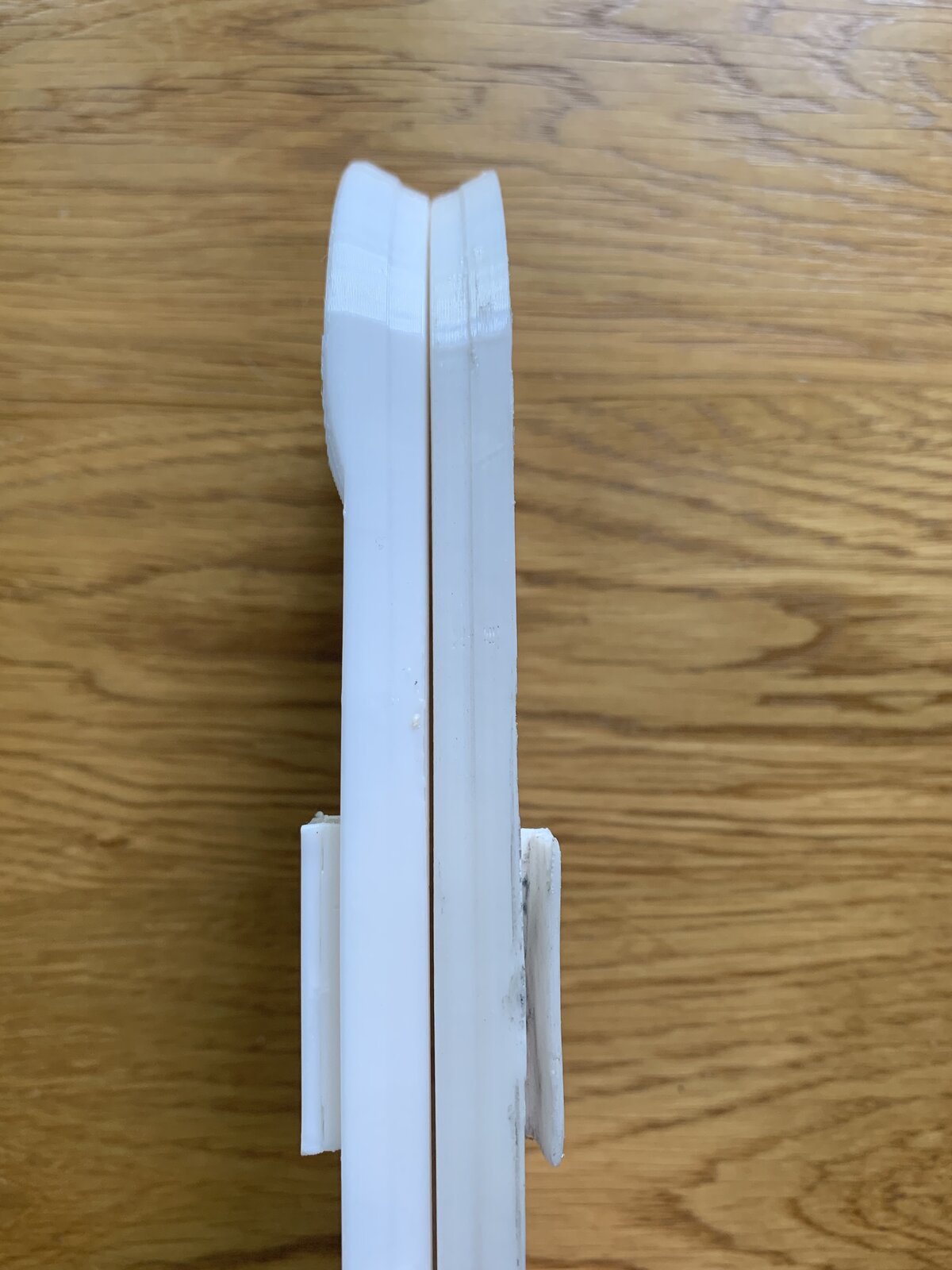

    As Stig (851 and 888 forum) pointed out to me, the section at the back of the seat unit isn't flat, in fact it curves gently. The first version is flat, and depending on the material, a bit of heat may well bend it nicely (not tried it yet). The second version has a raised edge that can be shaped by anyone wanting to get it right for their rear seat unit (as I am sure they all have little discrepancies in shape).

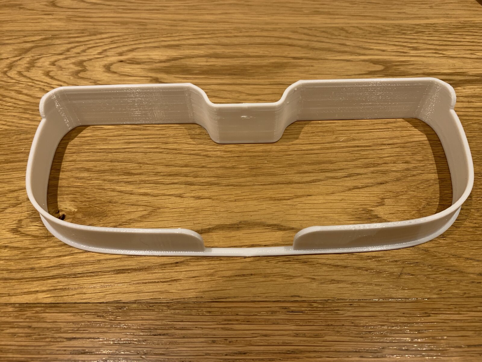

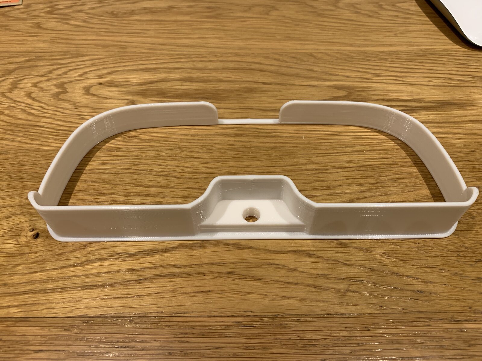

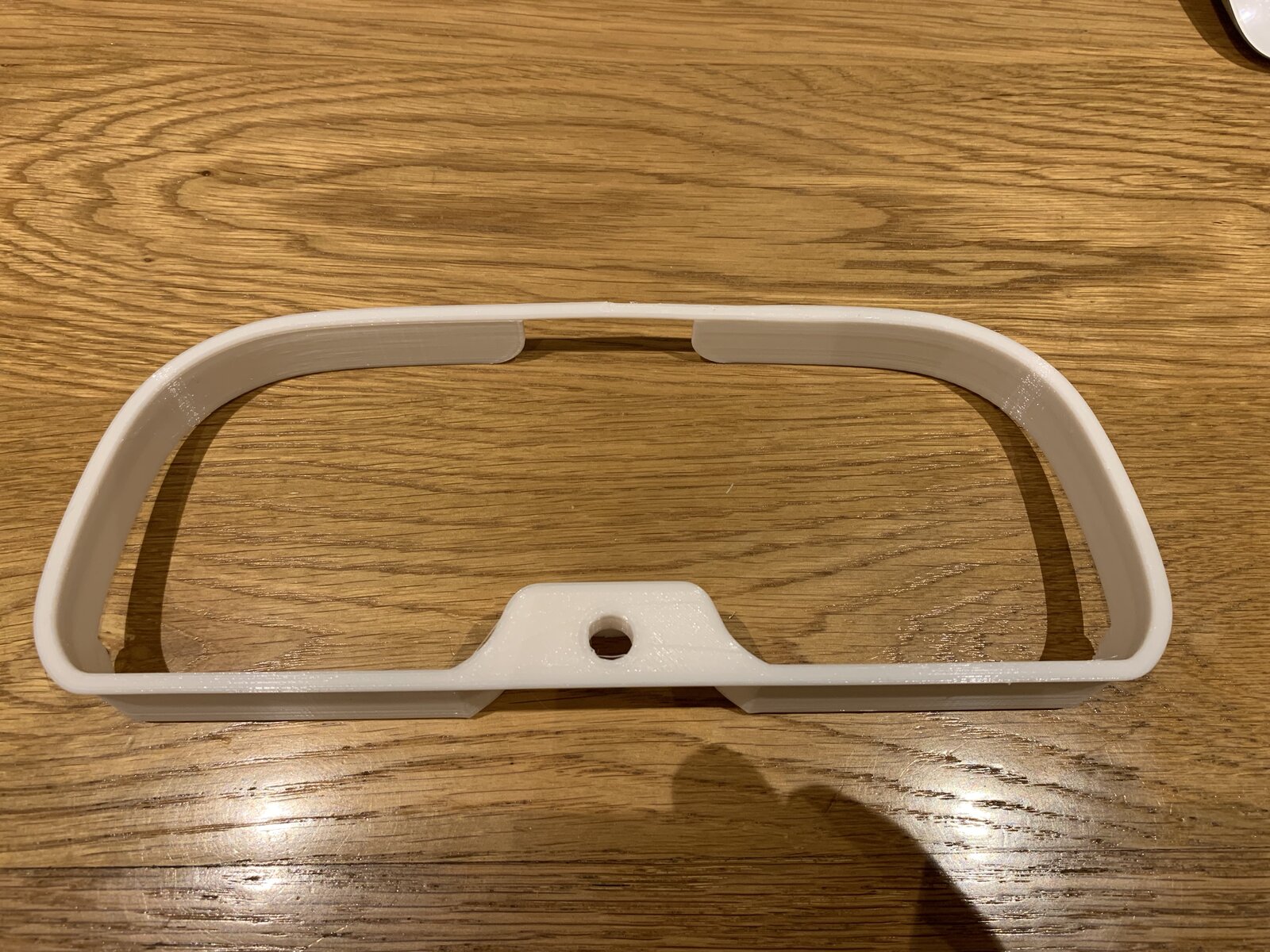

  4. So after a few hours measuring and designing in CAD, I have also done a frame that can be used as a template for the hole (for aftermarket seats units), as well as to be used as an insert that can be stuck in with epoxy once the hole is cut out. Just doing a small tweak to my seat pad base plate and should be ready for me to try out some Dzus fastener options.
    You will see there is a 2mm lip around the edge to allow the frame to sit in the hole, but this would be hidden by the seat pad once in place. LCexP0P%RkKhgxjKnp%isw.jpg WlMDMH5LQOOffjFKK0ZzCQ.jpg 1bOfimgKRlibYpL%6j+qXA.jpg x51dTkwhScWo3M%EUkpYYg.jpg

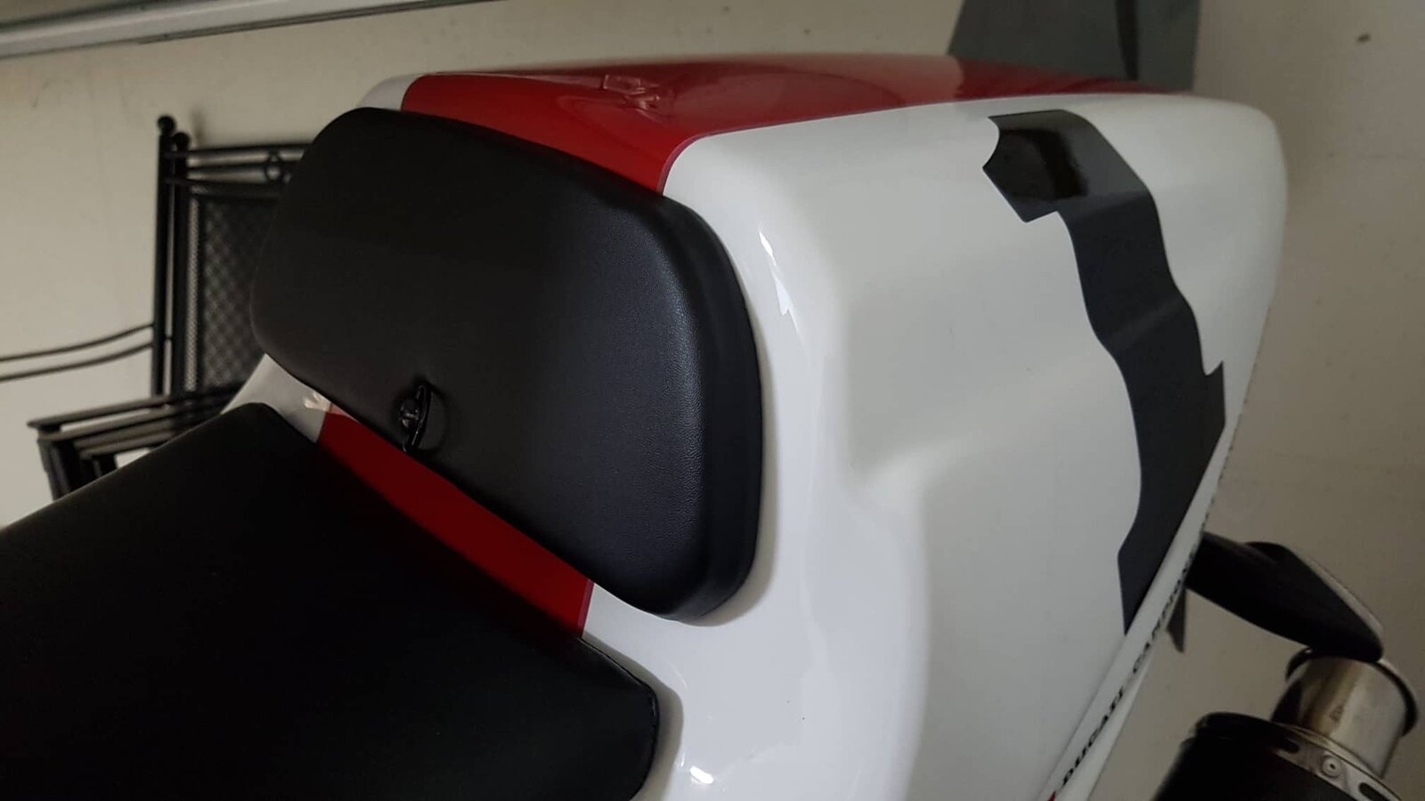

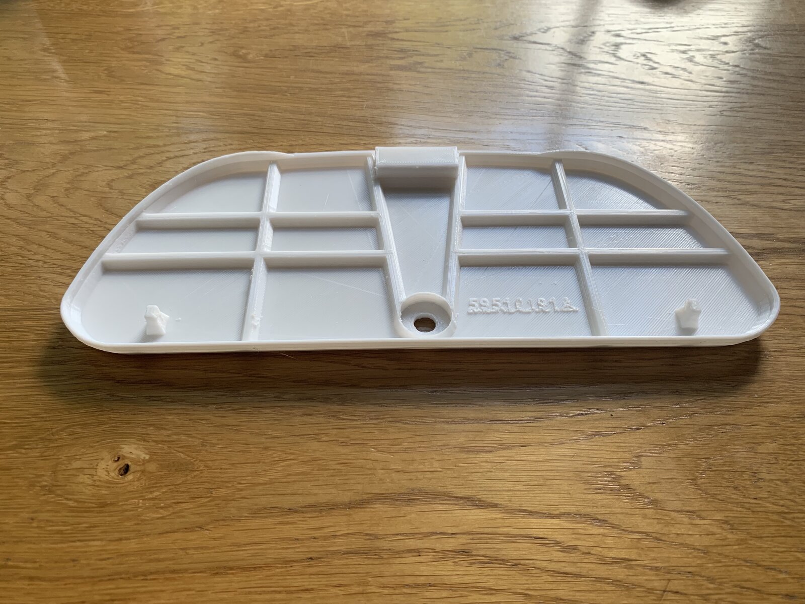

  6. Chris - I print them to order and sent a couple down your neck of the woods only a couple of weeks ago (assuming you are from the ANZ region). One of the guys in Switzerland who took one wanted to do the same as he is quite a tall bloke. He sent me this photo of it covered and in place.
  7. Thanks for your reply & photo.
    That looks absolutely spot on.
    I've got a mate with an SP5 whom is equally tall. I will ask him if he is interested as well and possibly get a couple sent down (yes you're right, NZ)
