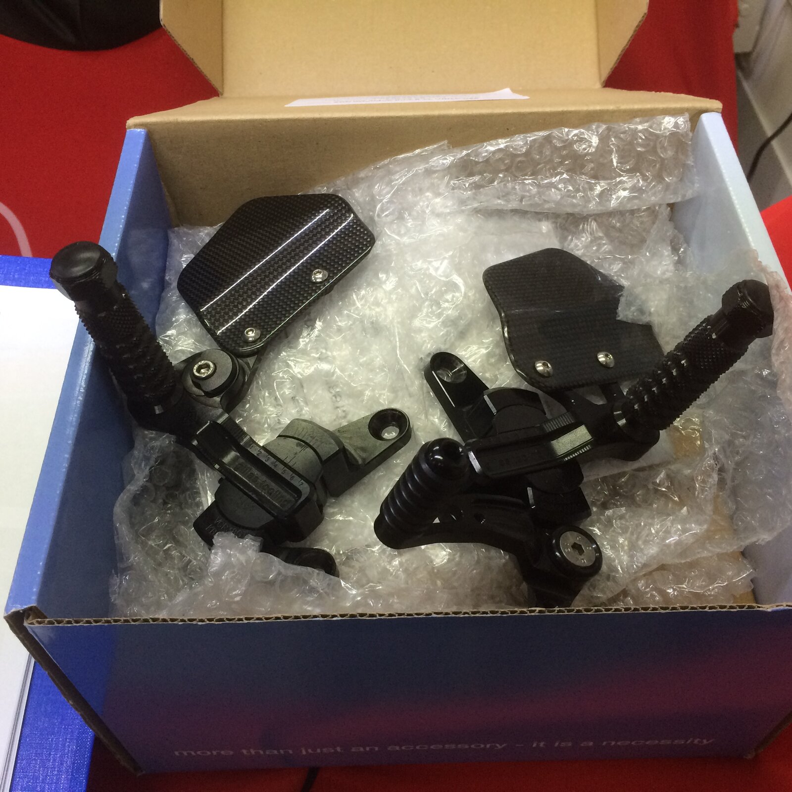

  1. Ok so bought some giamoto rear sets and didn't like the feel so bought some ducabike sets as they looked similar to standard set up which is what I wanted .... Wrong .. these put my feet higher and slightly more forward so I now feel squashed up .... I give up .. think I'll stick with the boring stock ones .... Probably stuck with the ducabike sets as I doubt they'll refund opened goods :( aaarrggggg

  3. Yes they do but all settings are higher than the standard pegs

  6. Not really lol

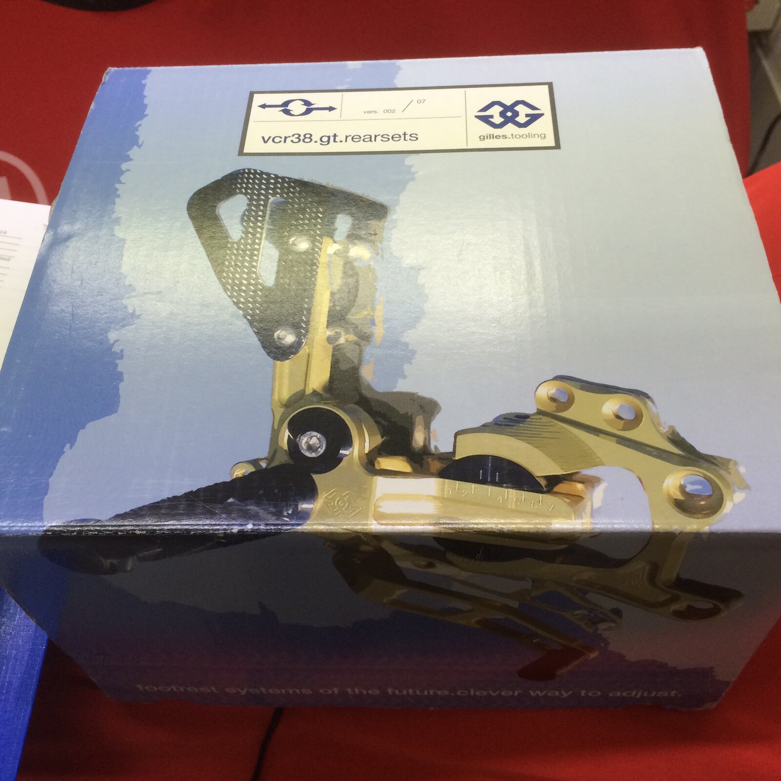

  7. I'm 6'1" and have the Gilles VCR sets on my 1098. I find them very comfortable, especially mated to the higher Superpole seat. :upyeah: They have great all round adjustability.
  8. Thanks but I'm probably stuck with theses now

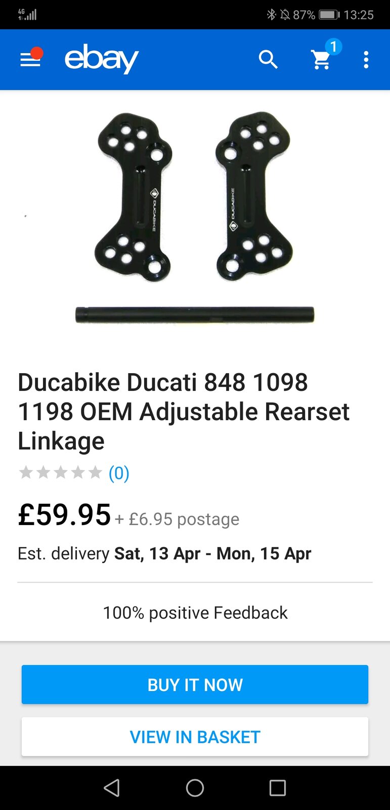

  9. Hi, you can get nice looking jack up plates but if you swap left for right, they become jack down plates. So you can use your Ducabike ones. J
  10. OK sounds like an option .. Would you have a link by any chance

  11. I'll take a look and put up a pic of what I mean. J
  12. Thanks ... Think I know what you're referring too though

  16. Cheers. They look identical to the ducabike ones I have
