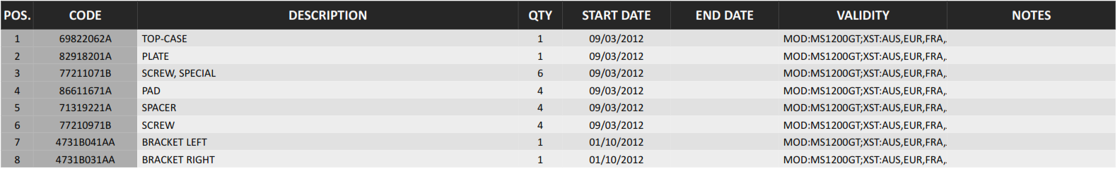

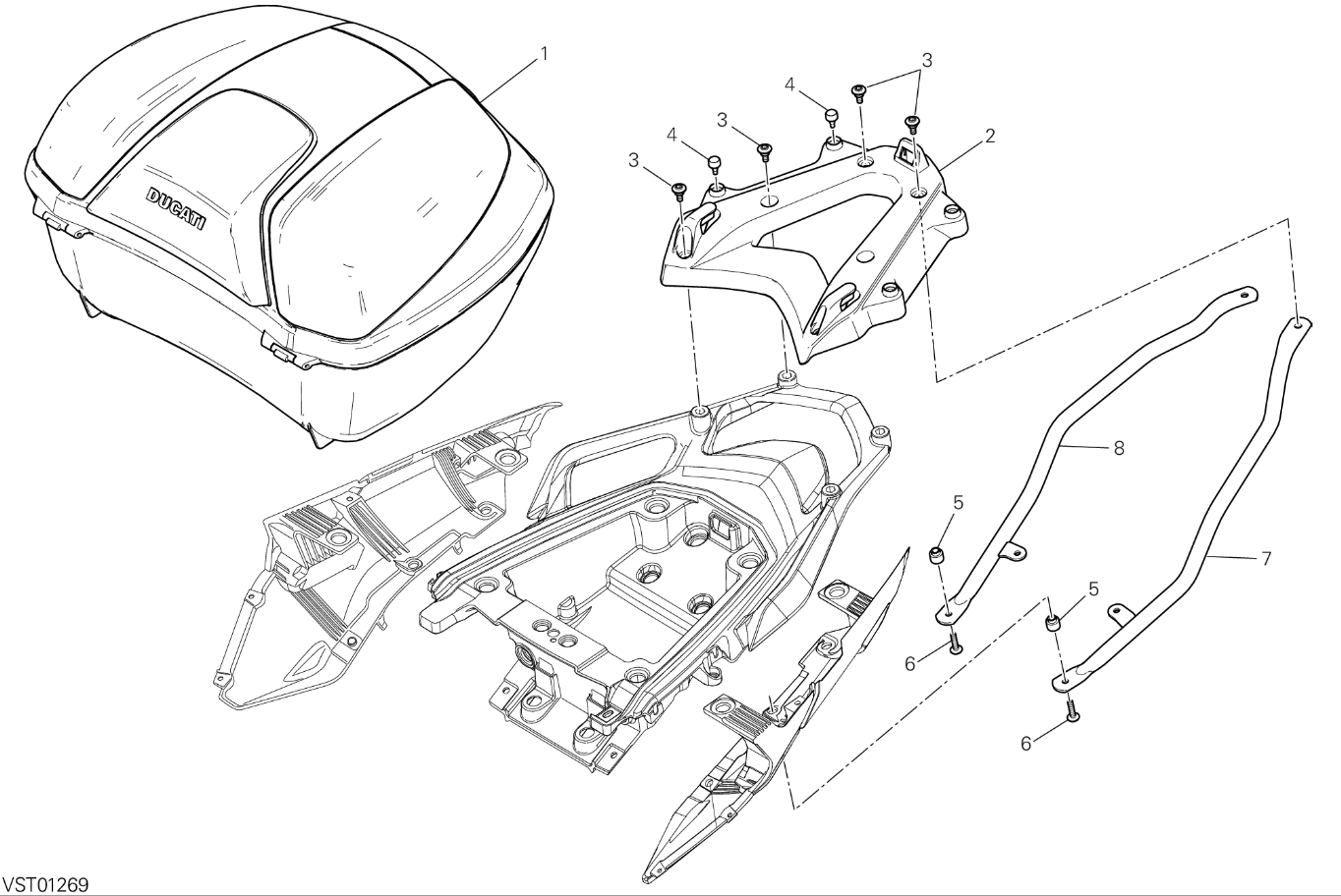

    Whilst the rear seat unit is in bits I am going to get the top box supports re powder coated and get some new mounting bolts. Just been through the parts catalogue and the top box mount isn't listed, does anyone have any ideas?
  2. For pre-DVT models, look at the parts list for the 2013-14 GT model, which unfortunately doesn't appear to be available on the Ducati web site. Fortunately I'd save a copy a few years back:
  3. How old & what mileage. Mines 2017 dvt & making me wonder whether to take the bolt out & copper slip it for futureproofing.
  4. Thanks Steve, exactly what I was after.
