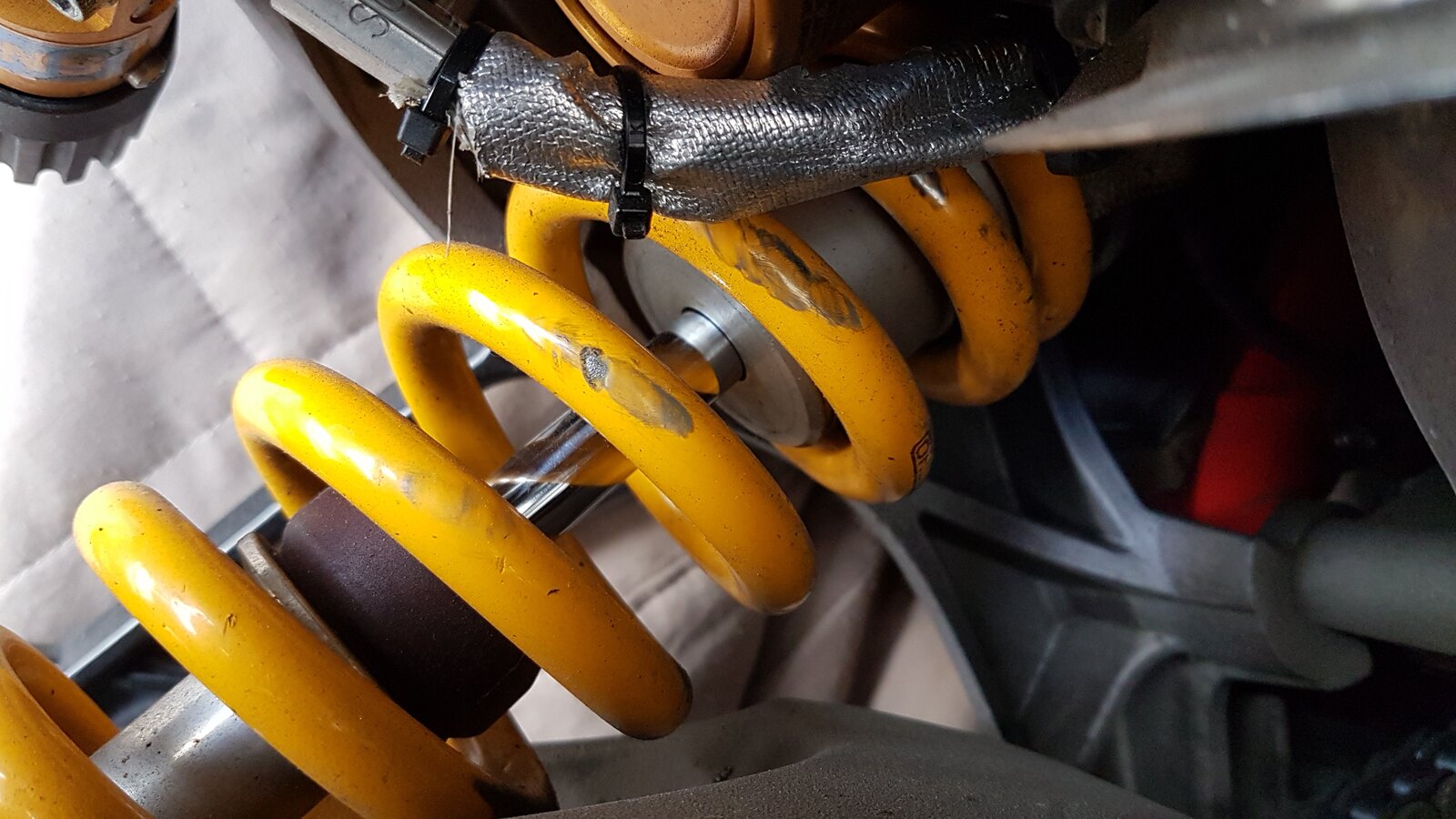

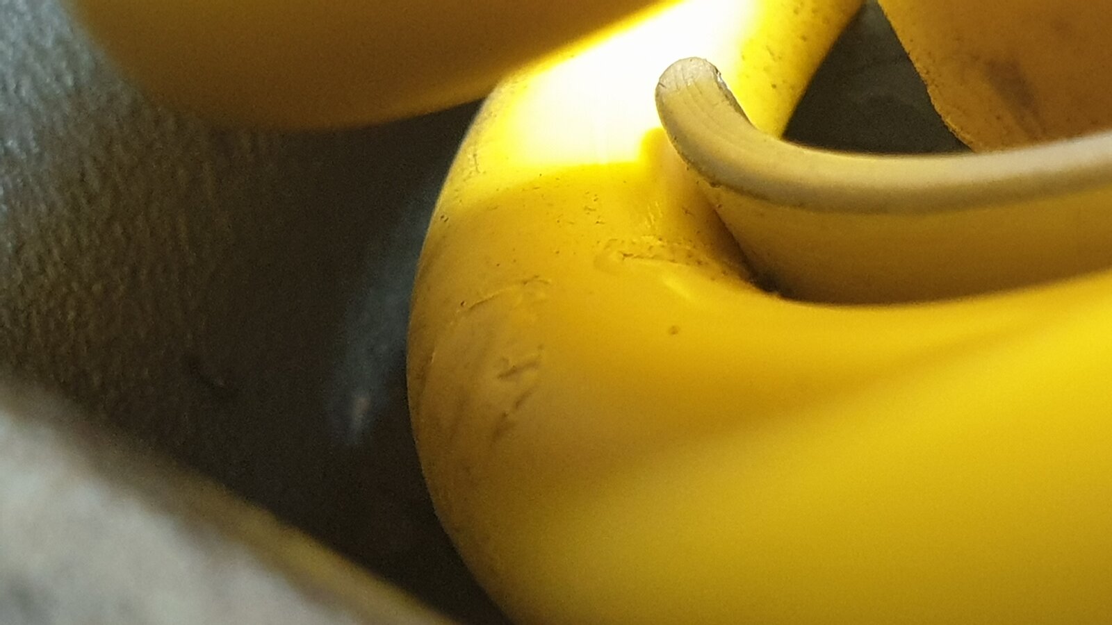

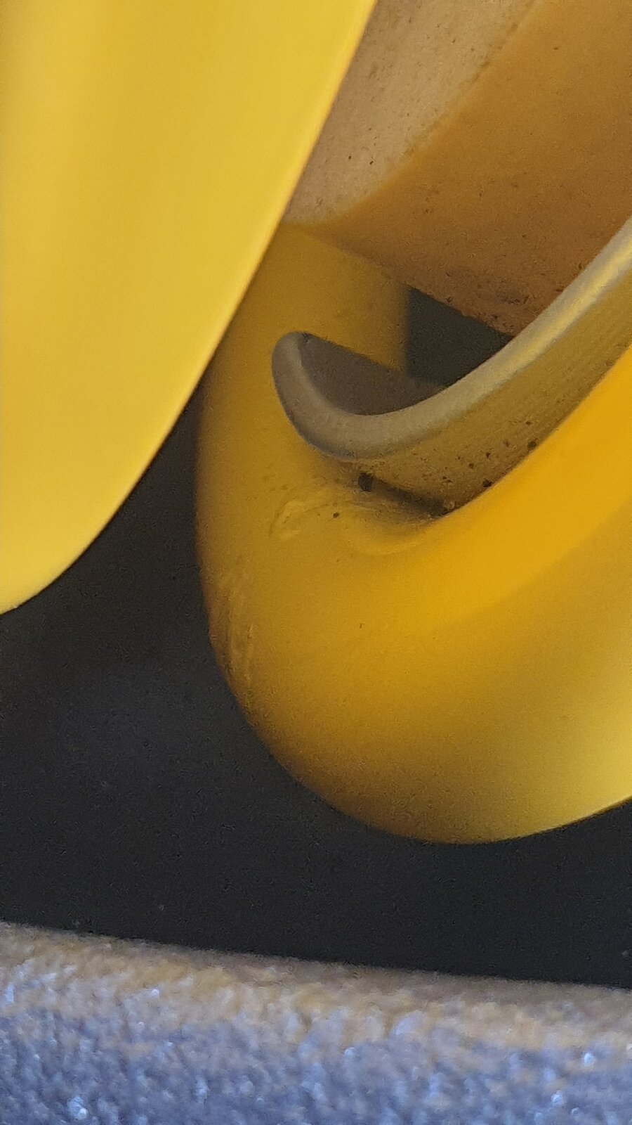

    Just after some clarification please.
    Has anyone else noticed anything like the pictures on their shock spring?
    6 weeks old and 1400 miles.
    Thanks

  3. I think @TonyMNo1 had the same problem and they replaced the whole shock under warranty?
  4. :( Absolutely as T4M has said above, I've experienced the very same and in fact my 1260S is in Riders, Bristol as I type, being dealt with under warranty.
    I suggest getting in touch with your dealer ASAP and be sure to not get fobbed off with the Ducati approach around 'aesthetics' not being covered!
    Your Dealership will no doubt (hopefully :eyes:) be very supportive, however, my bike developed this issue after circa 26 months, yet yours is hardly 2 months old. WOW a real quality control issue here, which seems to me to be something Ducati need to look more closely into, as it doesn't appear to be limited to this component, from what some other forum members have posted about.
    Good luck in your rectification quest.:upyeah::thinkingface:

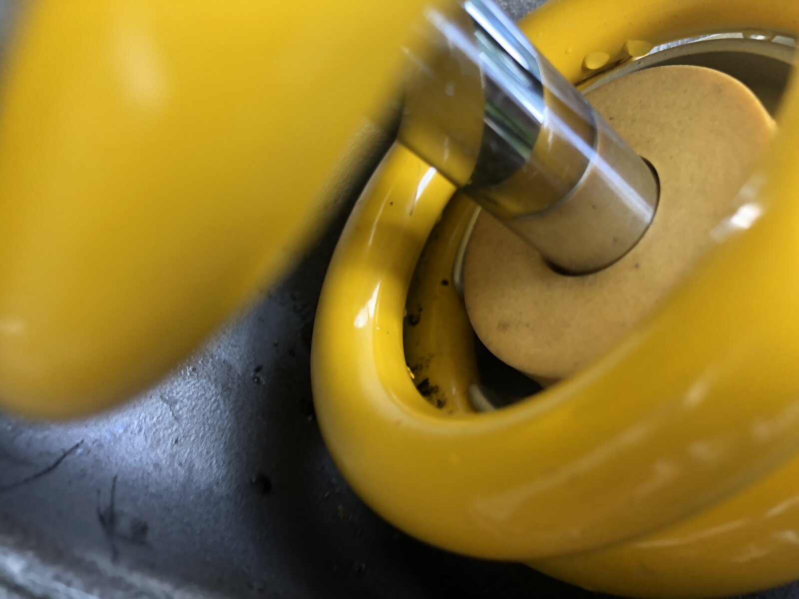

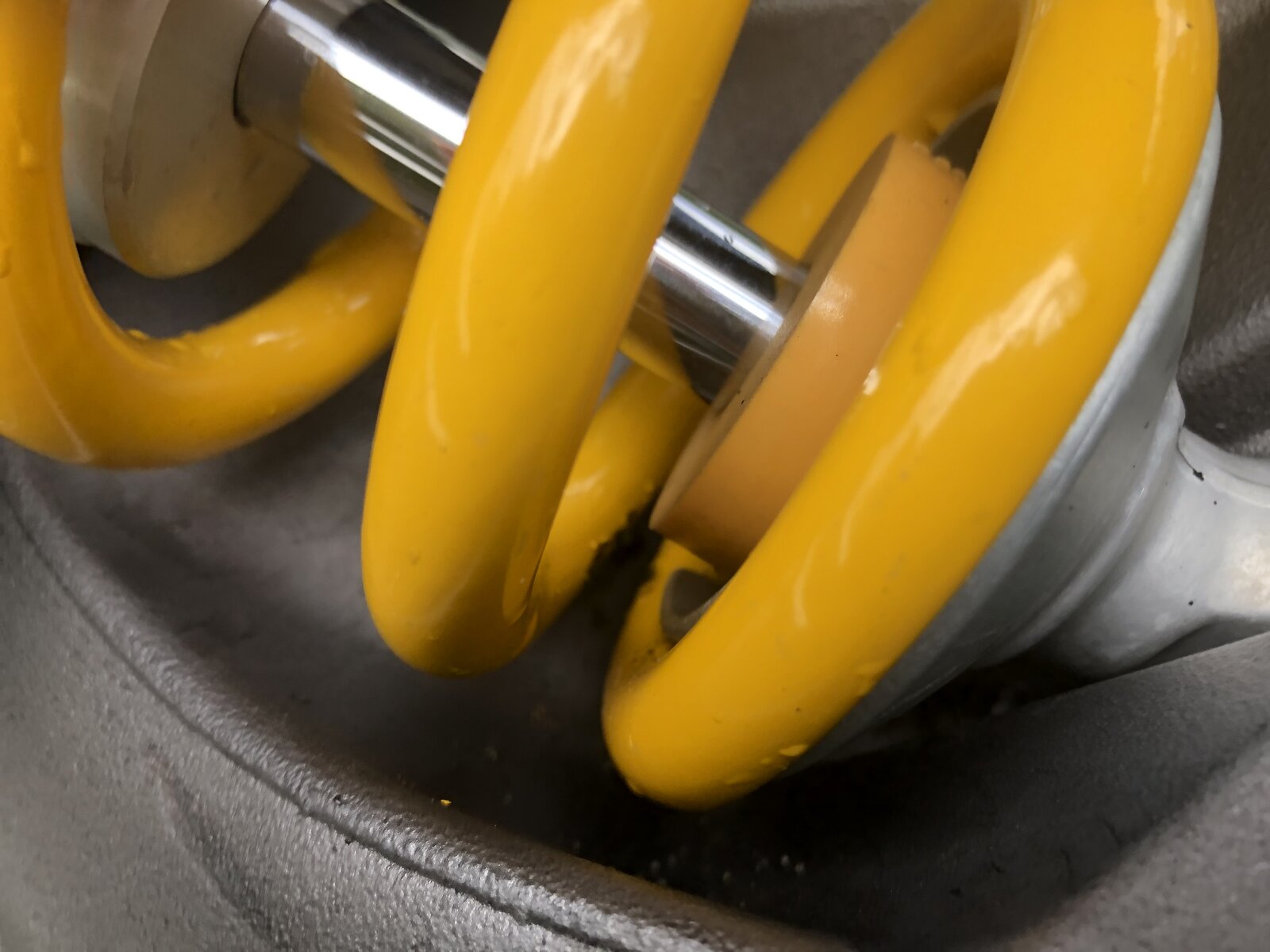

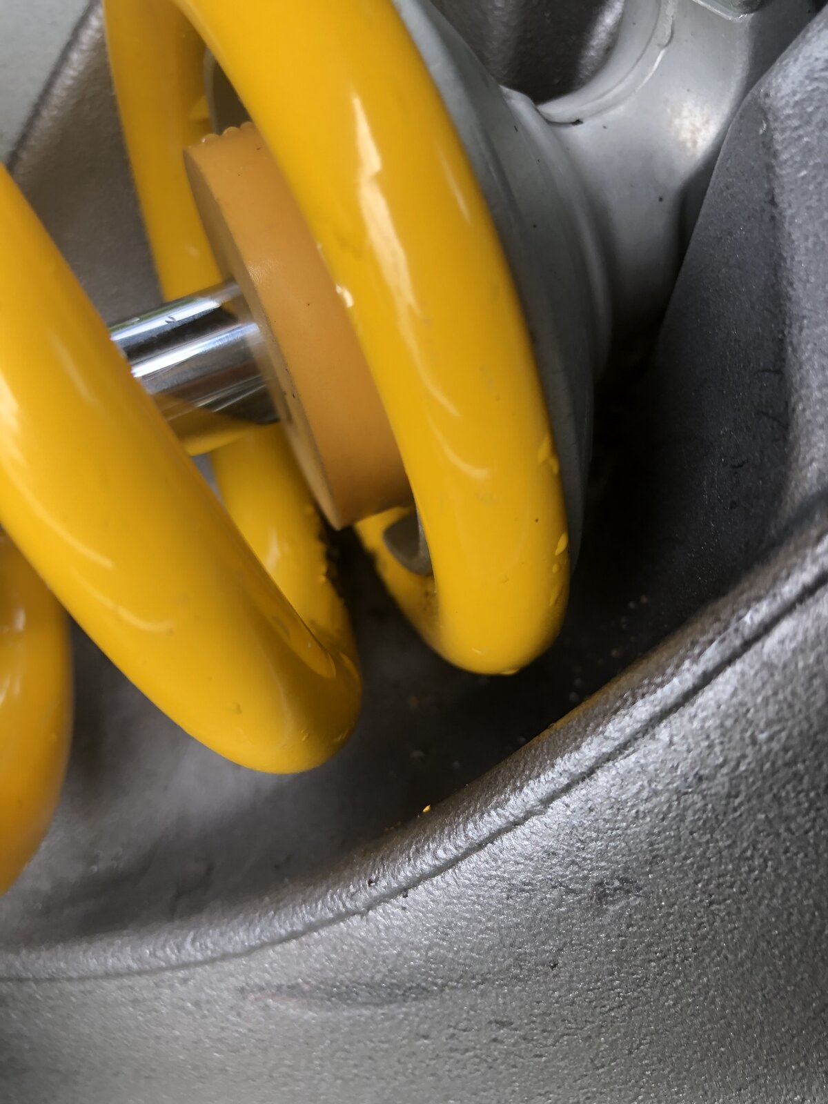

  8. My bike has circa 11k miles and is just over 30 months old, with the issue highlighted by me around August 2020.
    The paint delamination issue on mine isn't quite as bad as yours though. I've attached a couple of photos FYI and IMO, the problem is all about blockage of the swing arm drain hole and the habit the bike has of collecting debris there, which when drainage is interfered with, causes the water + debris to act as a grinder. Add to this absolutely crap quality control with paint product selection & usage + application and you end up with a perfect storm. End result: as-is!!
    And my bike isn't cleaned & dried after every ride, although it does receive its fair share of OCD treatment, including ACF50 annually.
