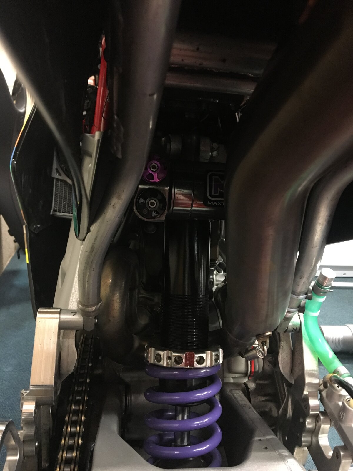

  1. Howdy all
    If i fit a slightly longer rear shock spring will it raise the back end?
    Also will it hugely mess with the bike geometry and make it handle like poo
    Cheers
    #1 Andy800, Feb 4, 2019

  7. is this on your aprilia 450 ...

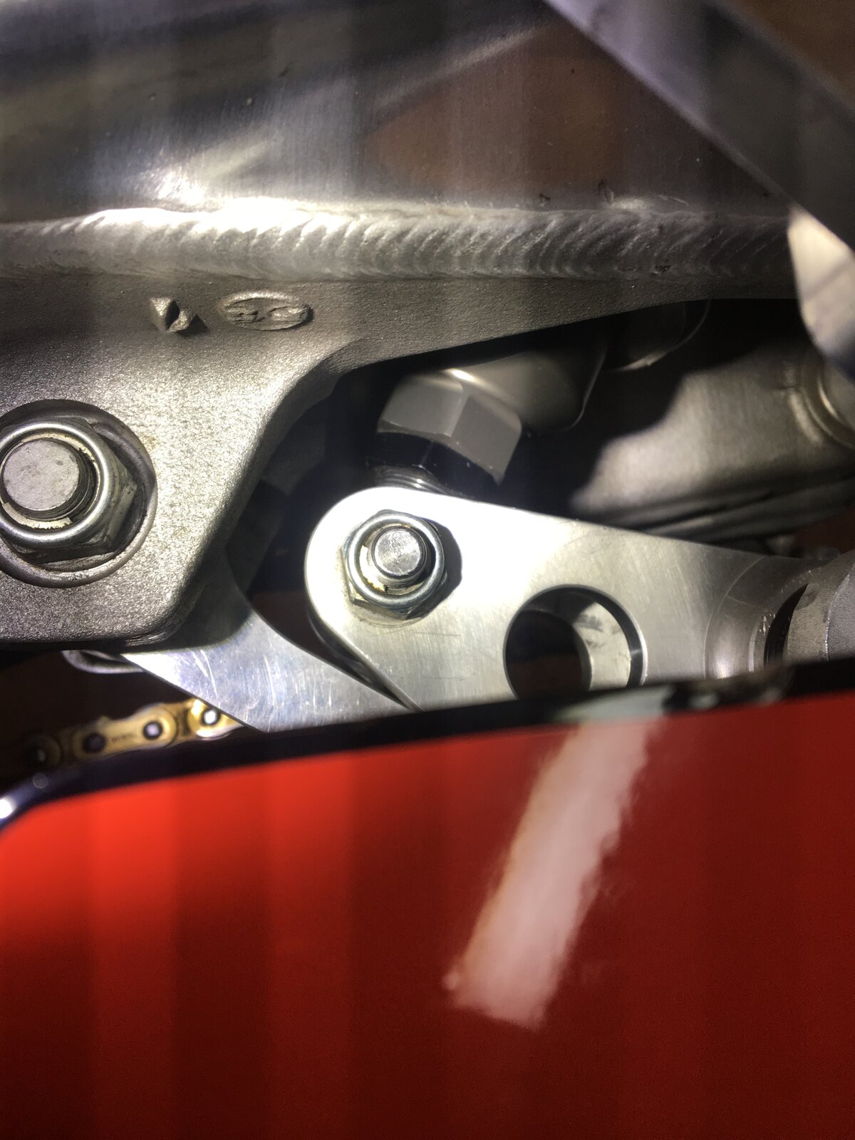

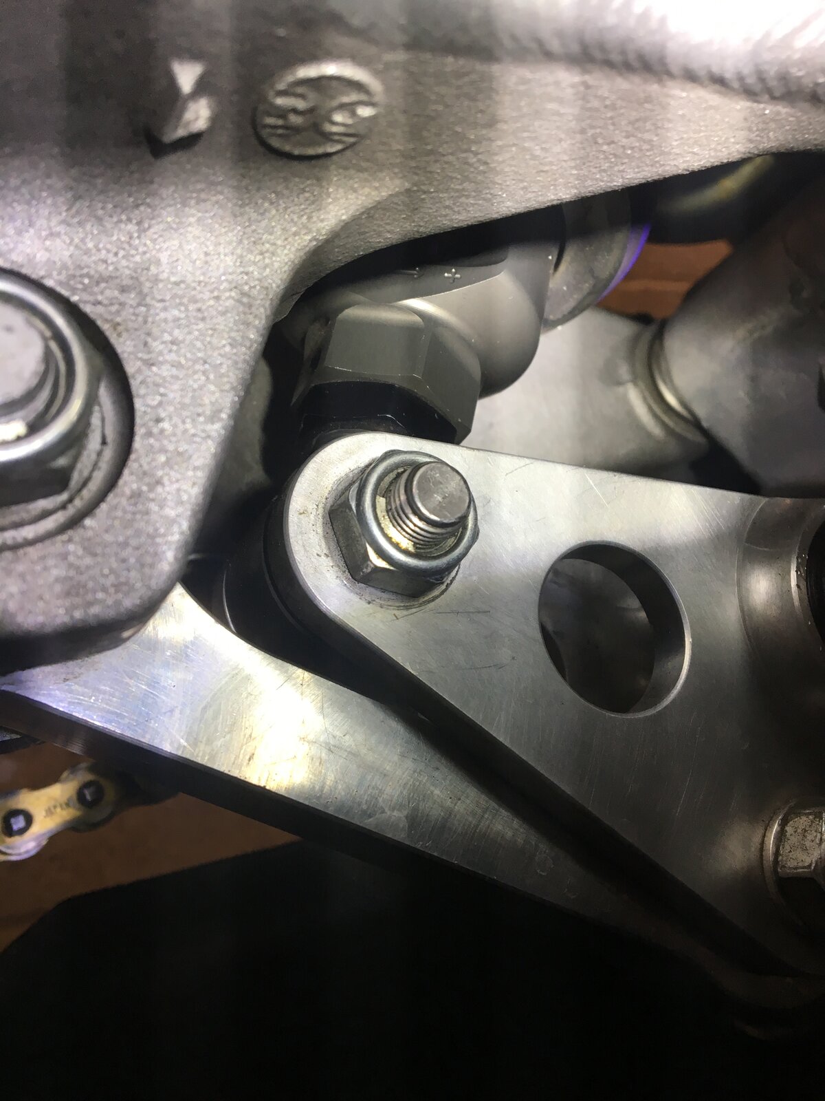

  9. It's the other end I need to see.
  10. Lower end?
  11. so support the back of the bike, take out that bottom bolt and that bottom black locking nut will i suspect undo and then you can unscrew the bottom of the shock and lengthen the eye to eye length of the shock raising the rear
  12. You can alter the shock length on that shock. It has a threaded rose joint by looks. Make a note of how much it is to start with before you make any adjustments to it. How much you can go is how much thread you have on the joint, it's just a case of undoing the lock nut and removing the lower mount. Given you have a dogbone rising rate set up there I would advise 5mm increments to start off with as it also will change the geometry of the rear wheel.
