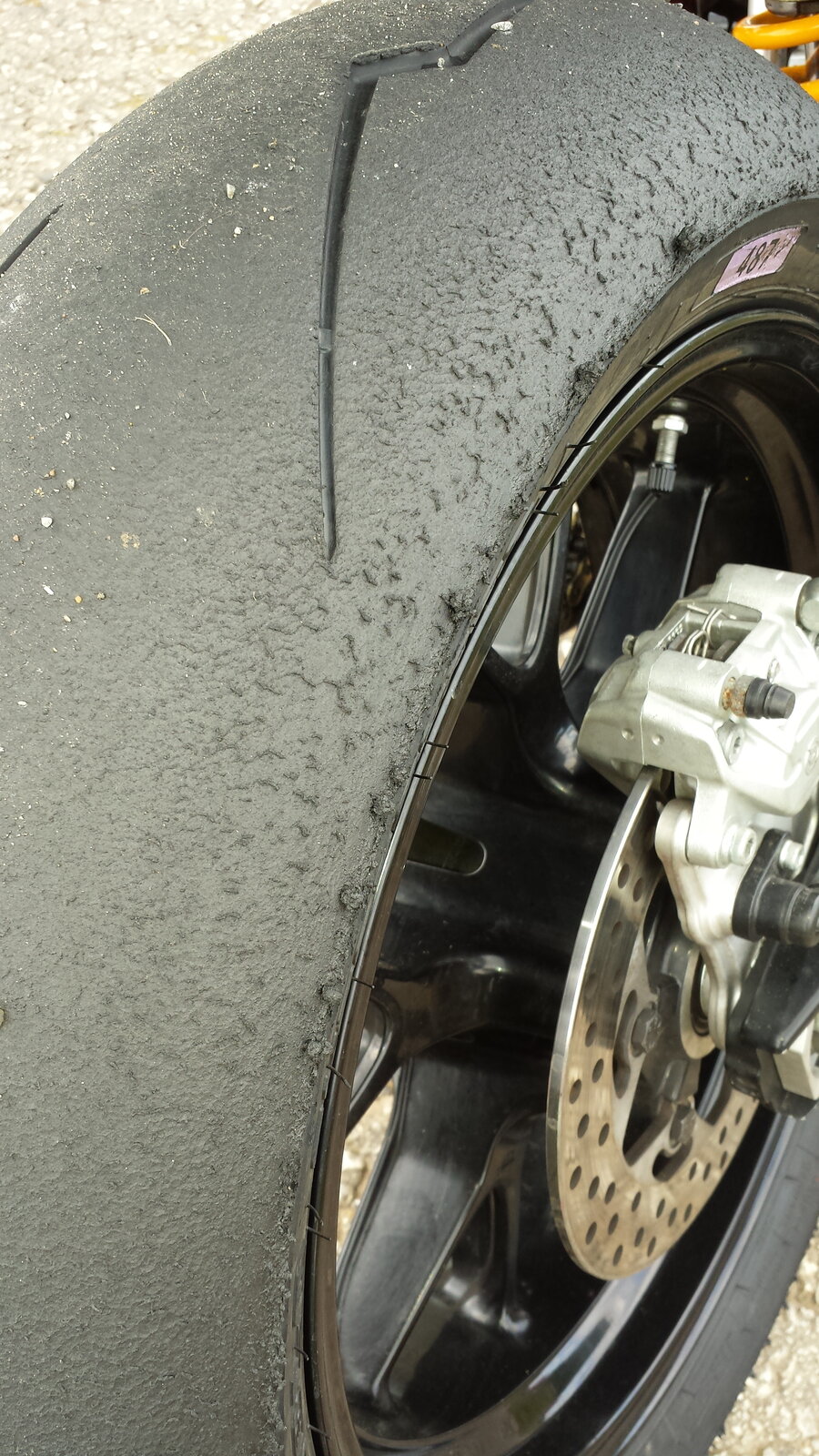

  5. I run a 180/60 at the rear (available ex-race Supercorsa scrubs) - have had to remove the hugger - corners beautifully and scrubs to the edge FB_IMG_1467645363756.jpg
