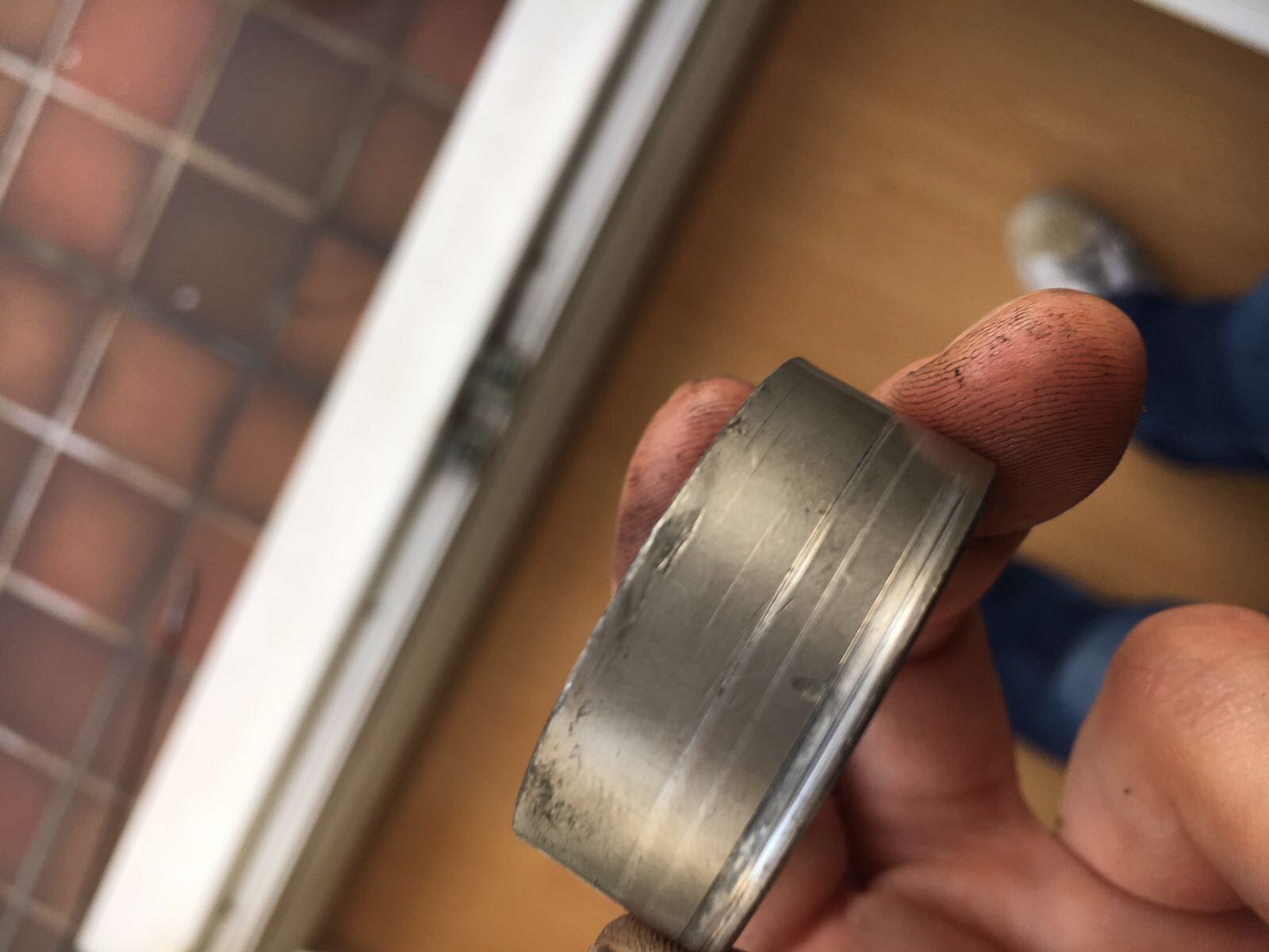

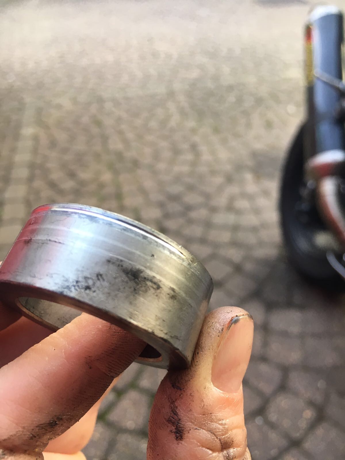

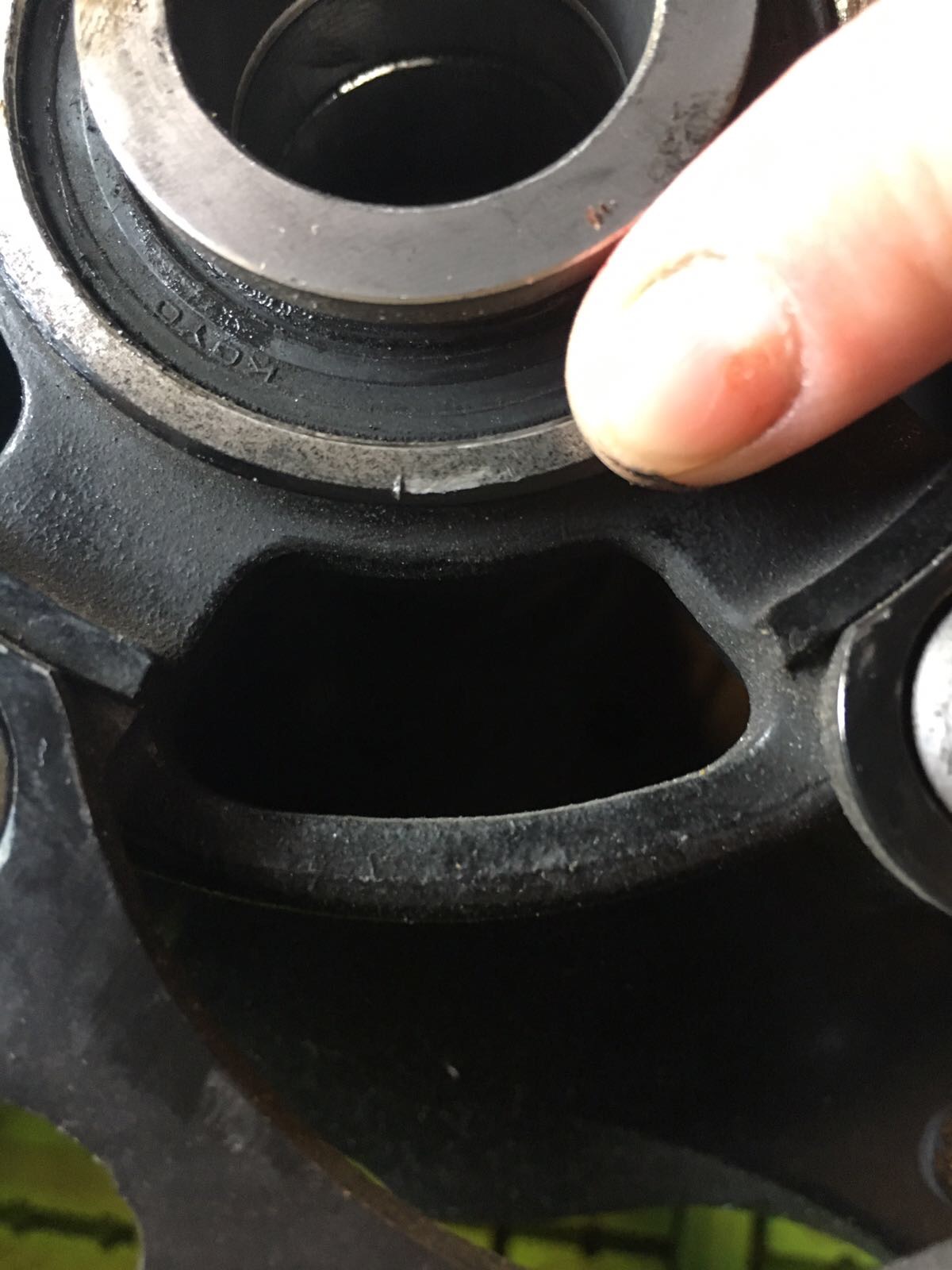

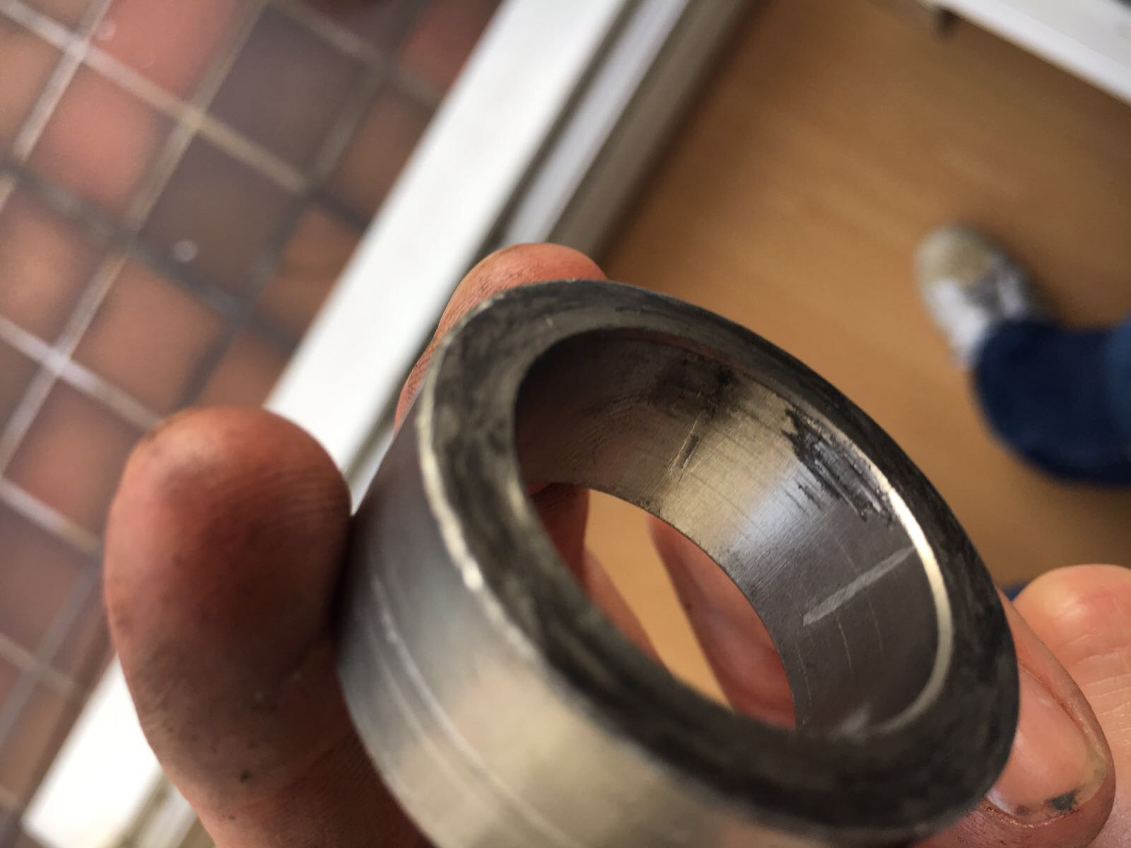

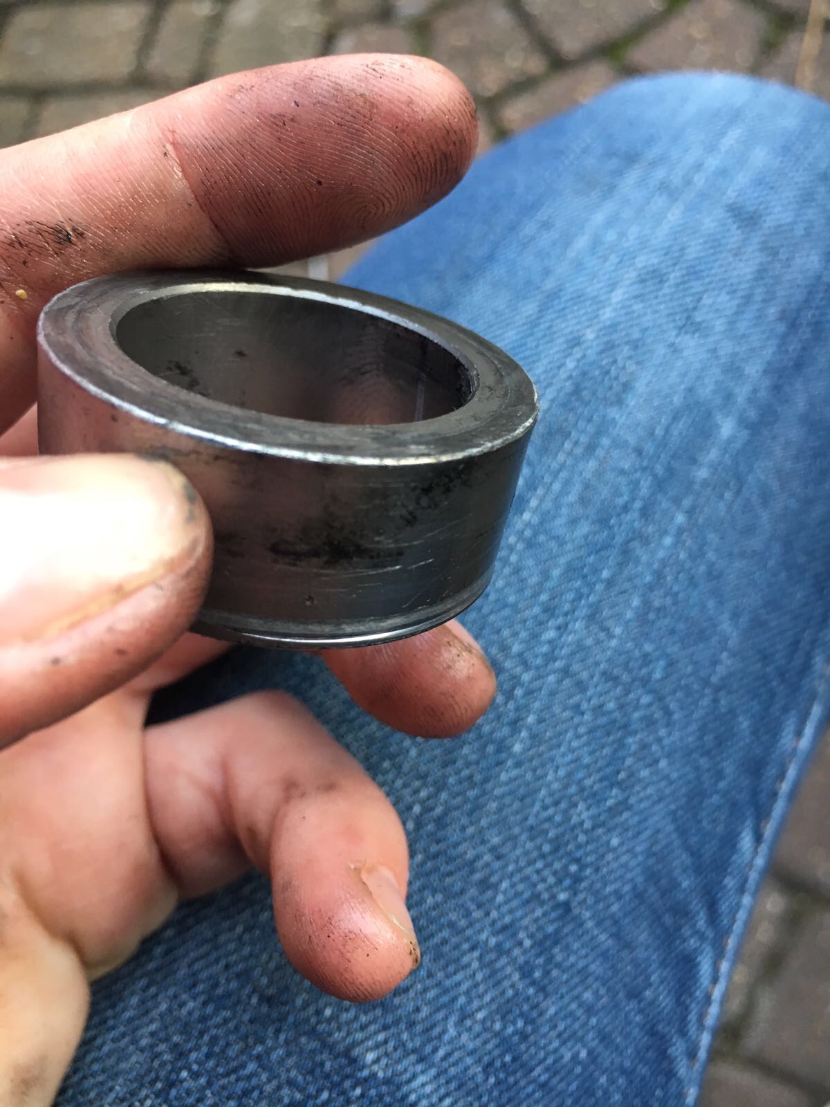

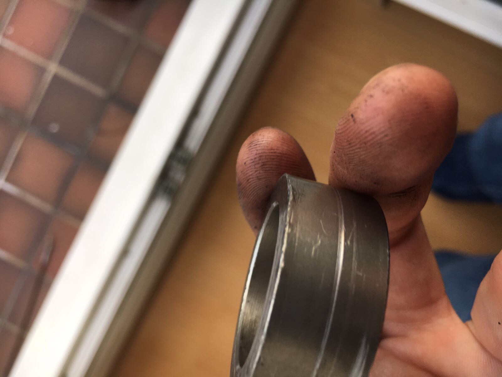

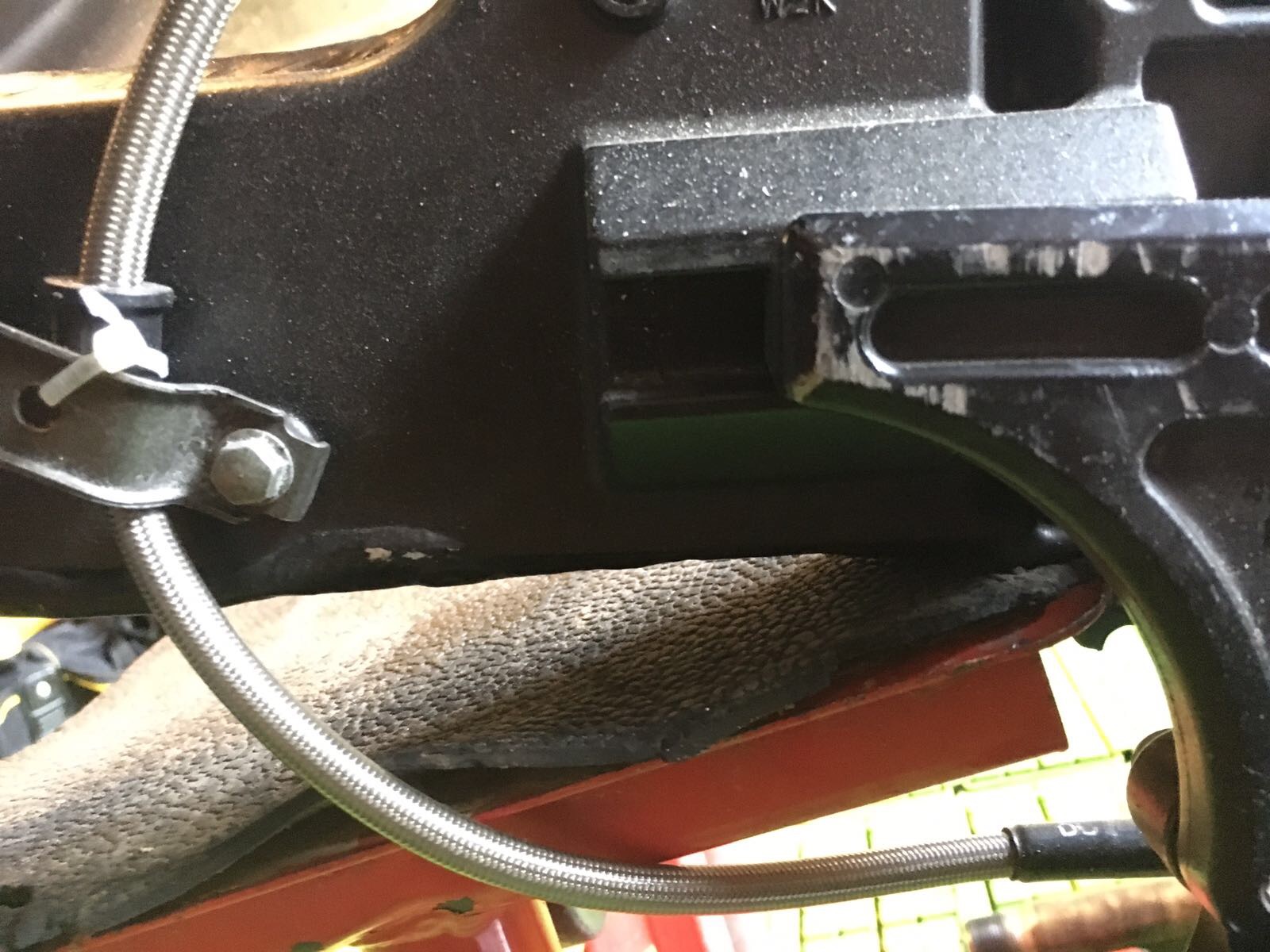

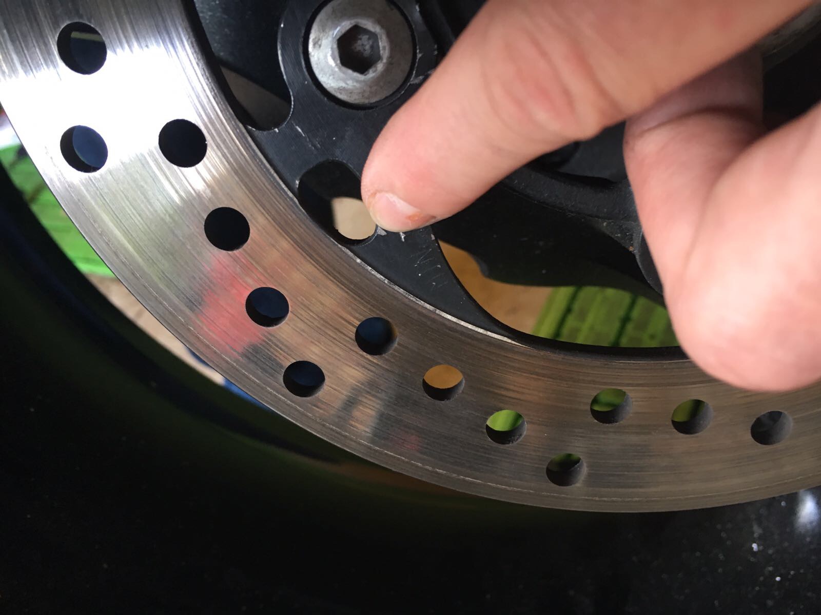

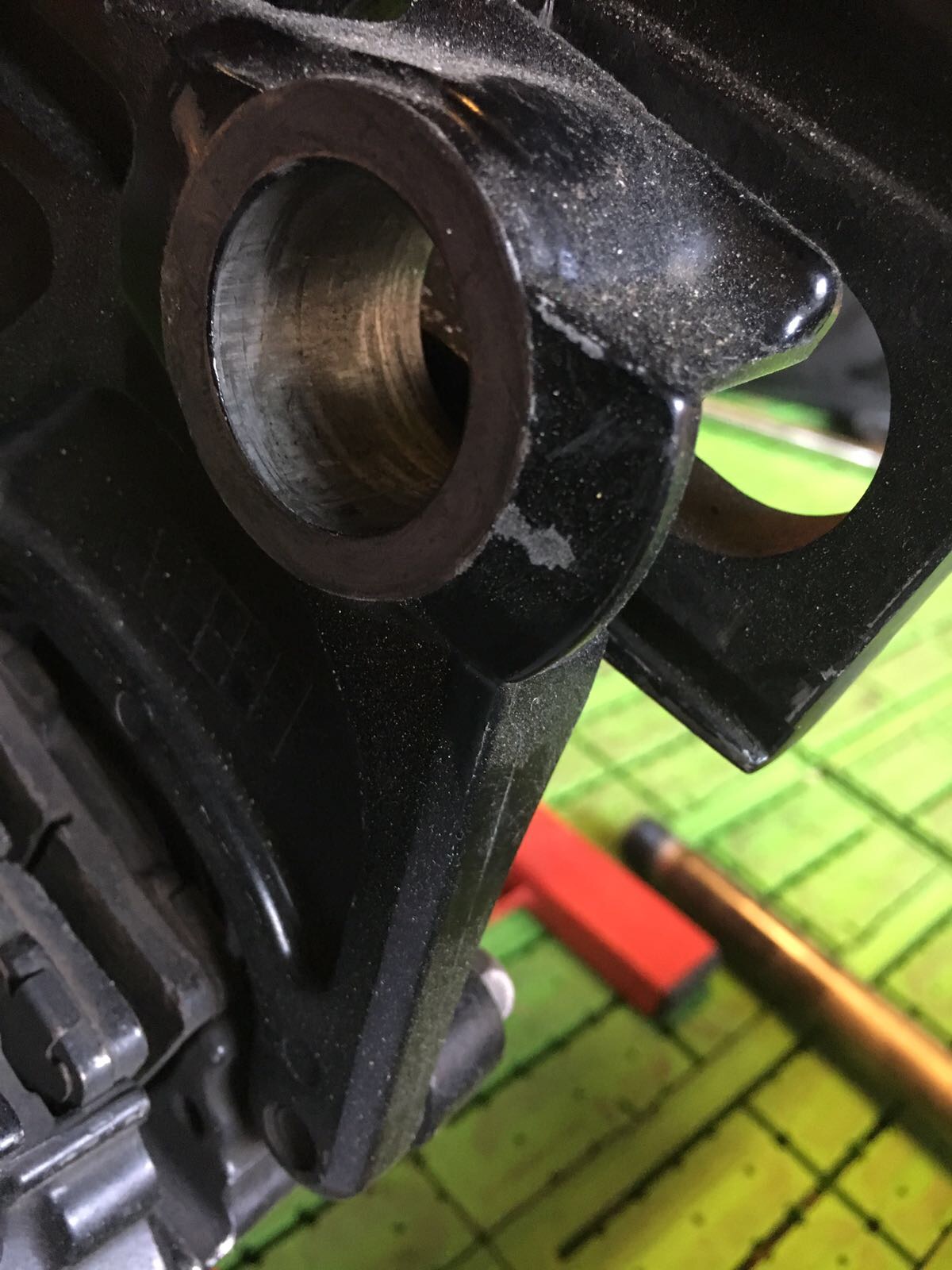

  2. So we've just been taking a further look at this tonight. I think it's impossible for the wheel to go far enough out of line for the tyre to touch the swingarm but the rear brake disc has definitely hit the caliper holder which I reckon is a very likely culprit; (possibly locking itself against the brake pads or caliper as well??). You can see a distinct nick in the wheel spacer where it pushed up against something as well which all supports the theory. I'll stick a few pictures when I get them for you guys to see if you agree.

  5. Can clearly see a chunk taken out of the spacer when it was slammed into presumably the swing arm. The rear disc is ground on the caliper holder. I'm feeling pretty confident the tight chain pulling the wheel out of alignement has caused this now. I'm still puzzled why the chain was so tight after the crash as I'd have thought we would have noticed it beforehand, but maybe it's a result of the wheel coming out of alignement?
  6. Pete was there when I put the rear in my gixer Thur am and couldn't believe how much tighter the chain was when nipped up. He could feel the immediate tension increase when I put that last 10nm or so on it, even tho the blocks were all tight and done.

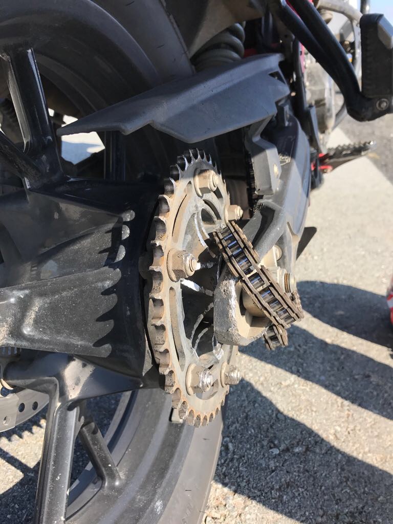

  12. GS700 on only dual carriage way in Iceland this May. Locked rear wheel in outside lane at 80 mph. Was interesting so feel your pain.
    • WTF WTF x 1

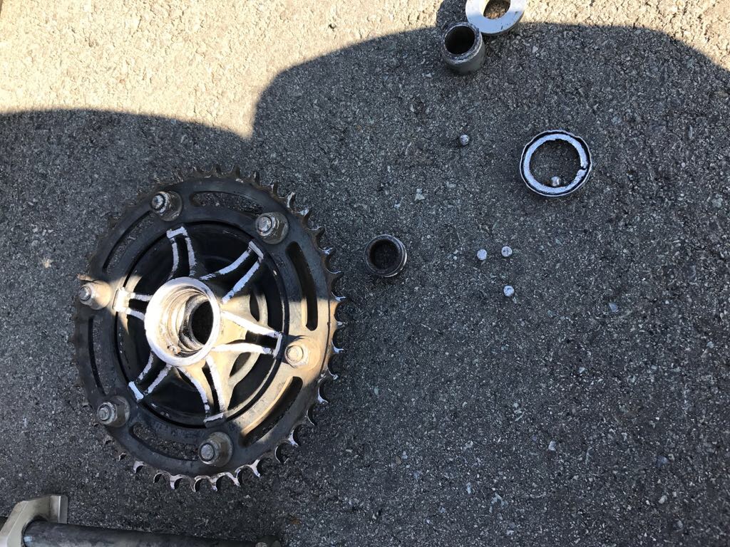

  13. Wheel bearing had collapsed, do sprocket wobbled and three chain off teeth which then jammed in between swingarm and the like. Good job it was a hire bike!

  16. If the wheel has contacted the swing-arm, rubber witness on the inner surface of the swing arm will be obvious. If no marks, no mystery didnt happen?
