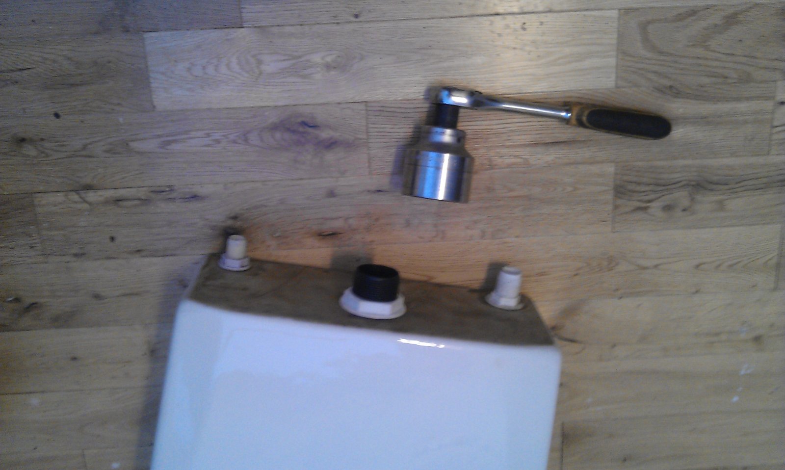

  8. The same 55 mm socket also fits a lavatory cistern, I find.
  9. Hope you don't try tightening that to 230 N-M!!!!!
  10. He'll be flushed with success

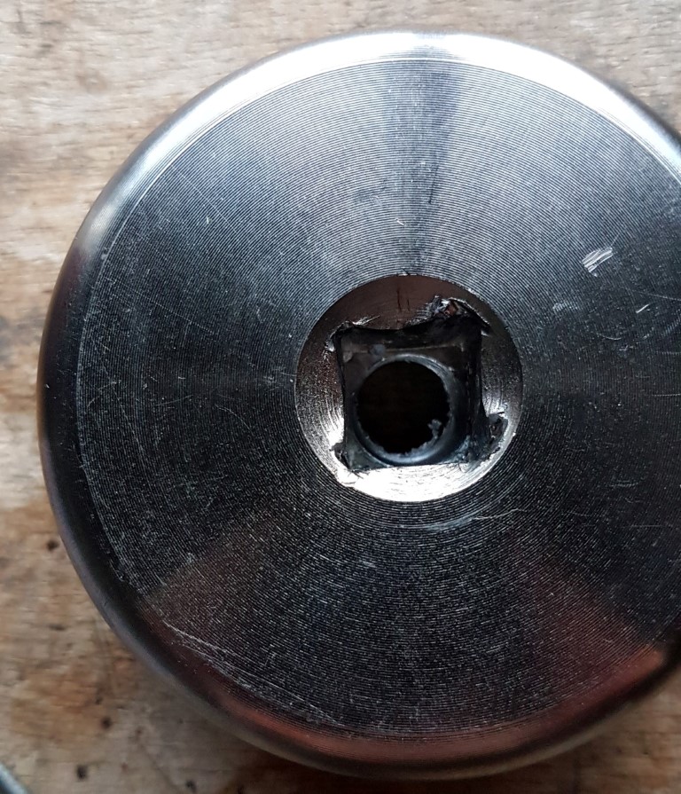

    Didn't do the socket much good though ![​IMG]
