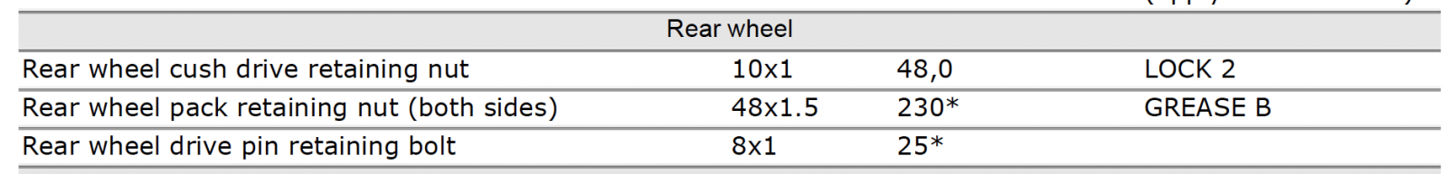

  14. The service manual quite clearly says grease.
