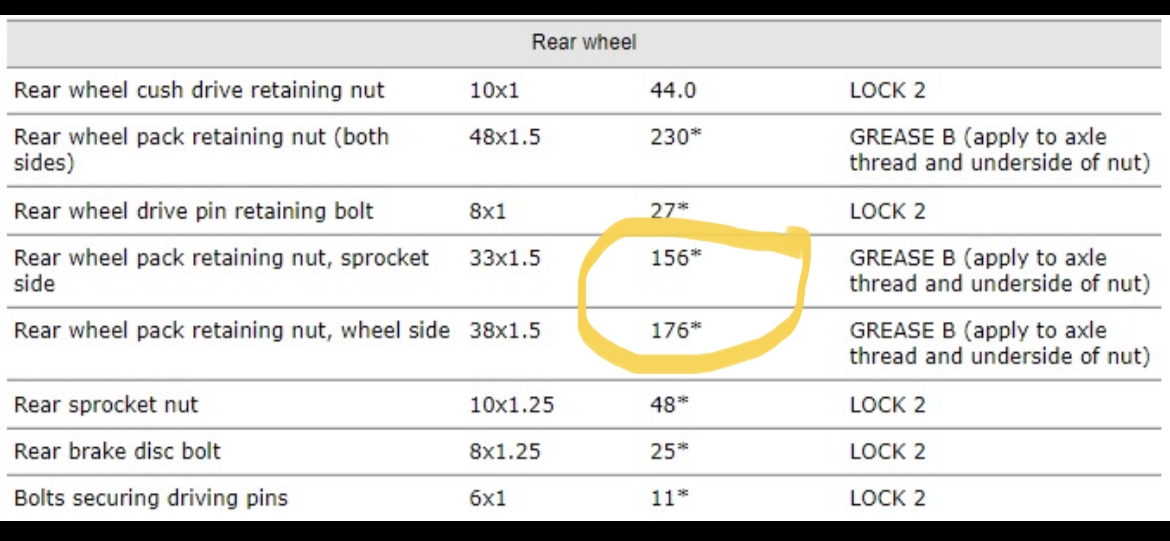

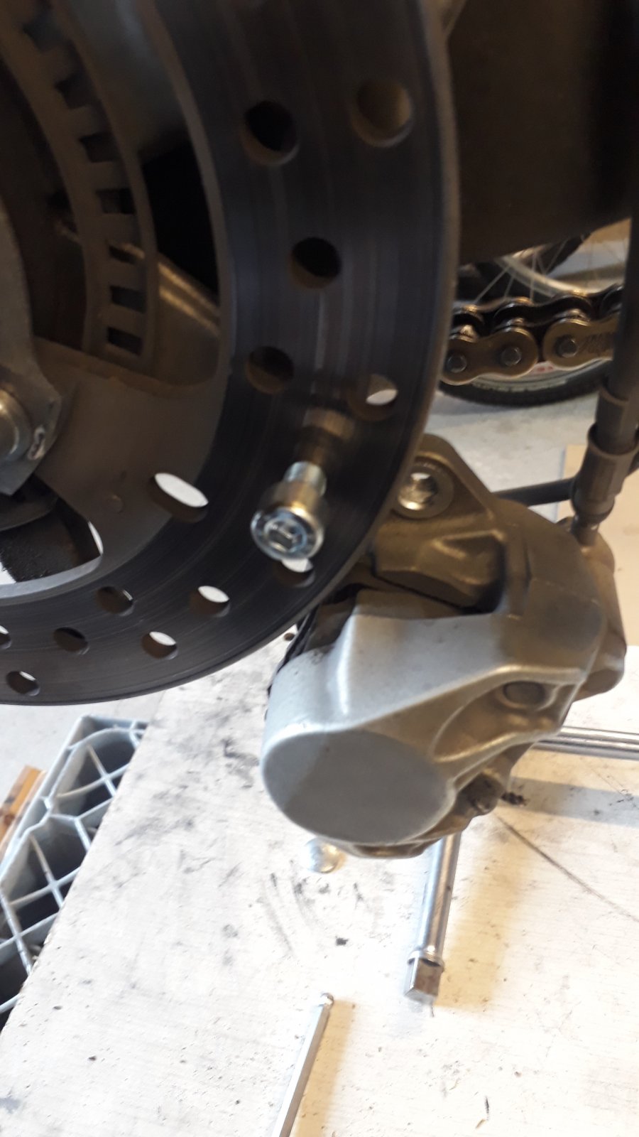

To loosen, not to tighten. I've stopped using mine for breaking off because it rarely works. Good old two foot breaker bar with an extension tube on it.
And against the rear brake, not the gearbox... Ideally you need a fat friend to sit on the bike and hold the rear brake.
