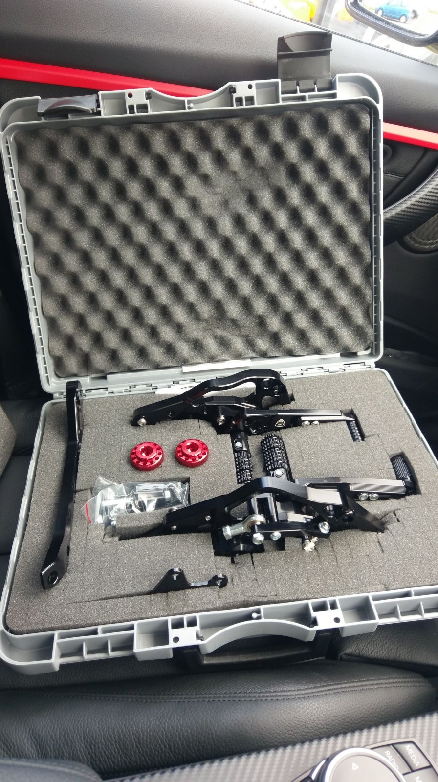

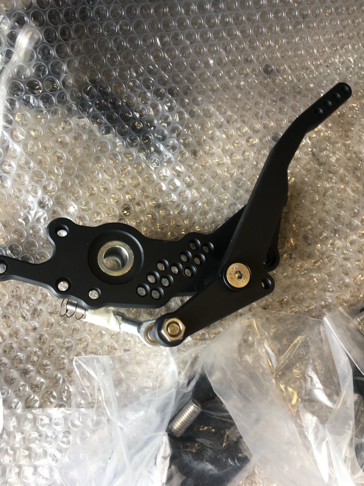

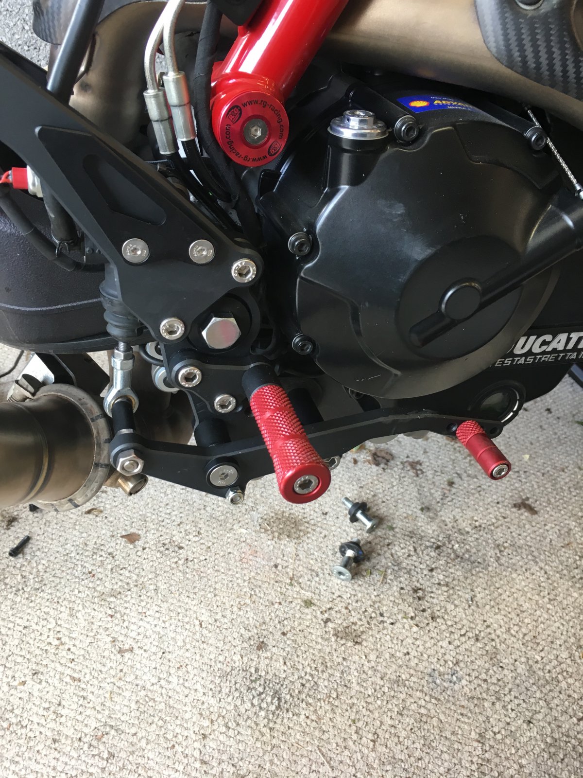

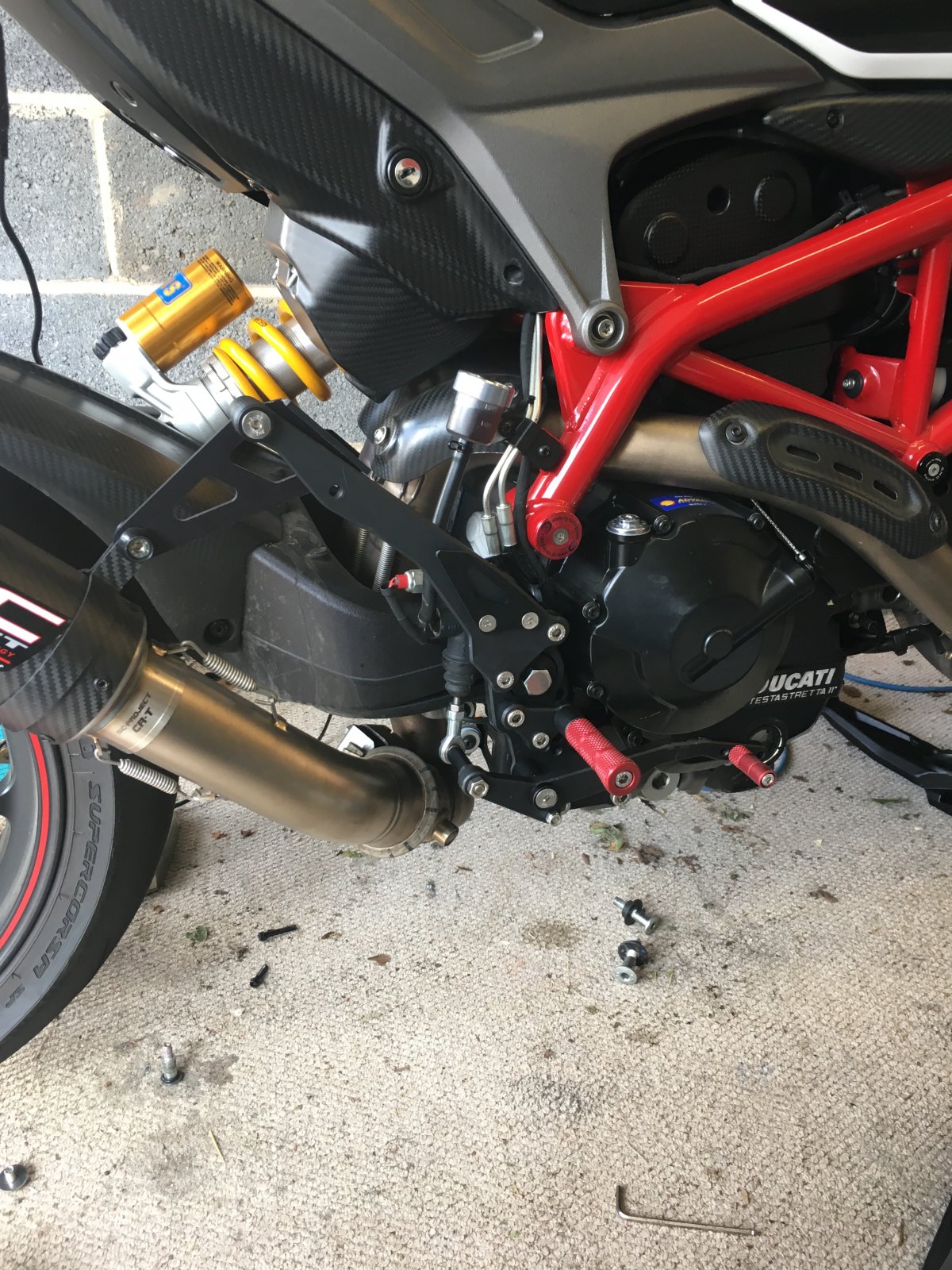

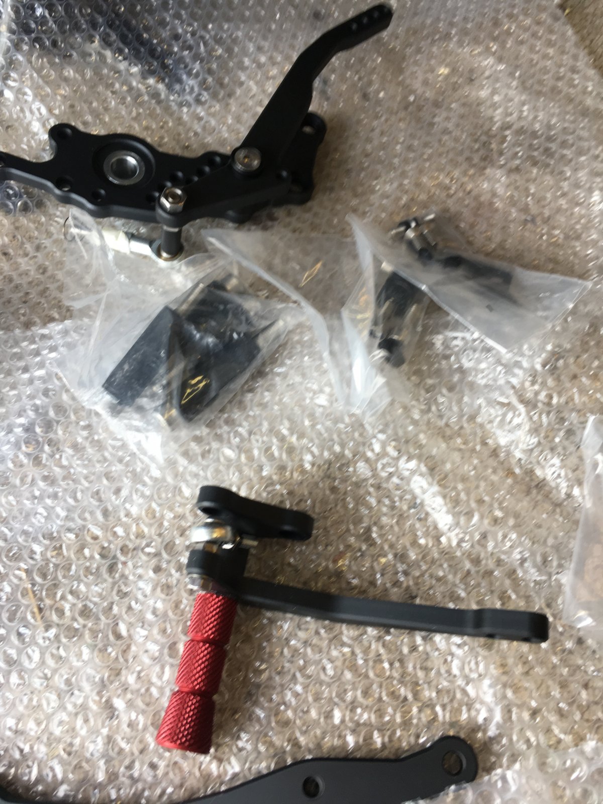

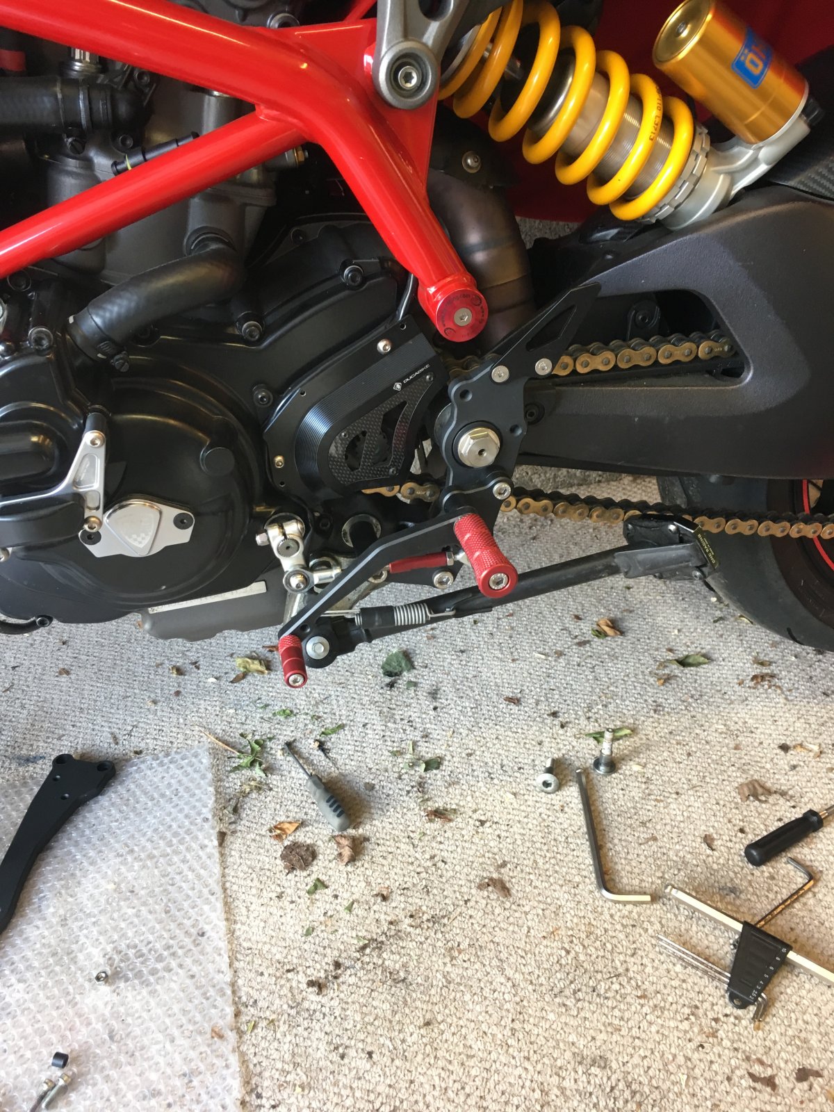

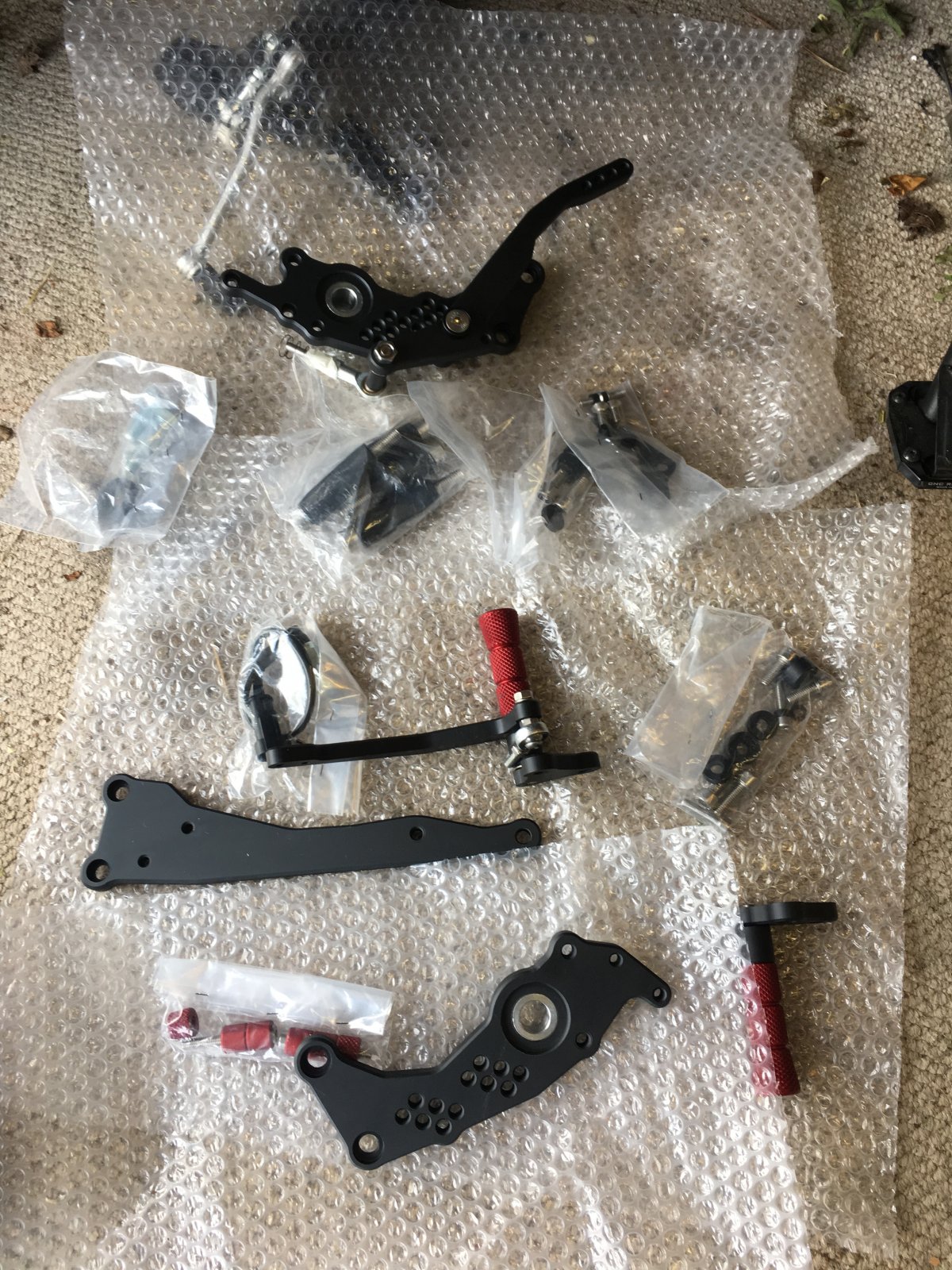

  8. IMG_0816.JPG IMG_0817.JPG IMG_0818.JPG IMG_0819.JPG IMG_0820.JPG IMG_0821.JPG Arrived Thursday fitted today in a couple of hours. Fitting instructions fairly good considering, although a little common sense is needed but still fairly simple.
    • Crap Crap x 1
  9. Shift rod looks longer than standard,could get a q/s on maybe

    Quality looks absolutely spot on so I'm very pleased with them so far.
  11. Wow,they look quality
  12. Wow,they look quality

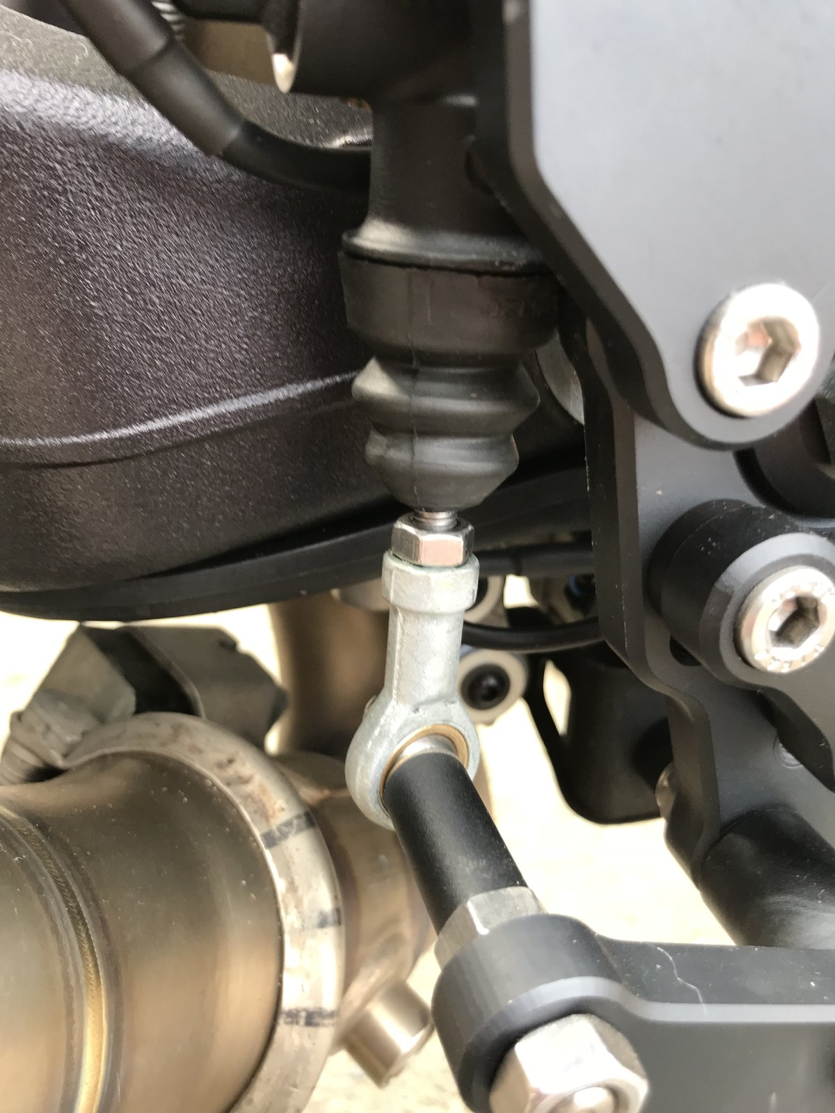

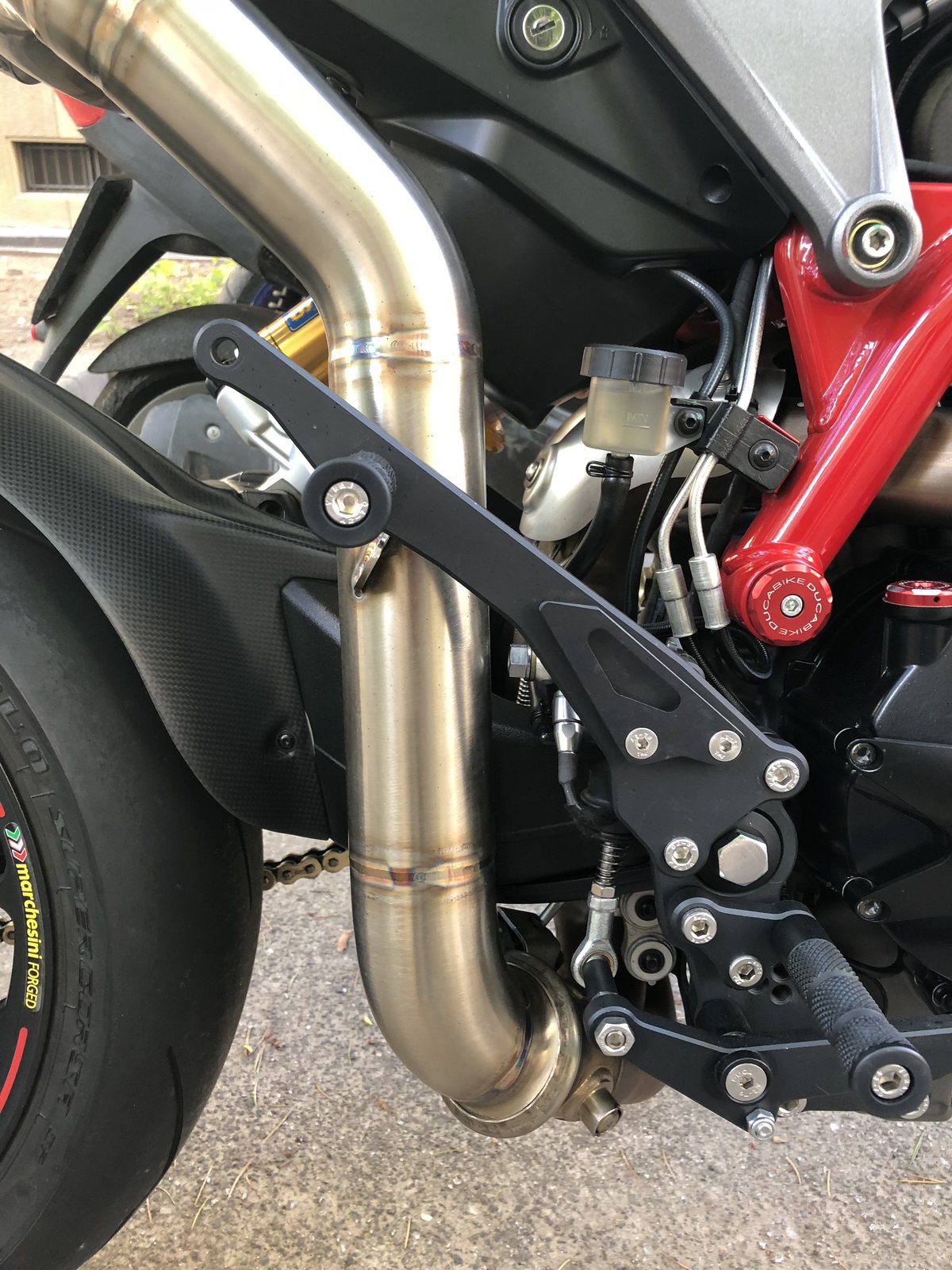

  14. Hi, I installed these last weekend but came across a little problem, maybe you found the same issue …..
    On the rear brake side it didn’t come with a spring so the lever is just pissing in the wind so to speak. Also, pin that goes into the brake pump doesn’t seem long enough.
    I did put a little spring on the pin to give the lever some resistance but doesn’t help much at all. And also the pin which goes up into the pump moves around in the hole.

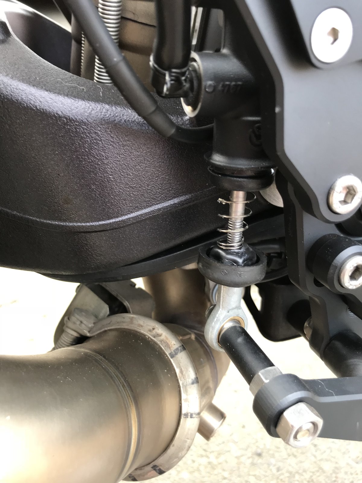

  15. Just seen this macaroni I’ll have a look in the morning, take some photos and get back to you, if I remember it all fitted and worked fine .
  16. 5BADF023-A896-4EC9-868D-1D0CA2D58D76.jpeg 1A72172F-3BF8-40A6-A18D-68209B113912.jpeg Top pic with rubber boot pulled down with spring inside there’s no side to side movement from the pin but got 3-4 millimetres of play up and down, hope this helps mate.
  17. Jenko832sp, Nice one, now I understand what I did wrong. Also I removed the gecko pin that went up inside the pump and put the original one on. It seemed to fit much better as it’s slightly tapered as well as longer. Works perfect now! No play at all.
