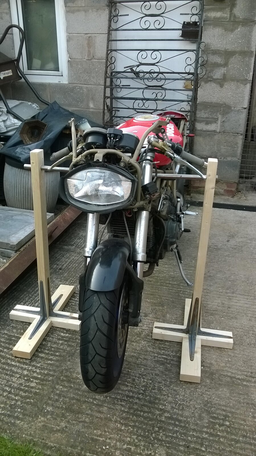

  3. I made this for my 750 it was ok at best, had to faff about with a trolley jack to get the front end back in, not ideal. But did the job on a bike I wasn't overly precious about.

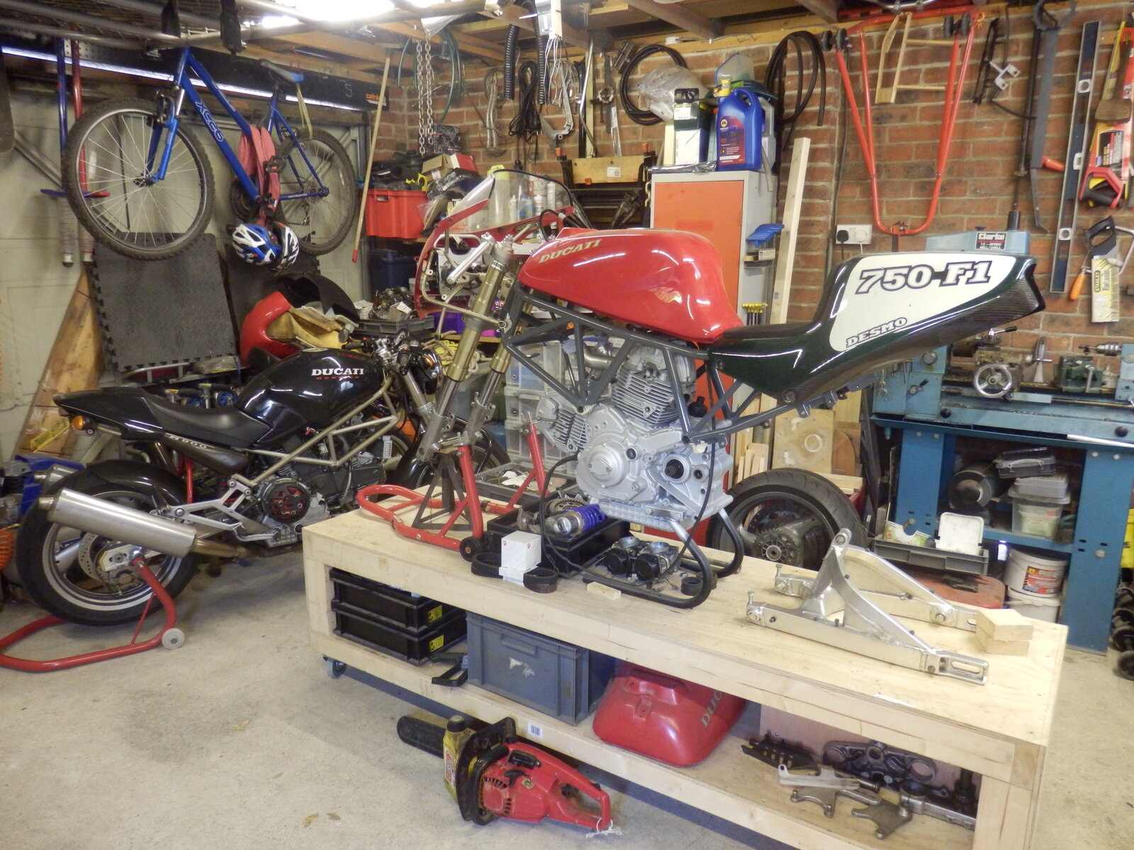

  4. been a few home made versions mainly copied from al (arquebus)
    this was mine
  5. Looks like her indoors lost the bookcase shelving.;)
  6. nah just some old brackets i had about
  7. I'm guessing but the steel rod was tubing and not solid with that little bow in her.:thinkingface:
  8. yes stainless thick wall tubing was all i had about at the time

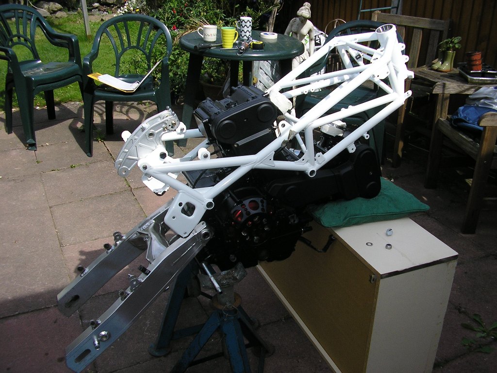

  10. That's coming along nicely.:upyeah:
  11. White frame the best look i think and wheels :upyeah:
  12. I did it the other way around by supporting the engine, bolting the frame to it, and building up from there.

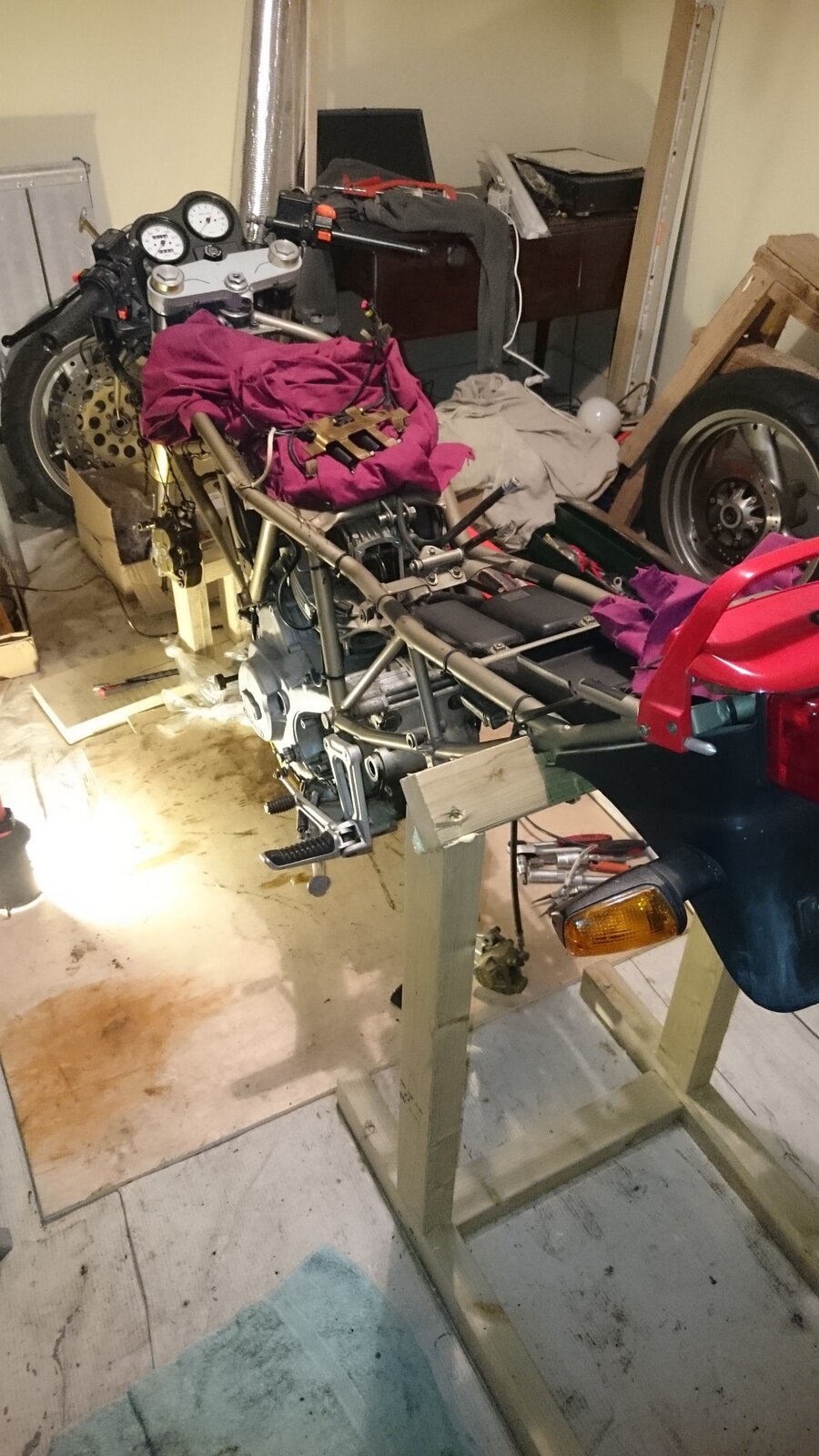

  13. I had to use what was to hand... :)
