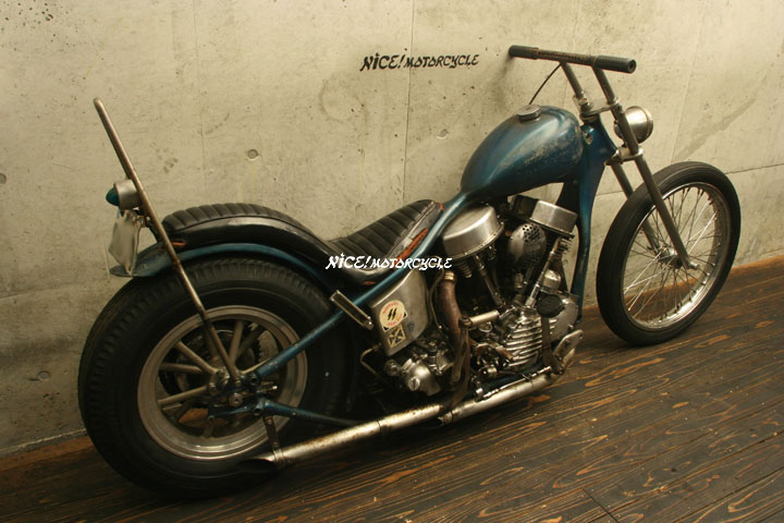

  2. Strange that. After i posted that comment, i thought 'Not if it has a hard tail'.:biggrin:
  3. Quite right..................all the grasstrack and speedway bikes I tried were hardtail............
