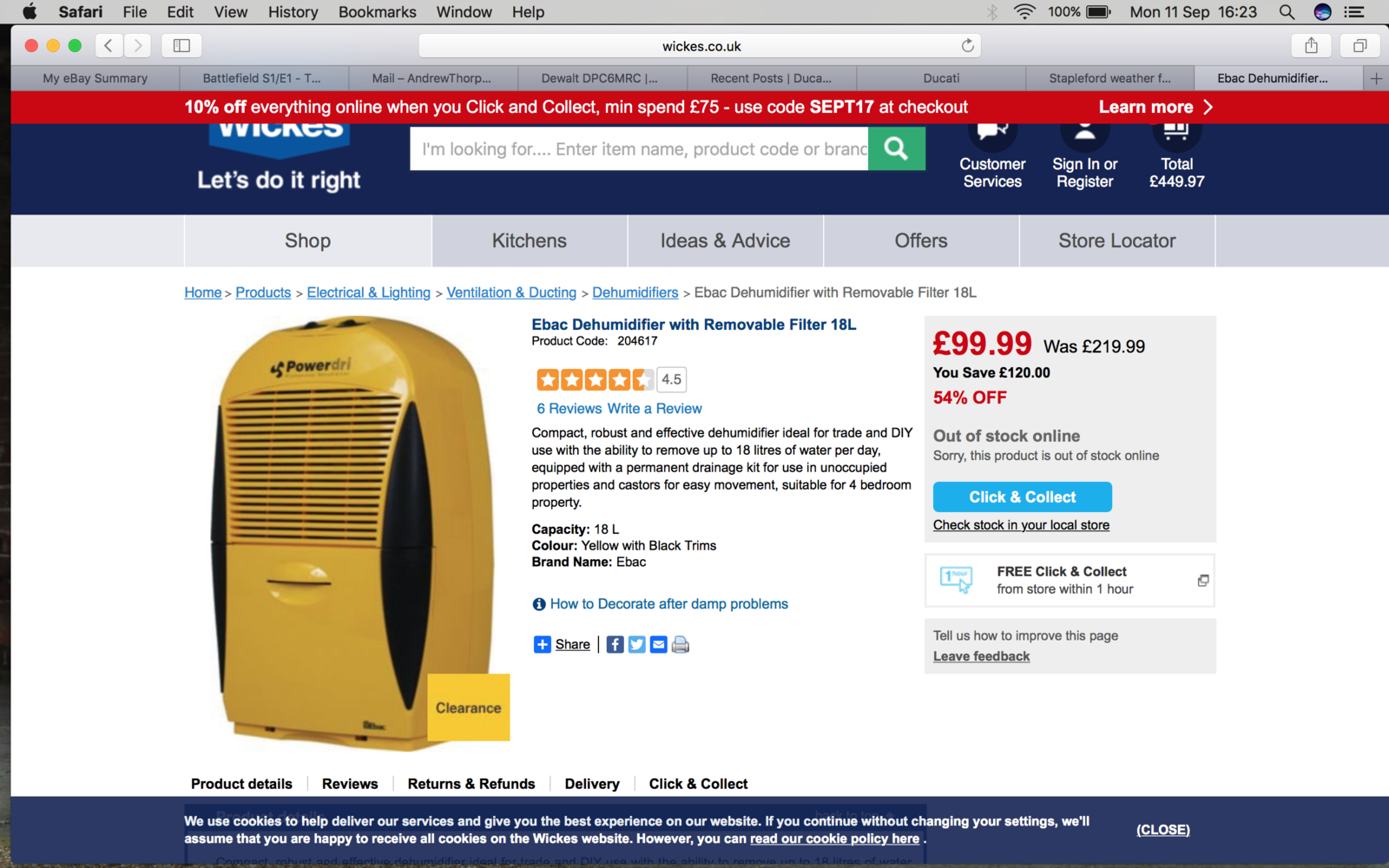

  3. Ebac might be worth a look, saw them on offer somewhere recently. I use Dimplex at home, small cheap, a little rattly but they are very worthwhile

  5. Keep it within the band of 45% to 55% RH. Dont try to close control to 50%. It will cost you the earth and you may not be able to get there with infiltration from outdoors. But 45-55% is doable. Good luck.
  6. Thanks for that Andy, doesn't look like a bad deal. I had seen Ebac mentioned as a reliable brand elsewhere also. Will keep this one on offer at wickes in mind :upyeah:
