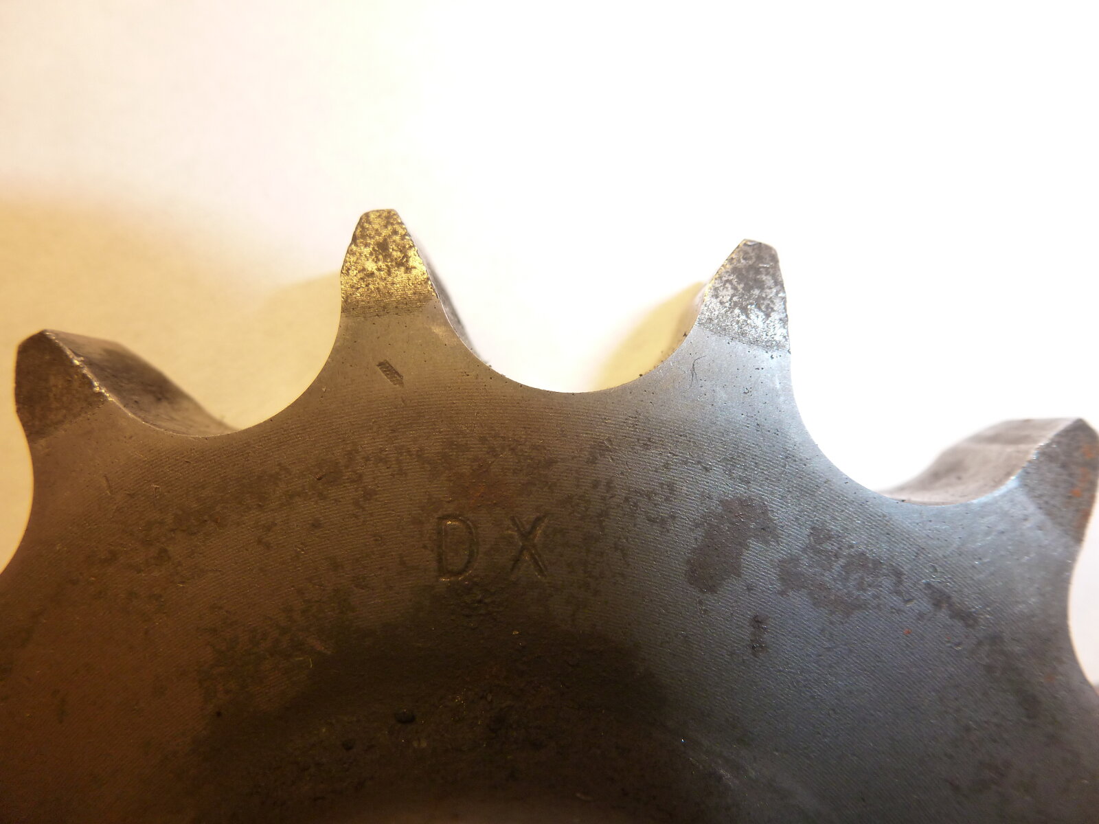

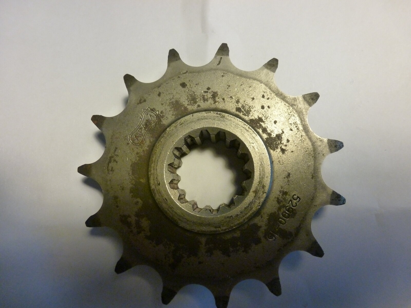

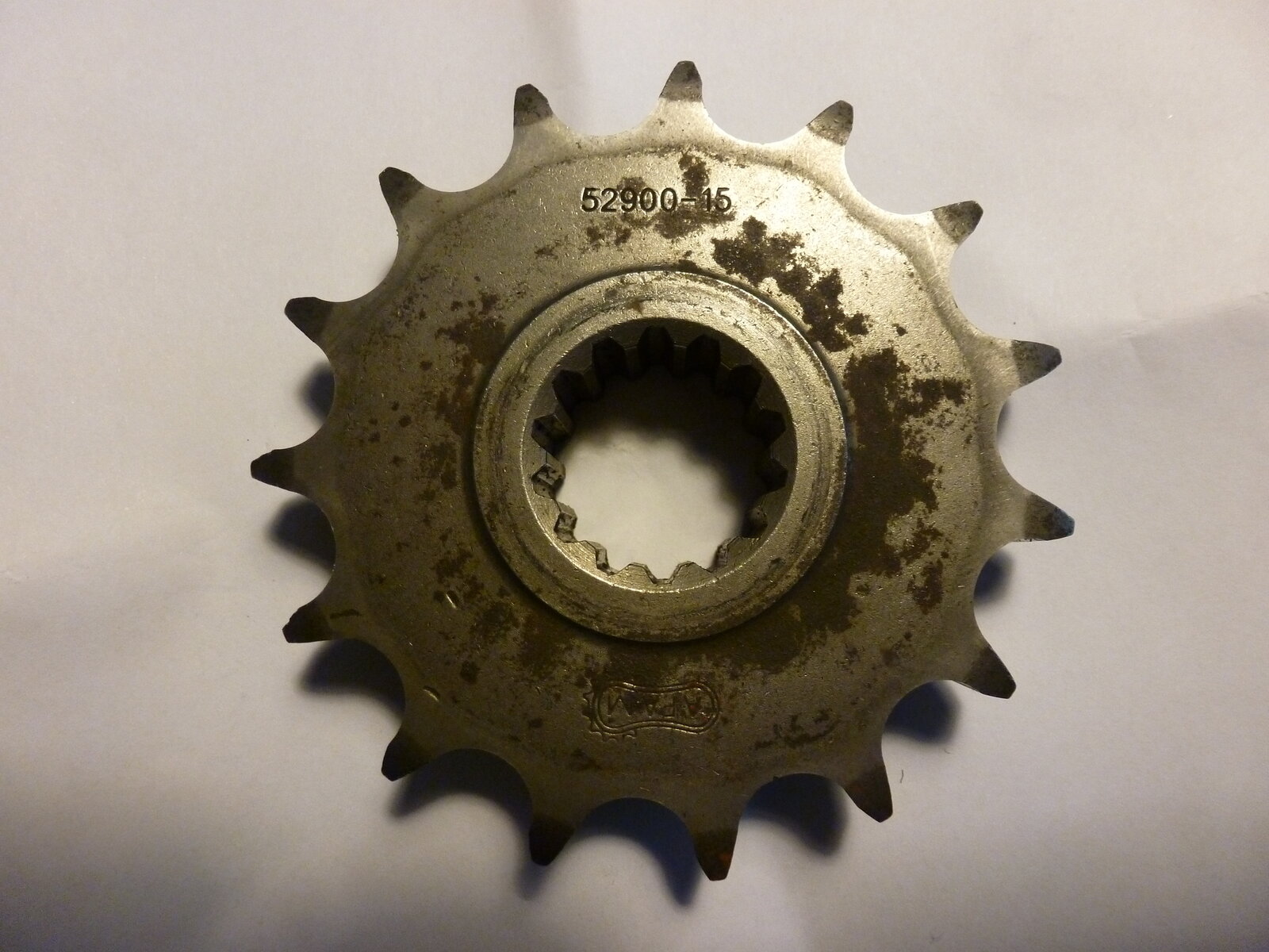

  5. My OE DVT chain was ready for change at 16300 miles. I bought a DID ZVM-X gold chain c/w pair of Afam sprockets as a package. After another 7800 miles I decided to change the front sprocket from the standard 15 teeth to a 14 teeth one mainly for smoother riding in 30 and 40 mph zones (plus other benefits). On removing the Afam front sprocket I was amazed and dismayed to see clear hooking of the teeth. I didn't expect to see that from such a low mileage. The rear sprocket showed no visible wear and neither did the chain. Of course, front sprockets do three times the work of a rear sprocket so more wear is to be expected, but I think this is excessive and makes me wonder what a 16300 miler would look like.
    I have an electronic Scott Oiler fitted so it wasn't lack of lubrication that caused the wear.
    I'm wondering if a different manufacturer such as JT would have been better. I read somewhere that their sprockets are hardened all over, not just the tips. I've used Afam before and never had cause for complaint, though as this was the first time I'd changed the front sprocket myself so I'd never inspected previous ones. If I'd bought a cheap after market part then maybe that's what you'd expect, but Afam is a well respected name.
    FYI the 14T sprocket I fitted is also from Afam, so I'll take a bit more interest in it as the miles increase.

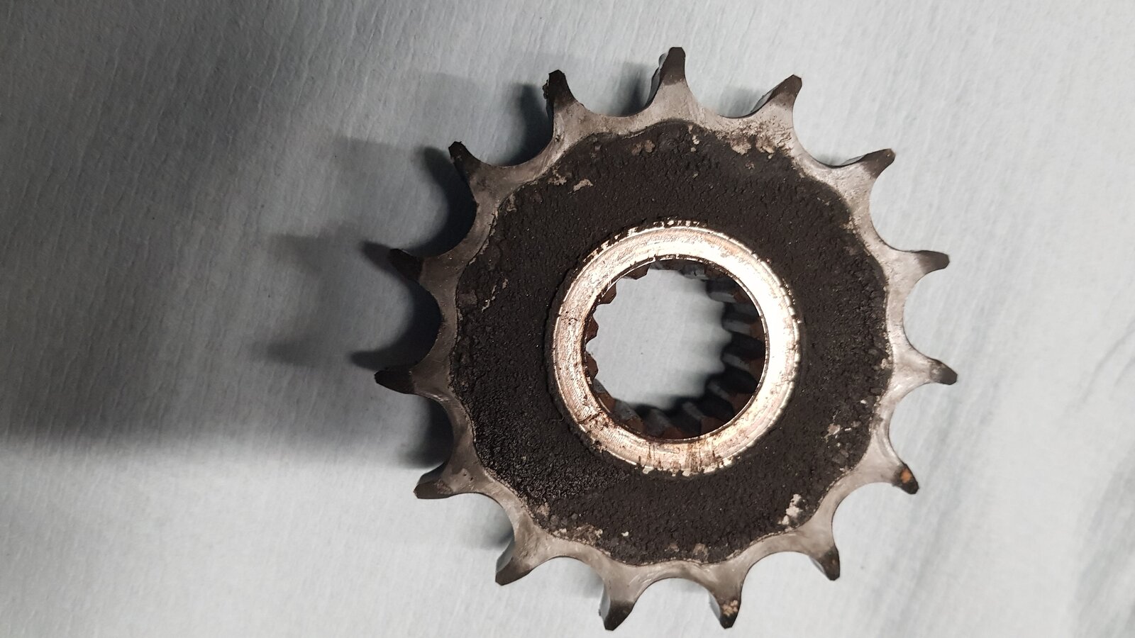

  13. This is what a 1260 Front Sprocket looks like after 12,000 miles, not too bad really but definitely worn. A new front sprocket has been fitted, the AFAM DID Gold chain is still good as is the rear sprocket.

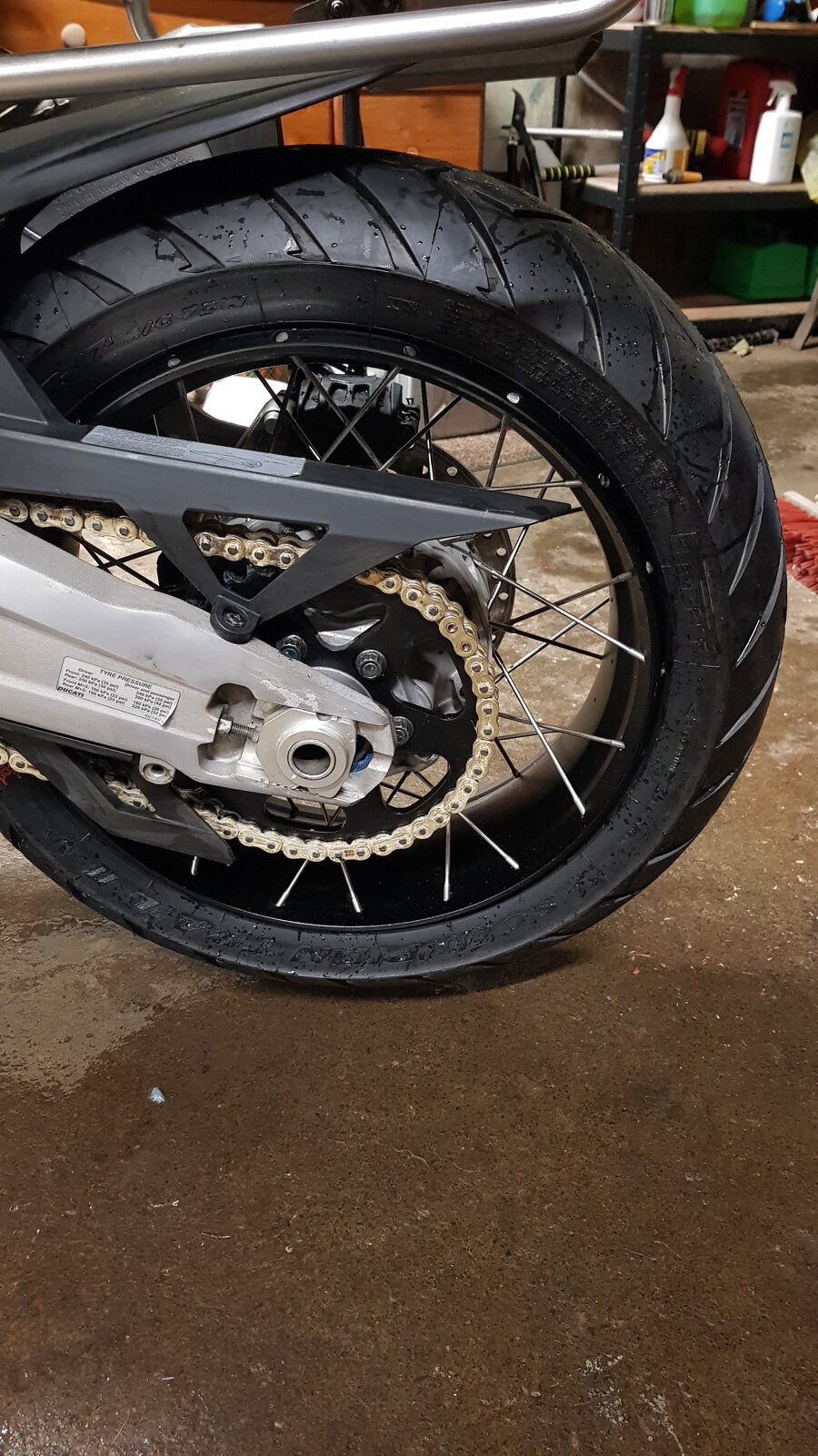

  16. New chain and sprockets fitted yesterday. Roughly 145000 miles. Front was clearly hooked. Rear not to bad.
    The new chain was adjusted as per the manual but it seems very tight. Has anyone else noticed this or have I done something wrong.
  17. Not sure what DSS settings are suggested for chain tension checking in Enduro bike, but On my normal skyhook it’s check in urban setting on side stand . This should give around 30mm-35mm slack?
    #19 michel couque, Dec 30, 2019
  18. If it's too tight, slacken it off. I do mine with the guide plate they supplied with the bike. One of the easiest chain adjustments I have ever had to do.
