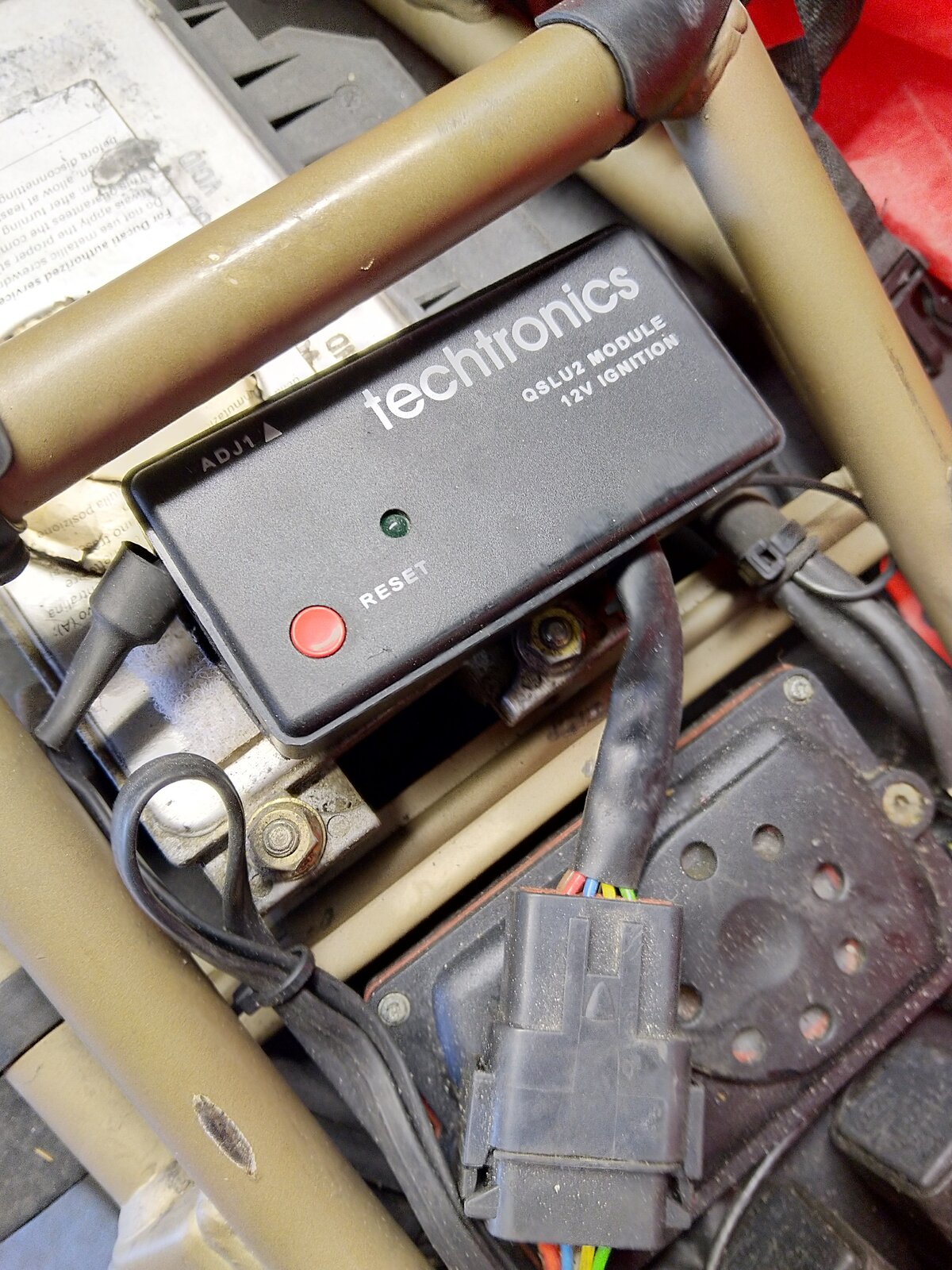

    Quick google and its a quickshifter, dunno if that will stay, I like OEM.

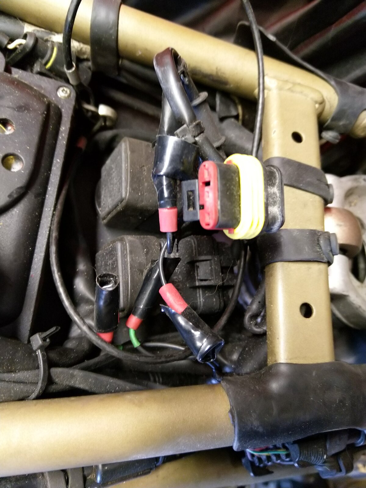

    As an electronics engineer this sort of bodge causes issues with my OCD, any idea what might have gone on here, looks like two wires were broken to fit something in that has been subsequently removed?
  2. It may have been one of the points where the data tool alarm was spliced into the loom.

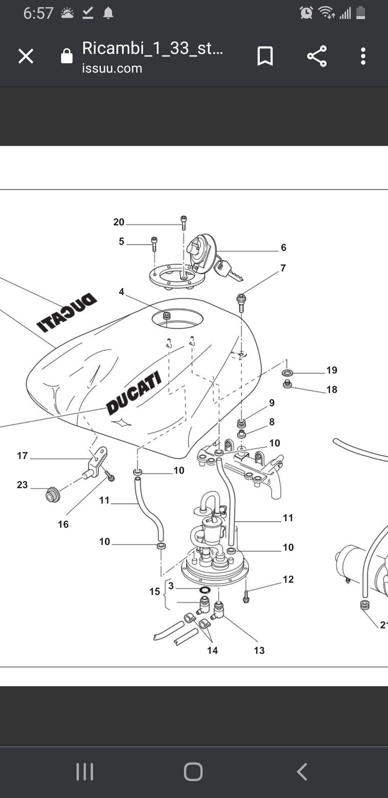

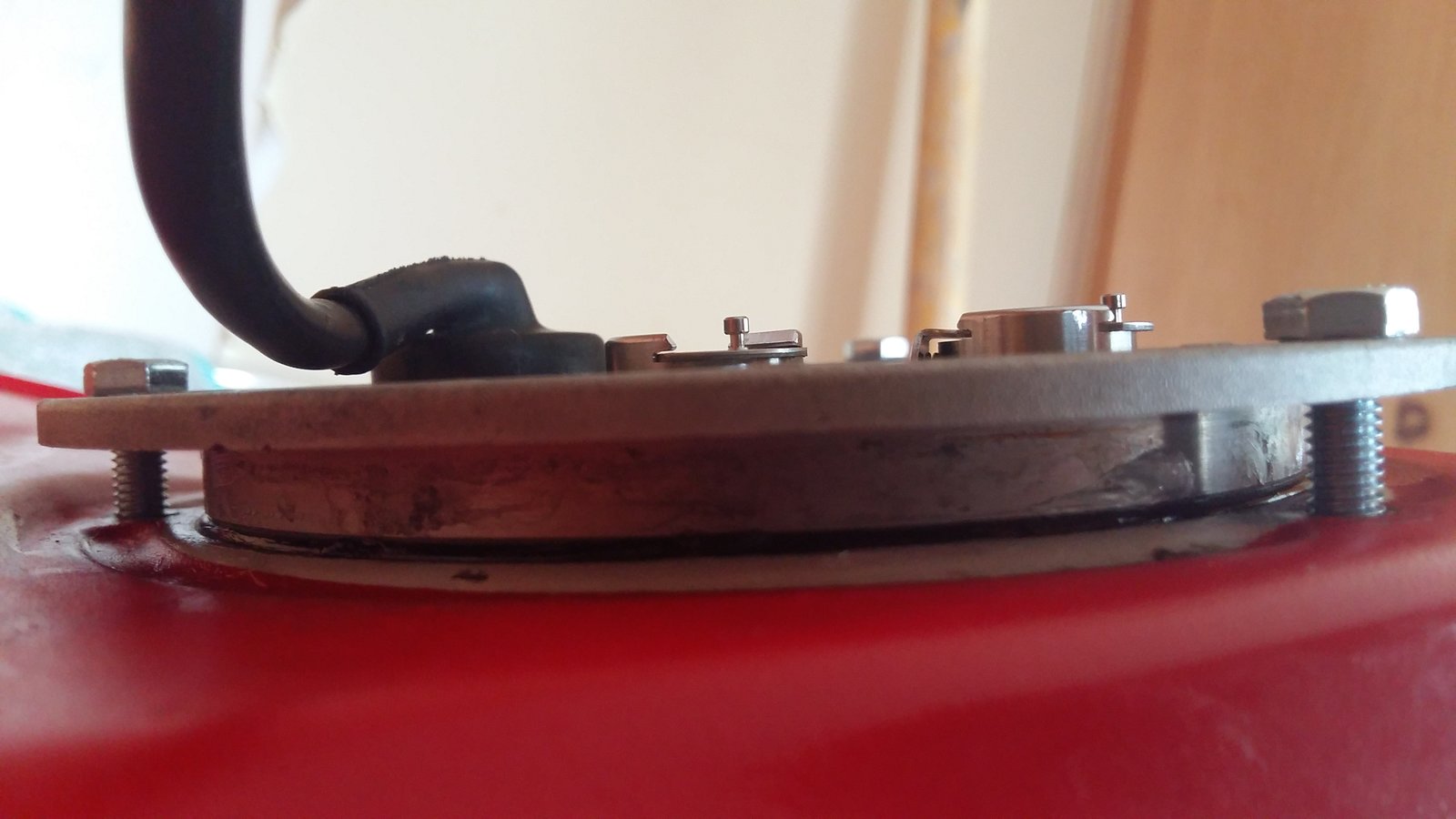

    One early maintenance item you might want to consider is replacing the in-tank fuel lines. They don't last forever and cause havoc once they start to go. This also means replacing the plate O-ring and fuel filter (Mahle 145), but it's worth it for the peace of mind.

    Useful advice thanks, where would I get the parts from, what do I need?

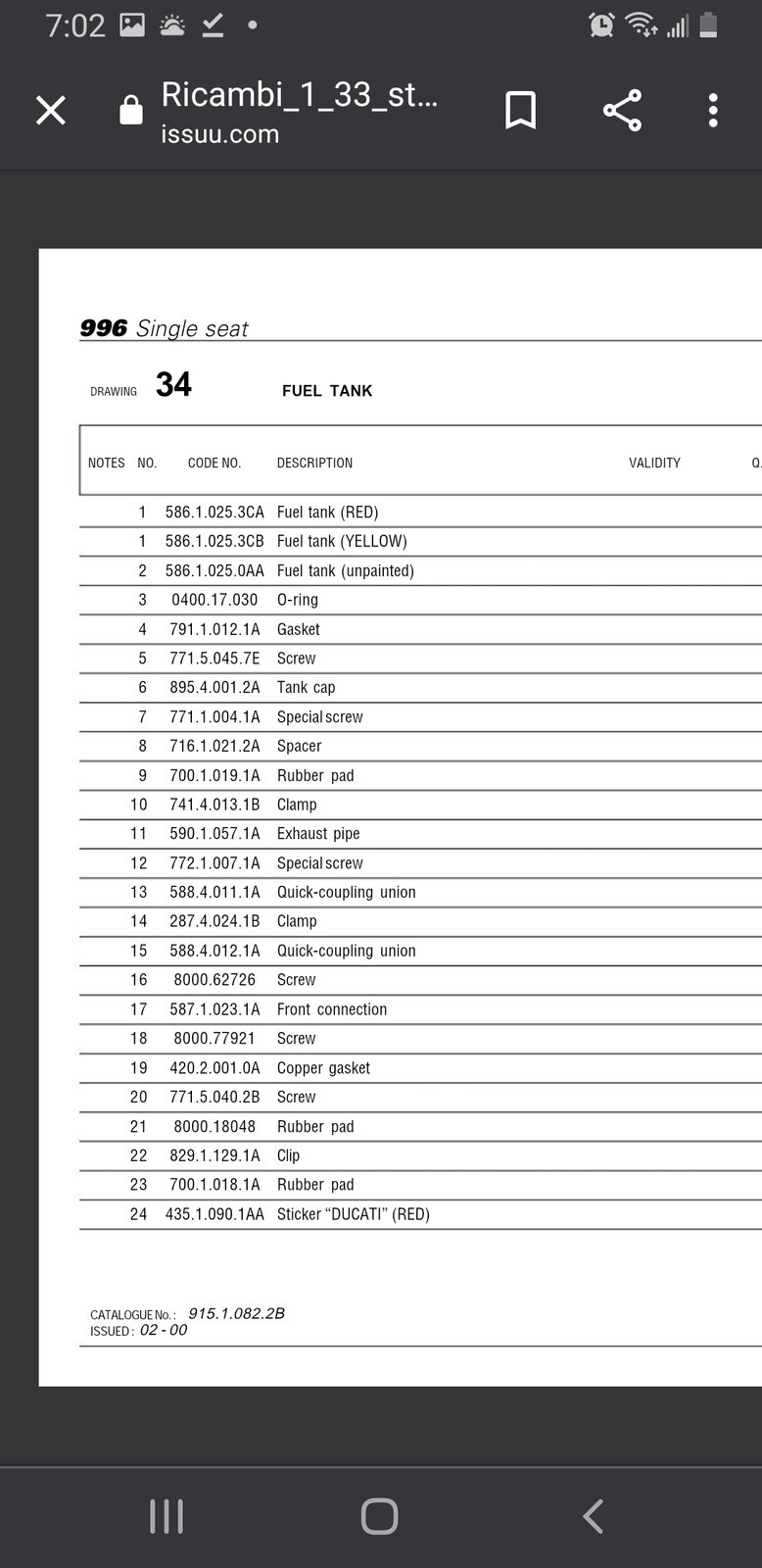

    Having taken the tank off it looks like I'm missing a overflow pipe, there's a tee/y piece joining two pipes but nothing coming off, there's also a clip lower down the frame that looks like it is for overflow pipes, but there's nothing there.

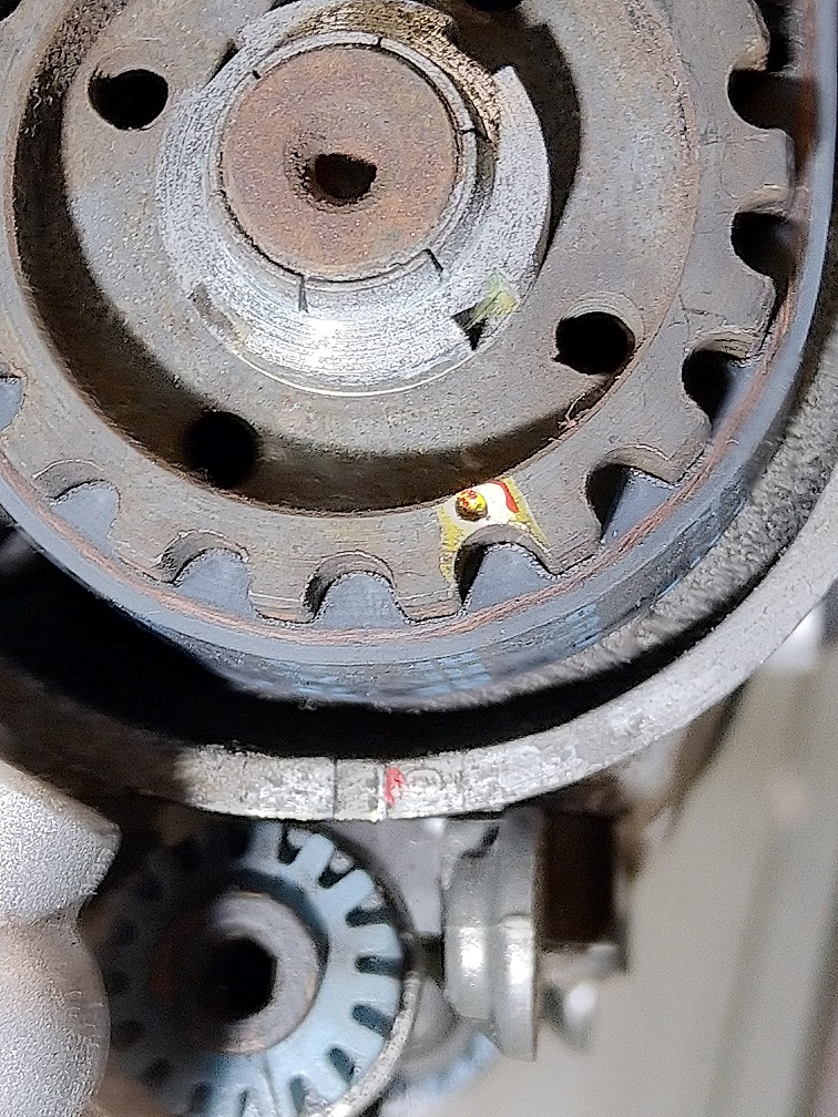

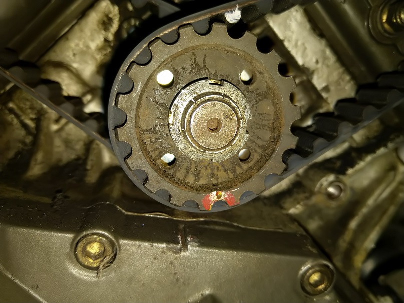

    Put it off for a bit but tonight I pulled the belt covers off, first impression belts are a bit slack and as dry and creaky as expected, but when I brought the top cylinder cams up to the mark, I noticed this on the horizontal cylinder's exhaust cam pulley.
    Unless I'm mistaken, that's a tooth out? Might explain the poor running?
    But, then I checked the crank pulley....
    I think that might be a tooth out as well, putting the crank pulley on the mark makes one pulley timed up right, but unfortunately the other three are out. No wonder it was stored and not ridden for years, must have run like crap.

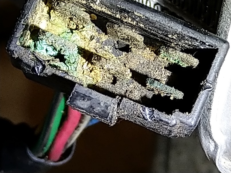

    I also had a look at the electrics as I gained clearance to the cam covers, I used to be a design engineer for AMP connectors so I appreciate the Econoseal connectors used throughout the loom but I wish Ducati had used one on the ignition switch connector
    God knows how this worked.

  9. I think that qualifies as the worst connector I have ever seen
  10. Dialectric grease is your friend here. Slap it liberally over all the connector pins on the bike before making them. That way any water ingress will not cause any corrosion.

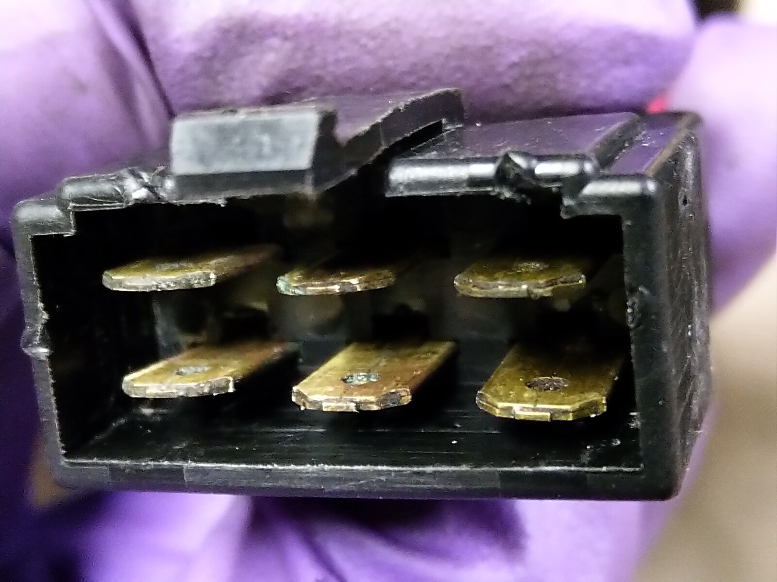

  15. Bit of coating with flux and cleaning and the spade terminals came up ok apart from the red one which had nearly dissolved, so that got replaced. The mating females were all replaced with new.
    Assembled back together packed with some silicone grease.

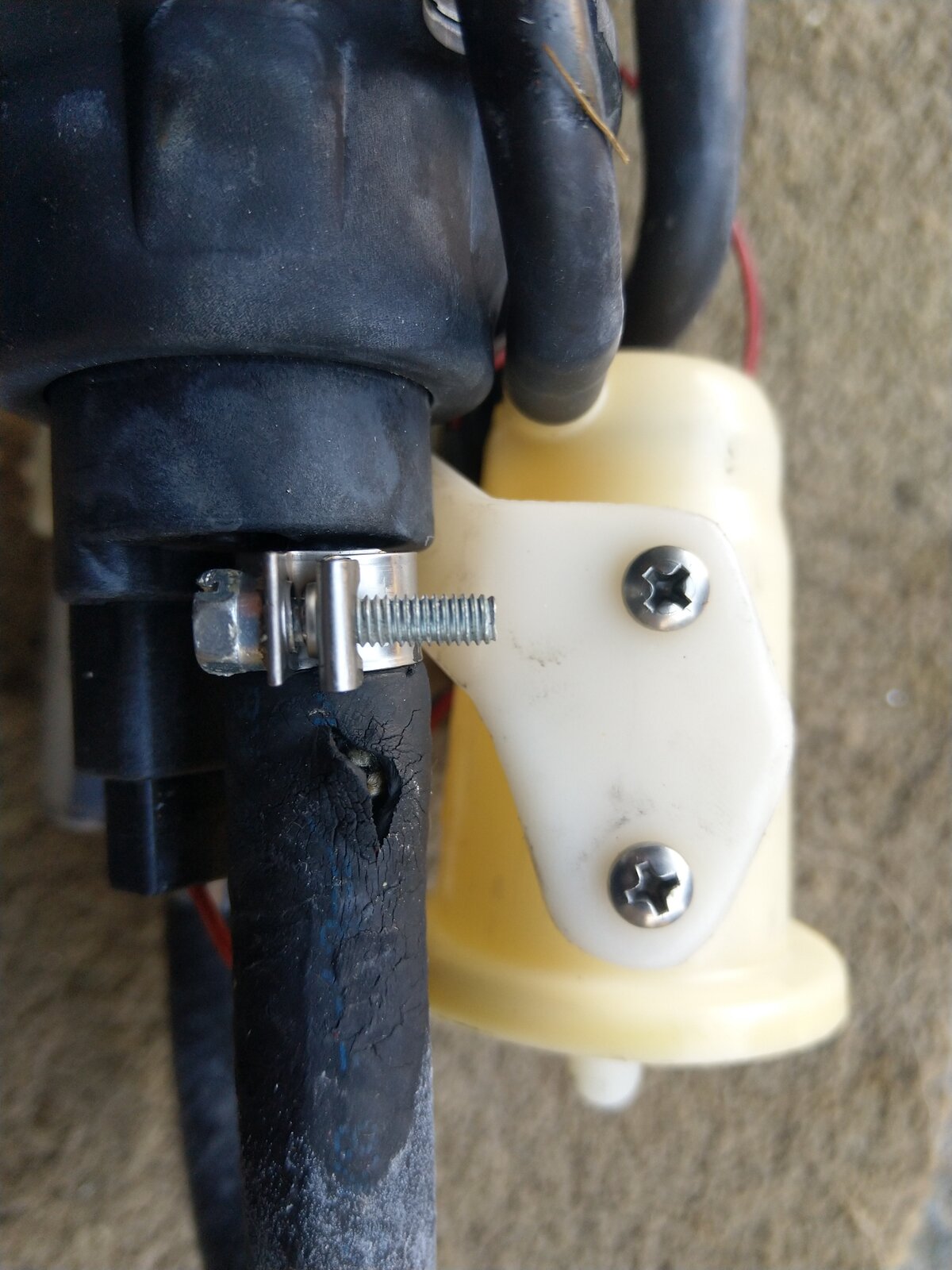

  17. Good shout by the Ducati forum, glad I checked the fuel pump and lines. IMG_20210228_135617.jpg
    This split in the pipework won't be helping, would have taken ages to find without your guidance, many thanks.
