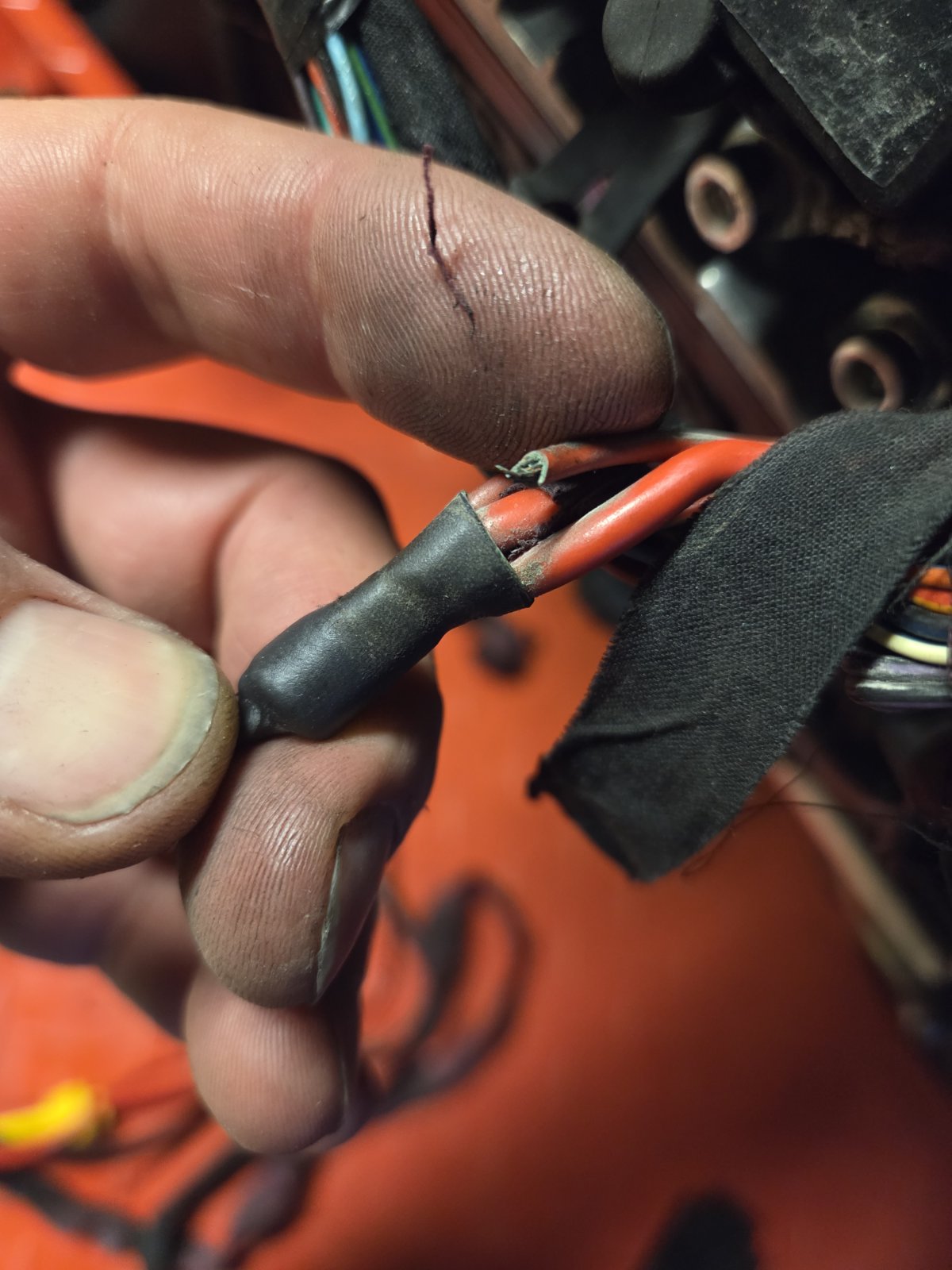

    Given the work I had been doing around the ECU and relay area, I initially suspected something more serious. Root cause found, after pulling the tray out again and inspecting the loom. Inside the main harness there is a compressed splice where four ignition-switched feeds join together. One of these wires had snapped at the crimp, leaving an intermittent connection.
    Completely coincidental.
    This most likely happened while I had the entire housing removed earlier during the ECU and relay troubleshooting and a thorough clean. The fix was straightforward once located. Once everything was reassembled the bike powered up normally again.
    With the lambda sensor installed and the exhaust valve eliminator fitted, the ECU is now completely happy and there are no warning lights.

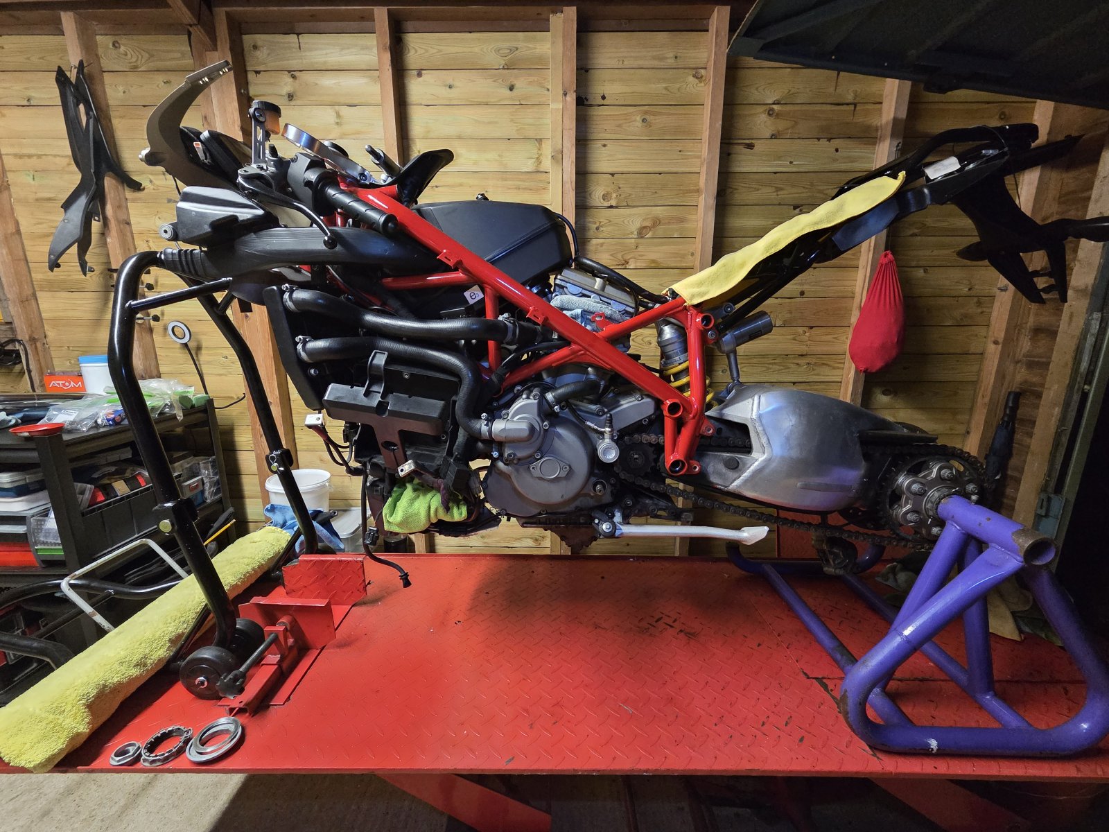

    While everything was apart I went through the bike thoroughly and completed the full recommissioning.
    Work completed:
    • Replacement stepper motor
    • Oil and filter service
    • Spark plugs
    • New cambelts
    • Front fork service and seals
    • New tyres
    • New radiator
    • Brake and clutch fluid replacement
    • Clutch inspection with new friction plates installed
    • New Front and Rear brake pads
    • All removed fasteners replated during the detailing process
    • Full deep clean and detail while the bike was stripped

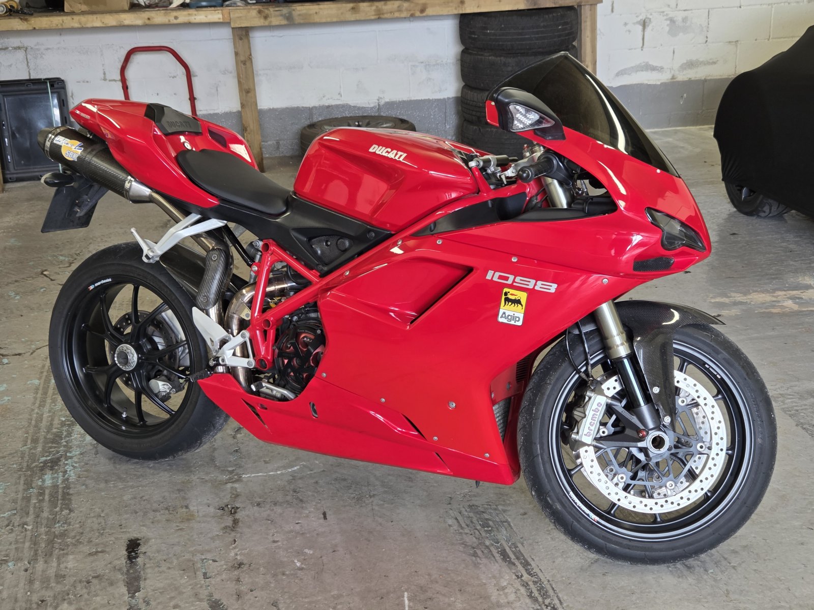

    The bike now runs, idles and cools as it should.
    The bike has now passed its MOT, The only advisory noted was:
    • Rear brake needs bleeding
    That one was on me, I hadn’t bled the rear brake properly during the service work.
    I’ve since rebled the system with the caliper removed from the bracket and positioned so the bleed nipple sits above the master cylinder, which allowed the trapped air to escape properly. The pedal now feels correct.
    Since completing everything I’ve had the bike out for three shakedown runs, the longest being about 1 hour 20 minutes round trip. Happy to report the bike has been completely flawless so far.
    Given how well it’s running, I honestly can’t see any reason to attempt flashing the DP/Racing EVO mapping at this stage.
