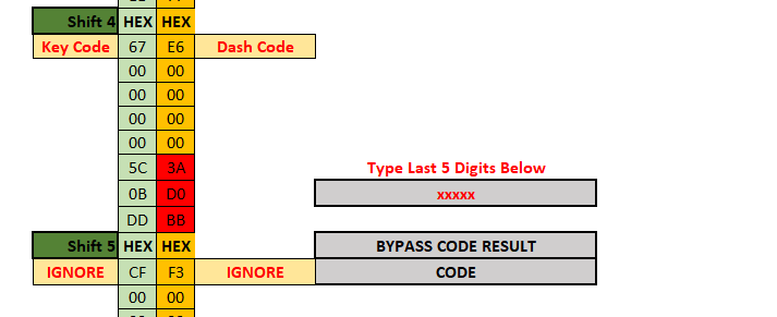

    Now I want to get used to the software/excel. I tried the example from the MK10 Post "06 00 00 00 C0 B5 D0 7D and 03 00 00 00 60 D8 E8 38 to test" but when I got in the key code (06 00 00 00 C0 B5 D0 7D for example) I got no key in Shift 4. I only get this but nothing to put in the "Type Last 5 Digits Below". Could you please help me?
  2. From the part in red, take the last 5 digits
    A D 0 B B
    and put this in place of xxxxx, press tab
  3. Ohhhh my god, this was to easy for me :-D Thanks for this :-D Hope to get everything will work if the Zen Mini is here. This is a great option to not open the Dash - great work :)
