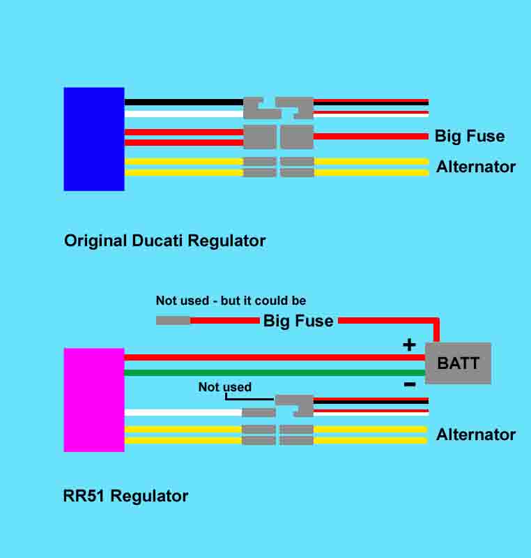

    AL

  19. As I understand it the 3A fuse has nothing to do with the output of the Alternator. Its a sensing or feedback line if you will, it tells the RR the voltage in the system and from that the RR can determine if its to send the electrical power generated by the Alternator to the system or dump it overboard as heat. Normally these lines are high impedance and draw negligible current. The output line(s) from the RR are the red ones protected by a 30A fuse
    If Nelson is running a 1098 RR then the sensing line is no longer used, it looks like it was already capped so not sure what was going on there. The Voltage sensing is done internally in the RR on the 1098.
