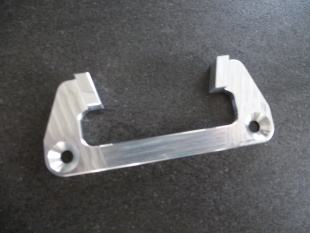

  2. Get a 749R bottom yoke and use a customised lockstop plate?
  3. Got any pictures?

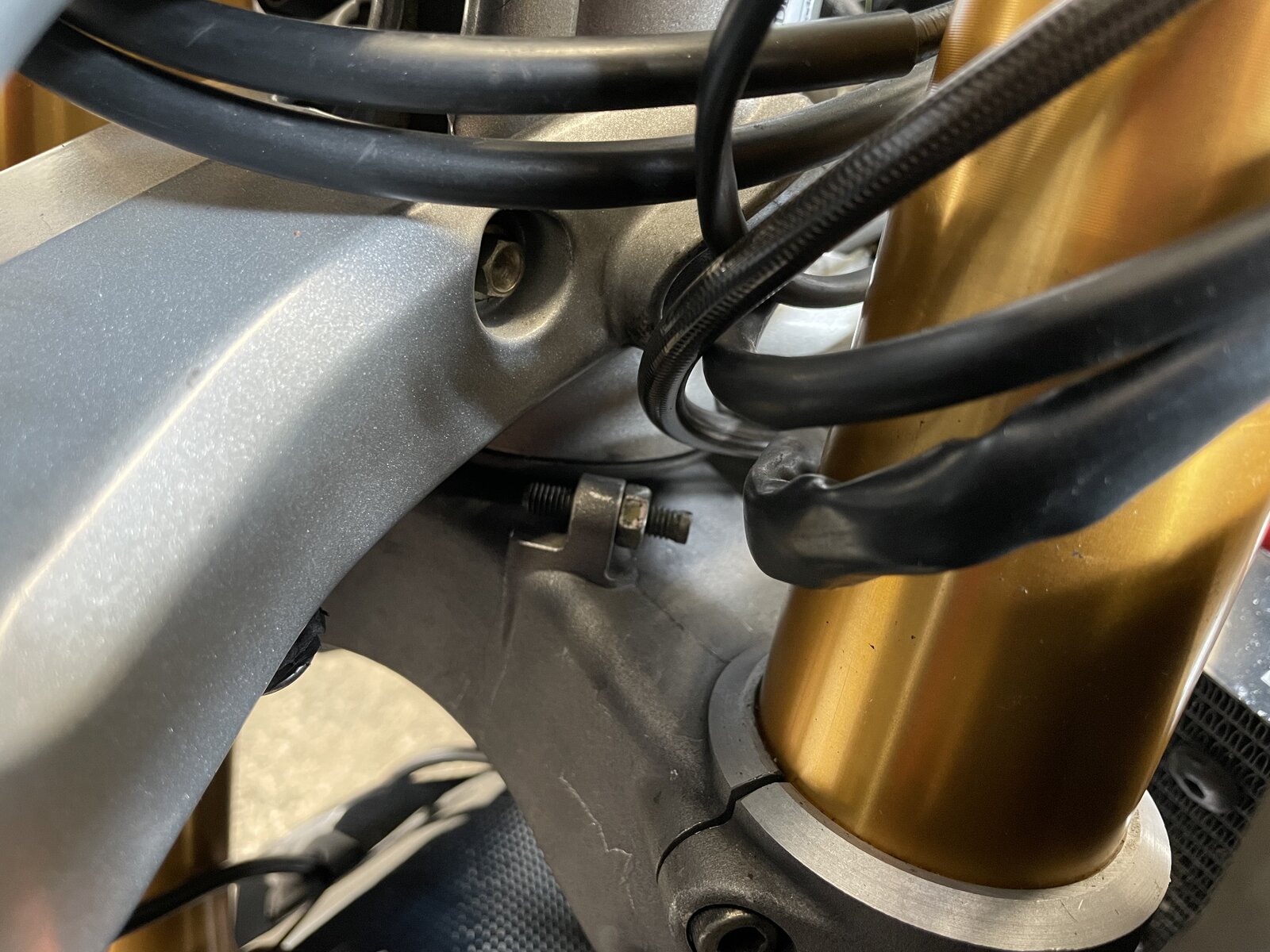

  7. Digging up this old thread to say that lo and behold….I can adjust steering lock on my 999.
    I have these on each lock stop.
    Begin to wonder if it’s been raced….
  8. Those adjusters are standard on many Ducatis.
    Actually, I don't think I've owned one that doesn't have them.
