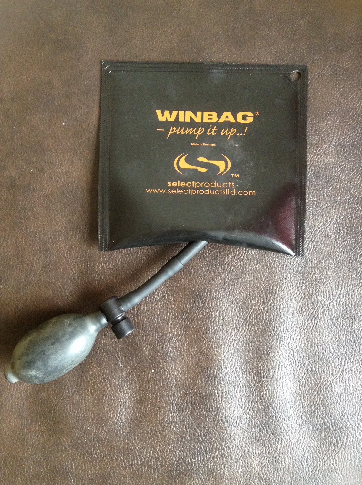

    Get a mate to help! Or use a winbag! Just slide it under the tyre and pump the wheel up until everything lines up,great tool for loads of things

    Good stuff - I'll look at a Winbag or two on top of some block of wood for the future. Pouchers input of using your feet/knees while sat behind the bikes seems do-able shorter term.

  7. Screwfix does a version for £12.

  11. Yeah! I was the same, then my son got me a winbag for fathers day now I can do it faster easier and cleaner
  12. Yeah! I was the same, then my son got me a winbag for fathers day now I can do it faster easier and cleaner
  13. Seriously, Ill try this tonight, your making it sound easy!!
