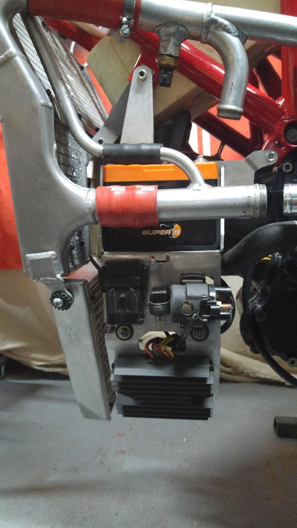

  14. This is how we did on the 999RS replica: Aluminium battery tray and a bit of airflow.
  15. Agreed. What's that got to do with the battery??
