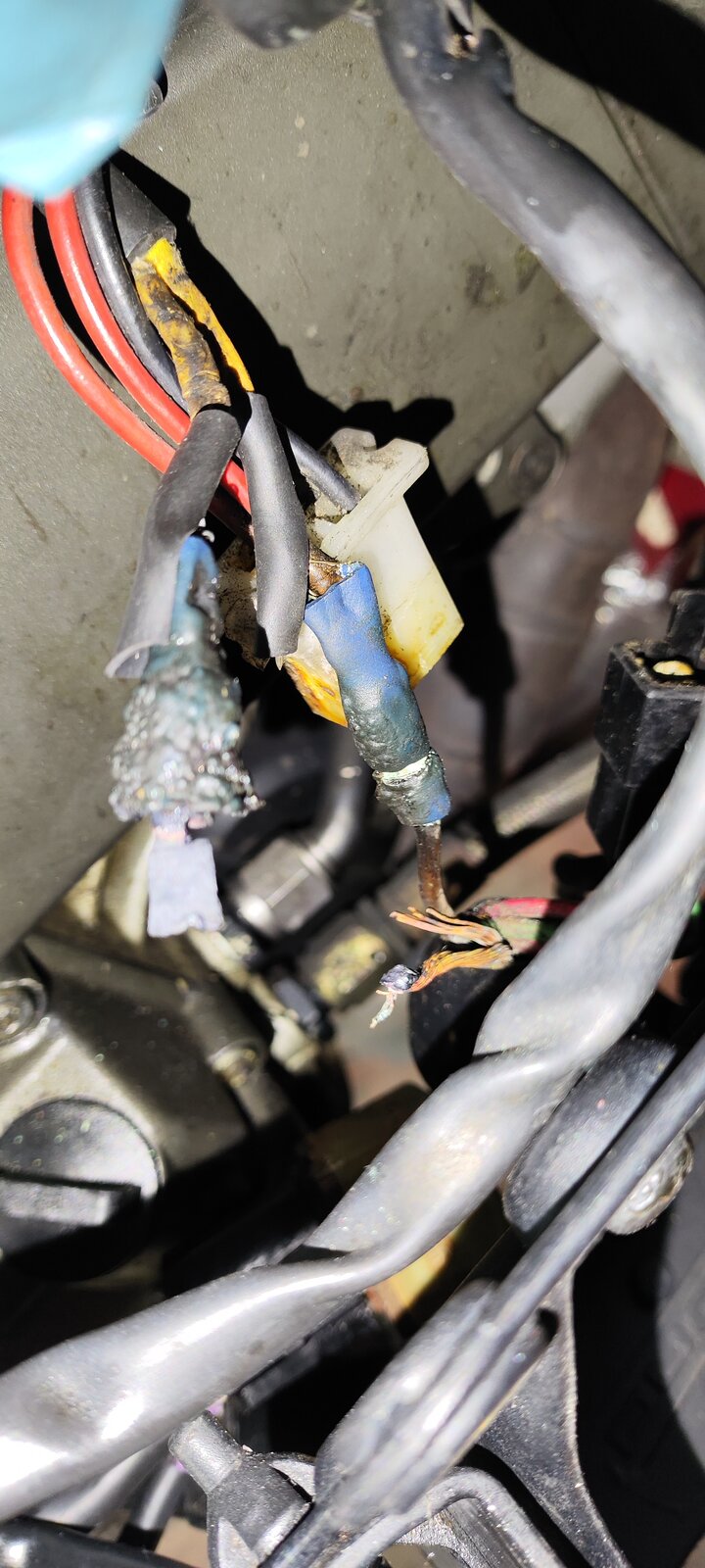

    Need to ask a question that I can't seem to find the answer to ,
    Hope someone hear can help .
    Can a 3 phase reg/rectifier be used on a 2 phase ?.
    I have a 916 with the two yellow wires and a think it's had its day .
  2. yes it can, but memory shot @Derek @chrisw will remember i think plus searches on this forum will also reveal the answers you are looking for (v. lucky escape by the way!) - often the connector(s) failing due to corrosion/inability to allow current to flow without overheating, are as much to blame for the breakdown rather than just the rectifier - ditto alternator connectors.
  3. Also best to replace the yellow wires with thicker gauge, as far back to the alternator as possible.
  4. I replaced the wires all the way back to the stator with 2.5mm squared. The stator can't take a thicker gauge. I also got rid of the troublesome connector and used a new R/R with larger spade connectors like the Shindengen has. Any 2 of the 3 R/R connections work with a single phase alternator.

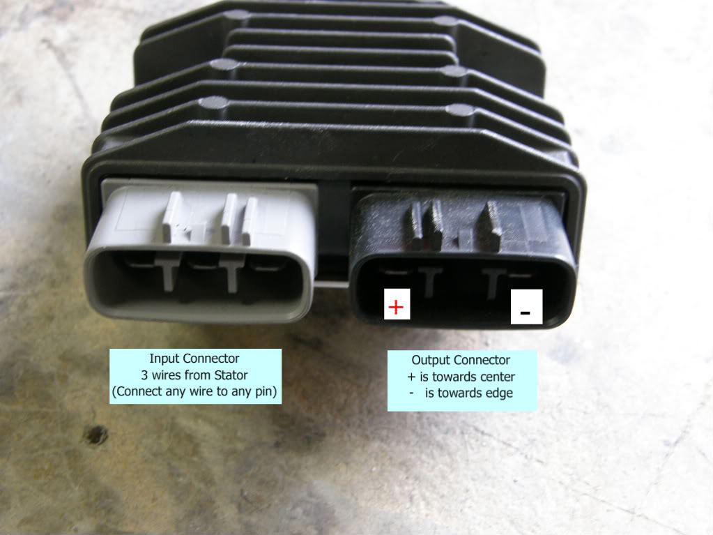

  6. The grey connector has 3 connectors - for the yellow stator wires
    The black connector has 2 connectors (the one nearest the grey one is +ve) - to the battery
  7. Thanks Chris . Much appreciated
  8. Thank you
  9. Just to confirm what Chris says:
