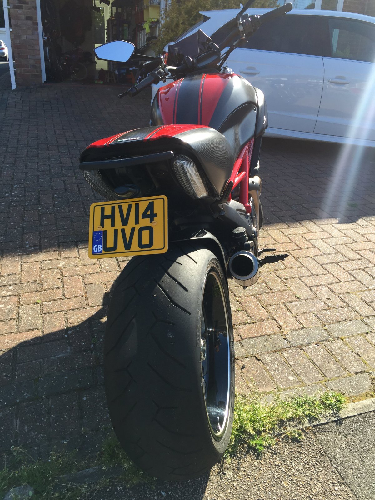

  15. Here's mine. Plate is 7x5.5 I think. Removal of the old mount was fine, but they are hefty bolts

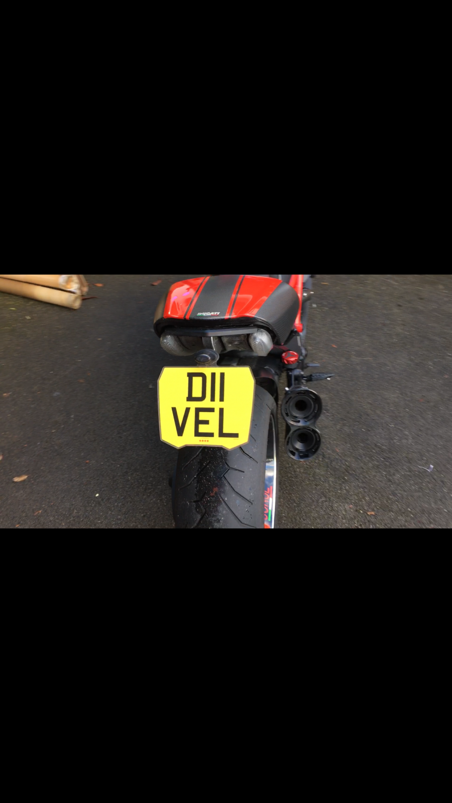

  16. IMG_4074.PNG Tidy off time
  17. Is there no left hand corners down your way? :grin:
  18. Oh yeah, does look a bit odd. Dust from the floor over the other half, looks like. Nice new boots for the summer now though
