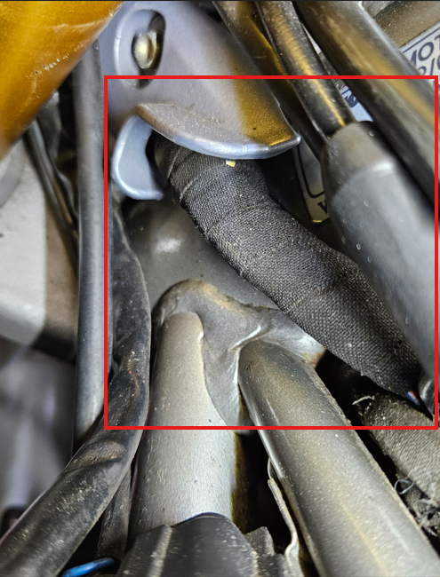

  1. Does anyone have a step-by-step guide on how to remove the light bracket from a 999?
    The manual suggests that you "disconnect the electrical connections" but doesn't give much useful info on which ones, where they are, etc.
    I want to open up the assembly a replace the low beam unit, as it seems to be very "loose".

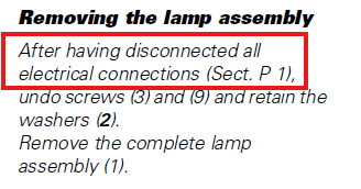

  3. I have the Ducati Workshop Manual but all it says is:
    Which isn't much help, as P1 is just the various wiring diagrams :-(

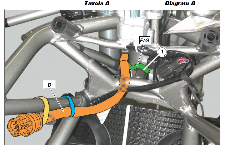

  4. The manual should have a nice 3D graphic showing where the various electrical looms run. There should be one detailing all the various connections to the headlight assembly.
  5. I might be reading the manual incorrectly, but there are a lot of pics of the different cables/connectors but I can't see any references to which ones connect to the headlight assembly. There is this sort of diagram, which looks like it might connect to the headlamp assembly but I'm not sure if there are others:

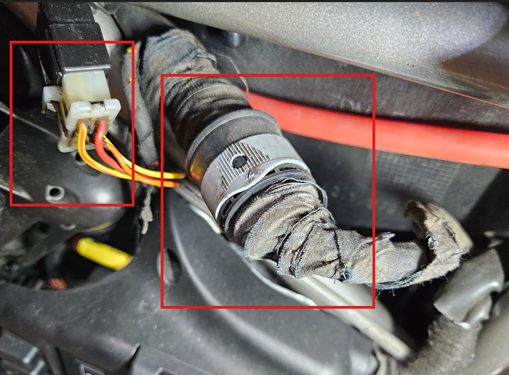

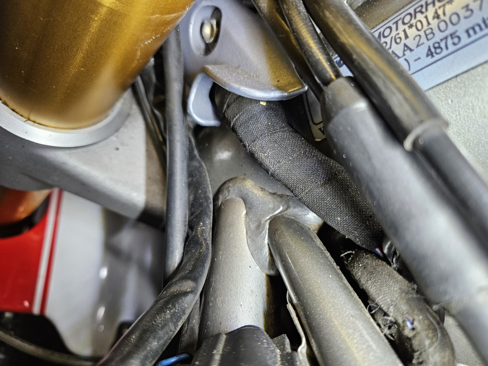

    I might just have to bite the bullet and remove the headlight bracket and see which cables stay connected to the rest of the bike.
  6. It's been a while since I did it, but I've a feeling it's just one big connector to remove it as a sub-assembly.
