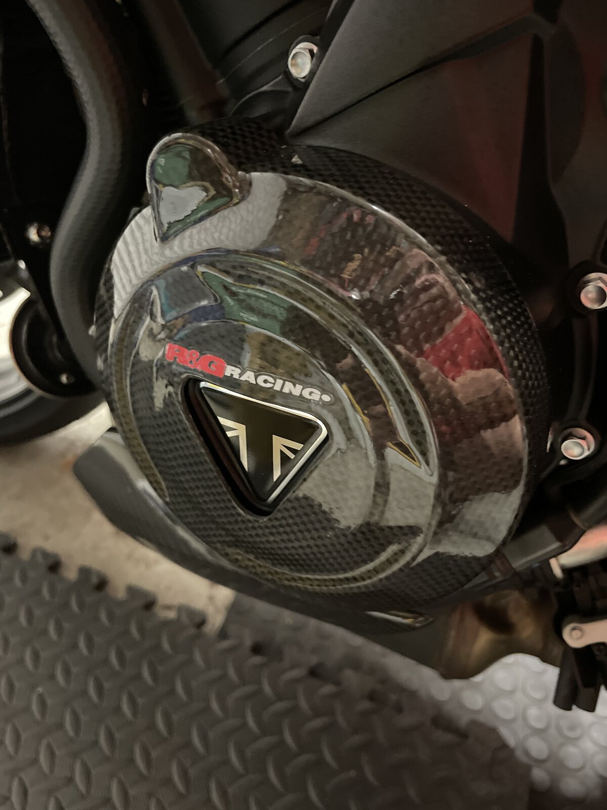

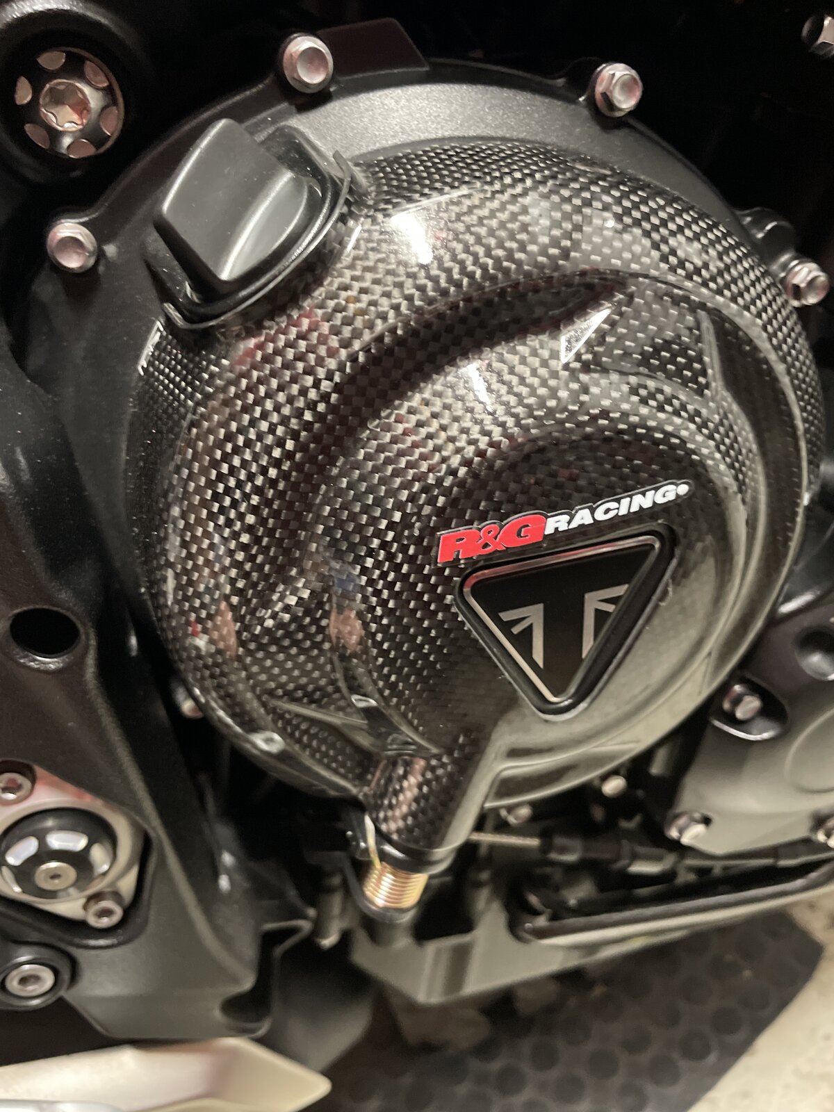

  1. image.jpg image.jpg My Striple has R&G carbon clutch and genny covers fitted by previous owner. I’d like to get shot of them but am a bit concerned it’s going to be a pig of a job. Has anyone got actual experience of doing this (I’ve taken carbon off tanks etc but never an engine cover and I kinda know what I’m doing) that can provide some real life experience rather than “you could try …” kind of thing. I’m pretty sure it’s be stuck down with silicon.

  2. Just add heat don’t you, make the glue pliable? May discolour the carbon….whey do you want to remove?
  3. Edit just looked at the pics more close;y. Are they not bolted on all regular R&G?
  4. The R&G web site leads you to think it’s bolted but I’m not sure. My guess is double sided sticky pads like the Ducati carbon cover. Andy
  5. They are stuck on. R&G supply aquarium silicon to fix them on.

  10. Just off. And more importantly not damaging cases below.
  11. Once unbolted a long blade modellers knife would cut through silicone in a heartbeat.
    Though perhaps a cheese wire (garrote) would be better?
  12. @Jez900ie is not far off with cheese wire but dental floss or dental tape will be kinder to the engine casing whilst also cutting through the silicon and also being easier to work under the covers. I’d apply silicon remover first though, WD40 does work but others such as Liqui-Moly have a purpose built sealant remover for engines.
